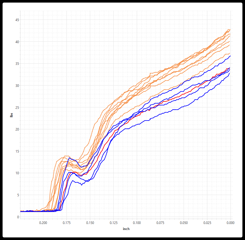

    I decided to run what will likely be the first of many tests in this regard.
    What I did:
    - I took new Lapua brass and prepped as follows: uniformed flash holes and primer pockets, trimmed/chamferred/deburred, mandrel, neck lube
    - After the trim step, I annealed every piece of this new brass. With five pieces, I annealed them four times, letting them cool completely between annealing
    - I then primed, charged and seated (using an AMP Press)
    Here are the plots (annealed 4x in blue):
    Notes:
    - As you can see, the 4x annealed cases show markedly lower seating forces.
    - This is likely to have been caused by the brass being slightly softer.
    - If these two sets of cases were shot next to each other (and I will do so hopefully tomorrow, but I might have Covid...), you would expect to see slightly lower velocity from those with lower seating forces.
    - This is not 100% analogous to annealing four times over four shots because in that case, the brass would be getting worked during each shot, so I wouldn't expect this much of a drop
    What's next? I don't know. I have to noodle on what would be a good test here to see how much this impacts things - I also hope I don't have Covid so I can test these tomorrow.
    What I did:
    Notes:

    How do you account for changes in the interior neck carbon with each anneal, impacting searing force?
    I use an ultrasonic to get the necks as clear of carbon as possible. For these, I used moly in the necks prior to mandrel and trimming, then dipped in neolube #2 prior to seating.
    Seating plots (28 cases - not the new brass):

    Pretty simple concept, actually.
    The point @918v brought up was that annealing over and over again lowered velocity. The way it would lower velocity is by softening the brass more each time, thus reducing effective neck tension.
    By annealing 4x in a row, I am testing whether annealing multiple times does indeed have an additive effect each time on softening brass. The plot above shows that it does. You are correct in that there is no work hardening, etc. that would lessen the softening each time, but this test is about testing the extreme.
    The questions I have now are:
    - Does the work hardening completely counter the additive effect of annealing? @918v has experienced that it does not - I would like to find an effective way to test this and gather data on it.
    - What is the floor - or is there even a floor - of the softening?
    The point of all this?
    If the brass is indeed continuing to soften as @918v postulates, is there a way to mitigate this? Why is that important? Because if you're developing a load at annealing #1 or #2, and the effective neck tension at, say, annealing #6 is different, then you've got to adjust your load. Determining if there is a floor is important, because perhaps you can mitigate by annealing to the floor up front with virgin brass prep.
    Reactions: R_A_W

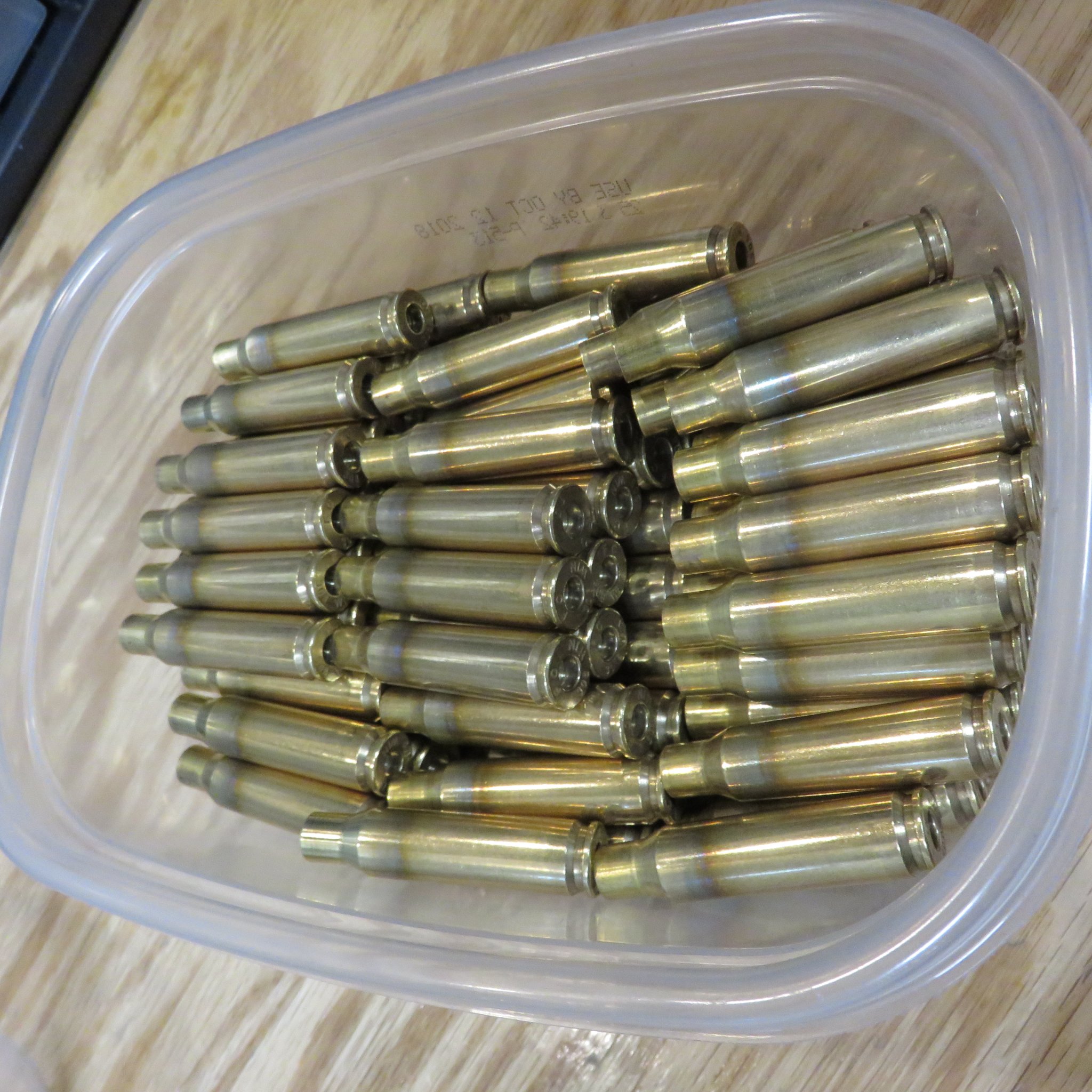

    When I first started annealing I was following the often prescribed 750°F as indicated by tempilaq. Then I saw a demonstration of the AMP where in subdued light you could see the neck turn rather bright red just for an instant as it engaged for their popper annealing time. For that to happen, the temperature had to be like at 1000°F or more. That's when I decided to try the Glow Method. In a darkened room I would get the case necks to start to glow and then have them immediately drop out of the flame. That glow was not just on the inside as I can see the glow also on the inside as well just before dropping out of the flame. With the case walls being so thin, I doubt there's much difference in temperature between the outside and inside. The results I got, both from the chronograph and on paper, are better than what I was getting when adhering to the 750°F model.
    Below are some Federal cases that have been 10X fired, which I was processing. The pic is after cleaning the necks with steel wool after annealing before sizing. You can see how far down the anneal line goes, which was a little lower than I typically do. But they still performed very well.
    Reactions: MarshallDodge

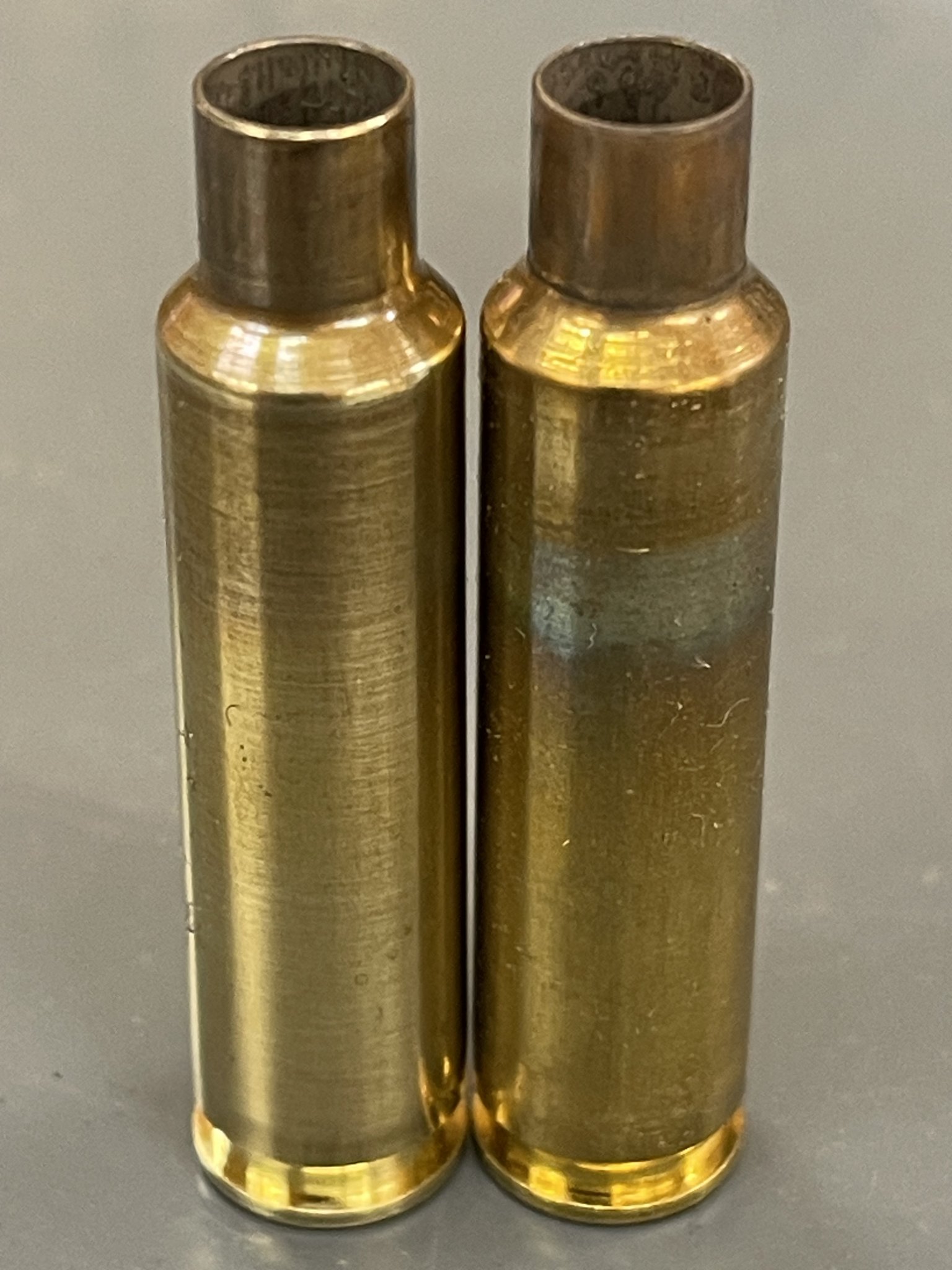

    You're right, discoloration does not tell you much about the heat on the case body. A lot of that simply depends on any residual cleaning or sizing solutions left behind. And the only part of the case that start to glow is the neck. . . not the shoulder.

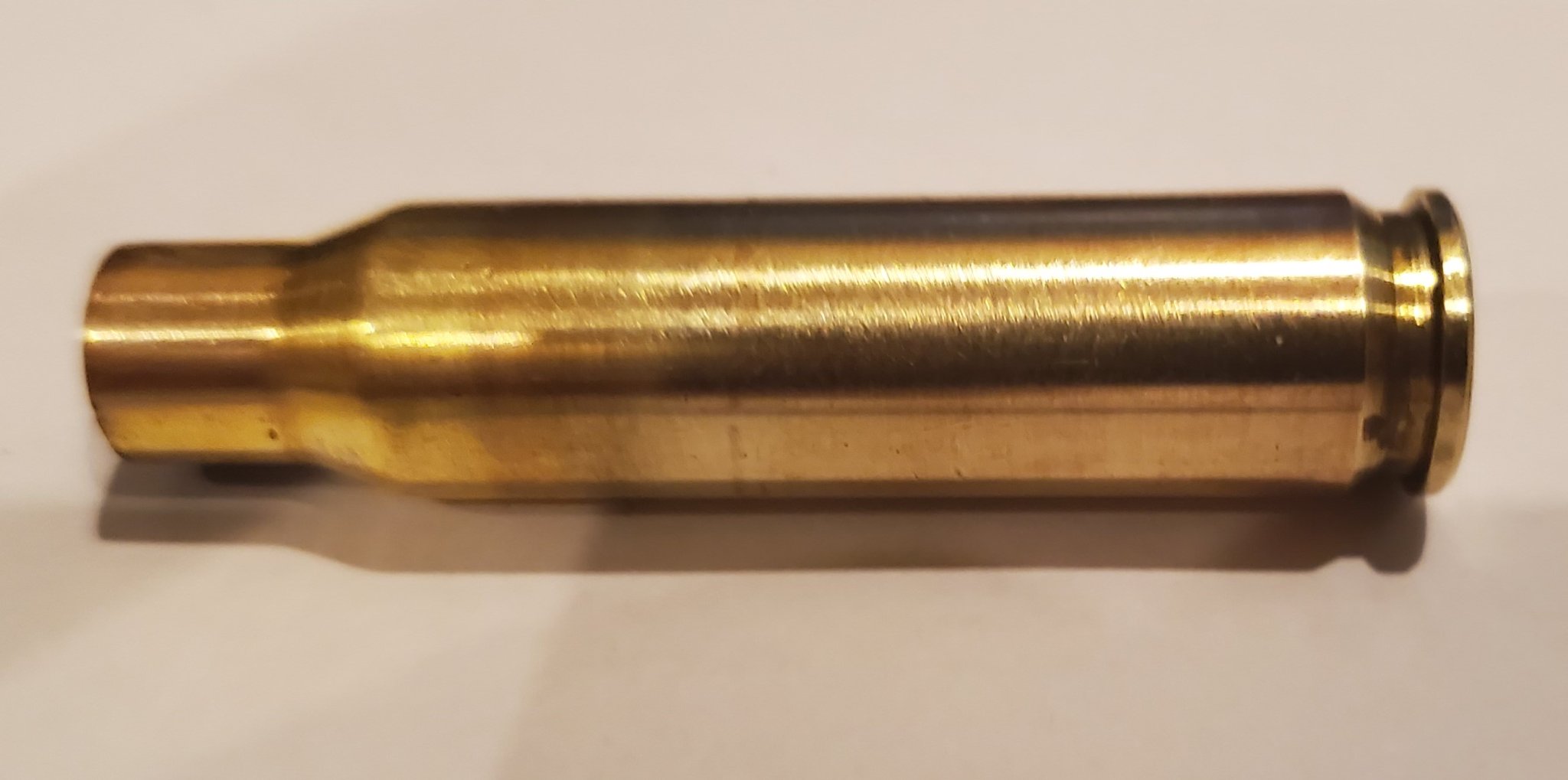

    Like I showed someone else on this website, I took a case and rubbed it down with steel wool to really get rid of an much contaminates as possible. Then I put in in my flame annealing machine and ran it for a little more than double the time I normally do to see if I could see how much and were the discoloration goes. Mostly, only could see and feel an oxidation layer. This is the result:
    Not long ago the guidence was when 750 turns at the shoulder body junction, not just the end of the neck.
    The neck will always turn before the shoulder, if equal heat are applied to each, so you concentrate a bit more towards the shoulder to try and have both come out closer together. But the neck will get to probably 1000 when the shoulder hits 750 just by the nature of the amount of material heat sink there is in each.
    I use an Annie and I find the point where my depth in the induction field has both neck and shoulder come out closer and then I do the time setting where I get the anneal to happen at the shoulder body transition.

    Range report:
    - I got a velocity drop, but as much as expected, and what I would say would be within a margin of error.
    - I expected in the neighborhood of 15 fps, and I got a 7 fps drop (2906 fps vs 2913).
    Reactions: B y r o n

    I started annealing brass a couple weeks ago. Running Aztec so I punched my code in from memory, 262. Ran a piece of brass, pulled it out when it was done, wow that looks hot. STOP. Is something wrong with this machine? THINK. My code is 162.
    I annealed brand new Starline brass like that. Without annealing there was obvious seating pressure variation. After annealing I could not feel any variation. SD's were below 10 consistently.

    Looking at your pictures it looks like the case mouth was smashed against something and the shoulder was deformed in the process. How is this the cause of the annealer?
    Maybe some more information about cartridge used, dies, bullets, and anything else that might lead to determining the cause of your problem.
