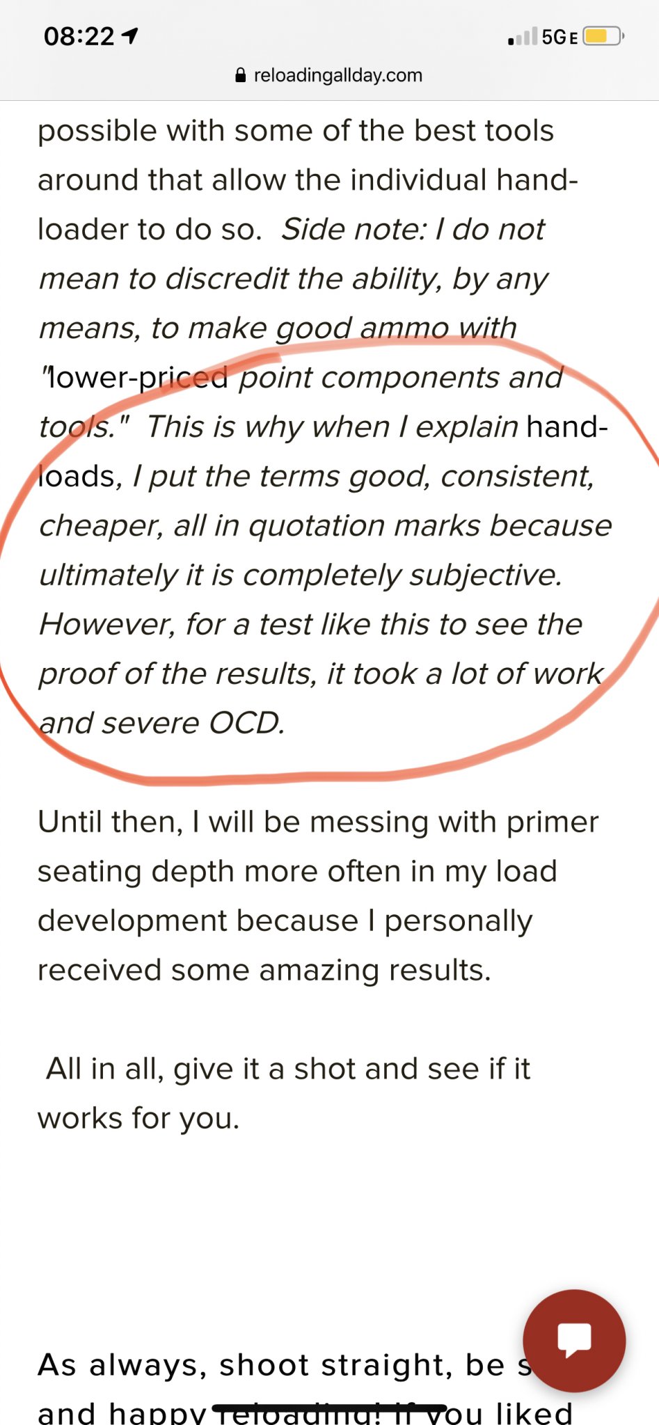

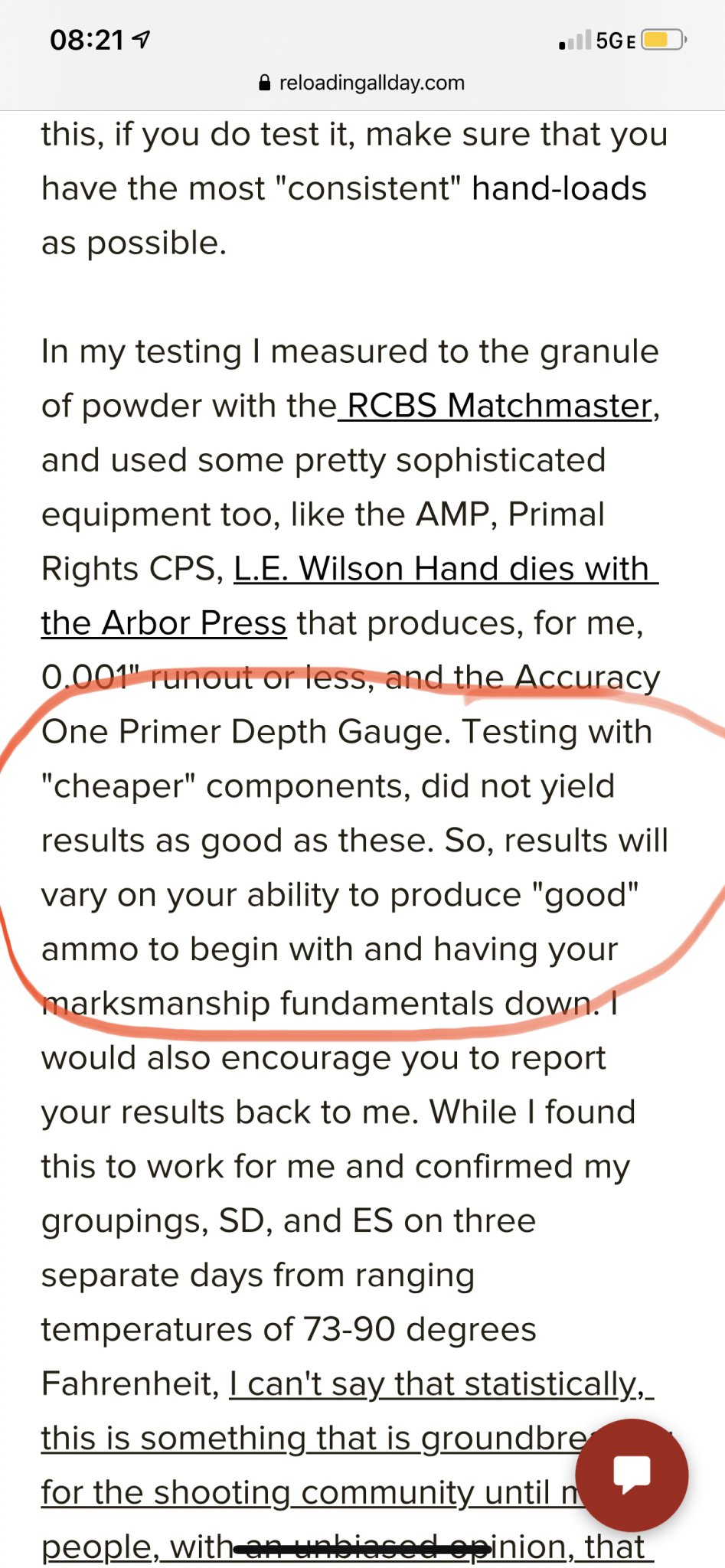

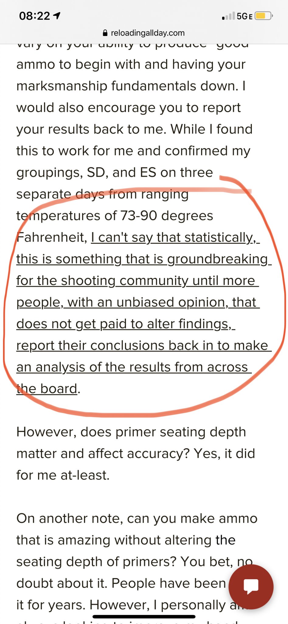

    Not to mention, he explains all this.
    Reactions: straightandtrue
