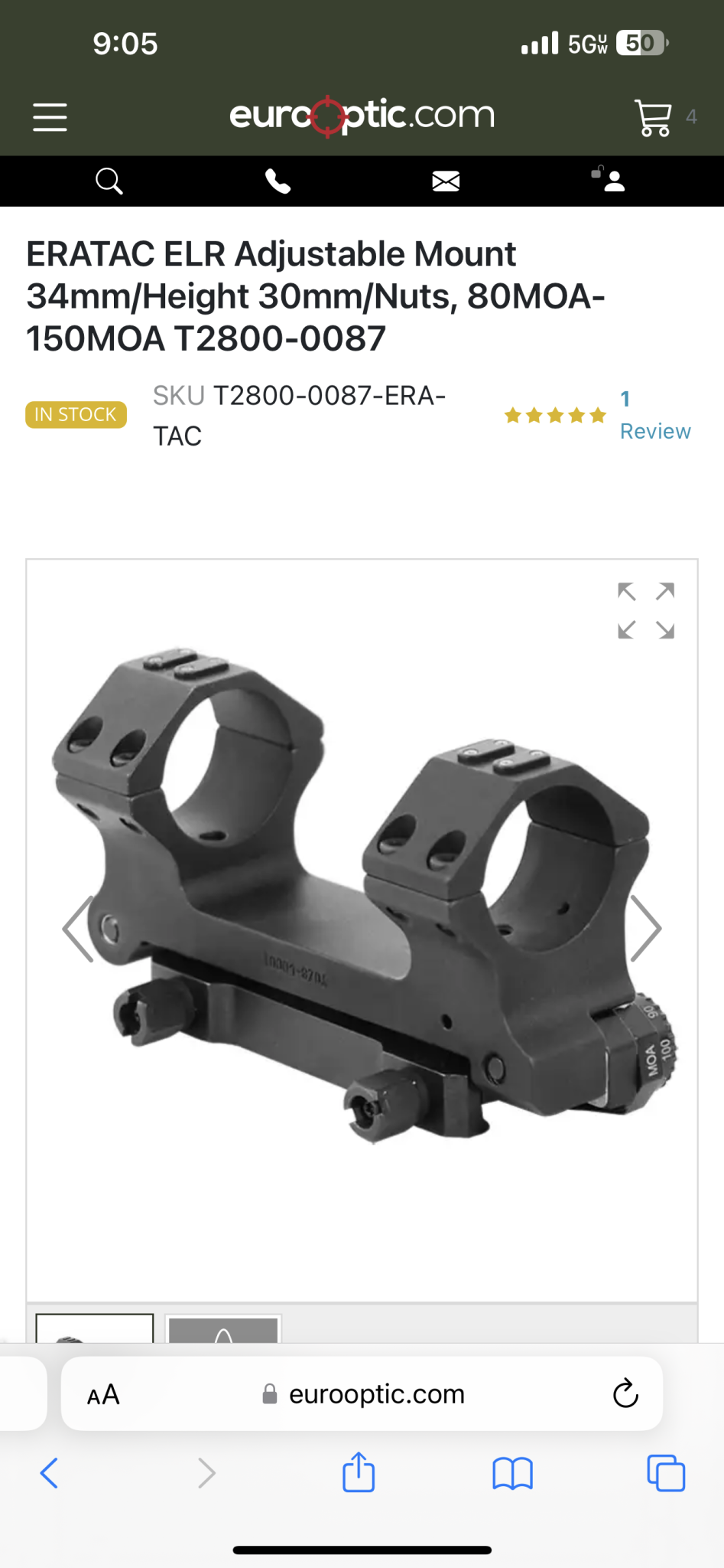

A 30 MOA mount will get a 30-06 to 1000 without a problem. With the right scope you can do it on a 0 MOA base. My .223 has a 20 MOA base and I shoot it to 1150 yards. You are way overthinking it. LOL Just trying to show you it's a non issue and the pinned scope base will be more of a help than hindrance.
And as @Rob01 mentioned, if you do indeed want to circumnavigate the globe with your bullet you can buy scope bases with additional MOA tilt built in.
30 MOA pinned base plus 10-20-30-40-whatever MOA one-piece rings = 40-50-60-70 MOA.
And Eratac even makes adjustable MOA rings.
If 150 MOA rings plus a 30 MOA pinned rail isn’t enuff…call in an airstrike?
