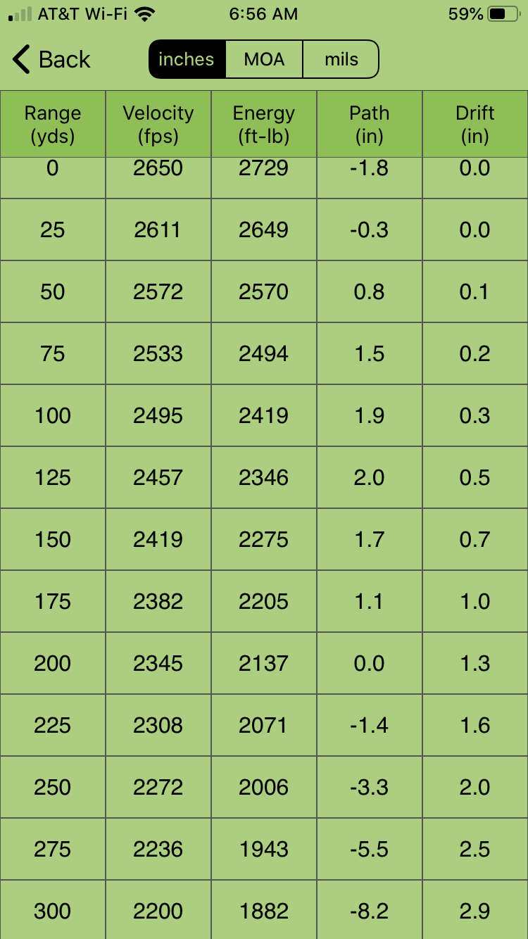

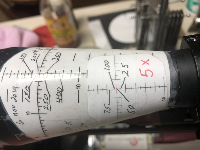

I just got back from shooting short range. Its 6.5 cm 2650 muzzle v. 130 bergers. its 2 3/8” scope to bore c to c.
At 5x, my 75 yd and 100, look possibly reversed, it was misting when i hurriedly did my testing and its raining now or id just go back and test.
Do you think 75 & 100 are reversed?
thanks if you can help

75 & 100 looks reversed to me on your 5x diagram. Your highest bullet impact should be somewhere around 120-125 yds with a 200 yd zero.
Those are some confusing diagrams to me, even though I see what you are trying to do.
One of the main benefits of a FFP scope you are missing out on. Subtensions remain constant at all mag ranges.
Unless that is for shooting tiny dots, or a .22 squirrel rifle, I don't see the need for knowing exactly where your POI will be at 25, 50, 75, 100, 150, & 200 zero. For deer, a 1.7" crest at 120 yards is still sufficient to hit just about any small/medium/big game except maybe prairie dogs or squirrels.
Just my opinion.

Do yourself a favor and try zeroing at 100 and building a dope sheet out to 500 using 10yd increments. it takes 2/10th of a second to dial once you’ve ranged your animal and you won’t have to worry about guessing if your hold is correct, especially if your deer isn’t exactly at 200 every time.

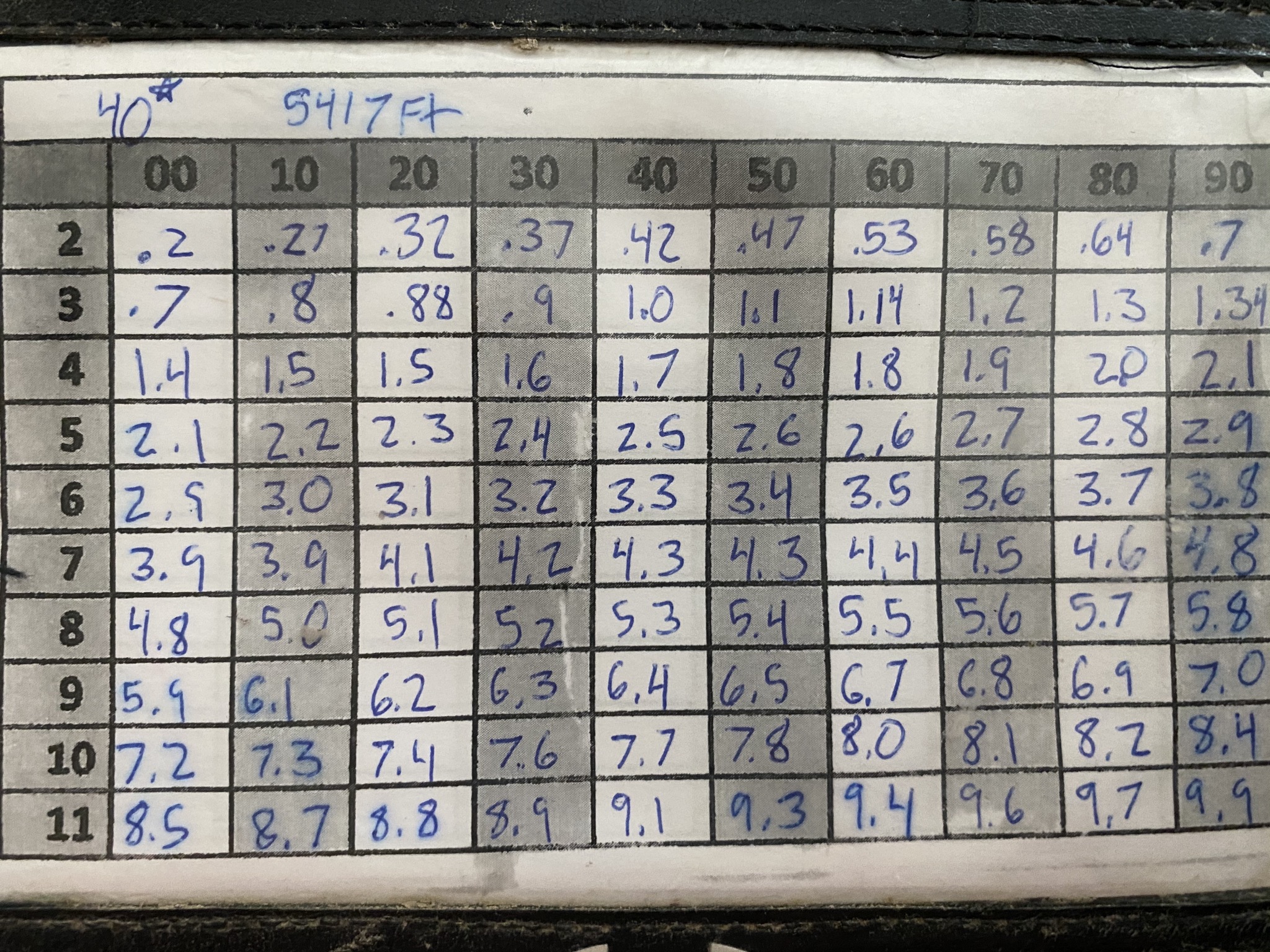

here is an example of 40 degree day with 5400 DA out to 1190. This is with a 100 yard zero. Notice the dope card starts at 200 cause it’s only .2 up from 100. 150yd is .1
100s on the x and 10s on the Y.
640 yards = 3.3
What hicm28 is telling you is that a 200 yard zero can allow for error in your zero due to large atmospheric changes. The added bonus of 100 yard zero is that all of your drops are below your zero... This has been debated much in the threads as there is an old school train of thought amongst hunters that a longer range zero has some advantage. It is solid advice but in the end you will do what you will do.

Can you please list what scope and reticle you are using. It sounds like you have some sort of SFP scope with a fairly useless reticle, and are afraid to dial the turrets.
If you zero at 100 yards, every correction in the scope will be in the "up" direction. If the deer are at 200 yards, dial the correct amount, and shoot them. the correction on my 6.5x47 at 200 yards is 0.4 mils. this should be a chip shot. don't overthink it.
If you bothered to read my original post, I am not asking for opinions or facts about where to zero, and i posted later that i went back and shot and confirmed that the 75-100 are correct. I am not saying everybody should zero at 200. But i do know that 100 yds is not a magic number.
The 2 trees in line with verticle crosshairs are 212 yds, that is where i see the most deer. Sometime i dont have time to adjust turrets. the narrow opening is 100 yds, the lane is about 10 yds wide from shooting house out to 100 yd.

He is using a nightforce shv 5-20x56 sfp moar reticle. I can’t remember if the top turret is capped or not. Also he shoots them in the neck and has to be ultra precise.

That is need to know info for walking around shooting varmints they can be from 1-700 yards. The real close shots are easy to miss when you can only see a head or less.
So leave your scope dialed .2mil. You're talking about roughly 1.5" difference between 100 and 200 yards. 200 yard zeros just add complexity and will certainly add confusion as soon as stress is introduced.
