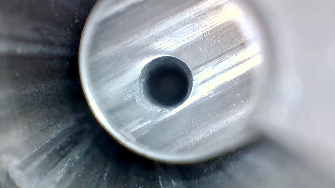

Forgot a buddy has a borescope! Anyways, gas block looks aligned well enough, maybe just a smidge off, but certainly not enough to affect anything I wouldn't think.
Gonna play with the buffer weight next. Now I remember why I told myself I'd never mess with building an AR10 :ROFLMAO:
