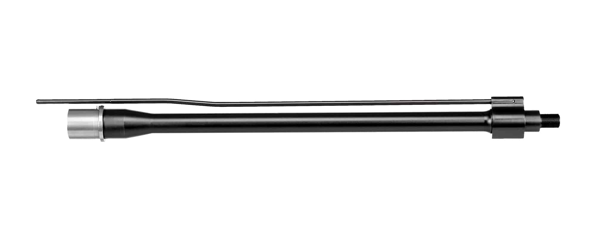

No way to change gas system length except possibly cutting down a 20"+ hbar to an SBR.
The good news is Faxon Firearms makes an 11.5" barrel with mid-length gas and it isn't terribly expensive, probably not much more than the cost of cutting and threading your current barrel so swapping makes a lot of sense even if you could cut it.
If you're going to regulate gas, you should do it at the gas block, that will reduce the amount of gas dumped in to your upper after the gas key has moved back off the gas tube. An adjustable gas key has no way to do that.
I think the Faxon barrel was kind of designed for running suppressed so there are probably many examples out there that you could learn from to see what works.

This is a 14.8" RLGS, as you can see it's only got around 1.5 inches of dwell time.
