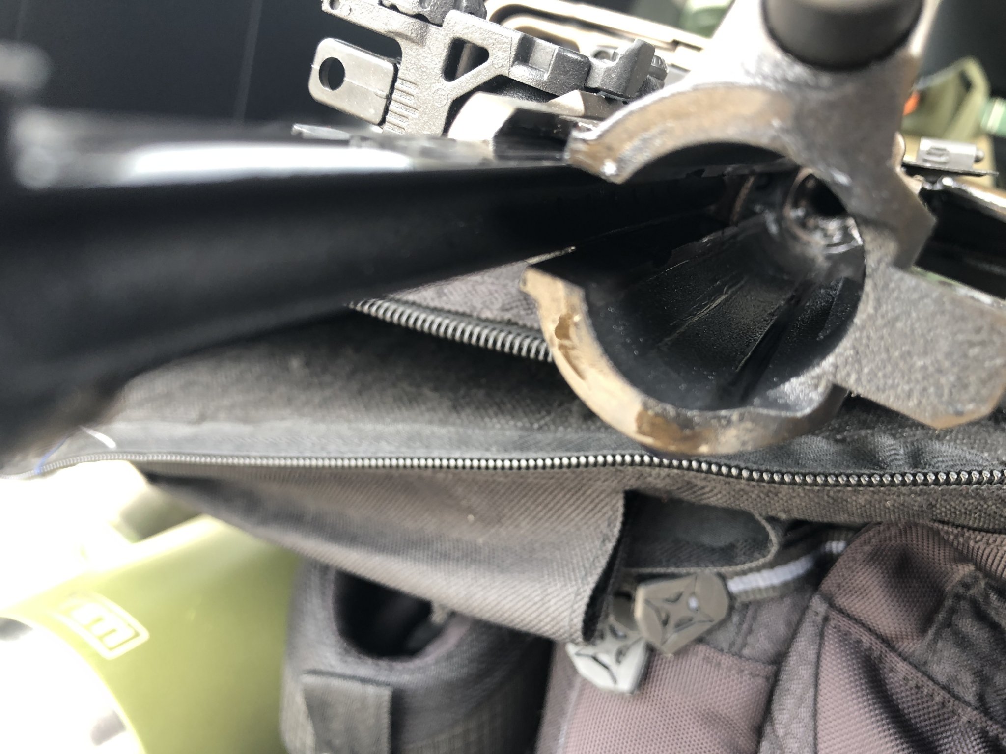

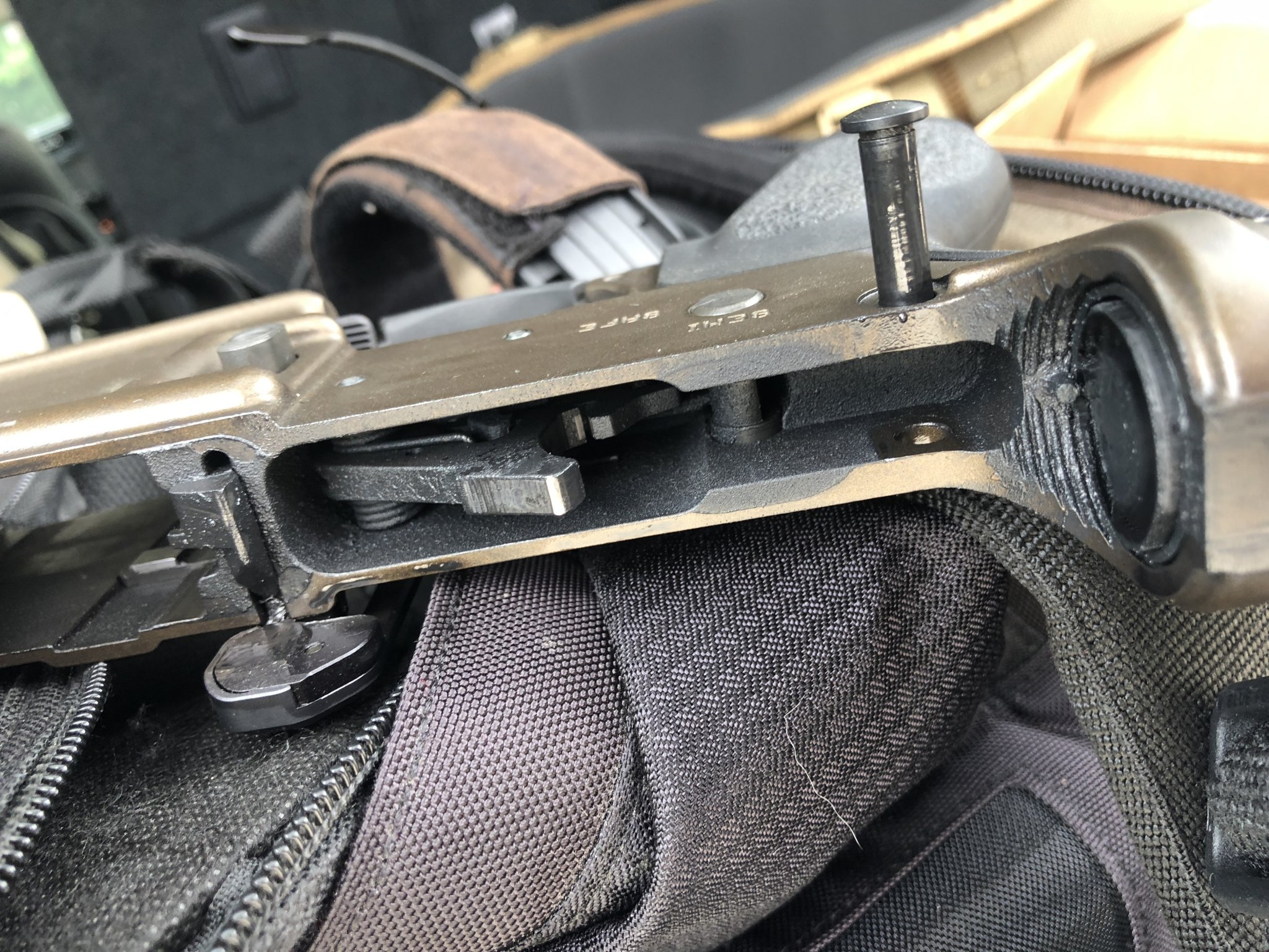

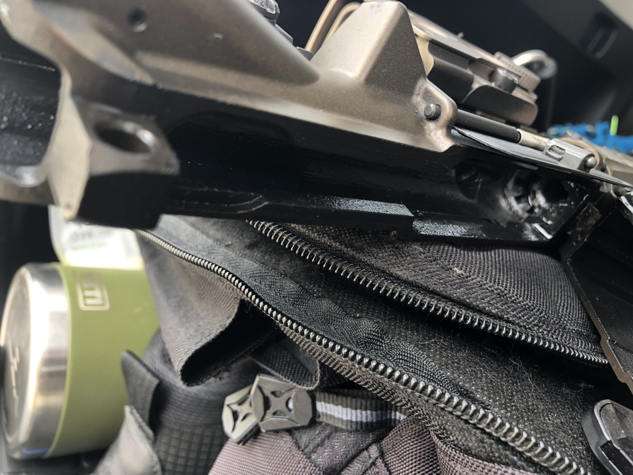

I recently took a course in July where I ran about 2,500 rounds through my BCM. I shot roughly 1,200 rounds suppressed through the rifle. Did not clean it during the course. Federal XM193 was the ammo used. BCM mid with 16 inch barrel. From what I have learned in use of suppressors is I have a bottle of lube on me during courses. SLP 2000 EWL does real well with extreme use. I use quite a lot of it but never had any issues with extraction or jamming. It gets incredibly dirty to the point of sludge falling out of the rifle. BCM also has a extractor upgrade kit which really can help. Spikes Tactical buffers can also help slow down the BCG. Here are some pics from the second day of the course. AR’s get dirty!

I've never ran that many without a cleaning, but bet you could go all summer long.
Try that in the winter and results will probably be different.
