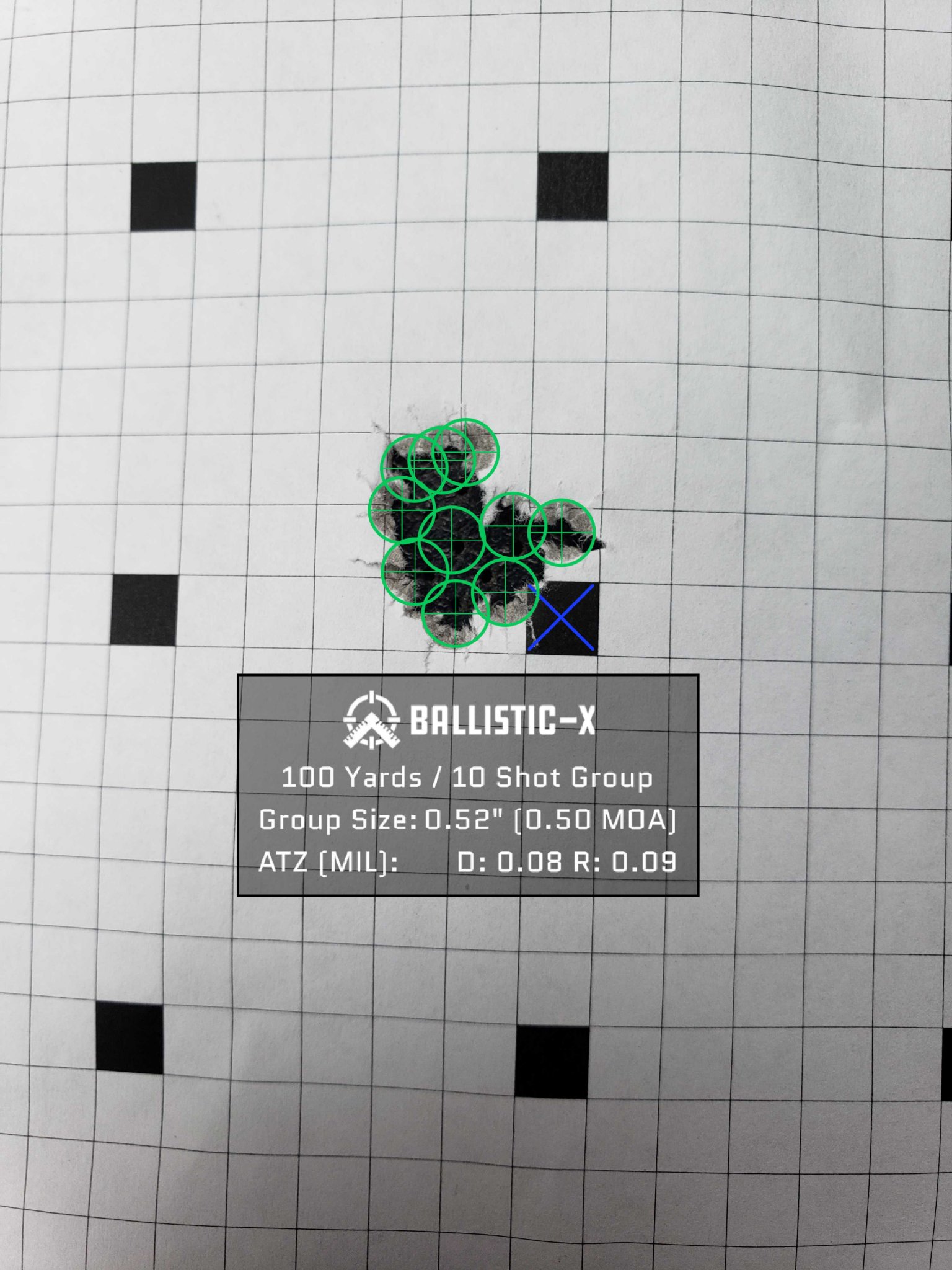

So I finally had my last straw with tipped bullets. Specifically, Hornady, but I'm not likely to go back to anything with a polymer tip for the appreciable future.
Quick version: 223s they shoot great at 100, 200 and with 6.5s even 400-600yds. But small lot-to-lot ogive/BTO variation, concentricity and consistentcy is not their strong suit.
Detailed version: My 6.5CM comp gun shoots consistently .3-.5 moa at 100yards. Ragged holes with no flyers with ELDs. At distance of 400, they stay around 1.5-2" but I'll have 1-2 "flyers" every other group that I usually explain away as the nut behind the gun.
However at Kahles, I had major issues with groups beyond 650-700 (elevation and windage). Groups were more like 1-1.5MOA at much beyond 700. Came home, check at 400 still right at .5 MOA for back to back 5 round groups. Leaves me wondering....

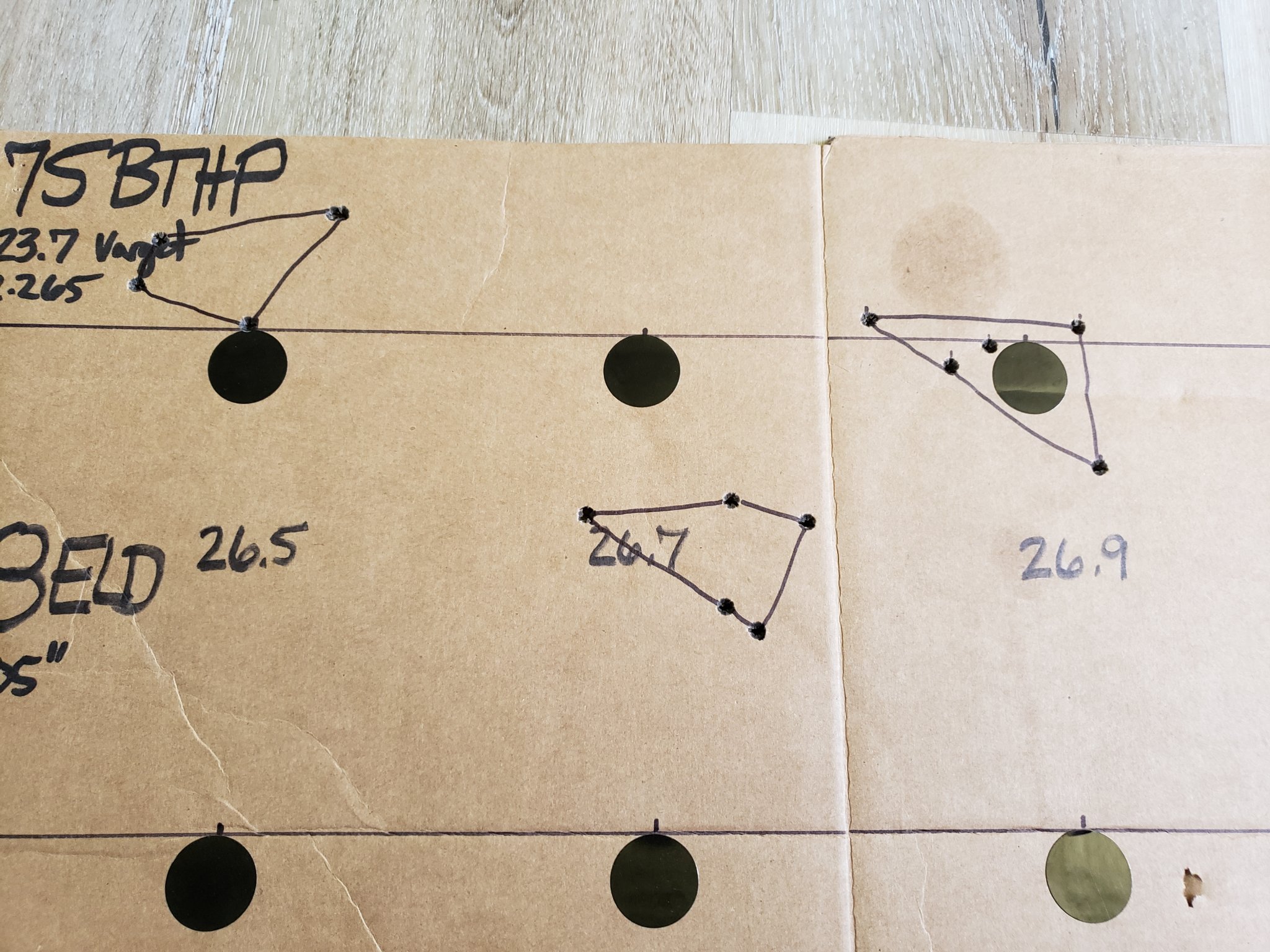

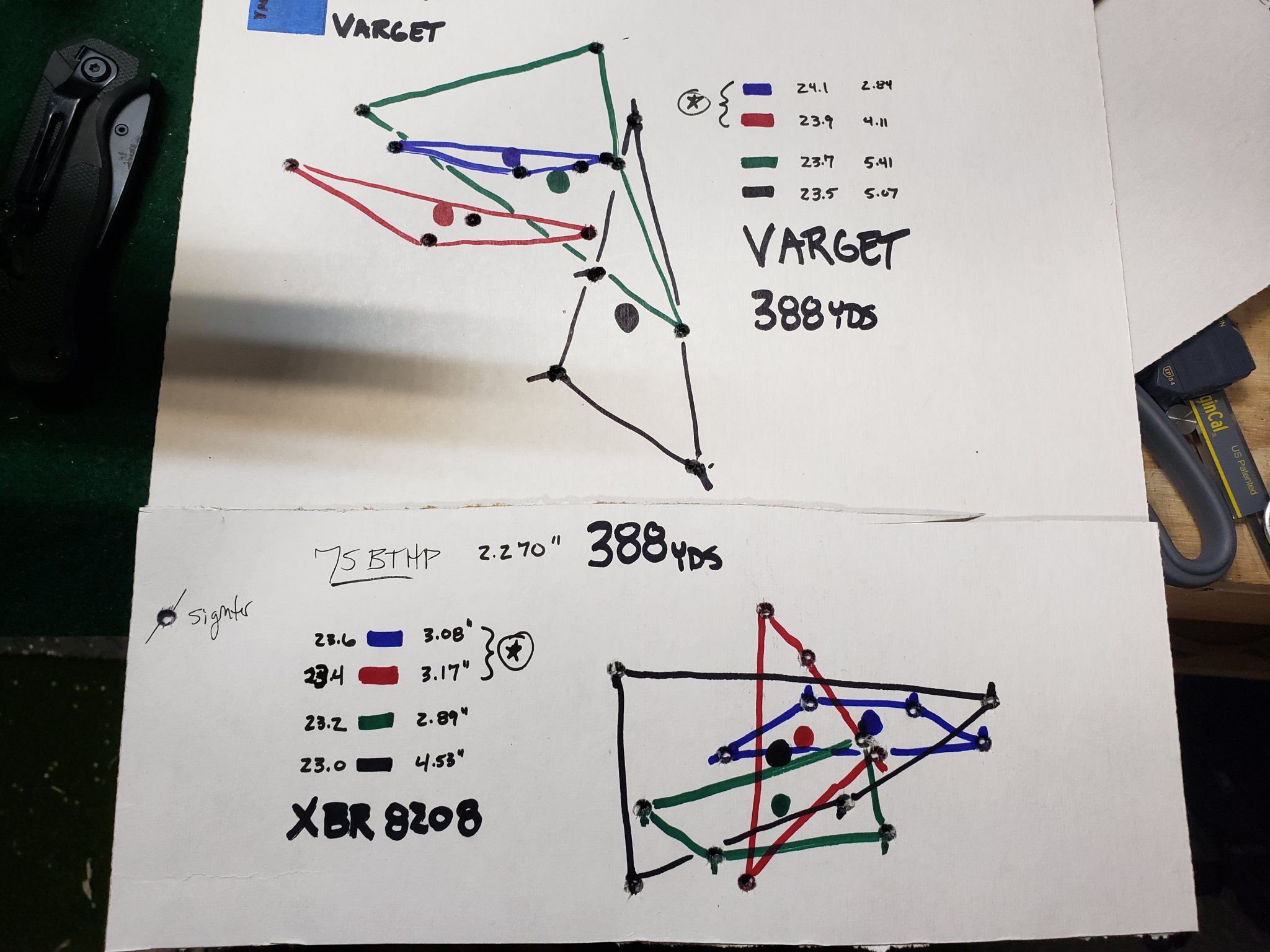

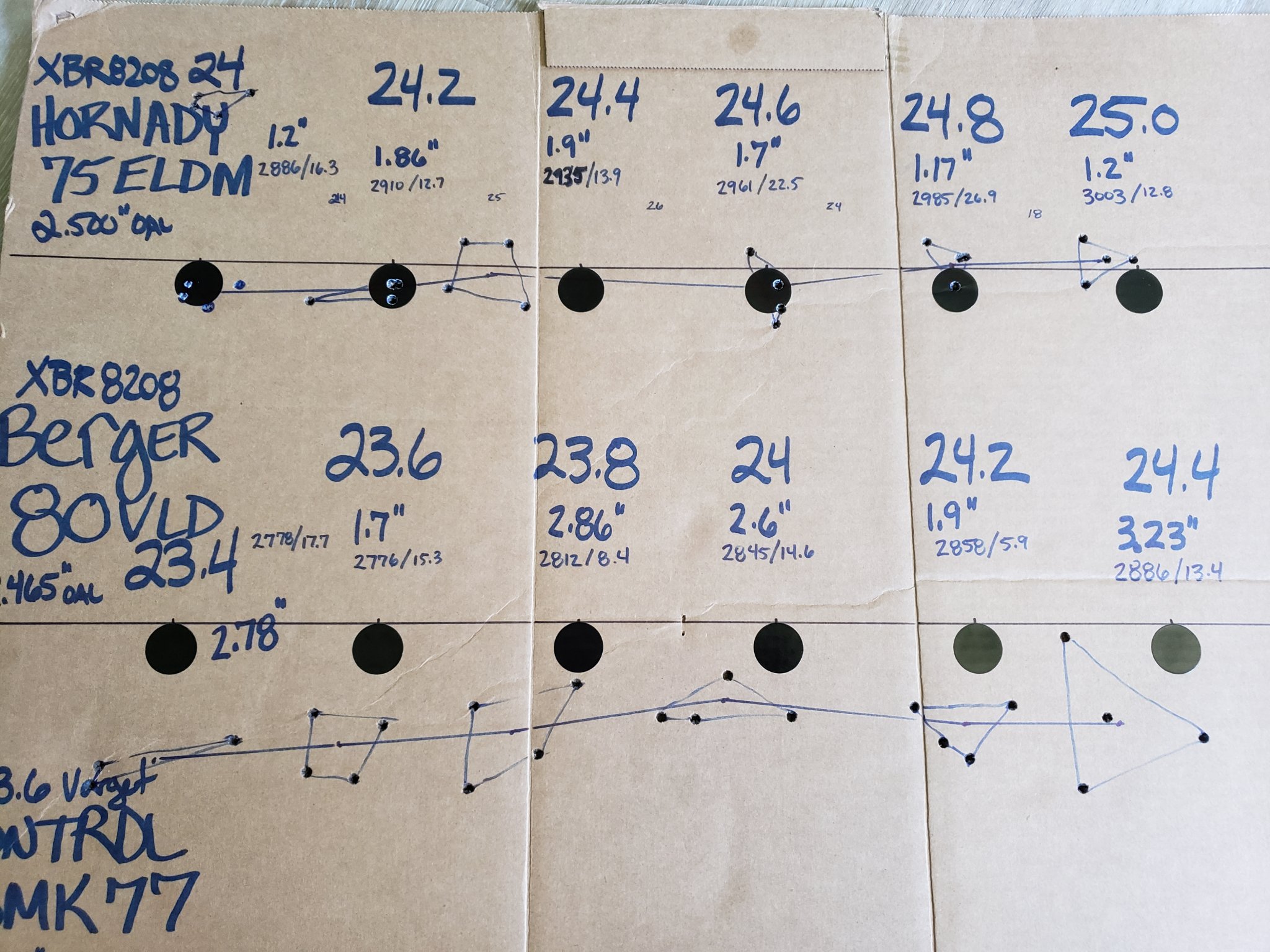

Picked up 223 trainer and started load Dev last week. 75 ELDs, 77 SMKs, 88 ELDs and 80 Berger VLDs. Testing with 4 shot groups at 300, the Hornady 75gr had two great nodes: 24gr and 25gr XBR. Both were .4-.5MOA both and .3gr wide. SUPER!
Load Dev:
7091129
Except, when I loaded confirmation, the same loads shot 1 MOA at same distance. 3-4 in 1" or so plus a flyer. No big deal, maybe it's seating depth, right?
Confirmation target: 300yds (note these are not the 75 BTHP, I labeled it wrong and didn't fix it after shooting.)
7091130

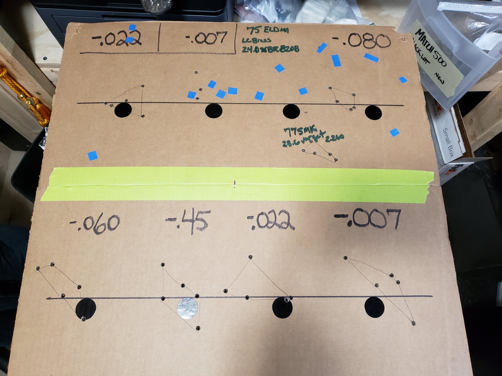

Shot seating depth confirmation and suddenly, .020 off sucked but .080" jump was good. I loaded 50 at .080" jump and shot then today. But I also checked runout: FML. They had .000-.008" runout, and even if the runout was .002 or less, you could visibly see the tips arcing non-centered in the test rig.
Seating depth test:
7091128

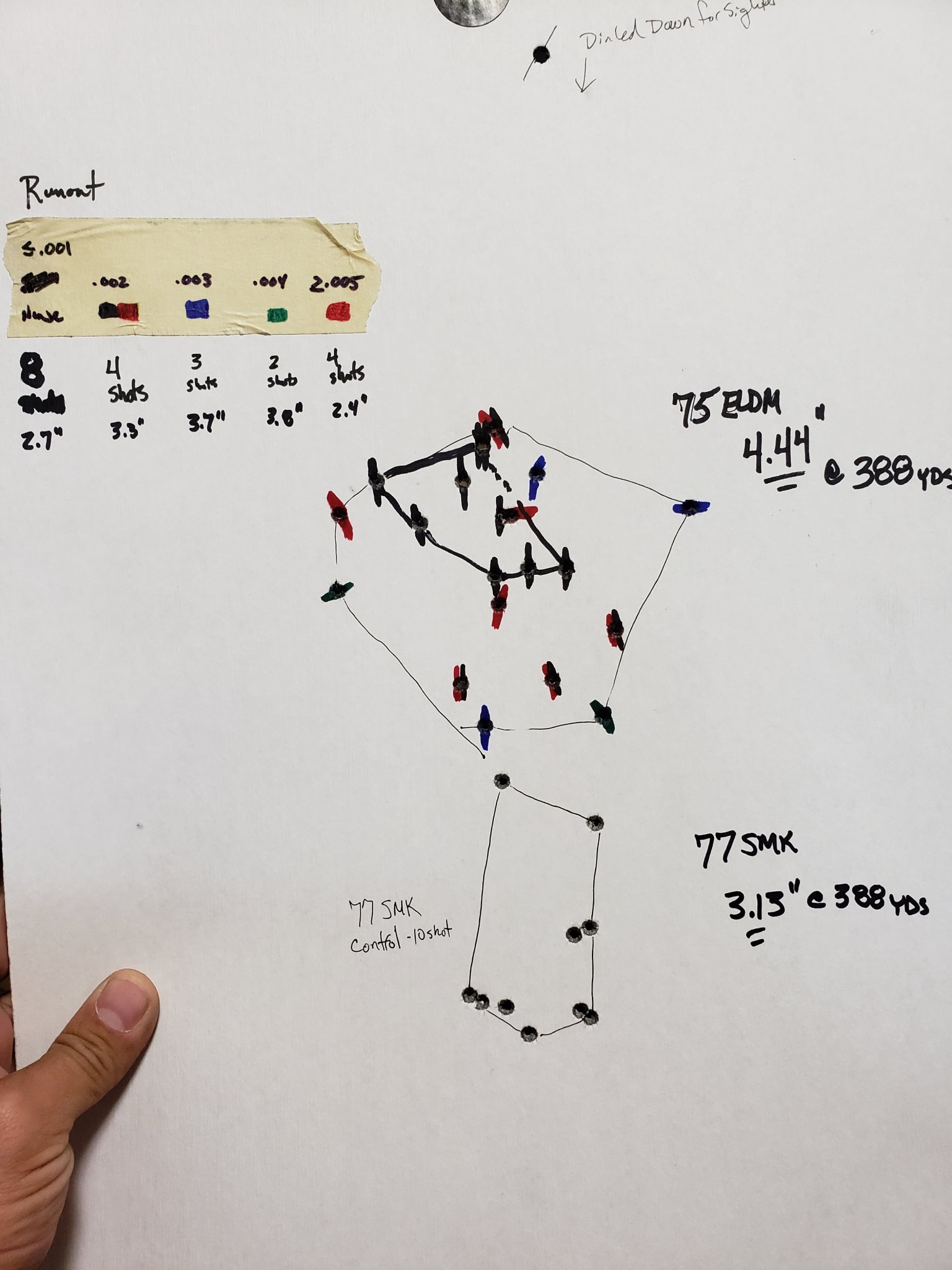

I sharpied them to see where specific run-outs would land within the group. Photo below, along with 10 shots from the 77 SMK load (which shoots .5-.6 at 100, 200, 300 and 400).
77 SMK 100 yds:
7091132
75 ELD Runout test:
7091122
The black cluster in the center are the 8 rounds that had .001 or less runout. The rest are scattered around the outside of the group with a few that made it inside avg of .001 group.
The 77SMK load has not been refined at all; and it exhibits the vertical shape all the time. They always group like a tall oval. Could probably tune this out, but 8 out 10 shots landed in 1.5" at 388yds.
Plastic tips are crap and bad quality control makes it worse... It's not that they won't shoot, it's that only 50% shoot like they should. This makes them essentially useless as a trainer or wind calling, since you never know if it was really a bad call or simply a bad bullet. But they are only 18-19 cents each.
I should know better: you can't expect Ferrari performance on a Civic budget. Lesson finally learned. Lol...flame over.

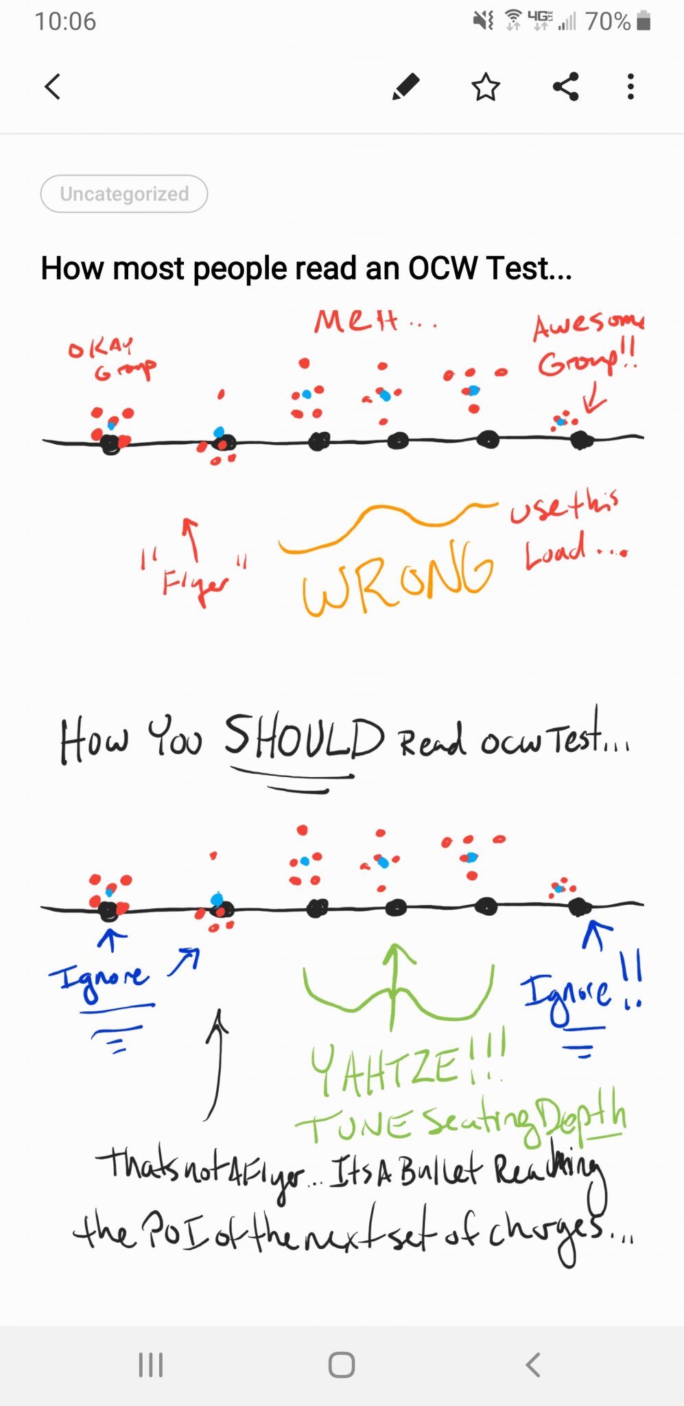

The reason why is proper load development at 100yds ensuring you are in the dead center of the node...
If you are not, you will see it on target beyond 500yds. This is why Dan Newberry's OCW method screams to not look at group size which unfortunately LOTS of guys do. Group size isnt what your looking for during initial load development and I feel like a broken record stressing this to shooters for years. You're looking for consistent point of impact that way weather variables, powder lots and slight variations in powder charge dont change your point of impact if you're in the dead center of your node.
Groups can look amazing at 100, 200yd but that vertical stringing and flyers out if the group really show up beyond 500.
Yes, it is a lot of work to find the center of the node, then tweak group size with seating depth to see what your barrel likes but it's the only way to go if you handload. And yes, you need to redo it every time you switch a component, whether its brass, bullet, powder or primer. I also always recheck in 0.2gr increments going .6 down and .6 up from my load to confirm my load with new lots of powder.
Load Dev:
Seating depth test:
77 SMK 100 yds:
75 ELD Runout test:

Group size isnt what your looking for during initial load development...You're looking for consistent point of impact ...
I'm reading your post thru several times to learn all I can . Some clarification on group size vs. PoI....
I'm guessing consistent PoI would best be measured on graph / quadrille paper???
The way I'm thinking... putting 5 shots into 1 ragged hole would be both a pretty consistent PoI... as well as a pretty good group size.
So....what is the diff btwn group size and PoI? What am I missing here?
No, not correct. 5 shots in a ragged hole has nothing to do with consistent POI. 5 shots in a hole at 100yds is worthless if those same 5 shots at 600yds are 18" vs a say 0.5" group at 100yds that shoots 2.5-3" at 600yds..... You need to read Dan Newberry's OCW then ask any questions you have.
Group size is exactly that, the size of a group, regardless where it lands on the target....Consistent POI means it consistently impacts the target at the same point every time. This plays into barrel harmonics and being in the center of the node means the barrel is release the bullet at the same point in the whip every time.....

It's clearly laid out in Dan Newberrys ocw I posted above. No, we are not looking at group size at all.
WTF why can't people go read Newberry's method in his own webpage? And then once they ready it stop assuming that he's wrong because his initial focus is not group size.......
BTW, maybe that's why Hornady ELD-Xs work for me all the way to 1000 yards with boring accuracy. Cause I'm in a nice node.
I've read the first couple pages; so far it seems to match my understanding of the process. Thanks.
You obviously havent read it at all if you still think what you posted above is accurate. Nowhere does it say look for groups to get small then large again.....Dan specifically states to ignore tiny groups...Some of you guys crack me up.
I've read it carefully several times over. I'm still trying to understand "hitting the target at the same point of impact."
Does that means"forms aclover leaf around a central point?" Say vs. vertical or horizontal stringing?
Sorta this: (tho smaller / tighter)
7091941
Honest....I really do want to understand this.
So if your first group hits an inch high at 12 o'clock, second group is an inch out at 1 o'clock, next 3 groups hit at 3 o'clock. Use the middle charge weight of the 3 3 o'clock groups and adjust the seating depth to fiddle with the group size.

My groups all hit the exact same spot on the target.

No, it does not.
It means if you have say 7 identical targets for 7 different charge weights and you aim at the exact same spot on each target you'll typically see 3 charge weights in a row impact at the exact same point in relation to your point of aim. You select the middle charge weight which is your optimal charge weight.... so if you aimed center bullseye on all the targets and 3 charge weights impacted say 1" low and one inch right of your poa then thats your poi....
Reactions: garandman
Yeah, I get that. I think I just didn't make my point clearly enough.
Dude asked, "What's the difference between 'group size' and 'consistent POI'? Those both sound like the same thing to me."
I answered by comparing how you'd pick the best group size and how you'd pick the most consistent POI -- basically explaining that group size indicates consistency from round to round with the same charge weight, while consistent POI indicates consistency across a small range of charge weights.

Wow. I didn't expect this to devolve into a OCW thread. I definitely think the OCW has merit; I use a combo ladder/OCW (Same point of aim but multiple rounds round robin) looking for same POI (group center, not group size per se) and same rough shape (usually flat shape).
I'm looking to two or three charges that fall in the Same vertical at distance (ladder style) but making sure the groups impact in the same area. See two tests with Hornady 75 BTHP (non-tipped ?) below with Varget and 8208XBR. Had them lying around and thought they would be a good interim until my Bergers arrive (thanks @padom lol).
7092016
Vargets lowest two charges shift dramatically (3" up and slightly left). The next two fall within one inch vertically (again group centers) ... I'd test 24 grains for seating depth next using Varget. Speeds and SDs where very similar for last two charges.
With XBR, again the highest 2 charges fall right in top of each other with group centers, so I'd go with 23.5 and test seating depth. Again, SD and velocity also happened to be very similar in those charges.
This load is specifically for 400-500 yard practice. The test will be if 15-20 of those stay in same group shape (pretty sure they will.)
Reactions: padom
I'm going to add my method is NOT a pure OCW test but the goal is the same: get two or three charges to impact in the same group center position so that seating depth can tweak group size smaller. Ideally, flat groups of at least 4 rounds or so.
It works much better if you do your homework to find common nodes for your bullet/powder combo so you can shoot less rounds before getting into seating depth testing.
So to help you out, if it's still unclear, you can find the mathematical group center of each group (in your picture, it would very close to the center bullet). There is a way to do it by hand, but honestly, it's a bit time consuming and it's WAAAYYY faster to simply use BallistiX or On target to plot the group and use it's POA vs Group center offset measurements.
In non-circular or non triangular groups (like the ones I just posted), I usually draw the cluster and simply eyeball it: my colored dots aren't quite centered intentionally. This is why I shoot 4/5 rounds at distance instead of 3.
See drawing below. Blue dot is approximate Point of Impact for the group. It would be better to call it "Average Point of Impact". Group size is measured by extreme spread of two bullets, average to center, mean radial dispersion, or one of several other fancy ways to give the same info. Newberrys OCW ignores size and looks for blue dots hitting same spot.
7092035
Clear as mud? ?

Subwrx300 pictures should clear up a lot of confusion. So would you shoot at 200yds or further to adjust bullet seating depth? I adjusted my seating depth on my 243 at 200 yards than shot it at 100 yards and can almost stack bullets at 100.
Wondering what peaople think?
At distances to 400-500 the ELDs hold tighter groups than Berger's (.3-.5 vs .4-.6) and better SD/ES (7/21 vs 10/30). But as you move past 500, that changes fast.
The Berger's run at 2760 vs ELDs at 2800, yet I hit 8 of 10 on 18" plates with Berger's and only 3 of 10 with Hornady. The Hornady has slightly better elevation consistency, however, it was missing left/right by far more than wind changes compared to Berger's. Berger wind was .7-.9 for all shots and Hornady varied from .3-1.0 mils.
Wind was same for both rifles but missing just left/right with ELD.
Berger's are simply more consistent (for me at distance) and now I've got a body of evidence to back up my experience in matches. Glad I figured it out *somewhat* early in the season!
I'd shoot and test seating depth at 300-400 minimum with at least 4 or 5 rounds per group. Mainly because it's easy to get fooled with 3 round tests. Seating depth testing is alot like OCW style testing, except your looking for the tighest consistent group node(s) that are as wide as possible. For example, shoot .005, .020,.035,.50,.065, .80, .95, there will be two depths that keep smaller and consistently shaped groups. Some bullets work even better further out than .100. Berger recommends testing VLDs at .005, .040, .80 and.120 with (2) three shoot groups each.
Load to the longest load with good precision and as the barrel/throat wears forward, you will have longer time between any adjustments in seating depth.
