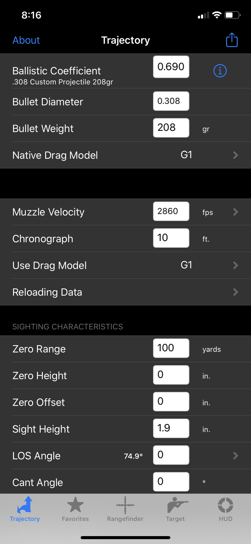

    Went out Friday with my 300 win mag to my local range. Sat down to shoot the 500 yard target, pull up my ballistic app and check dope for 500. App said to dial 2.6 mils, so dial in, held for a little wind and first shot sailed over the target . So I dialed .3 mils down and hit dead center in the plate. Moved on to the 540 yard target, app said to dial 2.8 mil, dialed in on the scope and fired. Same thing, sailed over the target. Dialed down .3 mils and bang dead center.
    I went to check all my data I had input into my ballistic app, everything looked correct but to get my app to line up with what I actually dialed I had to adjust my velocity up to 3100 FPS from 2860 FPS.
    Here is the data I had enter into my app. The app I use is ballistic ae
    Weather inputs are
    Altitude 800, temp 80, humidity 75, baro 30.1
    I have chronographed the rifle and over 5 shot the average is 2864.
    load data for the rifle is
    300 win mag
    Norma brass, cci250 primer
    H1000 77.1 grains
    208 eldm seats at 3.650
    Rifle data
    Trued Remington 700
    26 inch bartlien #4lt bull
    Grayboe stock that is bedded
    Timney 517
    Silencerco harvester 30 suppressor.
    So question is why is my dope so far off from what I actually dialed? I am pretty new to the app I have and I have to be screwing something up. Hope this ramble of a post make since.
    If you guys need more data to help me out that I am missing let me know.
    thank appreciate it 👍

    My first question is baro 30.1? Where were you shooting, Death Valley? Looks to me like you used a corrected barometric pressure instead of absolute pressure.

    I must have the barometric pressure off. I checked it using my app now and it says 29.92. I am located up in Washington.
    This is at my house. Range is at 800 ft.
    I see a G1 BC of .661 for the 208gr ELDM. Since it’s lower, the Ballistic Calc will cause you to
    dial more. However, the I got that .661 number from the Applied Ballistics app.
    Also, if you are using corrected baro, you need to turn off “pressure is absolute”
    Reactions: Mooseknuckles
    The app has the bc lower then what hornady advertises. The list a bc of .690, .696 was a guess off the top of my head.
    Ok I have absolute pressure turn off and the app at 2860 is still telling me 2.86 mils.

    Ok next question, are you using a kestrel or a weather flow? You don’t want ballistic AE to pull the data from the www. For all you know that could be from an airport 150 mikes away. You said you are at 900 feet, but it shows 24? There could be a few issues, but I think your enviro data is part of the problem.

    No I am not using a kestrel. I am pulling weather from the app. That could be part of my issue.
    I am at 24 feet at my house. The range is at 800 feet. It is about 20 miles from my house.
    @shotdown
    Yes 1.9 is correct for scope height.
    ^ this guy nailed the weather portion. If your pulling from a weather app and not your actual location you can expect your data to be off. That holds true even after you establish your real world drop by shooting variable distance in the same weather conditions
    Got it, I could only get your data to line up with a 2.5” sight height.
    Also, when you use station pressure (not corrected barometric) leave the “Pressure is
    Absolute” on. If using corrected barometric, leave that off. I pulled up Seattle Washington in my weather app as an example, and corrected barometric pressure there now is 30.01. I was just trying to get a reference.
