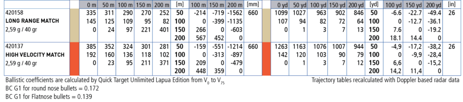

Pretty much everybody I shoot with is using .172 for rimfire BC....see below from SK website...unless you are running flat nose???
If look at what BC actually gets measured from AB's PDM's or good LabRadar data G1's are mostly in the .13x range.
Even the tables above are mixed data, the BC is calculated at 75 (yards or meters they don't say...) but the drops are from their radar data. So the listed BC is inflated for an average.
If you use Lapua's radar data in Strelok you'll still end up with a ~1.9 Mil drop at 100 yards with 1088 fps, same for G1 of .172 or .135, the inaccuracy of it as an average starts showing up at longer distances. Trued SK LRM data for my 16.5" T1x is a 0.135 G1 out to 300 yards.
Reactions: b6graham
.172 is the BC of the ammo at 50yds.
BC changes as the velocity decreases. If you're looking for an average BC out to 200-250, usually .135 or so covers it. At 300+ the BC is around .11.
Reactions: b6graham
