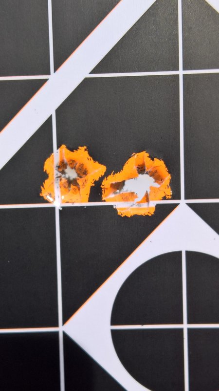

I bought the oracle last fall with the intentions of build a 6.5 creedmor out of it.
First few times out i was not impressed, really crappy trigger, and all i had was crappy scopes. Had trouble getting under 3" with cheap ammo.
Upgrades
- cheap Free-float handguard
- Athlon Argos BTR 6-24 on and ADM mount
- CMC Flat single stage
It was 6 deg F when i shot this group. But i can also hit our small gong, 4" i think, very consistently at 300yds.
This was with Hornady Precision Hunter with 178gr eld-x
I have been very impressed with the results considering i started with a $800 gun.
Thats 3 shots off of a sandbag. (I know its not the special snipers hide group)
Also still shoots like 3" with cheap ammo.
Ryan
