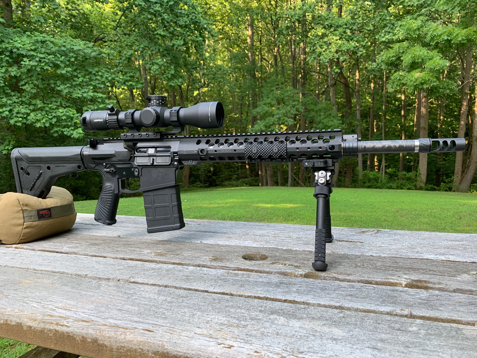

DPMS large frame AR308 Polishing a turd (trouble shooting with solutions)
357Max
  • Sep 11, 2019
    2,552
    3,636
    Marylandistan

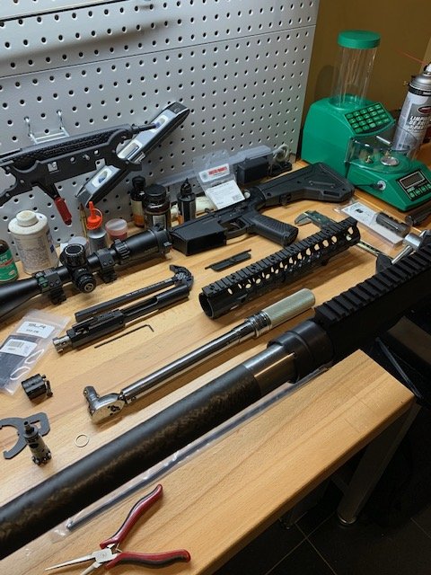

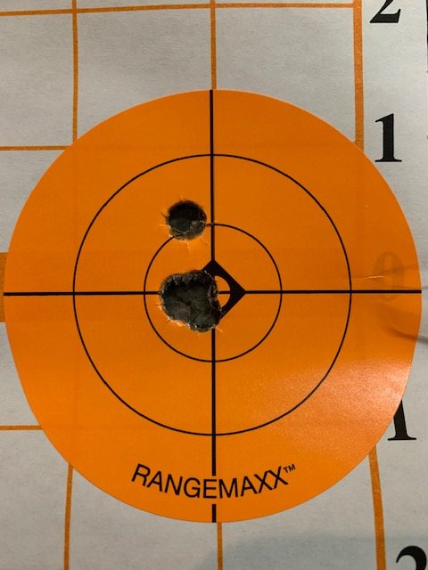

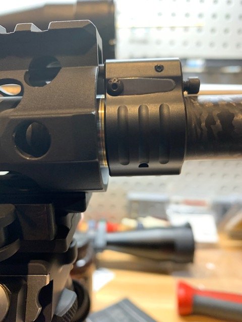

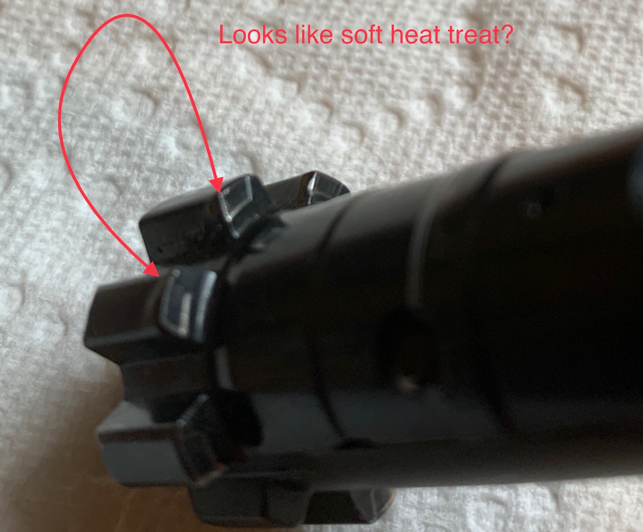

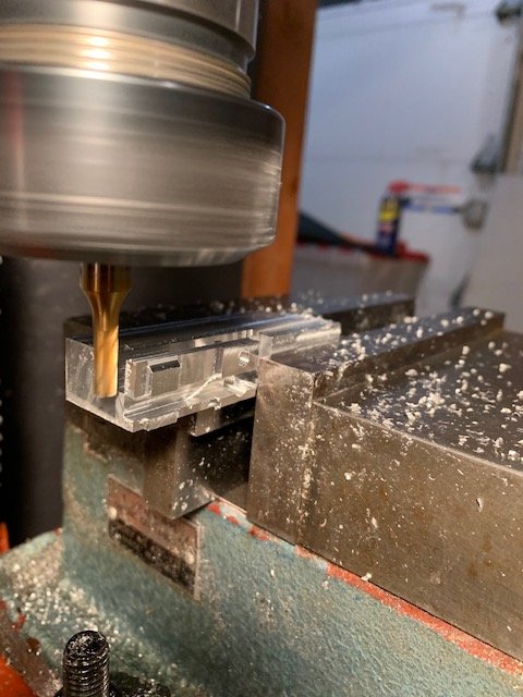

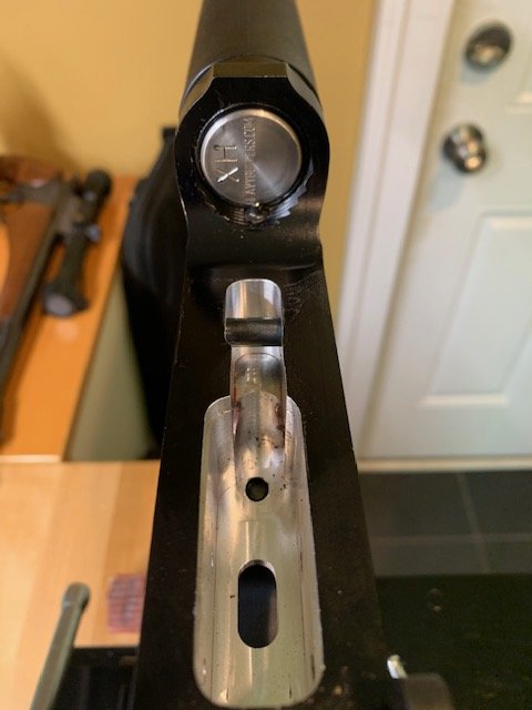

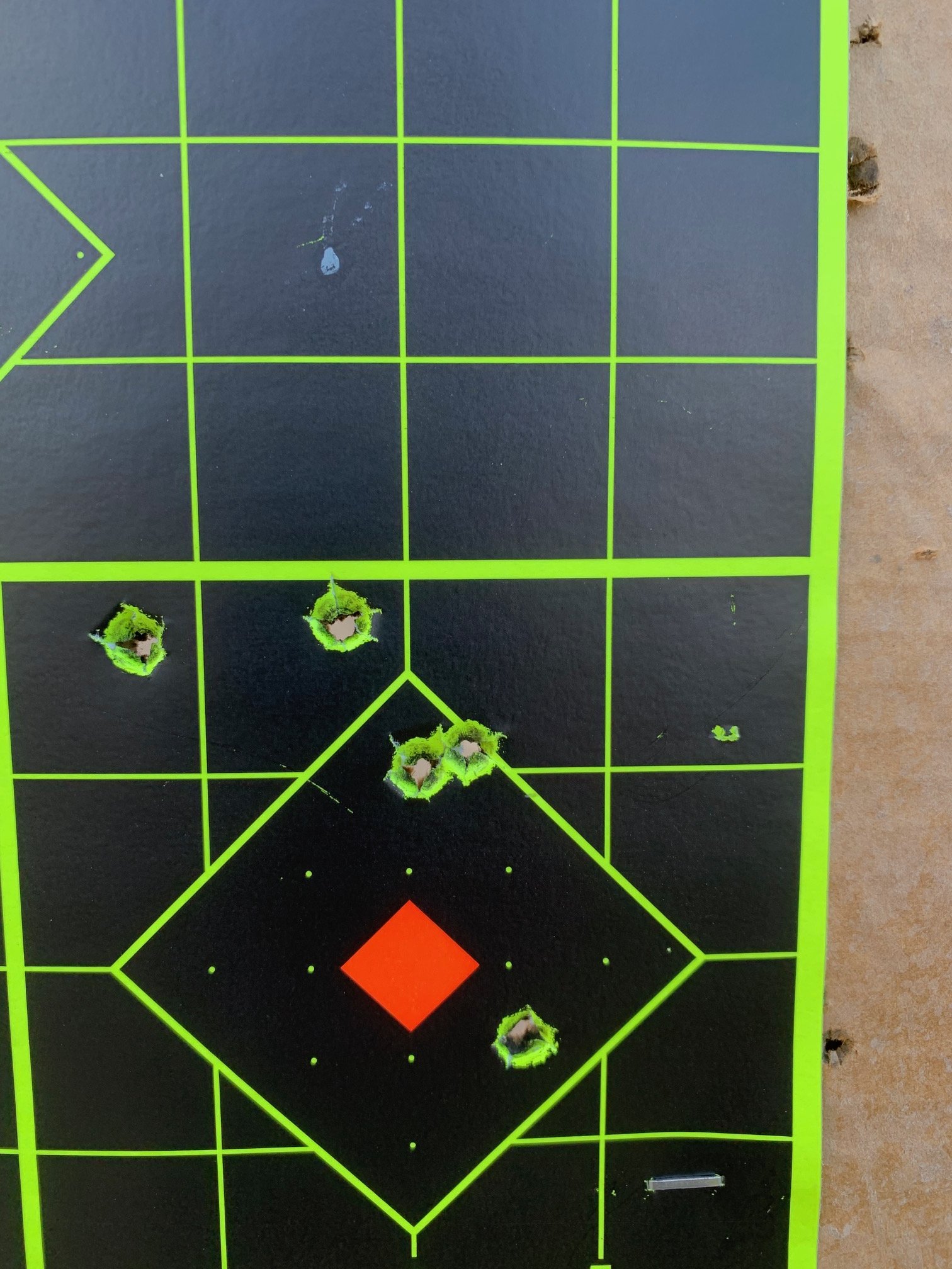

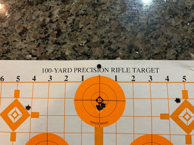

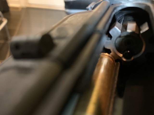

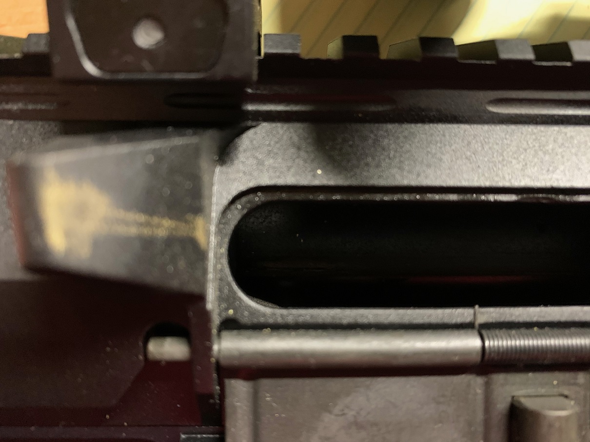

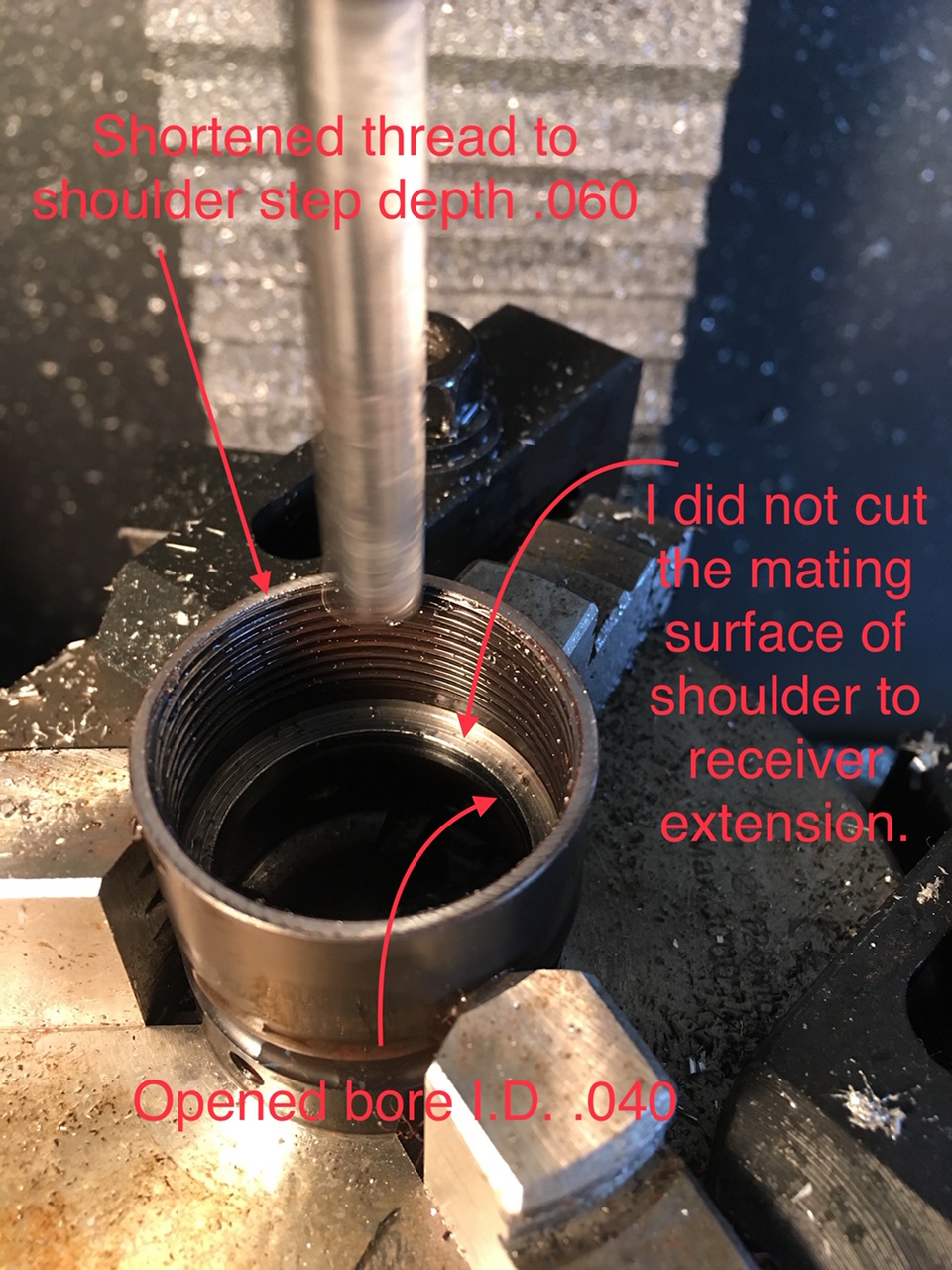

    During this covid lock down I decided to try chasing down the accuracy and reliability issues I've been having with a newly built 80% LR/DPMS 308.

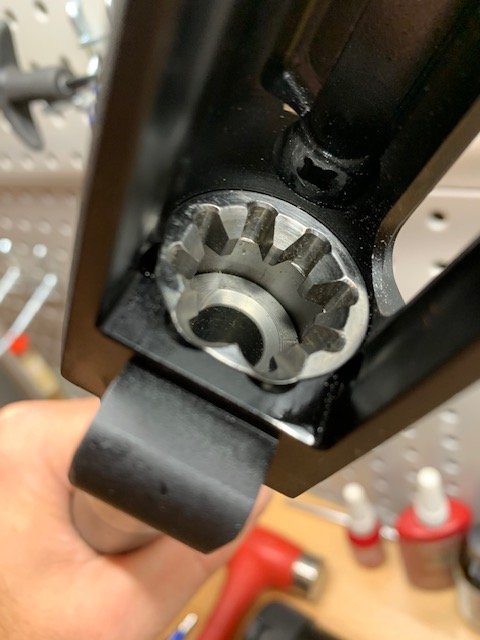

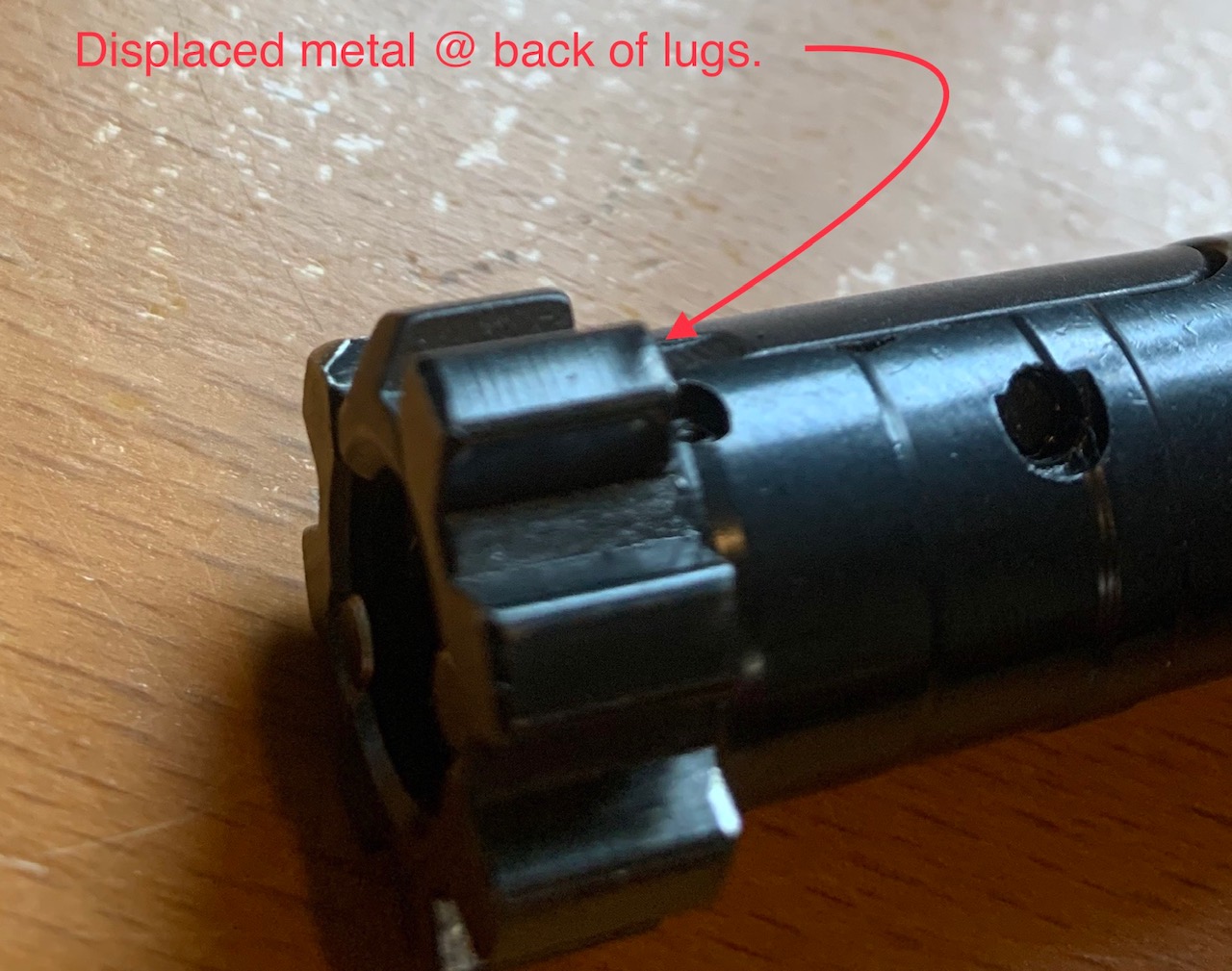

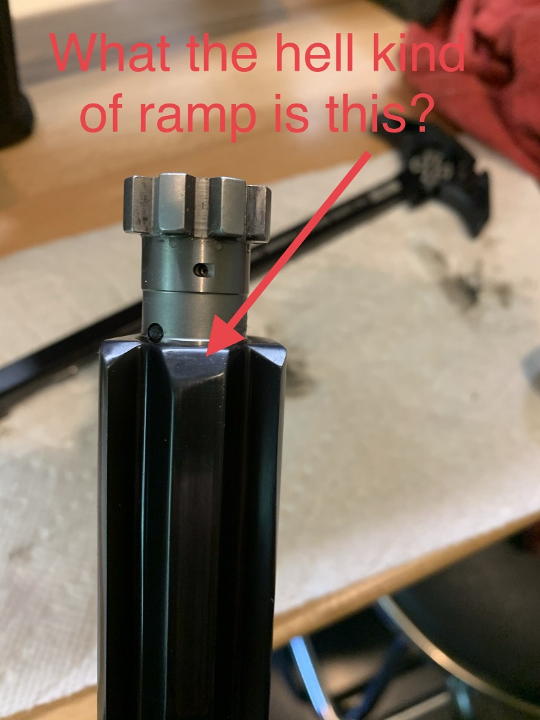

    Initially I started this thread looking for some input on a strange bolt issue. I'm now updating it to be sort of a build/trouble shooting large frame DPMS thread. I've seen so many of these started and never run to ground. This will be soup to nuts polishing the turd!

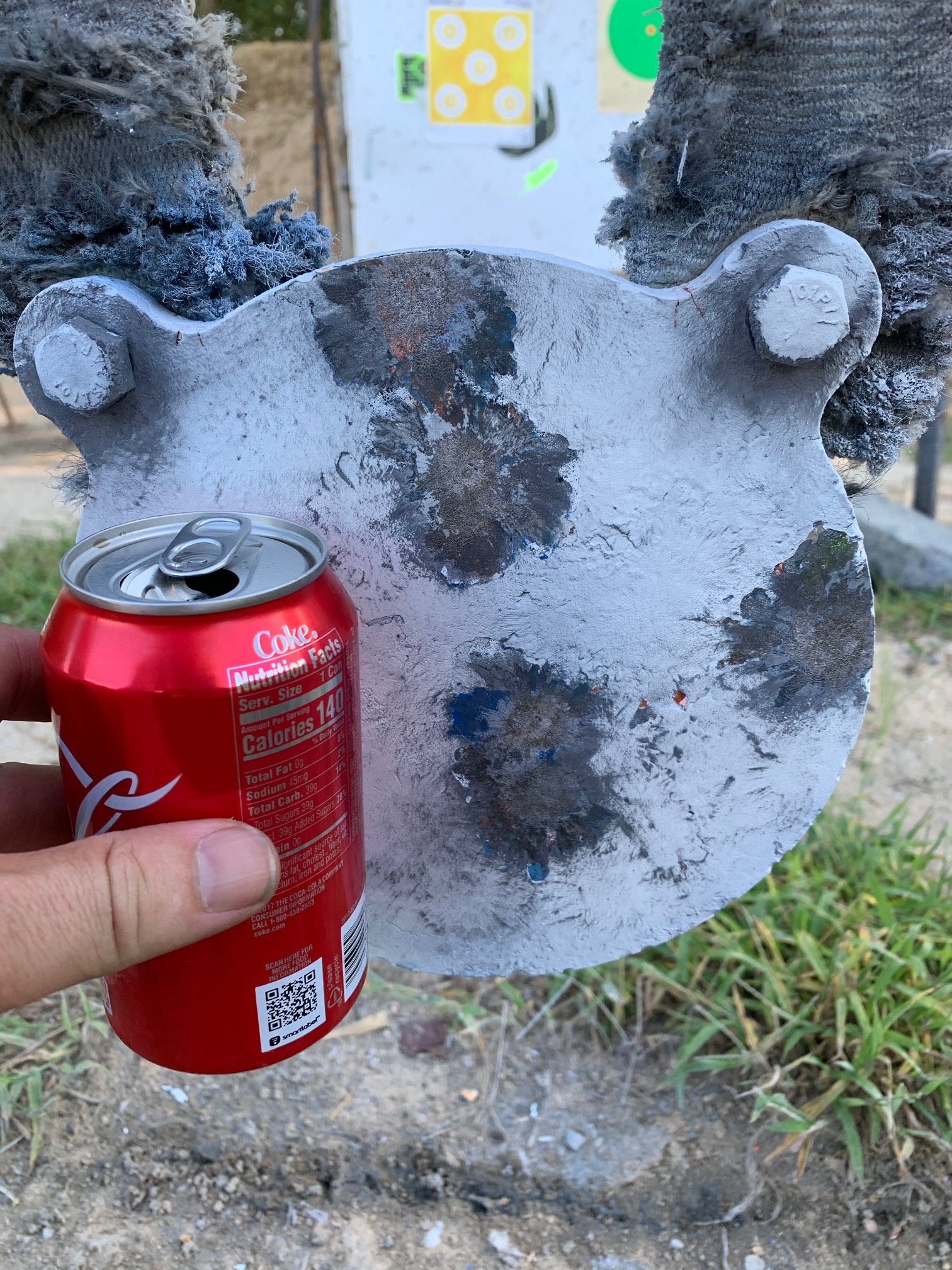

    It shoots a consistent 3-4moa 5 shot group @100YDS no matter the ammo. typically 3 shots will be within about 1.5 moa & then at least 2 flyers (mostly lateral).

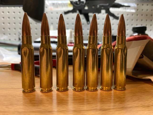

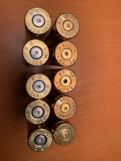

    Tried Win White box 147 to break it in, then FGMM 168, Hornady 178 BTHP, & Lake city M118 173grn.
    Shooting done off bench with Atlas bipod and rear bag.

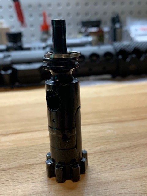

    The reliability issues have been bolt override where the case is ejected & next round is partially chambered & smashed against feed ramps with bolt ontop of case (like a short stroke, but it's not).

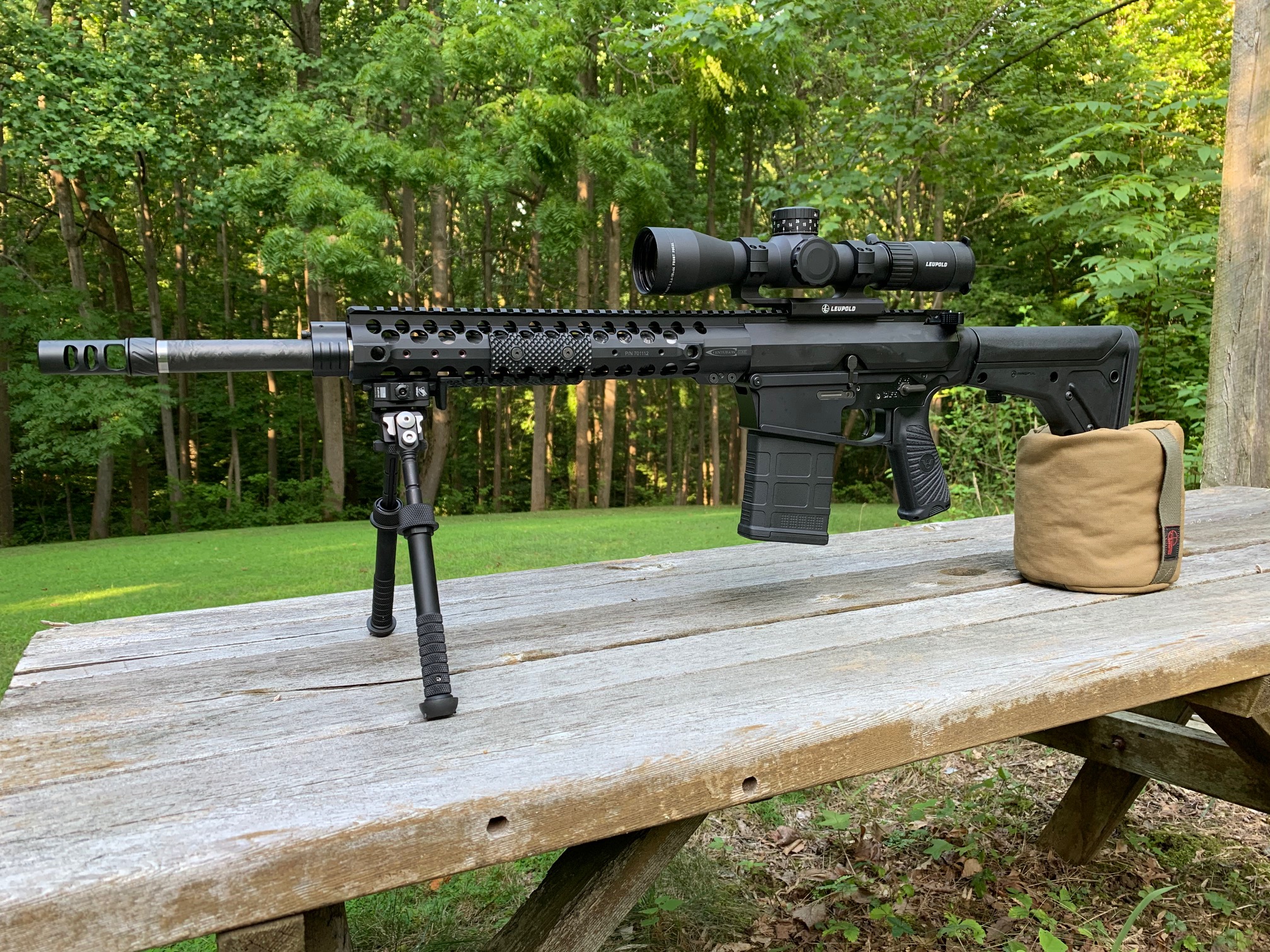

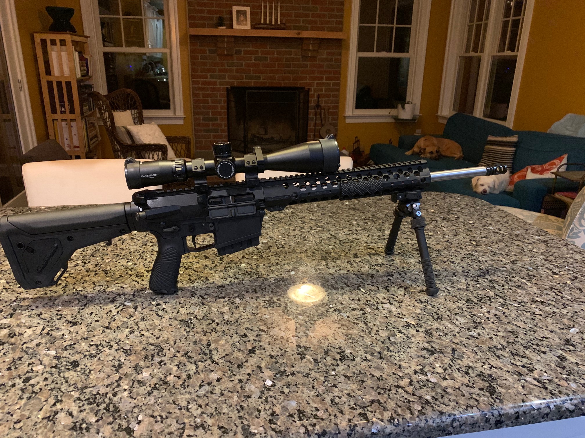

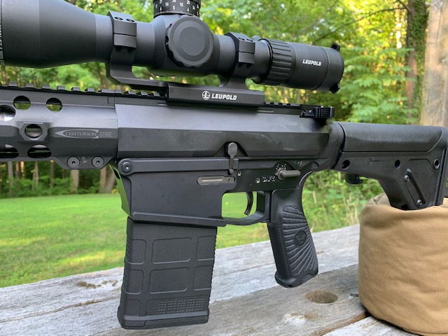

    Build specs: Includes some initial issues (This will be updated as parts were changed).
    LR 308 DPMS Gen 1
    All parts were new.

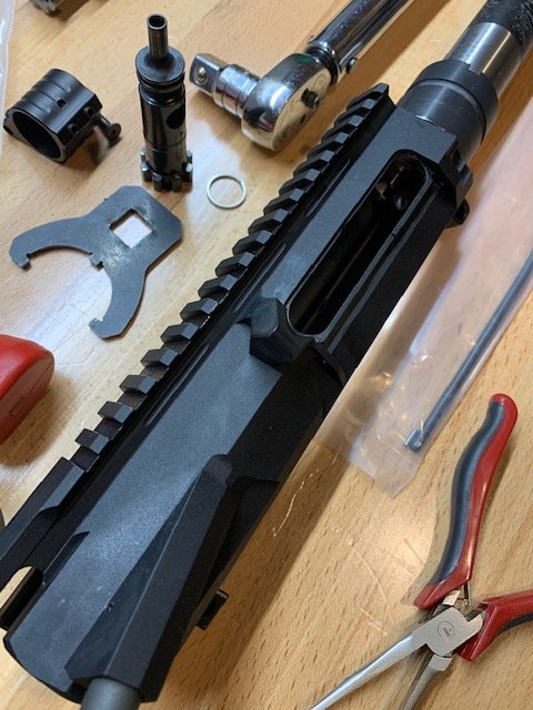

    • American made tactical DPMS 80% lower
    • Davidson Defense LR-308 Billet Upper Receiver .308 Ar (DPMS High Profile Style) This one matches lower and has forward assist in correct location.

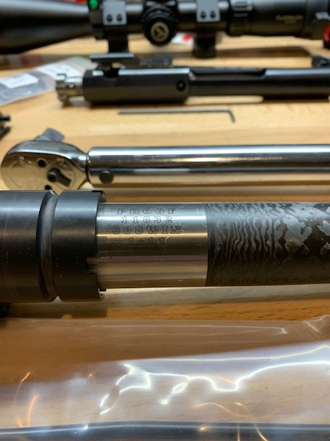

    • Barrel - Bergara 18" 308 Win. 1/10 SS mid length gas with .750 GB, 5/8-24 thread
    • VG6 Gamma 300 BLK 2 port muzzle break with shim kit
    • SLR Sentry 7 .750 adjustable gas block 4 screw clamp on.
    • melonited mid length gas tube from SLR

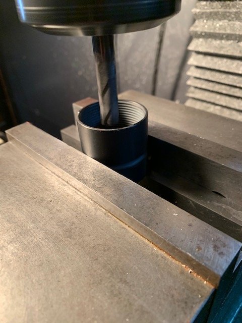

    • Centurion CMR 12" hand gaurd . Barrel nut did not fit over barrel extension shoulder (opened nut ID .040) Barrel nut also bottomed on upper before tightening barrel (shortened barrel nut .060) Makes me wonder about Barrel/extension. Shouldn't have had to modify barrel nut from Centurion?
    • Std upper completion parts (dust cover & forward assist)
    • Aero lower parts kit less FCG
    • Trigger is Larue MBT-2s 2.5lb 1st and 2lb second stage

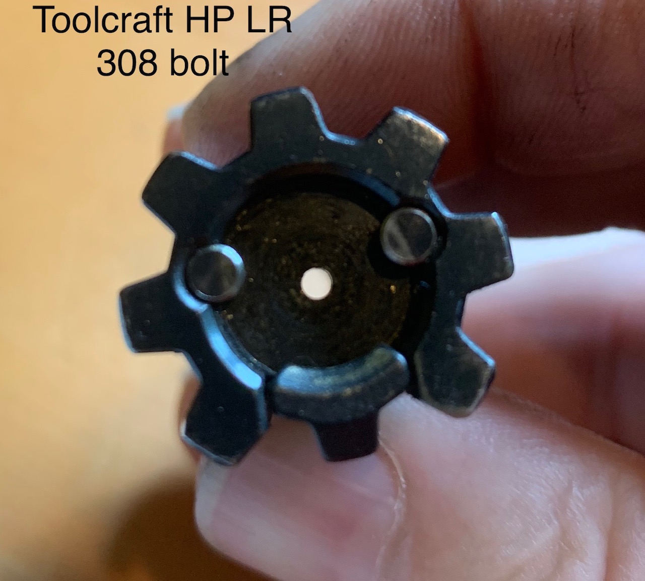

    • BCG is Toolcraft nitrite with small firing pin & double ejector (didn't want double ejector but that's the only way to get small firing pin for 6.5 conversion later.
    • Heavy Buffers XH carbine buffer 8.5oz

    During inspection to try and figure out accuracy issue. I noticed the barrel extension was imprinting the lugs on the bolt.
    I suspect the Toolcraft bolt has a heat treat issue.
    FYI - not bashing Toolcraft I have another one of there BCG's in a 6.8 SPC2 and like it. Their Customer service is very good. I sent them the 2 pics below and they replied within the hour with a return shipping label & said it would be replaced.
    Anyone have experience with this? Do you think the imprint on the lugs not meshing up perfectly with extension would cause flyers?
    The dual ejector BCG was not my first choice, but I wanted the small firing pin & that is the only way I could get it from Toolcraft. I don't think the dual ejectors serve any purpose and may also hurt accuracy.

    Soft bolt is definitely an issue with only 120 rounds thru it. I'd guess that the barrel nut is not fully securing the barrel tightly enough into the receiver. The barrel extension to receiver fit may be sub-par as well. I've found that lapping the front face of the receiver takes a lot of the inconsistencies out as well.....
    At the moment, I also am going to say a soft bolt.
    If the fit was part of the issue, ( or short headspace ) IMHO the bolt wouldn't fit with a loaded round... since it would be to "hardened" to cooperate.
    Any marks on the face of the bolt, or the face side of the lugs ? Pic ?
    Good thoughts so far.
    Yes Bolt is going back to Toolcraft........their CS is top notch.

    Had to cut Centurion barrel nut .060 shorter to keep it from bottoming out when torqued to 75lb.
    Found another target from 6 months ago. Compare to the one above and you can see the pattern (lateral flyers).

    Had to Centurion cut barrel nut .060 shorter to keep it from bottoming out when torqued to 75lb.

    Good choice on using the SLR Rifleworks gas block. Have you adjusted it down to where it barely locks to the rear on the last round? The bolt wear could be a result of the bolt trying to unlock too early.
    That bolt is definitely trash but I wouldn’t put the accuracy issues past the barrel or optic either.
    Yes SLR are a great design, it's set on the edge for 168FGMM 1 click up from intermittent fail to lock back.

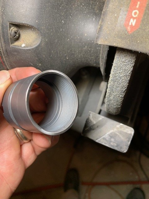

    Below is a picture of my set up in a rotary table to mill barrel nut step I.D. +.040 bigger to pass over barrel extension & same setup shortened barrel nut .060 receiver side as it would have bottomed against receiver before tightening against extension step.
    Extension - receiver fit was not bad, about .001 slip fit hence the Loctite 620. there was not enough room to add .001 stainless shim stock.

    So I took it to range and forgot the DPMS steel 10 round mag I'd previously worked over (polished and tweaked lips). Great now I'm single loading mag fed to avoid the bolt override issue (Fucking Turd is getting fixed come hell or high water). Leaning heavily towards "Rotten Bitch" for it's new name.
    Range report:
    First the good = Brass is now hitting the deflector square and no longer denting the hell out of the neck. The brass stripe shown below was not there before. It use to just wack the neck shoulder junction on the outer edge of the deflector with these dual super fucker ejectors. Were good on that now :)
    Now the bad: Best 5 shot group was about 2-1/4" with FGMM 168's
    Rotten Bitch 308 is getting a new barrel. I'll have to eat Crow if I just suck that bad with a large gasser Stay tuned.
    Proof Carbon 18" 1-11 twist rifle gas with matching JP high pressure bolt inbound.

    New barrel nut has the recessed ring properly located to firmly lock the rail against the receiver when the middle screw is installed. The redesign also uses a better wrench design.
    This new nut also fit over the barrel extension of the new proof barrel (y) It still hit the receiver before clamping the extension. This may be the upper that's a little out of spec so back to the mill to take .040 off.
    After looking at the new brass pattern on the deflector I decided to try making an improvement while I had it apart. Used the old barrel clamped in vise to position the upper in mill and had a go at the deflector. Aligned the notch with the brass stripe that'd been left. Finished it off with a chemical acid etch that turns aluminum Black.
    Mocked up new barrel to check feed ramp alignment with M4 notches in upper. They needed some TLC with the die grinder. Sorry no after picture of this but they align tits now.

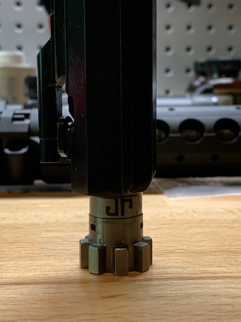

    Almost ready just needed to double check head space and in the process noticed 2 issues.
    • The bottom ramp of the Toolcraft bolt carrier looks like it was machined by a Monkey on a Friday. I'm not going to try correcting this since it's nitrited & I don't think this should effect function.
    • The JP 1 pc gas ring is a complete piece of shit! I swapped it for the 3 pc rings from the old spare parts Toolcraft bolt. Now it will not only not fall out, but will actually support the weight of the carrier. I no the latter isn't mandatory, but it gives me piece of mind.
      1. JP ring is to small. Measured .005-.006 undersized from 3 other sets of rings I had to compare to. JP advertises them as low friction, yeah as in the fucking bolt will fall out of the carrier when turned upside down. IDGAF about friction, they need to seal & these wouldn't have.
      2. There are 2 mechanisms that cause rings to seal. First is that gas gets behind the ring through the gap and expands the ring to the bore. Second is the ring flexes or rocks in the bore as the bolt moves resulting in the edge of the ring sealing. 1 pc rings even if the right size will do neither of these. There's a good reason 1 pc multi spiral rings aren't used in internal combustion engines (hint).

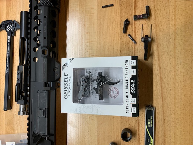

    What the hell, switching out the Larue trigger for a Geissele SSA-E. After having some trigger time with both I much prefer the Geissele. Larue is a good trigger but it will be going in a less precision oriented 350L pistol.
    You may notice in the above picture that the fire control pocket looks a little off center to the left. It is, and that is because I machined the lower in a mill vise, not a 80% jig. I indicated off the front pivot pin location & that is how far off center it was:rolleyes:. It's matters more that the front to back pivot & take down pins + fire control pocket align to keep everything in a straight line without binding. Had I not done this the hammer would have been off center. Keep that in mind for your 80% jigs. Firing pin wear pattern on hammer of this rifle is dead center.
    The new barrel is rifle length gas and .875 so time to fit up the new SLR adj block. Gas port on this proof barrel is .090 BTW. Looks like the port location in the barrel is set to allow for a stock type hand guard so the block needs to be spaced out a little. Since I have a lathe I just made a brass .028 spacer.
    LR 308 DPMS Gen 1 Take 2
    All parts were new.
    • Barrel - Bergara 18" 308 Win. 1/10 SS mid length gas with .750 GB, 5/8-24 thread Proof Carbon 18" 11 twist rifle gas .875 GB 5/8 x 24 thread
    • VG6 Gamma 300 BLK 2 port muzzle break with shim kit Heathen .30 cal 3 port self time brake.
    • SLR Sentry 7 .750 adjustable gas block 4 screw clamp on. SLR Sentry 8 .875 AGB set screw style.
    • melonited mid length gas tube from SLR Aero rifle length melonited tube.
    • Centurion CMR 12" hand guard . Barrel nut did not fit over barrel extension shoulder (opened nut ID .040) Barrel nut also bottomed on upper before tightening barrel (shortened barrel nut .060) Makes me wonder about Barrel/extension. Shouldn't have had to modify barrel nut from Centurion? New barrel nut cut .040 to clear receiver.
    • Trigger is Larue MBT-2s 2.5lb 1st and 2lb second stage Geissele SSA-E 2 stage 3.5lbs
    • BCG is Toolcraft nitrite with small firing pin & double ejector JP HP small firing pin bolt, swapped gas ring to 3 pc.
    • ArmaLite #EA1095 rifle length buffer spring
    • Magpul UBR Gen 2 stock with A5 length tube
    • Noveske branded Geissele super charging handle
    • Wilson Combat/BCM mod 3 grip
    • trigger shims.com for front take down pin - lower shimming
    • DPMS 10 round steel mags, Magpul 10 rnd mag, Magpul 20 rnd mag, & Magpul 25 rnd mag. Note: there are slight differences between the magpuls.
    • Athlon Ares BTR 2.5-15 x 50 in Eotech rings Leupold MK 5 3.6-18 TMR in Leupold mount.

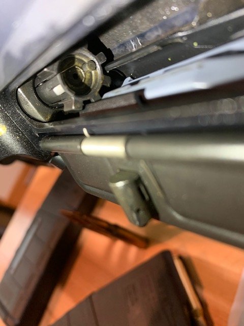

    Rotten Bitch is Done, well almost. There's still the reliability to tackle.
    First range outing. The Rotten Bitch was destroying 1 out of every 3 rounds so I had to load mags single round mag fed.
    1st pic is first 5 rounds out of barrel FGMM 168 MK 100yards for zero shot on left is first, far right is second (oops I went 3 mil right instead of 1.5), center is next 3 after 1.5 mil back left.
    Next 5 rounds out of the barrel .1 mil up @100yards
    No more 2.5 - 4 moa bullshit. Rotten Bitch shoots now.
    Stay tuned for reliability fix for this Whore.

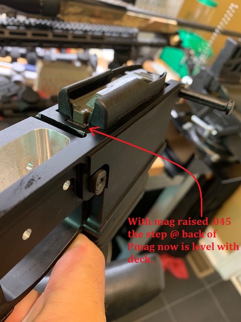

    I can’t comment on any of the other issues you’ve been having but this caught my eye-
    “The reliability issues have been bolt override where the case is ejected & next round is partially chambered & smashed against feed ramps with bolt ontop of case (like a short stroke, but it's not).”
    I had a DPMS 223 factory lower that was doing this very same thing and it drove me nuts.Every second or third shot, it would hang up just as you described and no matter what parts I swapped in and out, it kept happening. I had enough swapped parts in the end to build a new rifle, which I did on a different receiver and it performed flawlessly. Stumped I had two different smiths check it out and were of no help. After telling a friend of my issues he checked it out and compared it to his rifle and in about three minutes he says “your bolt catch is too low.”
    So he takes a mag and inserts it into his lower and marks it with a pencil where it’s sitting in his rifle, he then takes the mag and puts it in my DPMS lower and you can see it’s sitting low in the receiver. I get a new receiver, not from DPMS and take out all the parts from the DPMS and move them over. Flawless performance.
    This may or may not be your feeding issue but it’s worth looking into.
    I kind of thought the same thing, and then looked at the build list.
    80% lower...
    I have seen this very issue with a few AR10 platform 80% lowers. The mag catch itself can be on the small side and the inlet in the receiver for the mag catch can be too low from the deck to hold the mag high enough to reliably feed rounds from the mag. Higher quality parts kits will contain full size mag catches and the receiver inlet and be milled slightly higher, then epoxy bedding the lower portion of the inlet in order to raise the location of the mag catch.

    The odd thing is that with the changes to rifle gas @ same barrel length etc, reliability got worse. Rifle gas Should've delayed unlocking even with std Armalite spring. That particular spring was reccomended from Slash aka Heavy Buffers.

    Before I get into the reliability trouble shooting I think it'd be worthwhile to discuss a few things related to 80% receivers for these large frames.
    Building one of these is a challenge plain and simple! If you don't have access to the proper equipment & skill set I don't recommend starting with a large frame 80%. It is very important to have a good fundamental understanding of the large frame operating systems & how they interact before attempting one.
    I've never seen all the possible large frame 80% quirks itemized in one place & keep in mind this is just for DPMS gen 1 & just as it relates to lowers.
    Here goes:
    • There is no mill spec!!!!
    • The original Armalite AR10 was not an adaptation or scaled up version of an AR 15, the AR 10 was actually designed first.
    • There are multiple receiver patterns that don't play well with each other. Example Armalite vs DPMS etc. This includes receivers of the same pattern that don't play well. The lower 80% receiver used for this build (American made tactical) is a DPMS gen 1 & it does not fit well with an Aero upper for example. I selected the Davidson defense LR 308 upper because it matched the lower in width across fire control pocket & it had the forward assist in the correct location to actually function (many do not).
    • Prior to machining I scoured the internet for a DPMS blueprint. What I found was 3 different versions for DPMS gen 1 (Swell)!
    • There are 3 different locations for the fire control group (trigger pins & safety selector) measured from the front pivot pin center line.
    • There are at least 2 different locations for the bolt catch location.
    • Although pre machined, I found 3 different locations for the mag catch measured from the deck of lower (all supposedly for the same mags).
    Prior to machining this 80% I discovered the above. I'd purchased 2 x 80% billet AR 15 lowers from American made tactical (AMT) and sent them both back because they were out of spec. Rear take down pocket was to wide (never would have been able to get slop out). AMT forged 80% AR 15 lowers are GTG.
    So how do you check spec when there is none?? How do you know your fancy 80% jig has shit located in the right place??
    Answer to both is you don't.
    I chose to abandon the idea of using the 80% jig. Instead I mocked up the upper with my BCG and took dimensions to figure out where the trigger pins needed to be to have the hammer square to the firing pin when struck. I then compared the required location to the existing safety detent hole pre drilled to see if it would work (it did).
    To machine it I chucked the lower in a mill vise that was indicated to the table on the X axis. The AMT DPMS lower does not have the rear pocket pre-milled so I indicated from the front pivot pin center line in both the X & Y axis. I then discovered the AMT lower was actually machined a little off center (bastards), but determined it was not enough to cause any problems if I aligned everything. What was off center was the front pivot pocket, mag well, buffer detent hole, & buffer tube threading. At least they were all aligned with each other so I machined the fire control pocket & rear take down pocket in that same plane.
    To sum up the above, had I thrown this thing in the 80% jig it would have been a wreck.
    If your not prepared to go to this level of checking then I'd recommend purchasing a matched upper/lower & purchase the jig from the same company selling the lowers. At least that way you may have some recourse if it's FUBAR.
    Reactions: LRRPF52

        • under gassed caused by one or combination of; miss aligned gas block, undersized port in barrel, improper length gas tube, improperly adjusted gas block, bad gas rings on bolt, loose gas key on bolt carrier, out of spec bolt carrier gas run bore or bolt tail bore.

        • attempted fix open SLR block for full gas. Still malfunctioned, but oddly seamed a little better. (Under gassed ruled out!)

    The next logical thing to focus on as Keel Haul pointed out was the mag catch. I dug out my folder from the lower machining and the mag catch location was within the spec of the 3 different locations, but on the lower end. I found a .045 variation for the mag catch location across 3 different blueprints WTF.
    Even though it was "within spec" I honed in on this as the culprit & compared bolt - mag mesh of my small frame AR to this DPMS.
    As you can see in the pictures below the small frame 6.8SPC bolt lugs sit well below the mag feed lips and the DPMS did not that "Rotten Bitch"
    Hard to believe nobody makes anything to fix this?
    Found a hunk of 7075 T-6 in the garage, time to get busy!
    I'll bet money this is a more common problem then people realize, so it's hard to believe no one is making stepped mag catches. I'd have gladly paid for one & a simple file would be all that's required to modify the lower.
    I chose to machine the new mag catch to step up .045 putting it about .010 above the high side of spec. I find it curious that when installed the Magpul step at back of mag now is perfectly level with the deck of lower. This would be an easy check to diagnose this problem.
    Bolt now gets a good purchase on back of case head.
    If you don't look to close it'd be easy to miss the modification.

    Aguila 7.62x51 150grn Hecho En Mexico............. Terrible reviews for FTF, horrible accuracy, filthy etc perfect pile of shit to test with right there!
    40 rounds through 4 different mags including a 10 round rapid fire at steel @300yrds zero issues with gun. Ejection pattern in a nice pile @ 4:30 & no dents in brass Fuck yeah!!!
    The Aguila lived up to it's horrible reviews. Brass soft as butter, filthy, horribly inaccurate, and 1 pierced primer!
    Just look at the fucked up case heads of the Aguila compared to FGMM case heads. The ejector swipes on the Aguila raised a bur (not a scratch on FGMM) & what the hell are the primers (Brass cups?). The center Aguila is the pierced primer. That crap isn't even re-loadable in my opinion.
    Another fun fact is the case heads of the Aguila measure .4675 vs FGMM @ .470 so the Aguila would make a low mag catch issue worse.
    It's a "Sexy Bitch" now!

    FWIW, the upper and lower are.both the same brand, and forged. I'm gonna give it a shot. I may have to revisit this thread, hopefully it won't put up too much of a fight. Thank you so much for documenting your journey. I'm certain others will find it helpful.
    Quick update. Gun is now at 70 trouble free rounds & it likes FGMM 175's.
    I may put the tungsten back in the buffer to bring it back up to 8.5oz. Never really found a good explanation for tuning buffer weight. I'm thinking it may help a little to spot shots. I'm sure there is a trade off between slightly softer recoil vs heavier reciprocating mass.
    Any of the AR experts @padom have an opinion on this? I'm thinking it may help a little to spot shots at higher magnification.
    I may upgrade to an Atlas Cal & I wonder if I'm leaving anything on the table with the SSA-E? For now I'm sticking with it, and will just work on learning to drive it better.
    100 yards zero check with 175's
    500 yards & Think this plate is 8" could be 10" & not much wind 2- 3ish from 10 o'clock. held left 1/3 Scope @ 12x with 3.8 mil elev.
