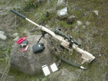

Thin Pro 12" Inch Length Free Float Rail Semi Smooth For 308 on order for mine, have been running standard full tube with Harris stud and Seekin's rail/sling mount at 9 oclock.
Haven't noticed that i need a full 360deg & lenght rails, and paying x2 the price for most just because it's a 308 tube sickens me. the Thin Pro is under $99 and will give it a try. I would run a carbine length tube if i didn't think i would crush the gas tube somehow.
Apex one looks nice: Apex 2550 Handguard 308 DPMS GatorGrip Mid Length AR10 SR-25 Forearm
