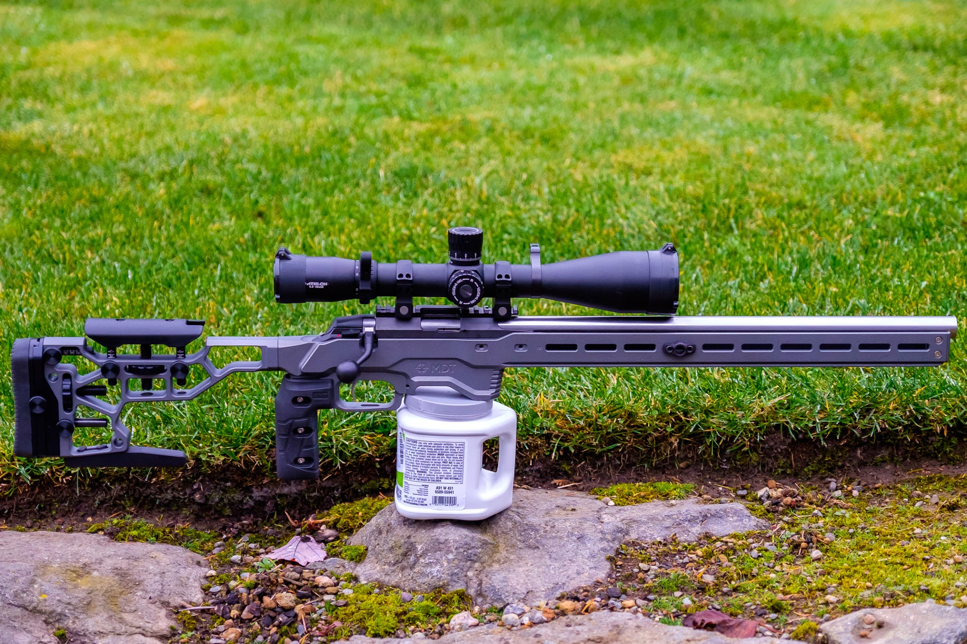

    Perhaps the new MPA Matrix chassis should be a contender? It has grip interchangeability.

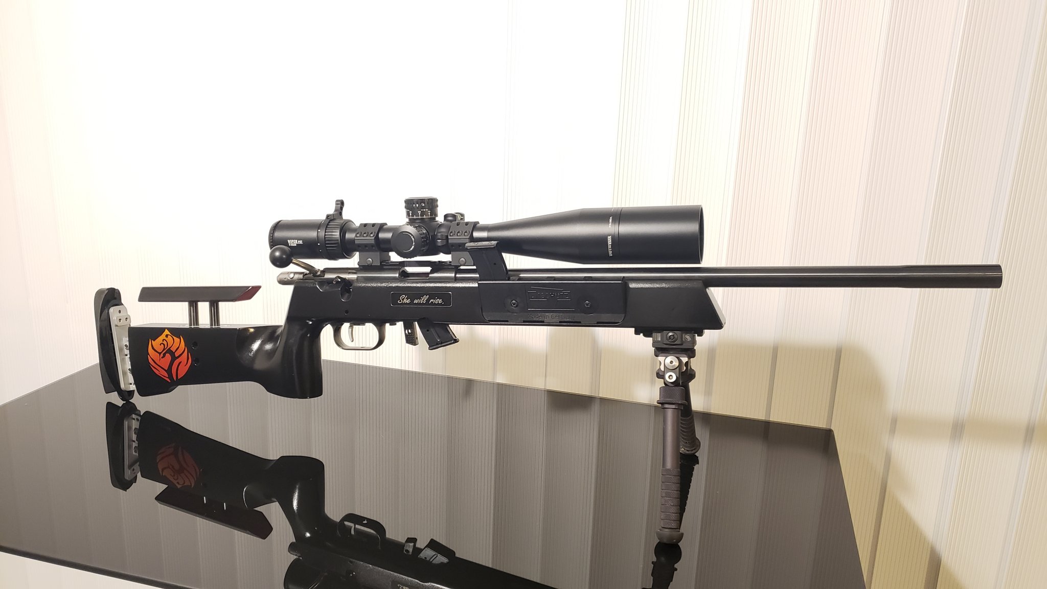

    I went with an Izhmash Biathalon in an ARS chassis with an SWFA 3-15 DM reticle scope. Really fast, smooth and accurate. I just have to learn to shoot from all the weird positions, can't blame the gun. To me it's my idea of an ultimate setup.
    that’s really cool. Have you posted about it here on the Hide?
    Would love to see some groups and read more about it.

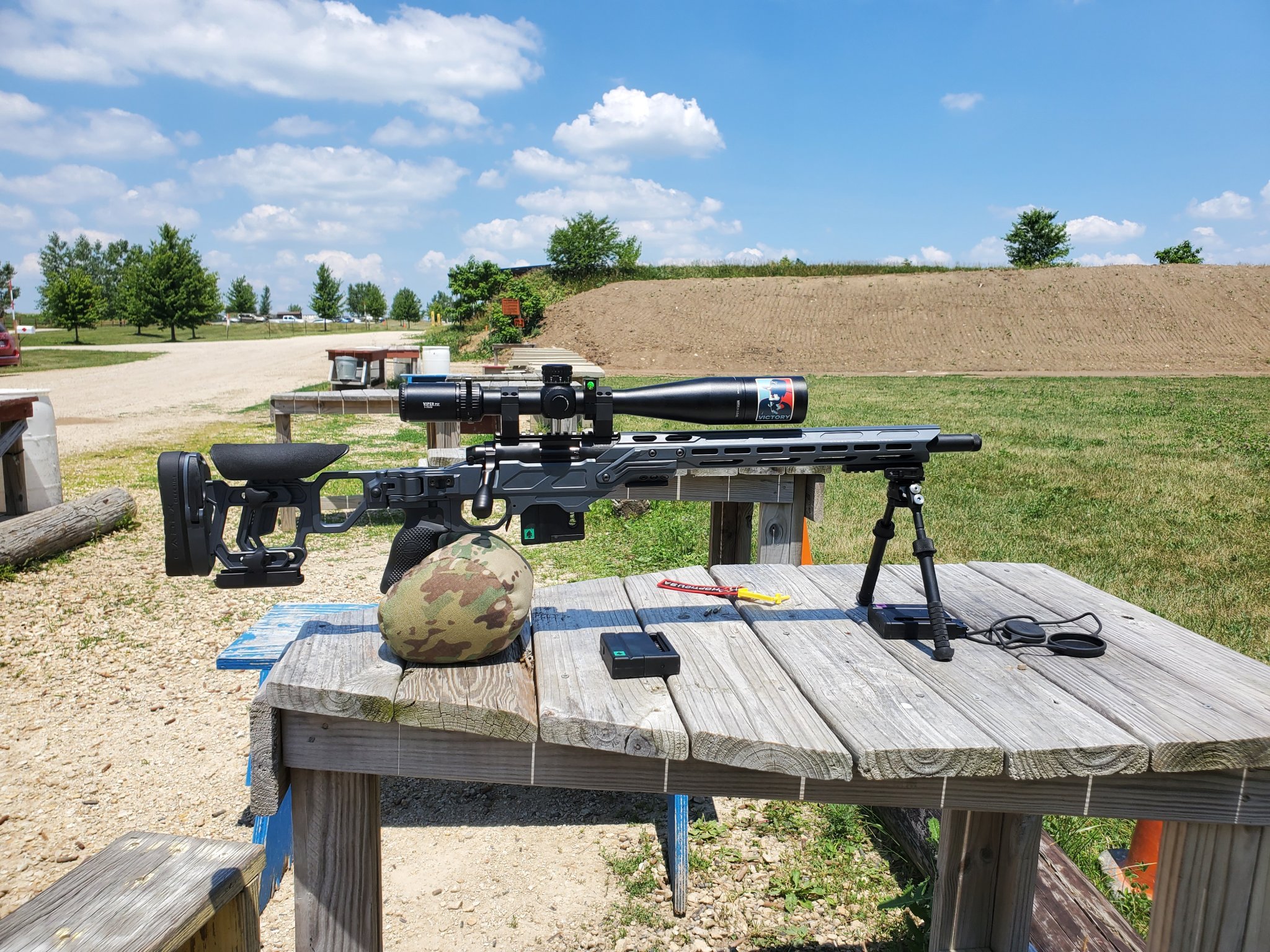

    I'm partial to the Bravo. I think you've used it as well. I have zero experience within other chassis except my TacA1.

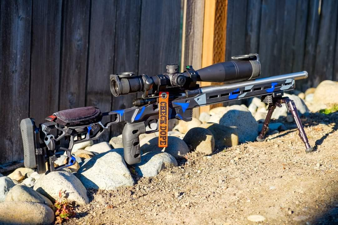

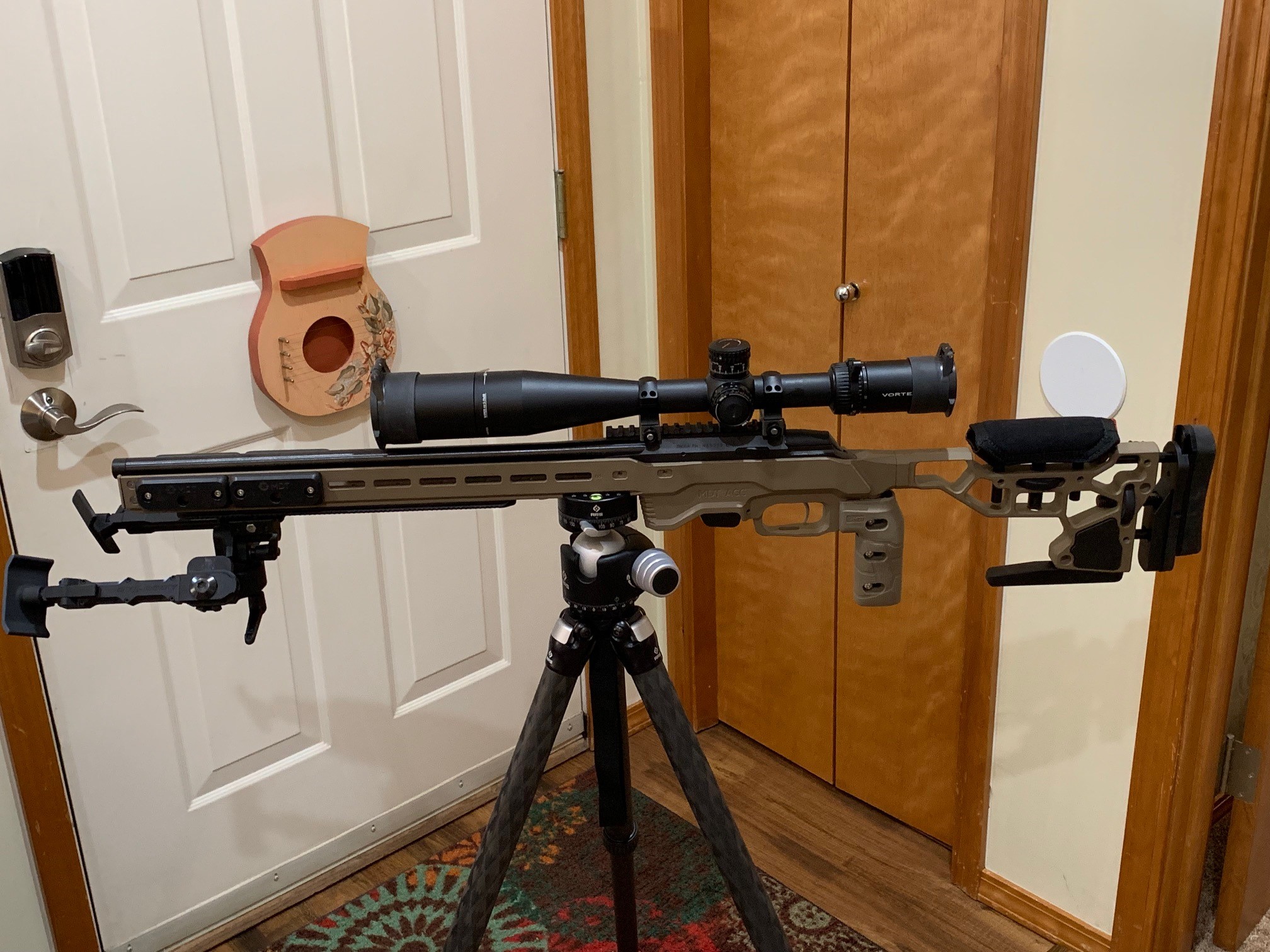

    @littlepod have you tried adding weights to the front of the ACC to help balance it out? I know my friend runs two weights up front and not the weight in the buttstock and his balances right in front of the magwell. Pic shows before he removed rear weight, also he has factory barrel so you may only need one weight each side.
    Thanks my Tikka in an ACC requires a few more weights up front.
    I have a 20" bull barrel so significantly heavier than the factory barrel, but the balance point is at the mag well. This is w/o the rear weight, and swapping the buttplate to aluminum instead of the default steel.
    If I put a heavy bipod like in your picture, then I would be balanced, but bipods catch on barricades/cargo nets, so I'm usually running those stages w/o one. I believe I need 4 front weights to get the balance perfect sitting right in front of the mag well (with my heavy barrel).
    Picture below has the balance right now about the mag well.
    Reactions: K80/6.5

    Definitely looks sweet, but I'm concerned that it may be too rear-heavy for optimal balance on a bag.

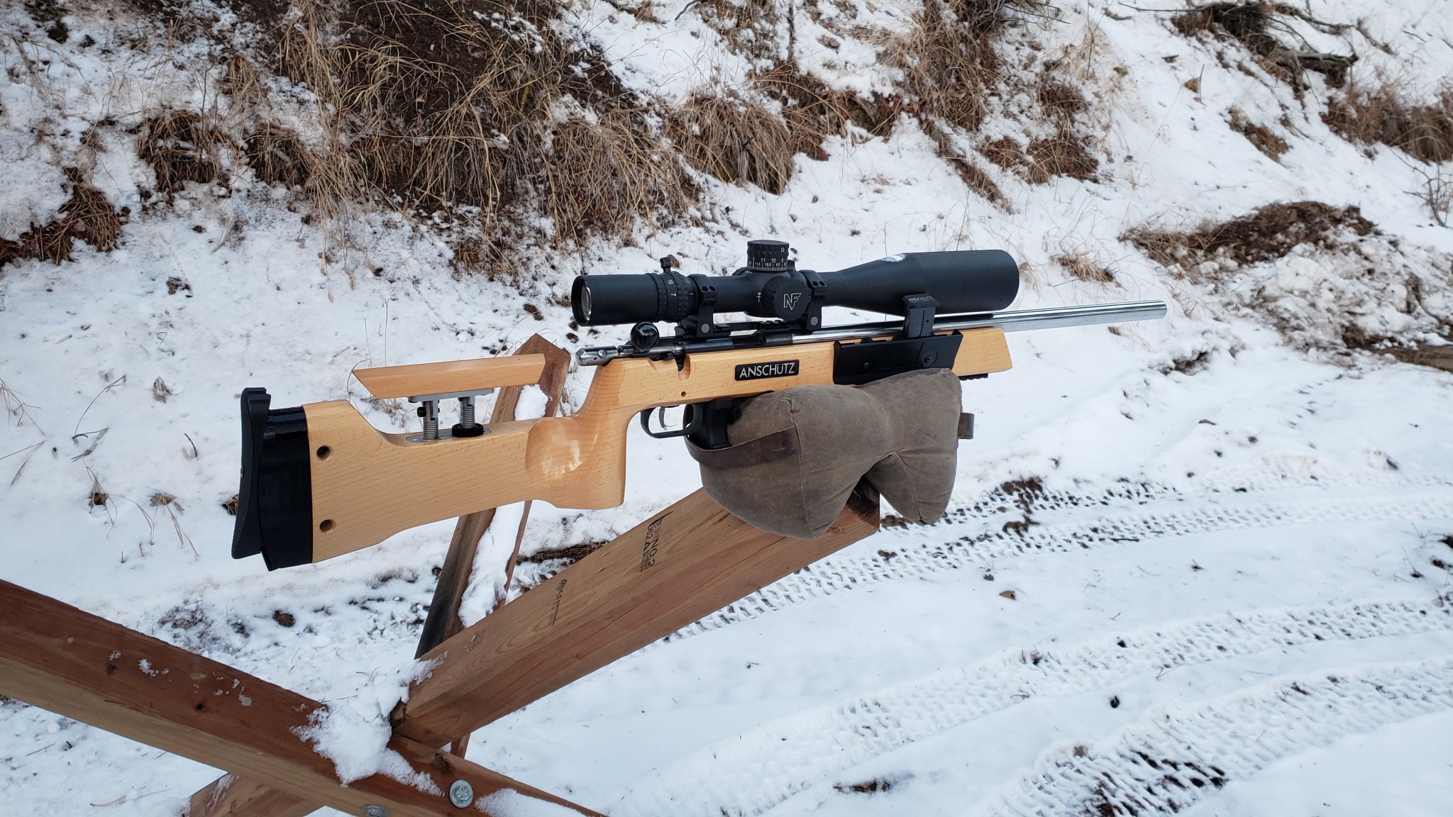

    Got my ultimate 22rf comp rifle alreadyView attachment 7252261View attachment 7252265!
    Anschutz Fortner 1827F with a custom fitted steel mount on top.
    Could have a heavier barrel but the rest is good. Done a lot of winning with this one.
    Might have to consider adding a ARCA swiss rail so I can slide the bipod back and forth easy.
    She's a beaut!
    Yes, I think you'd like a heavier barrel.
    I considered an Arca rail, but so far I'm fine with the Anschutz rail. I can't move things on the clock, but can before the stage. Haven't moved my bipod in a year now. I just shoot so much from a bag, e.g., 55gal barrel upright.

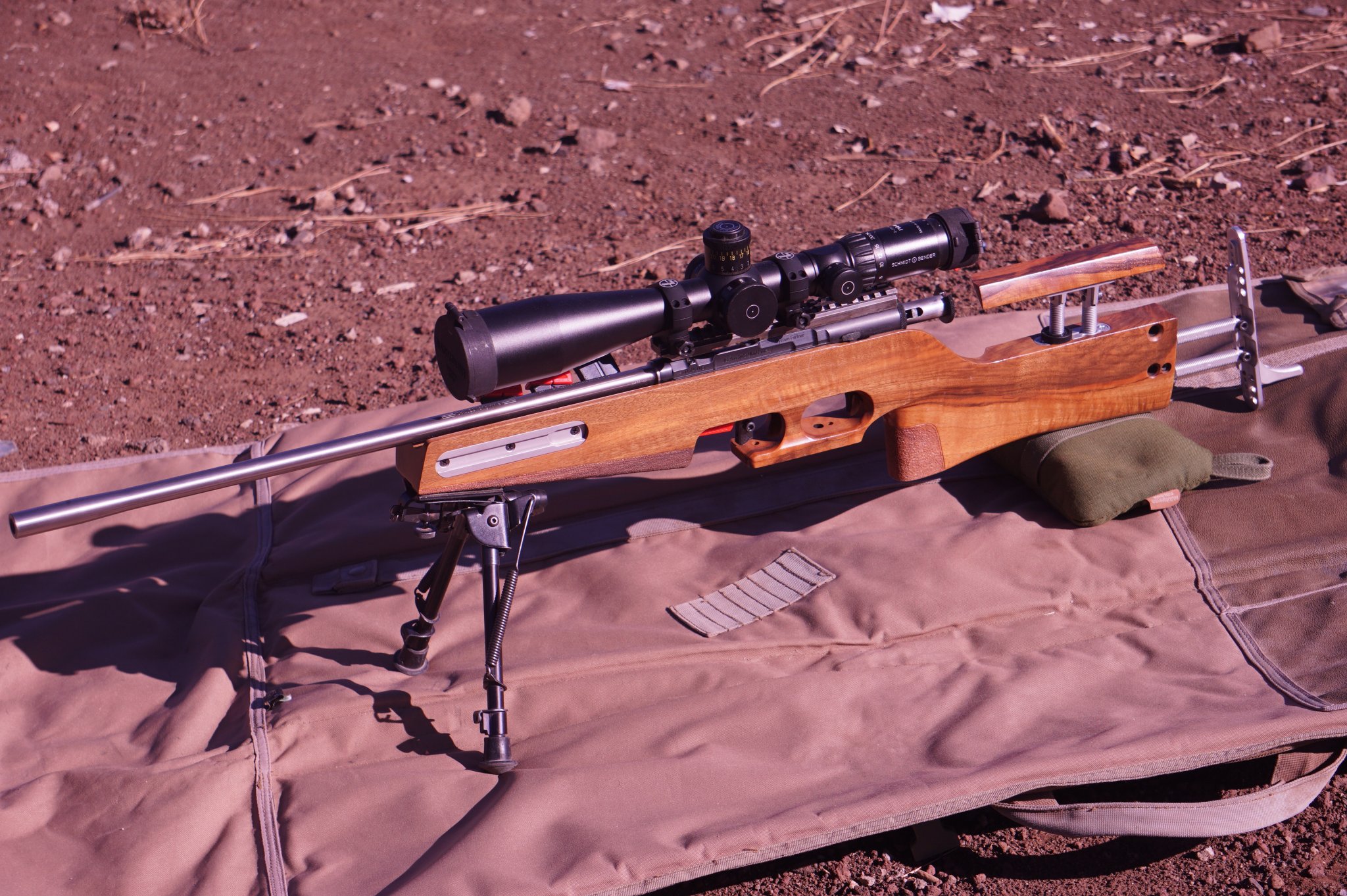

    As to Op's dream rifle, I did a lightweight rifle here : https://www.snipershide.com/shootin...-barrel-and-stock-build.6981016/#post-8275091
