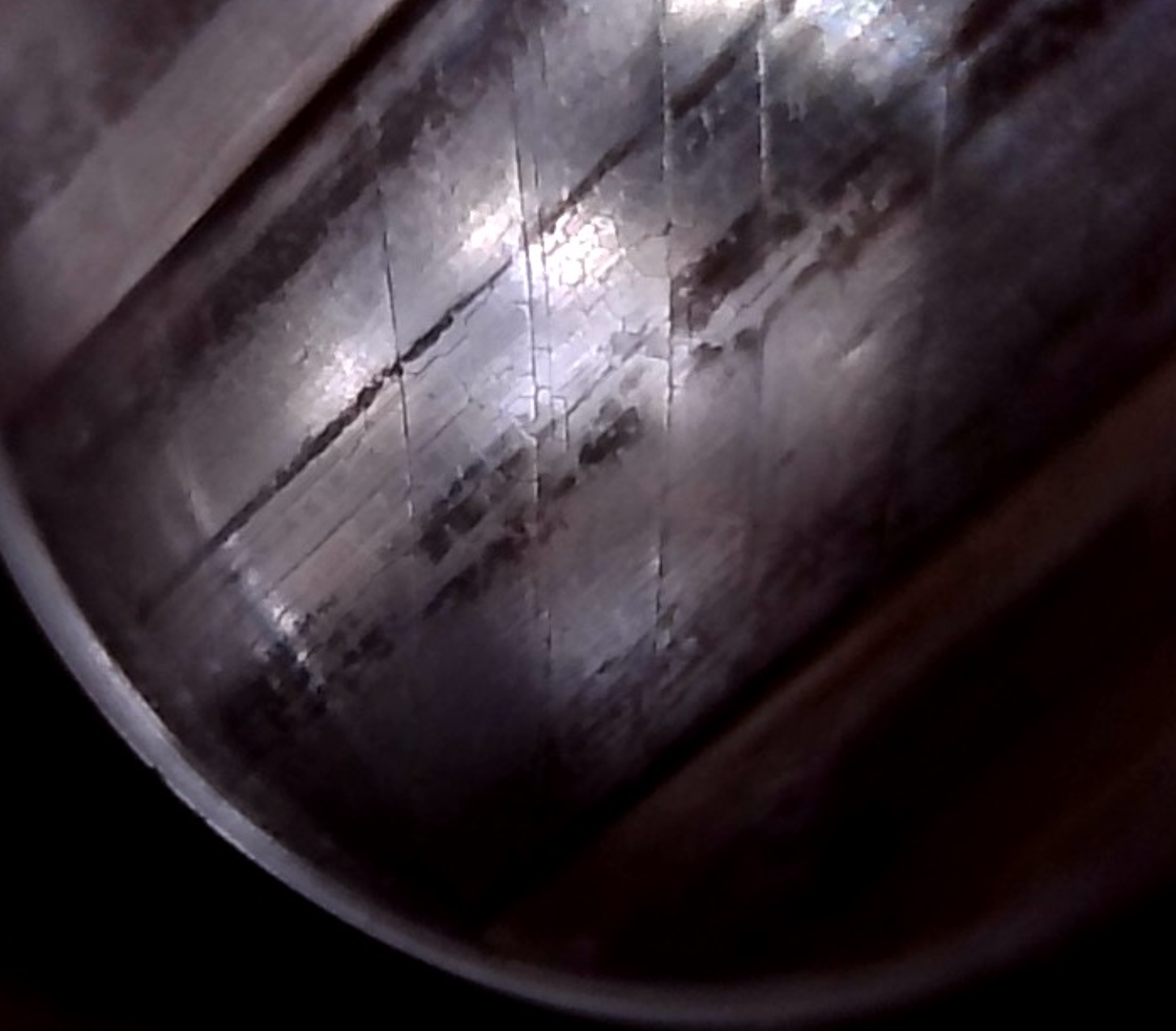

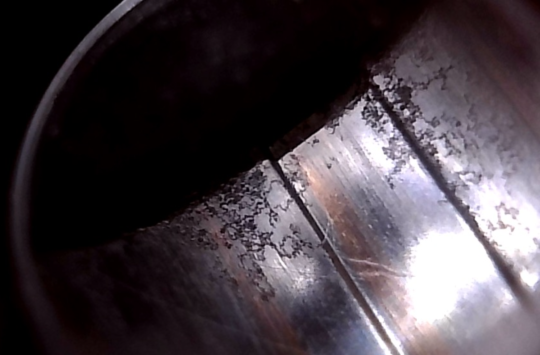

OK, well wondering if I can smooth something out like this, might shoot a little better. Seems like a power tool would add that extra mechanical elbow grease. I see your point however.

Not sure what those lines against the rifling are but they shouldn't have been made by bullets so jamming a drill in there probably wouldn't hurt anything. LOL Seriously though I would try some Tubb Final Finish or TMS bullets before jamming a drill in there.

^^^ This! I would try fire lapping before a drill and a brush.

Really, what made those lines across the rifling would be my first point of interest.
Can't explain the "lines", but the rest looks like typical fire-cracking in the throat-if that's the case you're not doing anything about it.
That's what "wears out" rifle barrels- it ain't the rifling a foot down the barrel.
What section of the barrel was this taken?

LOL Nope, though I have done plenty of dumb things in the past, actually have not made a move yet. My guess is those lines are from tooling? Got that gun used, shoots ok actually. That barrel is on a Tikka.
Those lines go for ten inches along the barrel starting near the chamber, strange stuff.
