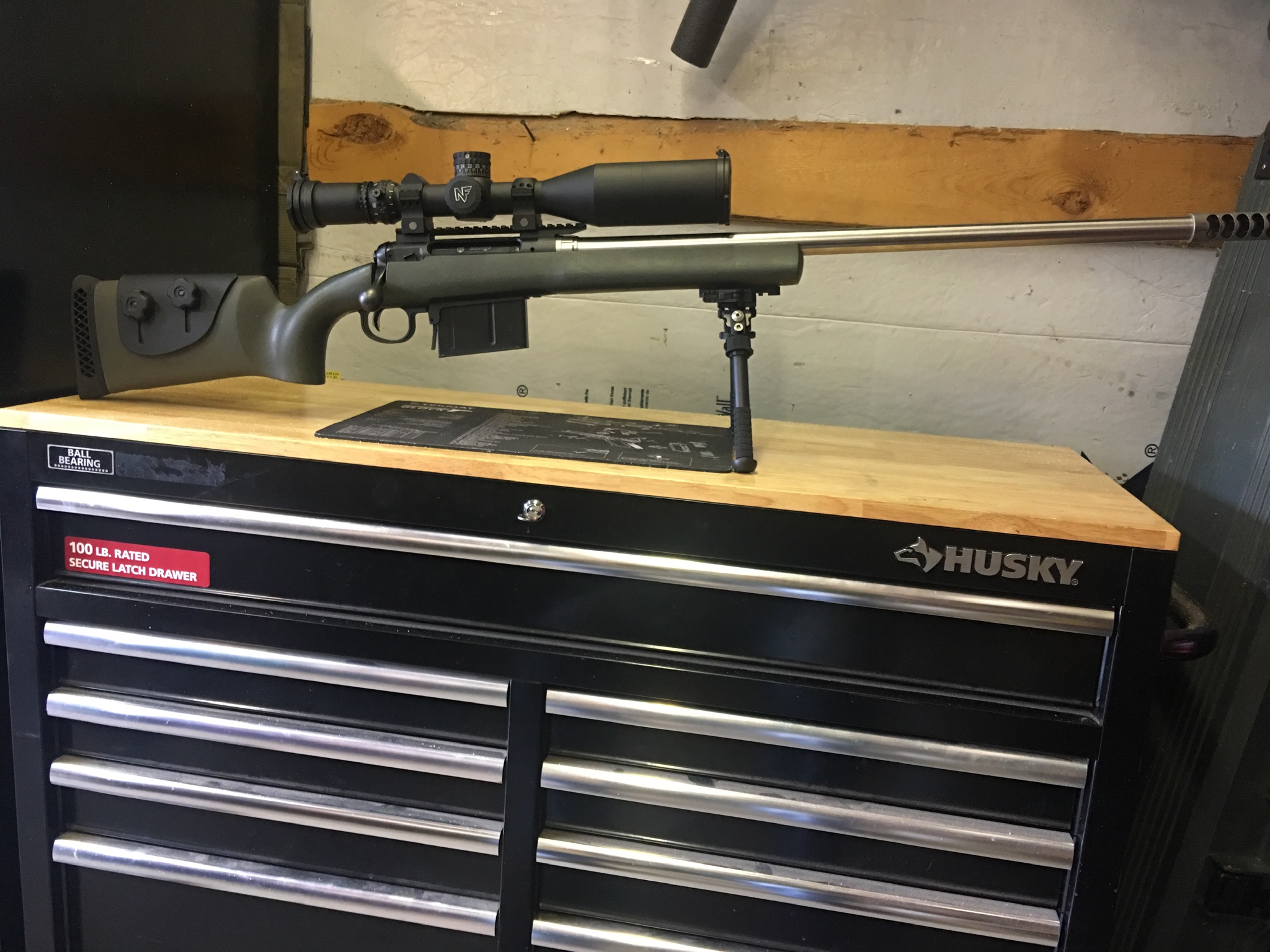

Ok So im finally starting my rifle project. Im $1900 invested up to this point, so i don't want to ruin the stock. My issue is i want to install this
150-108 Stock Embedding Spigot Versa-Pod Bipod Adapter
So has anyone here modified a HS Precision stock? I'll need to drill a hole about 8" deep into the forearm, and then decide what to use to epoxy/glue the spigot into place. I know there is other ways of attaching my Fortmeier bipod but this is how i want my end results to look, feel, and function.
Below is a photo of my rifle (Savage 110 FCP HS Precision in 300 PRC, SKU Number. 22088) using the dual swivel stud mounting holes with a picatinny rail i had, that just happened to fit perfectly, and the rail to spigot adaptor that came with the bipod

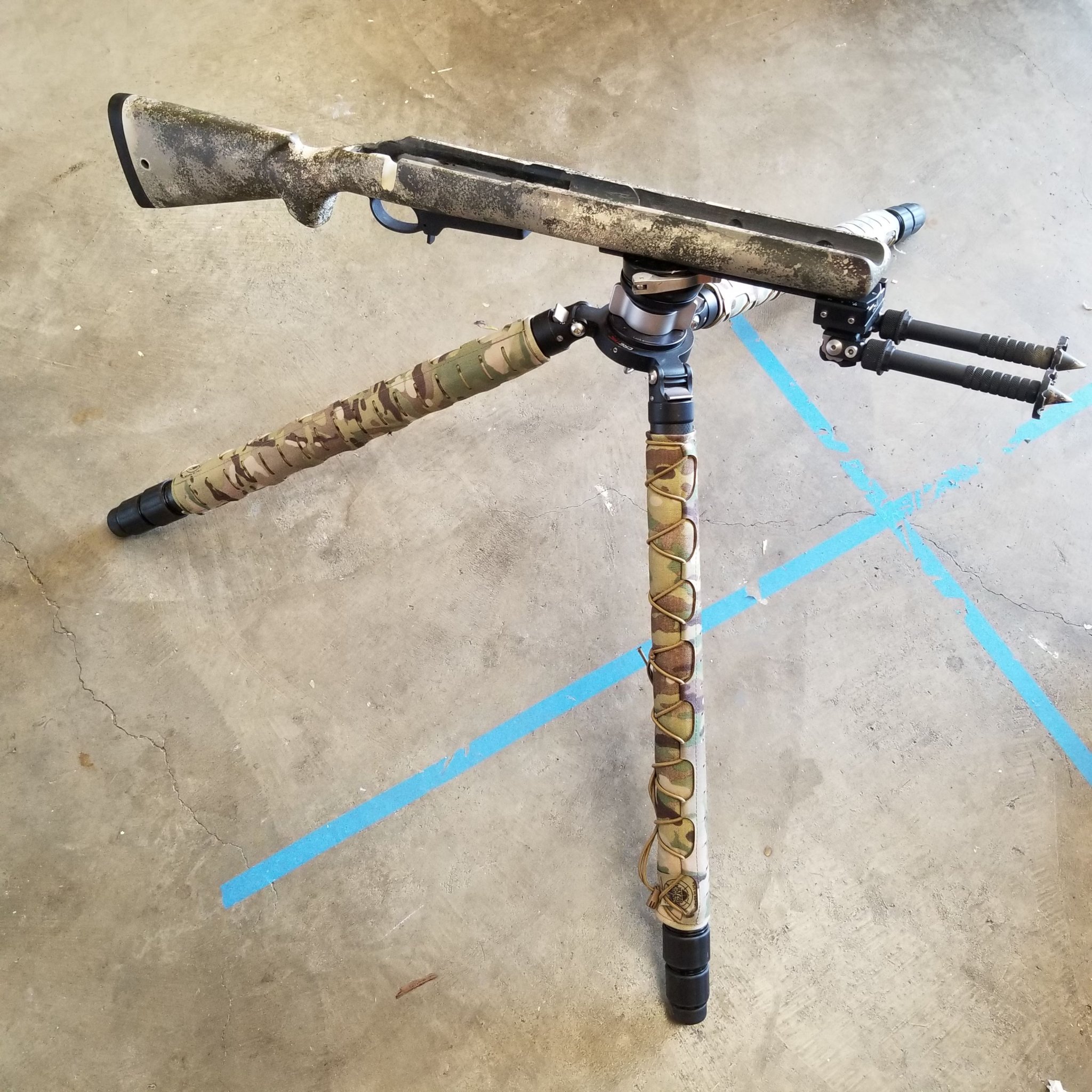

Ideally you *will* run into an aluminum chassis core, that’ll be more stable than just the fiberglass. Use an appropriate bit for aluminum, go slow, and hope you hit silver. Either way, sounds like this is your plan, so it doesn’t much matter what’s in there. You do want it true though, you could wreak all kinds of havoc if you punch through the exterior or end up with the bipod mounted all caddywampus. You’ll also want to aim high enough to avoid the stud screws if possible, but it may not be.
JB Weld is g2g for this purpose, with that rod at the core it’ll stiffen the friend if anything. It’ll bond for sure if you blow the drilled hole out well, should only need an air can with the long red straw. Could also spray brake cleaner or similar down there to rinse it out, but I’d feel fine with just air. That stuff bonds like crazy.
Oh, and if you’re worried about the bond, you can also stick a spherical Dremel bit into the front of the drilled hole and manually hog out a little “cave.” Then fill the cave with JB Weld before inserting the mount, it’ll set up and act like a retaining plug that will keep the rest of the epoxy from being able to pull out the front.

I would bet you have aluminum in the forend. Make sure you fixture very secure and use a slow feed rate, being you may not be able to fully drill into aluminum. This will help mitigate the bit from wandering.

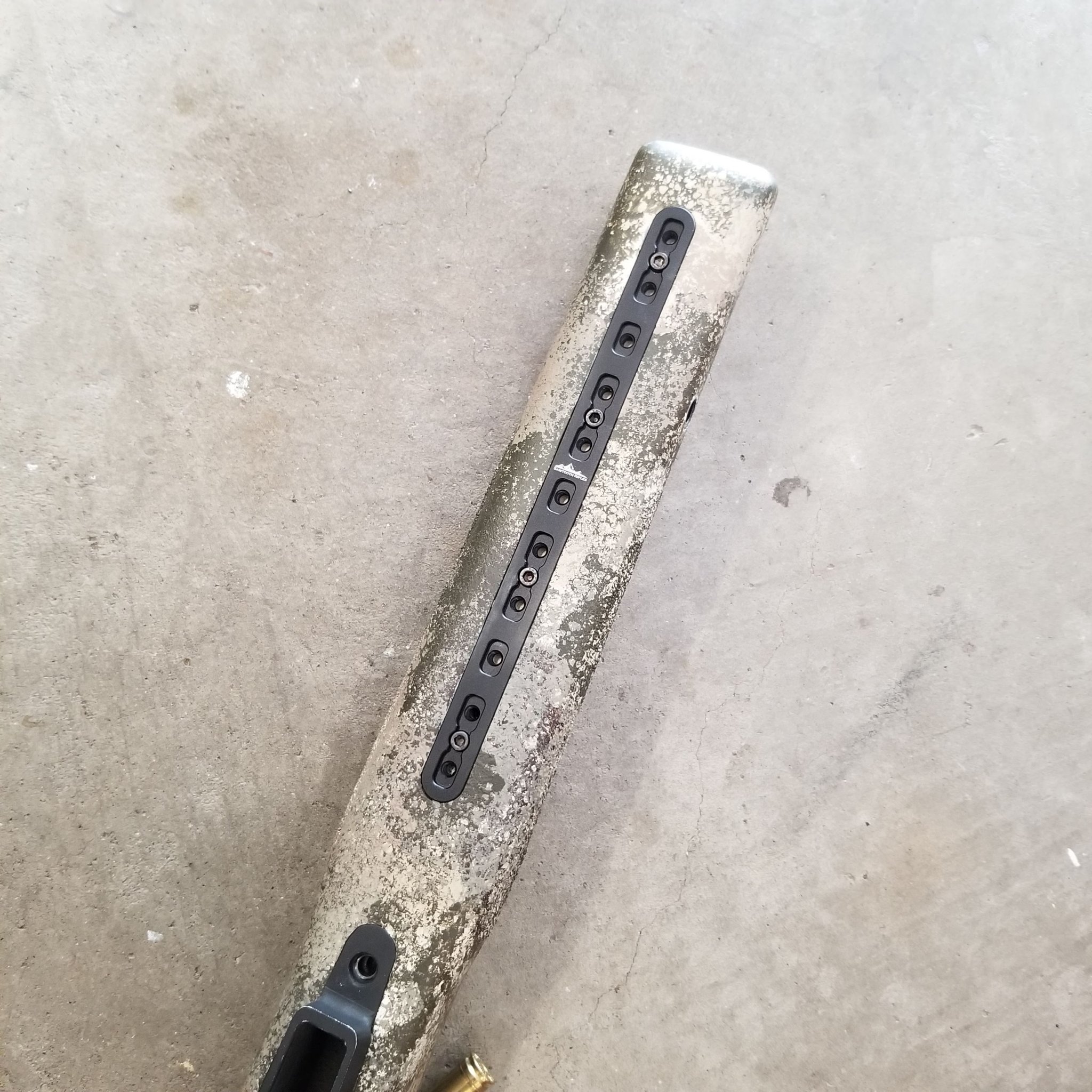

That H-S has an aluminum Skelton type lattice structure in the front. Older and I mean older stocks do not. The aluminum chassis structure extends into the pistol grip area. Nothing in the butt area. That long ass stud glued that deep into the stock, going through any aluminum should be fine. The fill is light weight and the skin is thin. Some have glued in flush cup but I’ve seen the pull out because of that light weight fill and thin skin.
i was able to verify mine has aluminum in the forearm. The spigot will be imbedded into tha aluminum. Should be super ridged.

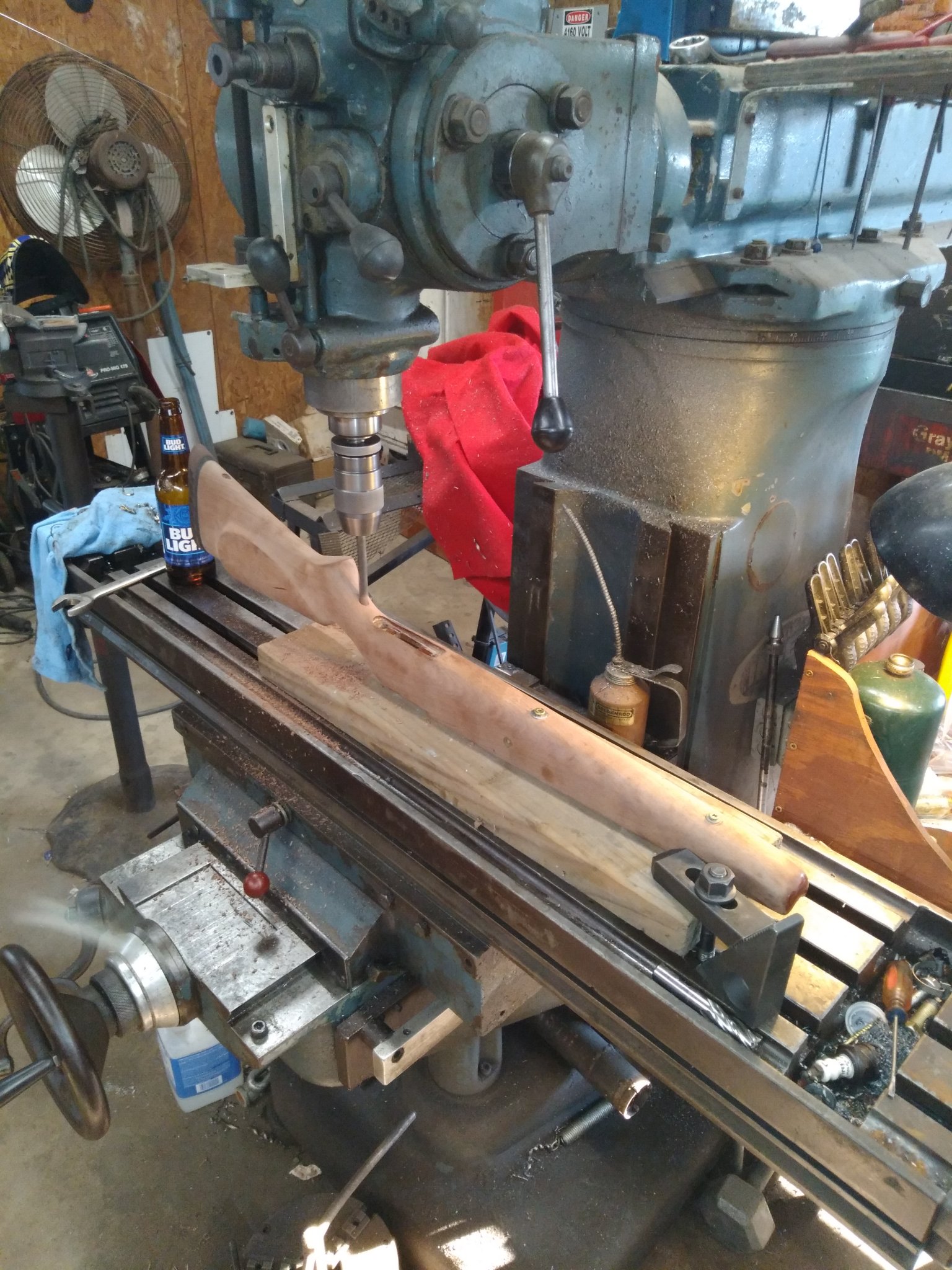

I still feel i could do this with my drill press at home. Would not be hard at all to fashion a mount out of lumber to hold the stock perfectly inline with the range of motion of the drill press. Set it for a low speed, take my time, go slow and not get anything to hot. Or i can just let the gunsmith do it. Either way its going to be pretty nice when its finally done.

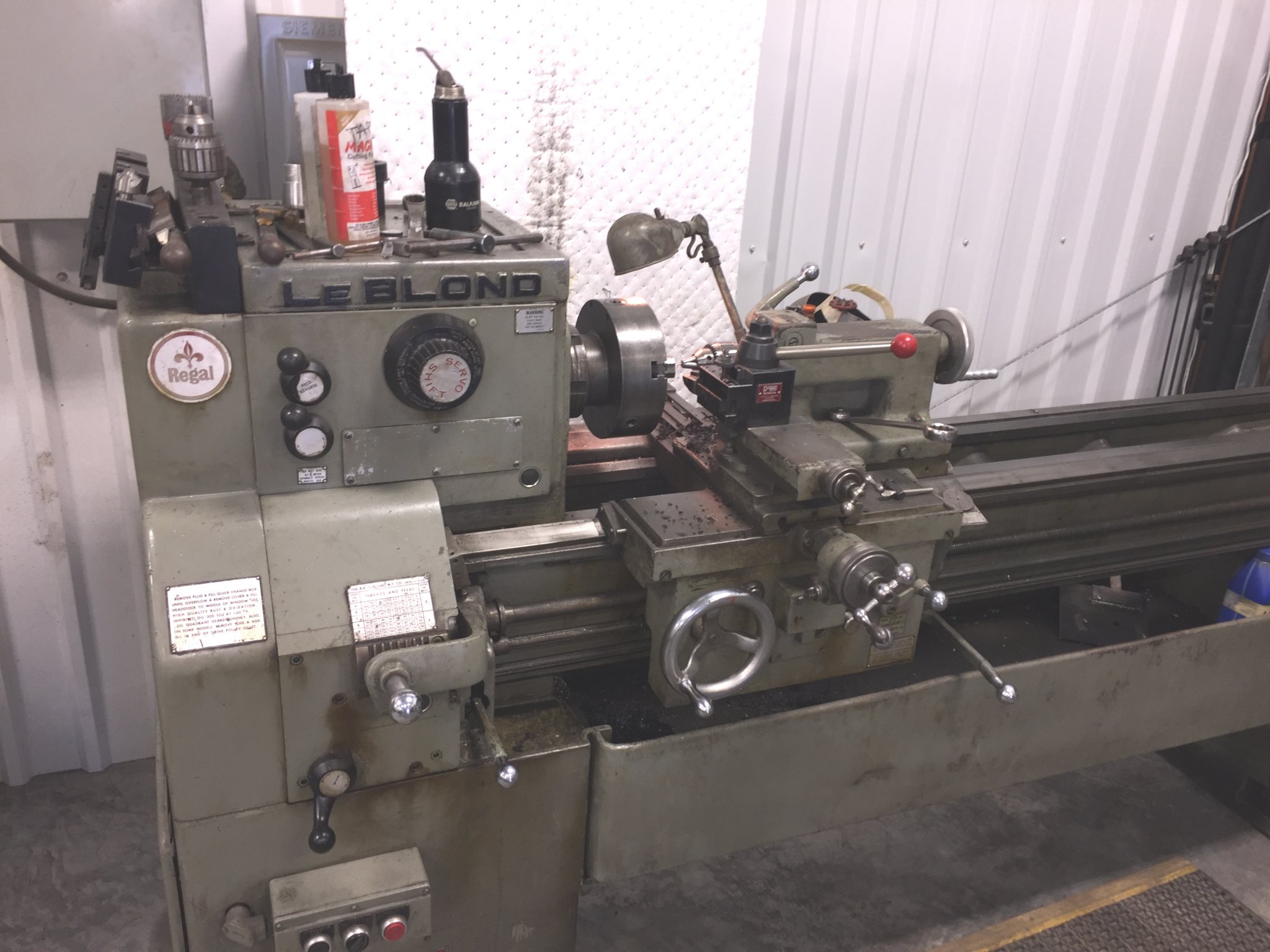

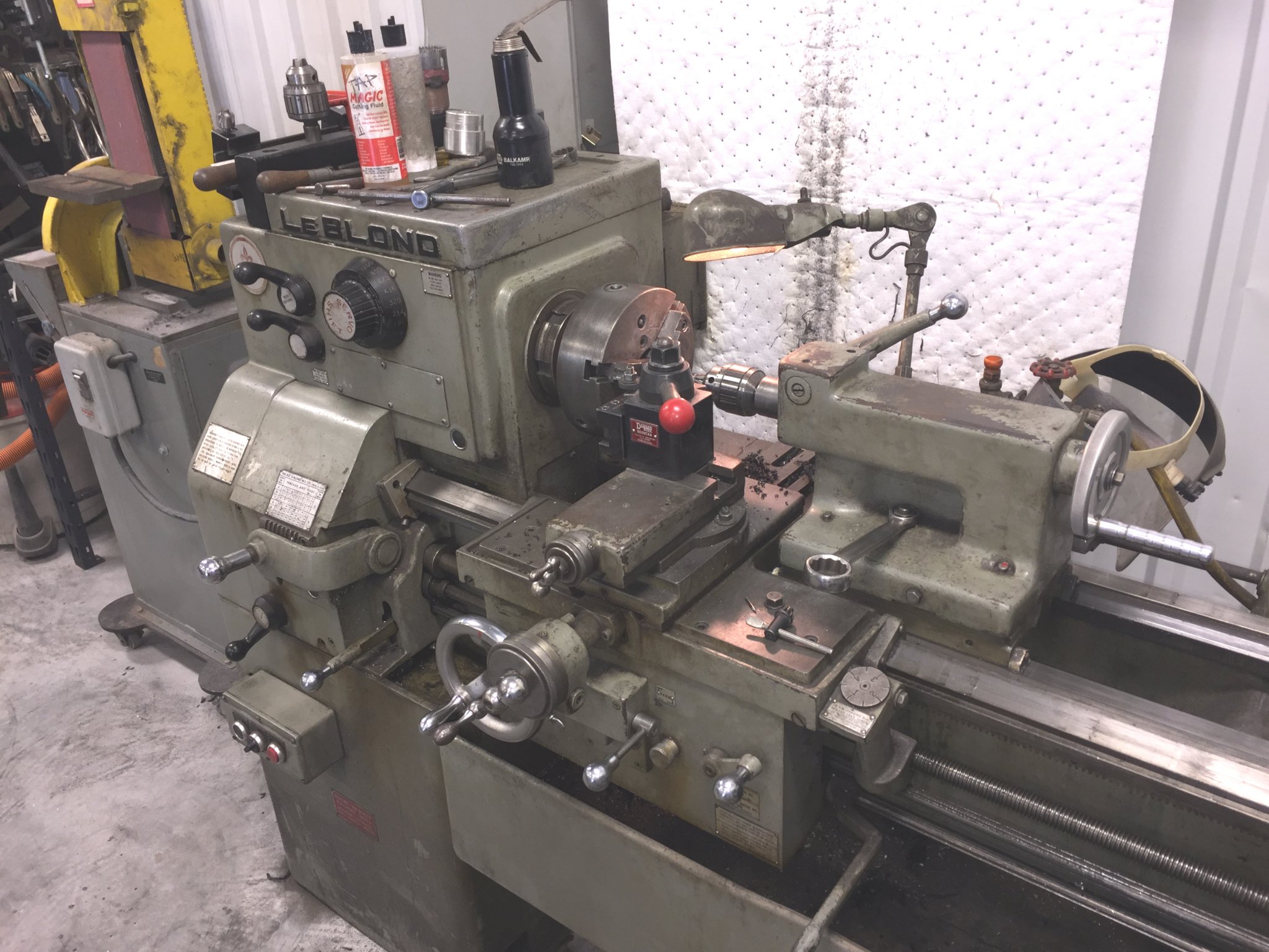

So, I have this pretty good size lathe, but a rank amateur for a few years on the Bridgeport and the lathe.
I would have to build a jig to hold the stock on the dead center side and perfectly align the center of the to-be-bored stock height with the center of live end?
Thanks.
honestly guys, i wish i owned these machines. really i do. That said why would it be such a bad idea to build something to hold the stock true and then use my drill press. Would it not effectively be the same as using one of these machines?

Yes, it would be effectively the same. Since you only gotta go 4 inches, not 8, a drill press should be fine if you can get the stock to fit and align under the bit.
Honestly, at 4” I’d even consider a hand drill starting with a tiny pilot hole, but if you have a press that’ll accommodate the stock that’s absolutely the better option over a hand drill.

The aluminum bar that runs the length of the forearm is rectangular. Probably only 1/4 - 5/16 thick. Not sure how you plan on drilling a hole
that needs to be the diameter of your spud? Let alone how you will locate the drill or end mill precisely in the stock. You could drill small holes
in the barrel channel to locate the bar. Almost would be easier to mill out the barrel channel to the depth and length to fit your spud. Leaving the end of the stock untouched Then drill a hole through the out side of the shell so it looks pretty. Locate your spud through your hole into the channel you milled out and glue it in. Fill the milled channel in with whatever. Paint it black. A 15 dollar end mill in a drill press might even get it
Depending on your press. If your just gluing the spud in and not sleeving it to make it functional You could also shorten the spud
i might be abandoning the HS Precision stock. The aluminum bar is actually thinner than the spigot i want to instal. There is just no practical way to get what i want.
The GRS Bifrost is already set up to instal the spigot like i want. Though im not so sure the stock would be idea being only fiberglass with no aluminum bedding or reinforcement. I know there are a lot of chassis out there. They are neat, just not honestly comfortable to me. so idk where to go from here. kinda bummed about the stock. Seems like an ok stock and there is not exactly a lot of options for a savage long action.
I’d say install the spigot anyway, unless you’re now set on selling it. JB Weld sets up friggin stiff, and I think it’ll hold up to loading normal bipod loads
