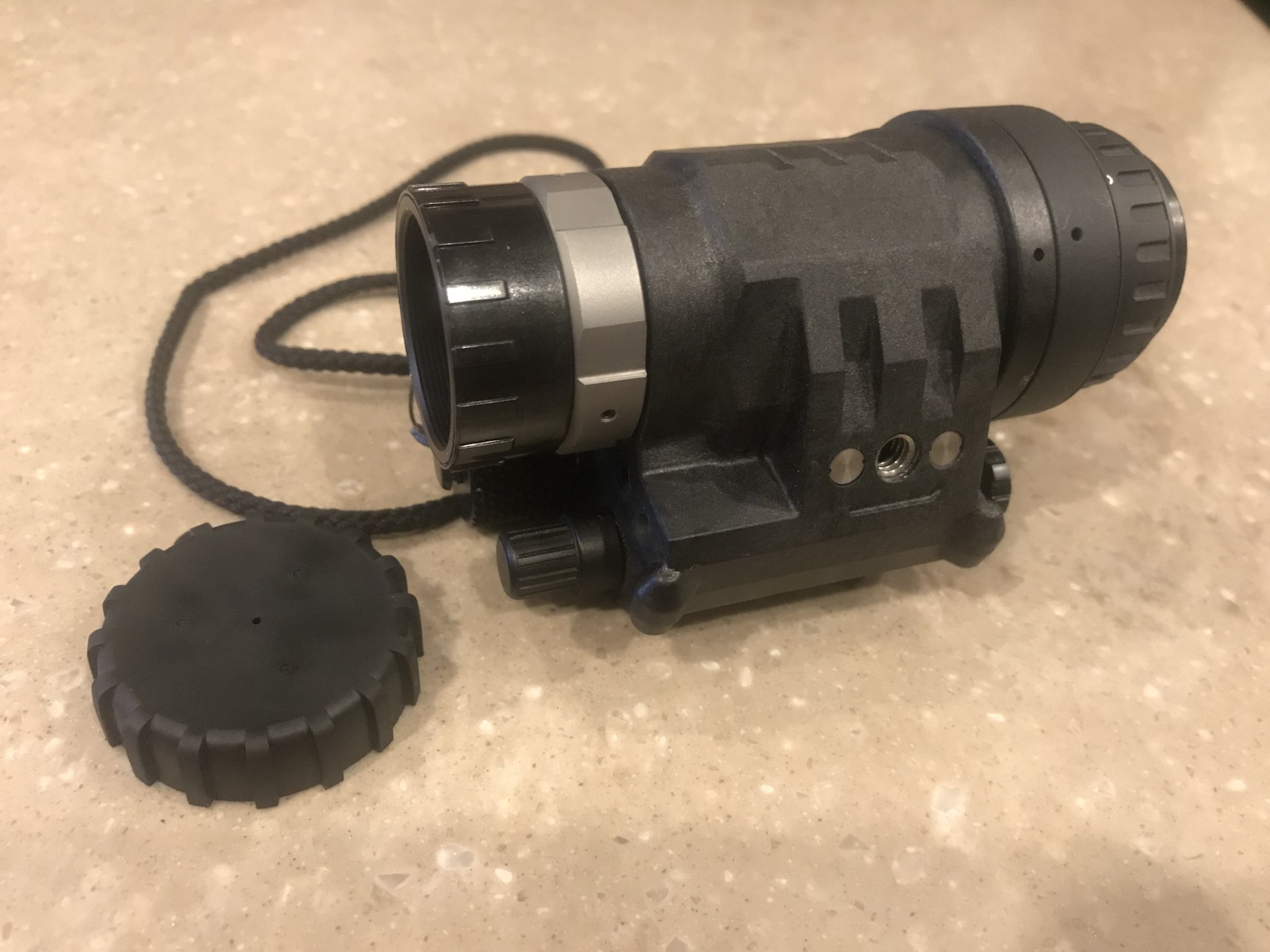

I got a pvs14 about 5 years ago and loved it. I’m just now starting to build goggles. I’ve used goggles at work regularly for the last 6 years and always loved them but can just now budget to afford them. If you start with a single tube of good quality you can always trade up years down the road. Or you could save while you have the single tube and just keep it then get goggles. I’m going to use my single tube for loaner one or for shooting video at night.
