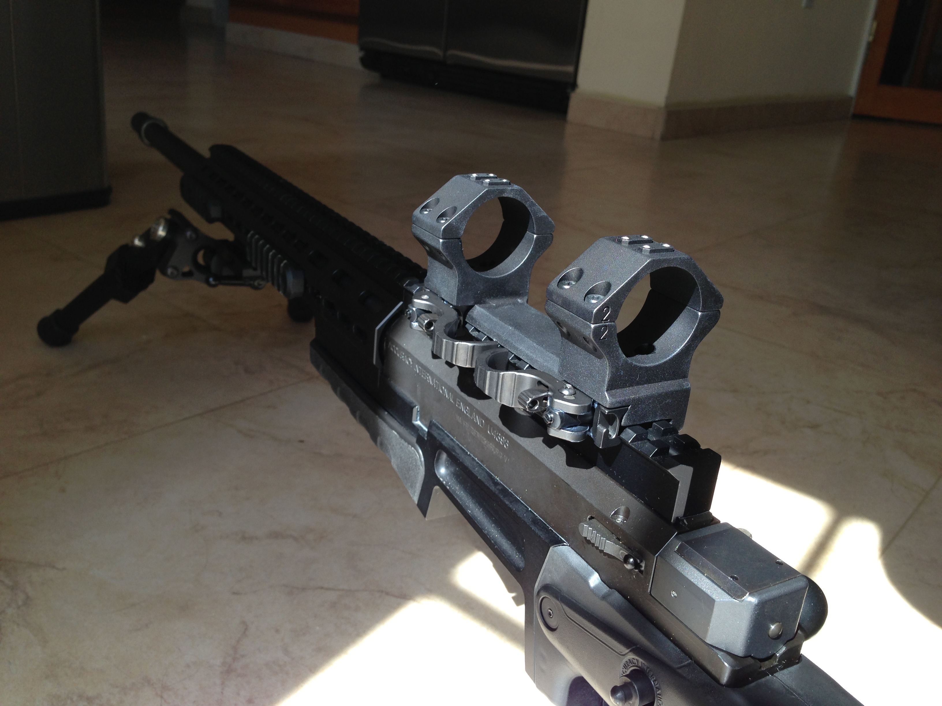

I was fortunate to be able to pick these up a couple of weeks ago. ERA-TAC QD mount from Recknagel out of Germany. They've been around for a while but never popular here in the US. Eurooptics just added them to their website including the Inclination mounts they launched at Shot. Very well made and engineered. No Rosin or blue loctite needed here. Worth taking a look.
