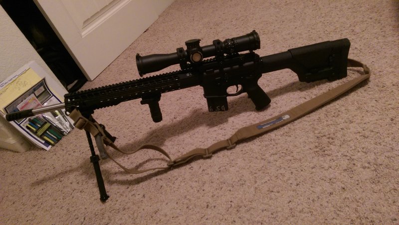

I just built a grendel for similar reasons. I wanted a light weight hunting rifle with more energy that a 5.56 but less weight than a AR10. Rainer has the Carbon Fiber Christensen barrels for $500 and I snagged a 18". I will post some pics soon but so far its what I was wanting. Its under 9lbs suppressed and is still paintable. Truth be told I would probably SBR it and do a 13" next time.
Can't speak to dumping the .308 but I'm very happy with my decision to get into the Grendel - JP SCR 11 shooting factory Hornady - super accurate and fun to shoot.

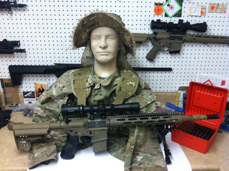

I will always have my 308 but I am exploring the 6.5 Creedmoor world. Pressure is not so much an issue if you use the JP rifle length plus 2 gas system. Gives the bolt a little more time to unlock and in conjunction with an adjustable gas block it is an awesome round in the AR platform. If I was to build another AR15 type weapon, I would look real hard at the 6.5 Grendel
For me, I will always keep a 308 no matter what just because it's such a versatile round. However, I have been shooting my 6.5 grendel a lot more lately. Love it for all the reasons as stated above but the only thing that bugs me about it is the lack of good muzzle velocity compared to 308, 6.5 C, etc... Mine has a 20" barrel and I'm thinking if stepping up to a 24" in the future. For now though, it's accurate, it'll drop a big mulie, and i have a blast shooting it...

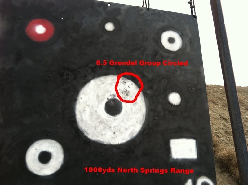

I shot a .264 ARP barrel for several months, the factory 123gr Amax could be put in the same hole. Once I started shooting longer ranges, the hits on steel were not impressive. I sold it and shoot a 6.5CM now for long range work, less recoil than a .308 and awesome drop/wind numbers.

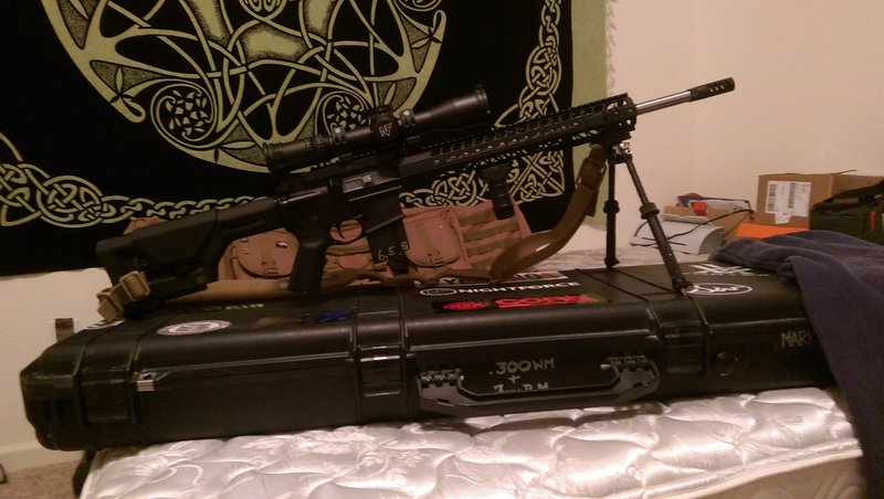

I've owned 3 different AR10s/LR-308s, and 2 different LR-260s, one DPMS factory, one custom GAP-build that I still have, got out of all the .308 Winchester stuff after spending time with .260 Rem and 6.5 Grendel. I initially got into 6.5 Grendel as a fun toy, lightweight little AR15 that maybe I would consider for shooting certain matches that involved a lot of movement in field conditions.
What happened over time was that I shot the Grendel more and more, especially after the Hornady 123gr AMAX was introduced as a factory load. I started hand-loading for it, but quality, affordable factory ammo made it even more easy to shoot with. It gained SAAMI approval after that, and more factory ammo started to come online from various sources.

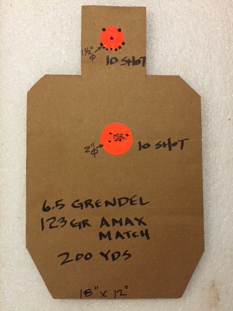

I like the AR-15 platform. I picked up a used Alexander Arms Overwatch 6.5 Grendel w/ 24" barrel last summer. Added a PRS stock and Wilson Combat Drop-in Trigger.
1st range day ... laser bore sighting at 25 yds,
(2) 3-shot groups at 100 yds ... AA 123gr Lapua Scenars ... sub-moa
(1) 5-shot group AA 123gr Lapua Scenars at 200 yds ... center mass ... .625 moa
(1) 5-shot group Hornady 123gr Amax Match at 200 yds... center mass ... .5-moa
10-shots Hornady 123gr Amax Match at 200 yds... headshots ... just to be a dick
I'd buy the gun

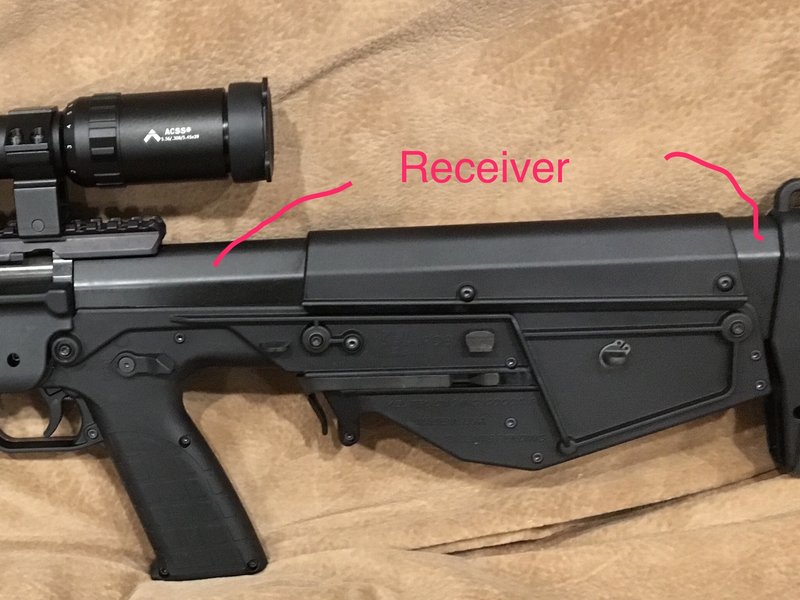

Hey just to give you an update, Kel tec is also coming out with an RDB in 308 win, and also may be selling barreled assembly and bolt for other cartridge conversions on the same rifle. How they got away with what is the actual firearm on the RDB is anyone's guess (it's the steel piece that's on top that's is just the top cover and it joins the front and bottom together) no working parts are mounted in it or to it????
