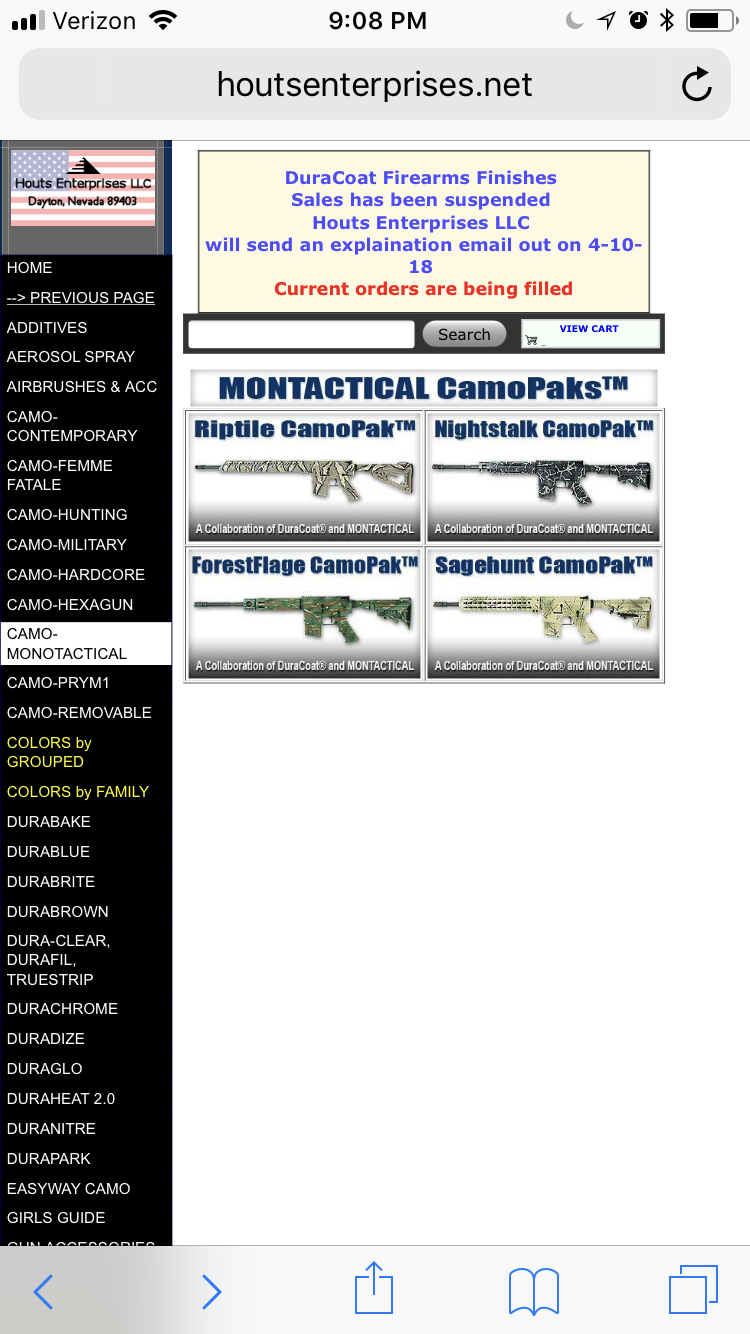

Just saw this when I went to place an order today.

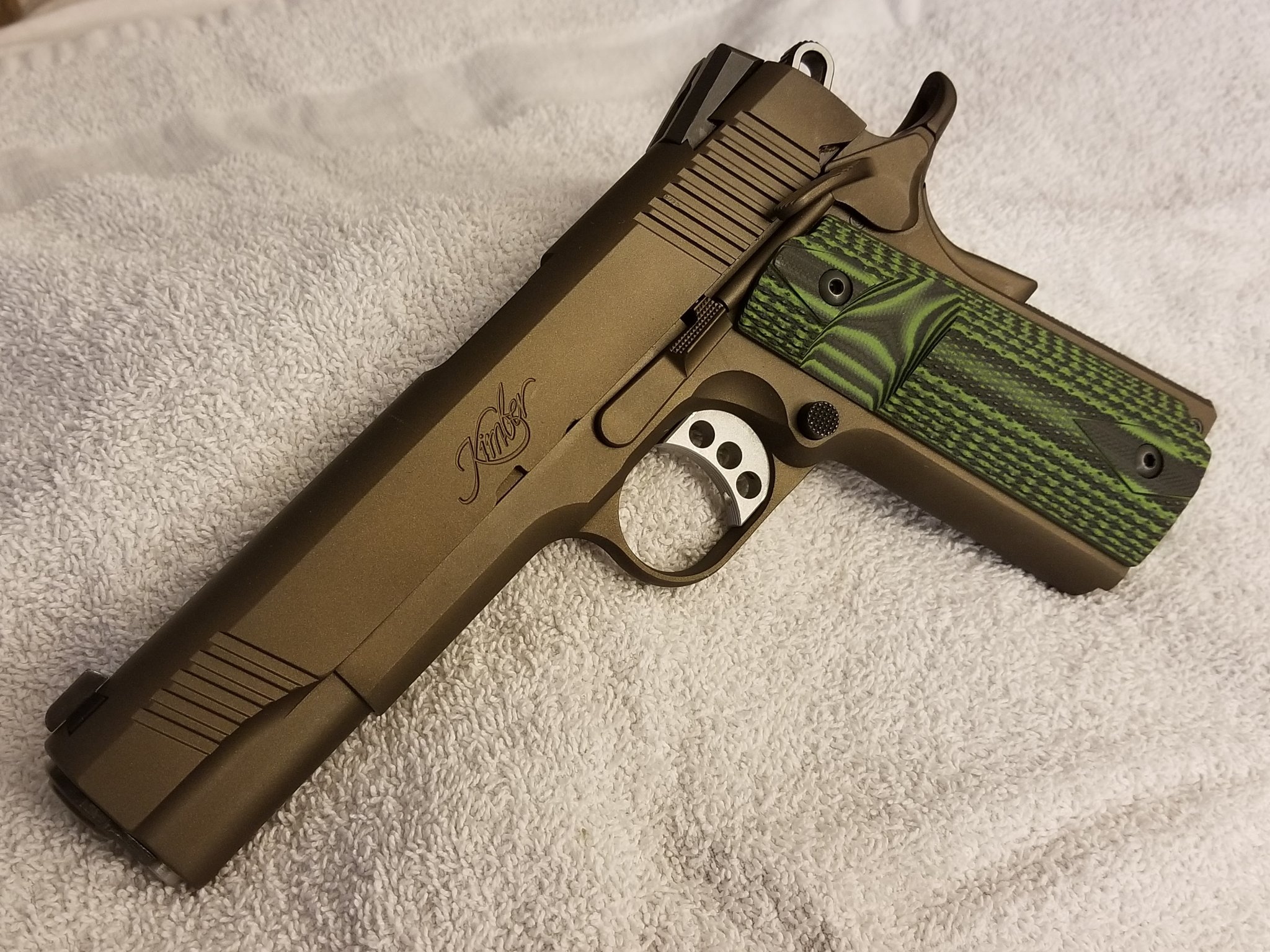

I've tried a few different setups. Cerakote is what I stick with. It looks that it's becoming the industry standard. I strain though as it's recommended depending on the color/type. I've always tried to stick to the mfg specs and not deviate. Here's a Kimber I did recently. View attachment 6891146
That looks like a great job. I imagine you blasted it first right?
