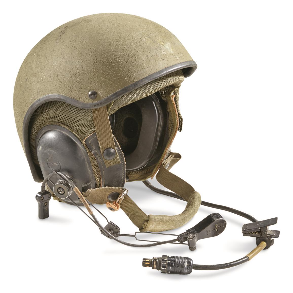

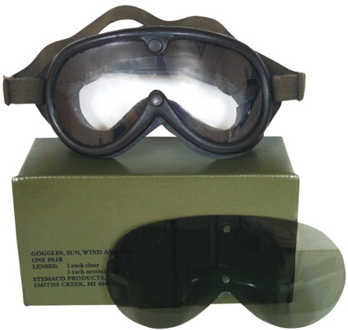

Don't despair Uncle Sam has some surplus just for your purposes, if it works for the 120mm of an M1 Abrams tank it will work for your Tikka. LOL
To complete the ensemble the famous Goggles, Wind, Sand, and Dust.
