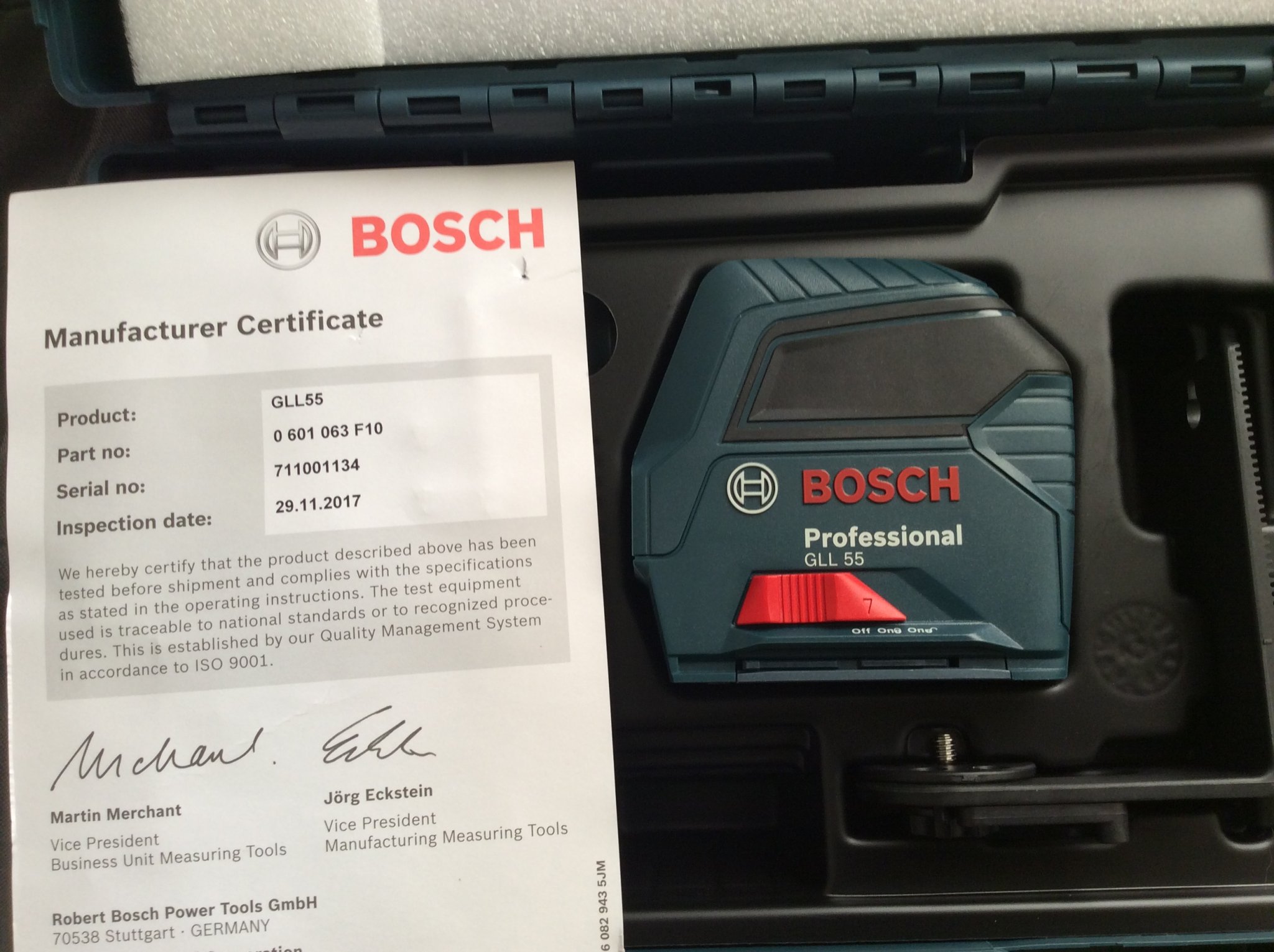

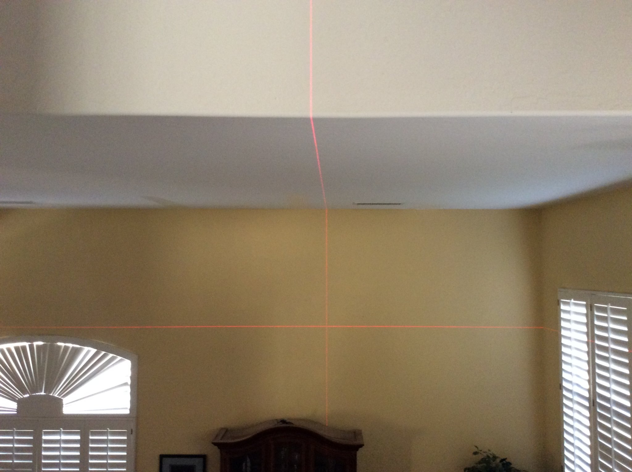

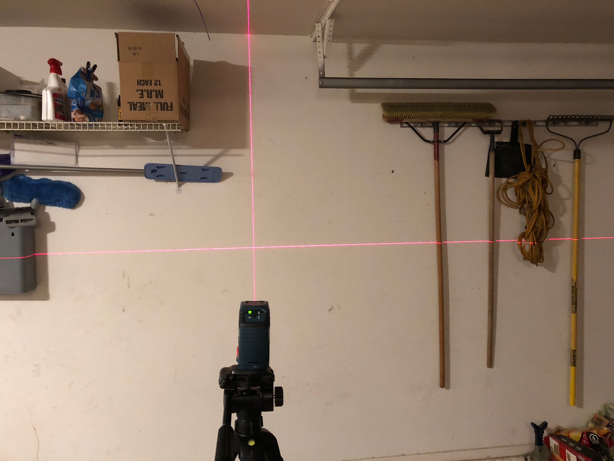

I have one of these I use for work all the time. Not sure what brand that is but I have a Bosch 5-Point Self Leveling Cross Line laser. Ive never used it for installing a scope though. I recently bought the Arisaka optic Leveler and installed a few scopes with it recently. Its legit and super fast. Well worth the $12
