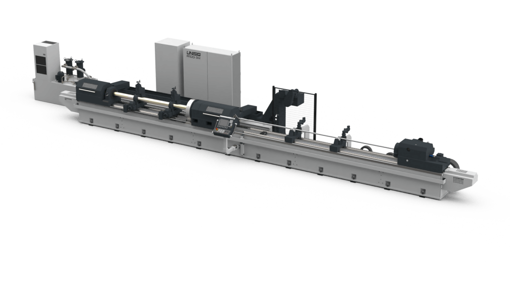

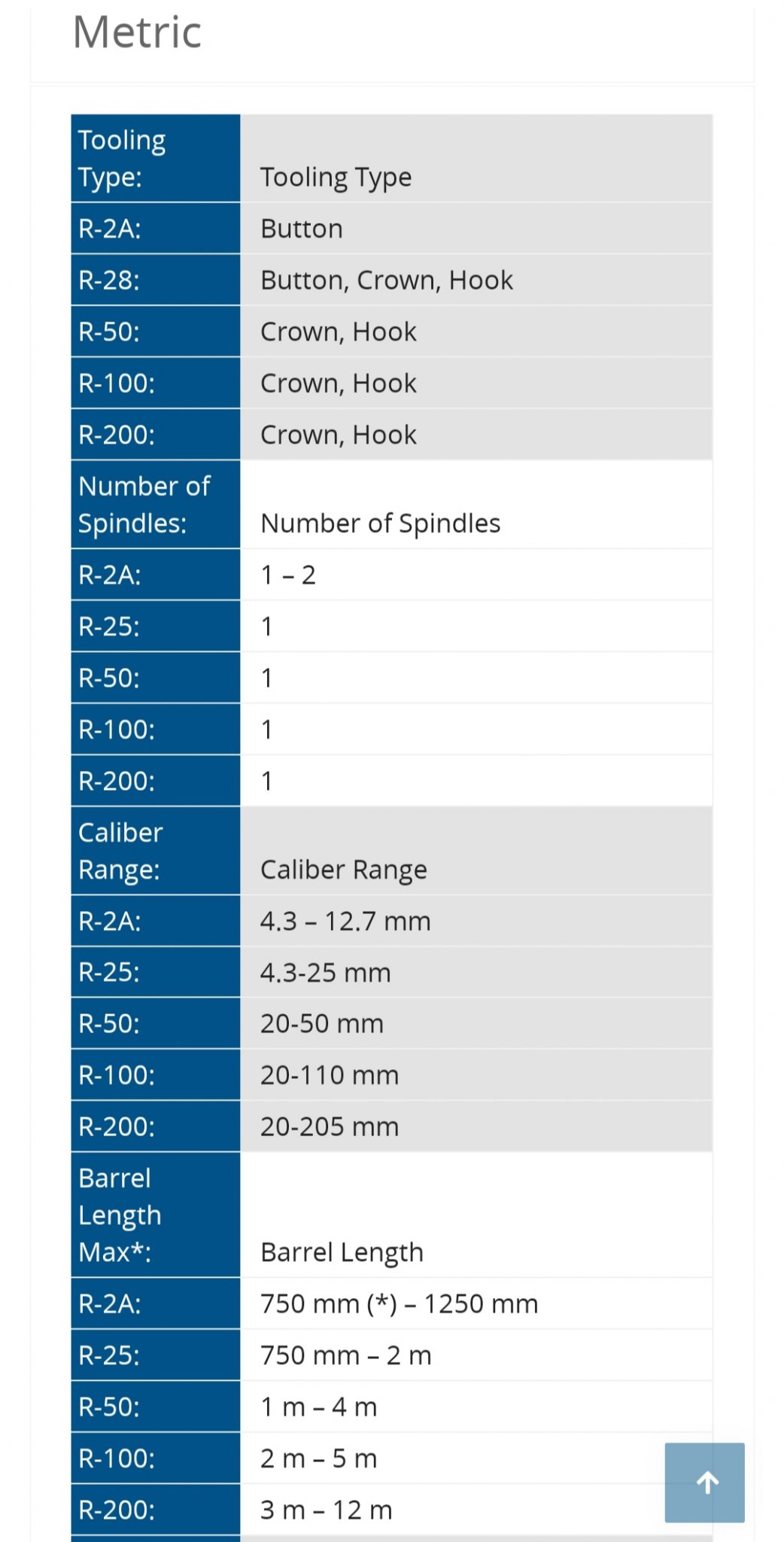

So you are interested in the production of giant cannon barrels. These machines from UNISIG can rifling pretty much any caliber. The type of rifling is also specified. Rifling machines for barrels up to 205mm are offered there. I hope that's what you were looking for.
