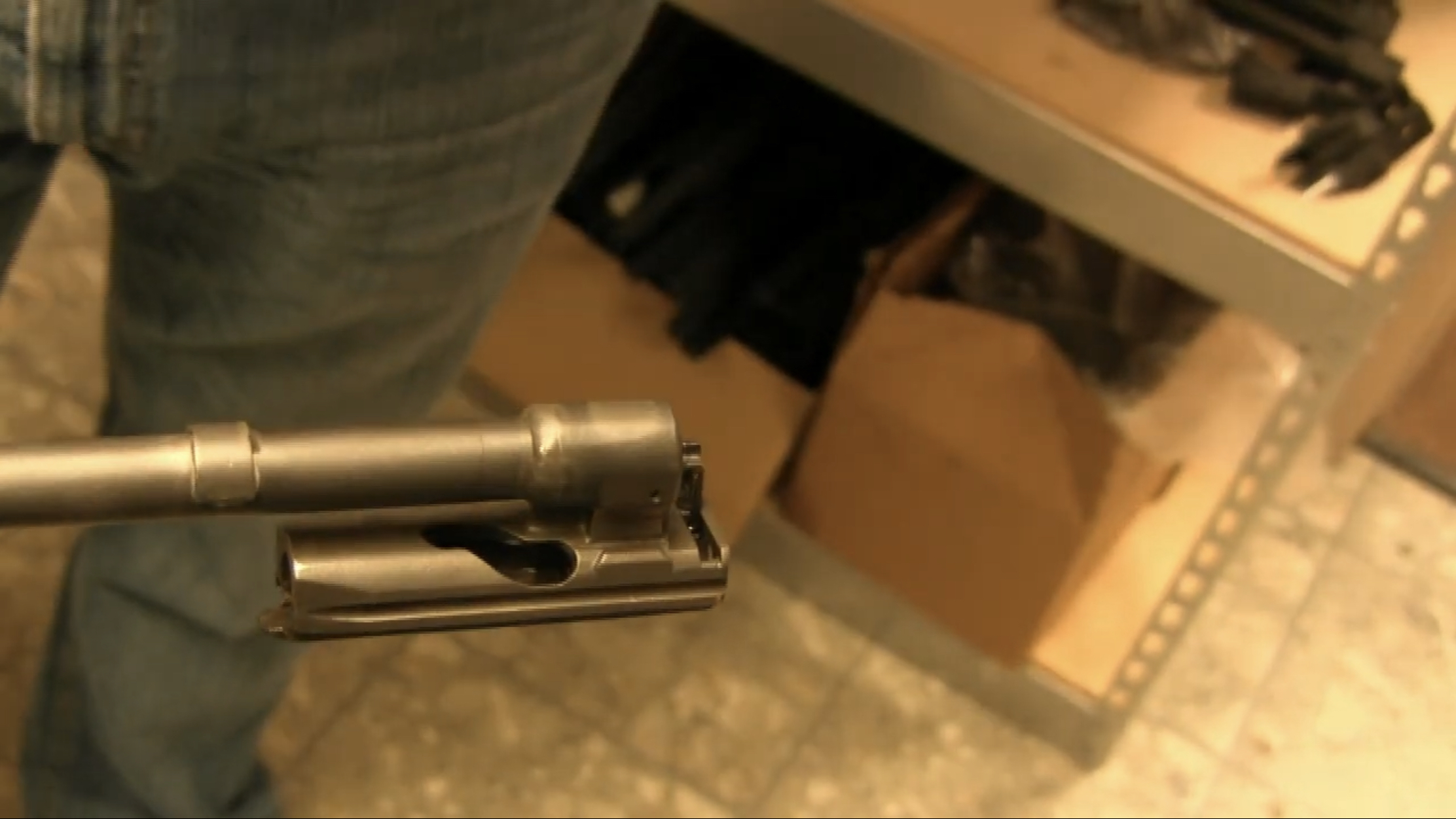

Didn’t think they finally translated that idea into an AR bolt carrier, glad they did.
Love the idea of the long, slow, smooth helical cam track.
I imagine that the design enables a slower, higher - torque camming action.
I always wondered if this design would be friendlier to brass.
Long Recoil designs typically have these long cam tracks…
Examples from Singapore are the CIS Ultimax and the SAR-21.
Not entirely sure if the machineguns from Knight’s Armament use a similar cam track in addition to long recoil travel.
Above firearms have James Sullivan’s influence in them.

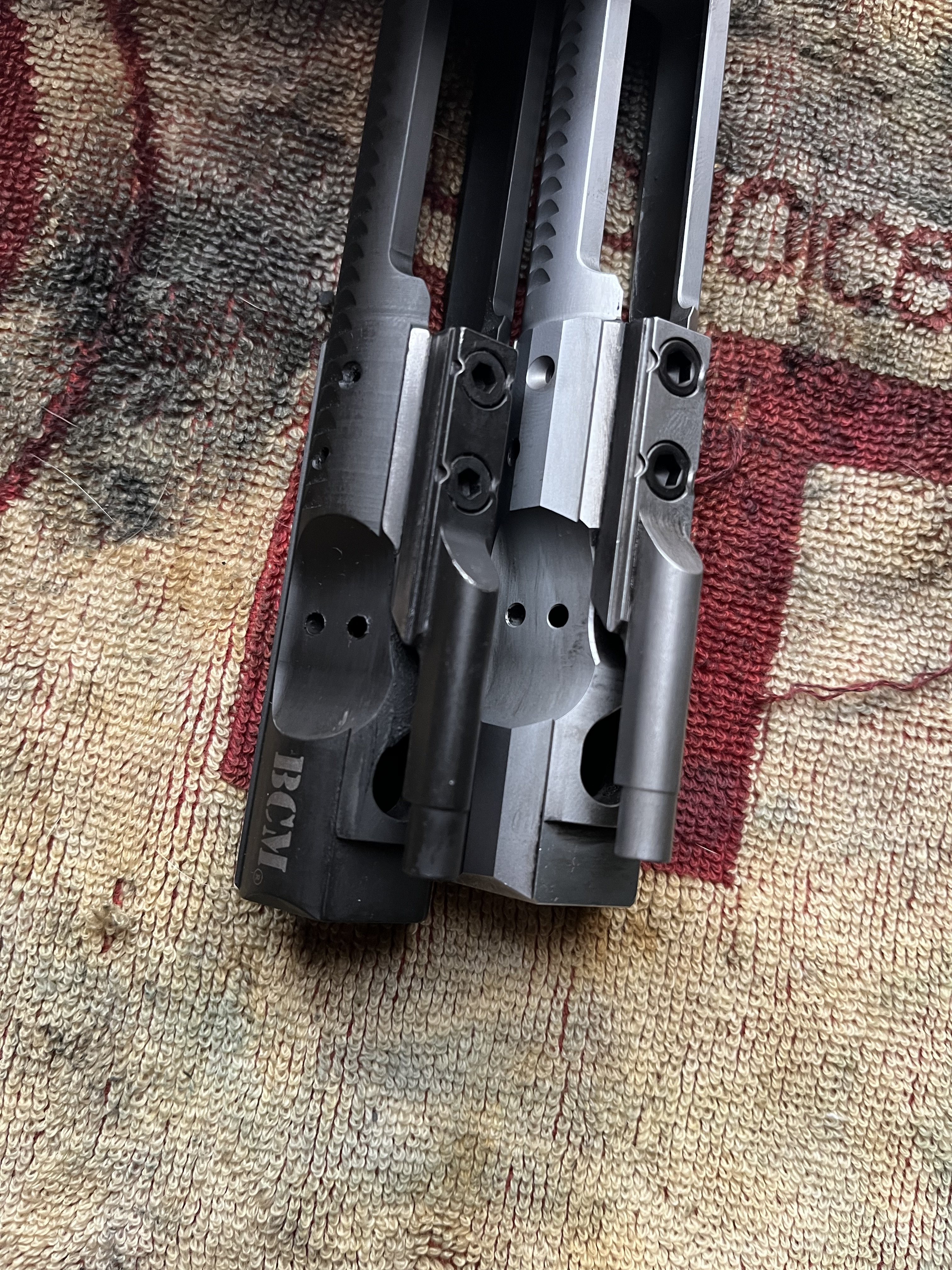

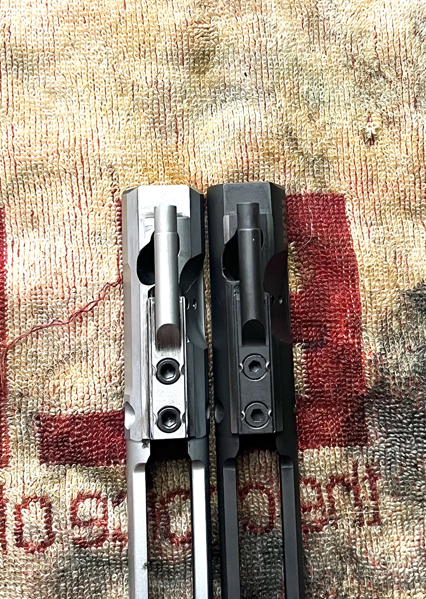

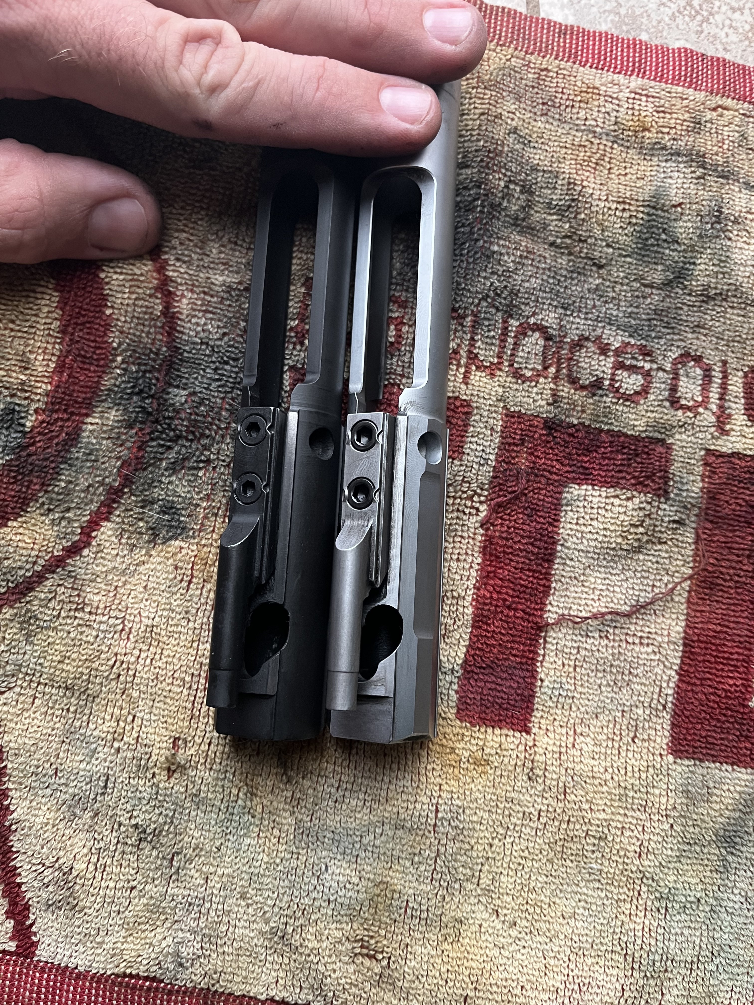

Any chance you could photograph the cam tracks of a regular BCG and that one by VKTR side by side for comparison?
I’m curious about the differences.

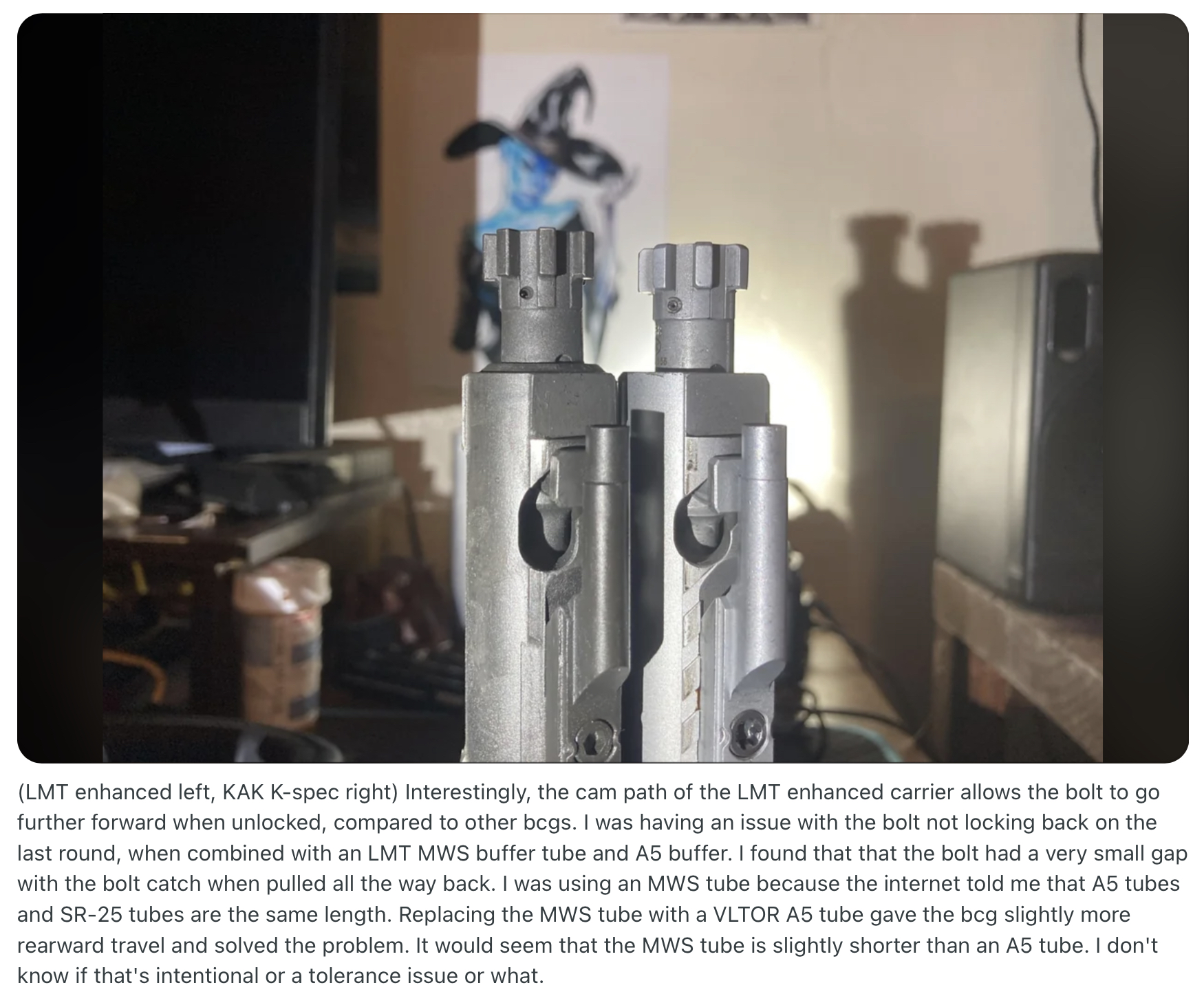

So where the cam path of the LMT is elongated with regard to bolt travel forward, the VKTR has an elongated travel in rotation. Standard BCG has 20.7 degrees of bolt rotation, whereas the VKTR has 22.5 degrees. Additionally, looking at them side by side, it appears a standard carrier, as well as the LMT, have straight line movement in the cam path while the bolt is in the fully locked position. However the VKTR flips that around, and puts the straight line travel AFTER the bolt has fully unlocked. I imaging that helps reduce the chance of the cam pin gouging the upper receiver, although I’ve never personally seen a rifle with that issue.

Instead of “slow unlocking” associated with a long helical path, it’s more of “delayed unlocking.”
Something closer to changing the timing of the “bolt twist.”
Definitely a change to the bolt timing. I would almost lean more to a “delayed extraction”. Because the bolt probably is technically unlocked around the same time, but that linear travel in the cam path is after the bolt is unlocked. So the bolt is held in a technically unlocked position for a split second before actually starting to extract the case from the chamber.
