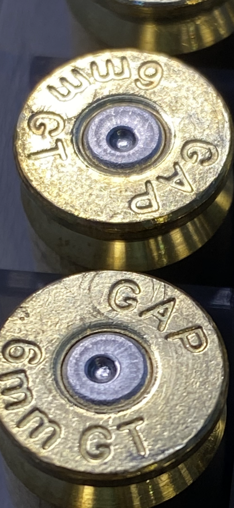

I am getting ejector circles on most of the 150 pieces of 6GT Hornady Gap brass I have fired with a very mild load on a brand new barrel. Load = 108Eld, 34.5gr h4259 @ 2700fps and 35.5gr H4350 @ 2800fps.
When looking for what the issue could be I found that most or almost all the brass when primed will result in the primers sitting just slightly higher than the head.
could this cause the ejector circles I am seeing since the brass would not be sitting flat on the bolt face and when fired it would slam back into the bolt face?
I think the primer pockets are not deep enough because I have the setting turned all the way up on my priming tool. I do have a pocket uniformer but holy shit the pockets are tight and the uniformer just gets stuck in the pocket before it cuts enough. Maybe due to a radius at the bottom of the pocket.
I just wanted other opinions on high primers being a possible culprit for the ejector marks.
This is all brand new virgin brass and I have not fired any sized brass yet. I am full length sizing and I am only bumping the shoulder 0.001” back.

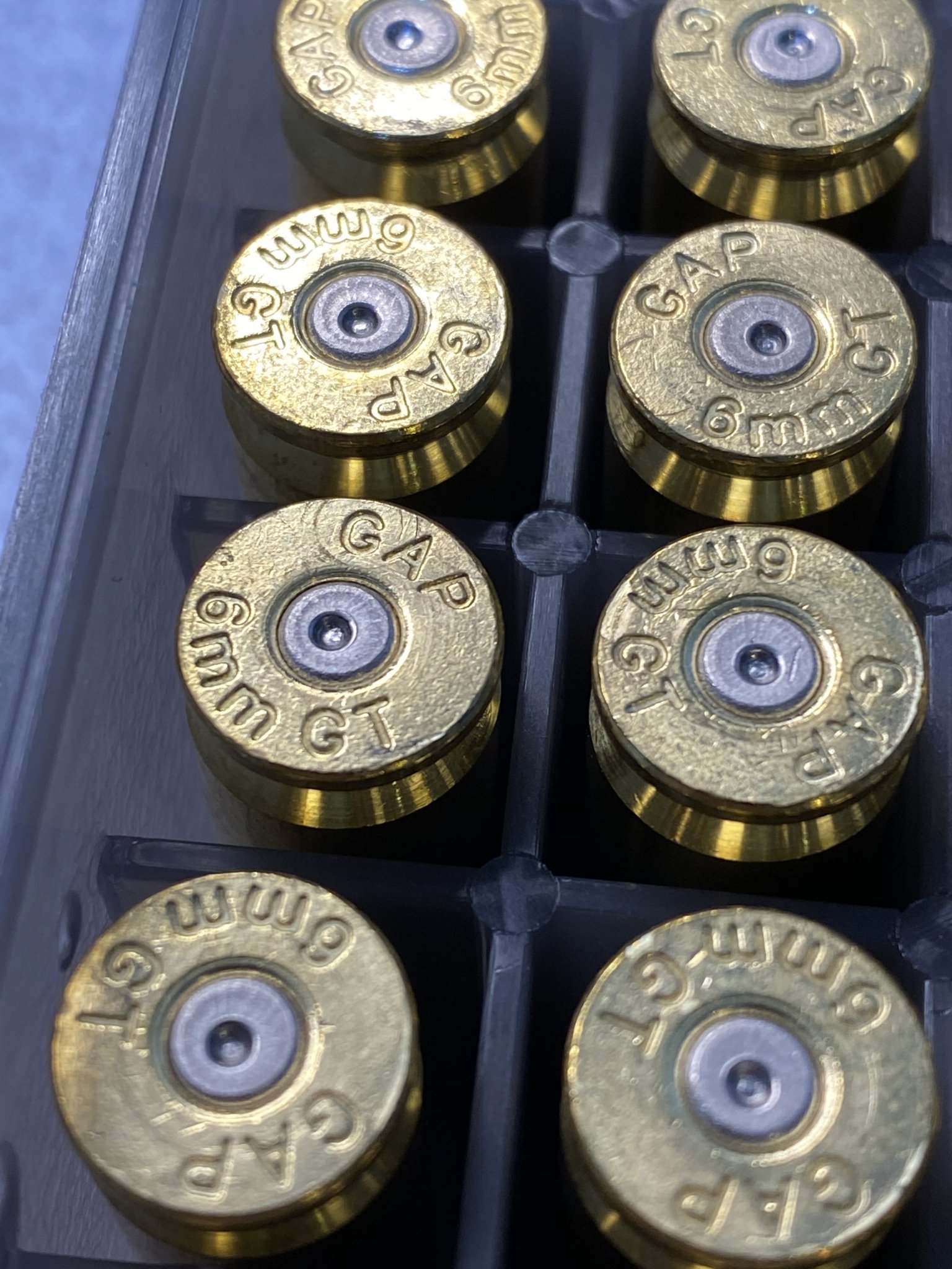

The edges of the fired primers are still very radiused. This to me says you are not over pressure.
That was what I had also looked at as a counter indicator and was looking for the additional assurance. Still odd to see the ejector marks and those have almost always been my indicator for the onset of pressure in every other cartridge I have loaded for. The 6GT seems a bit of an odd ball.

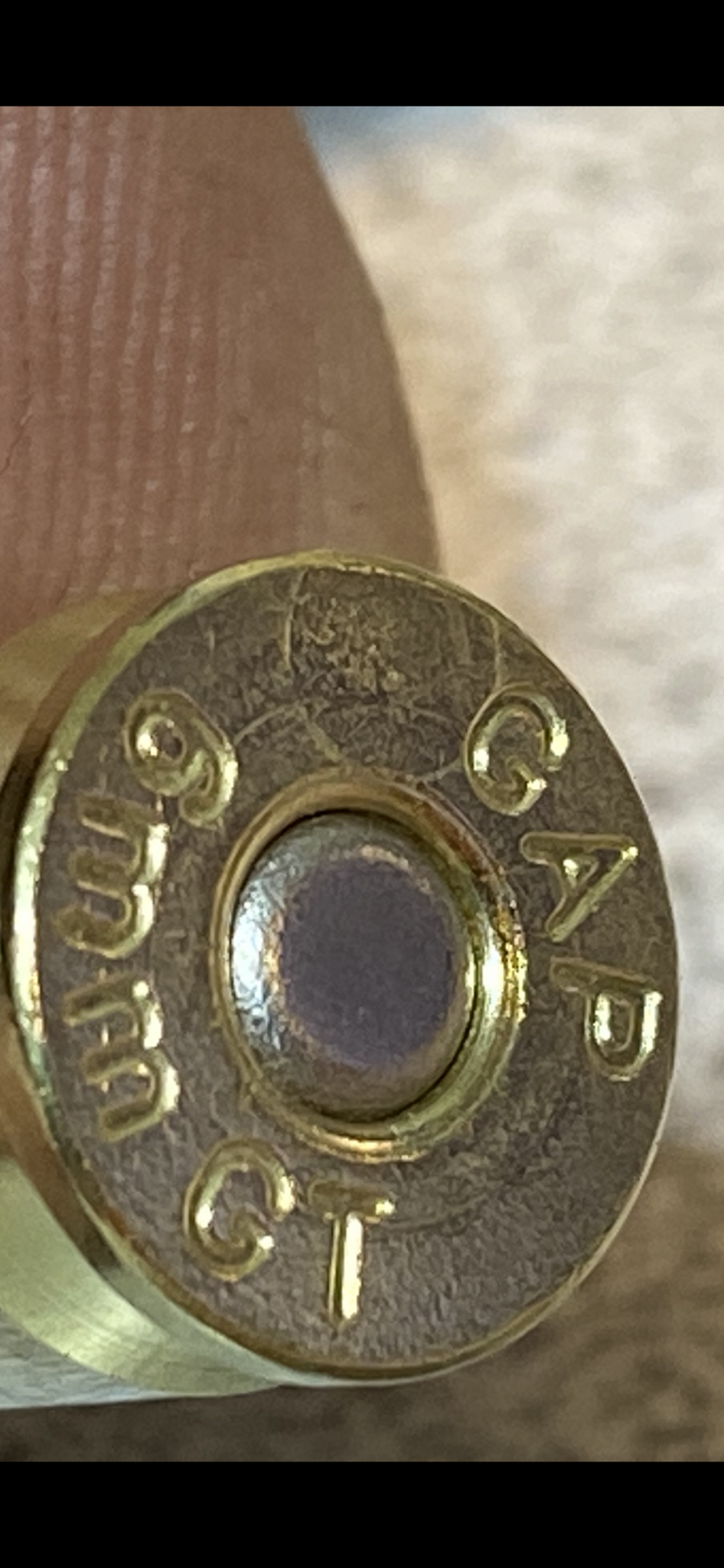

I don't know what action you are using but in one of your pictures other than the ejector imprint you also have primer flow around the firing pin indent.
How many of your primers are showing that ?
I do Remember looking for that and didn't recall seeing much of it. Here is the only other photo I have showing more than a couple of cases if you can see more? It’s the same photo just zoomed out
Six out of the eight cases I can see some primer flow, the other two may have just can't tell from the angle.

I don't own a 6GT but in 6.5x47 in my Kelbly Atlas action I use primer flow as my indicator of pressure and don't exceed charge weights that show it.
Some actions show it at relatively low charges and is a false indicator.
That's why I was curious about what action you were using.
Rem 700 actions are notorious for primer flow at any pressure.

I wasn't so much interested in action as i was small or large firing pin.
The larger diameter firing pins may show some flow regardless with small primer high pressure cartridges.
If I'm wrong please correct me.
It looks like a small firing pin indent from the pics but a little hard to tell for my old eyes.

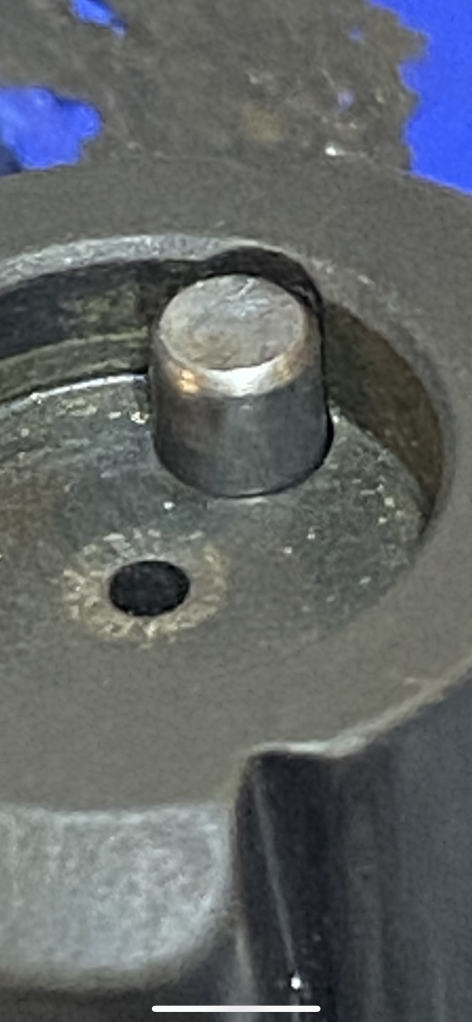

By the close up pics it almost looks indented instead of flowing into the ejector plunger hole, you might check and make sure the plunger will atleast depress to flush with the bolt face.

Your primers are not flattened. That suggests that you have low to moderate pressure. But you do have ejector marks. That suggests that you have high pressure. One of those signs is wrong. I don't know that caliber so I will rely on your statement that this is a mild load. In that case the ejector mark is a fake sign. So test it.
But before you do, check the edges of the ejector hole in the boltface. If it has burrs, either push the ejector deep into the hole and scratch off the burrs or remove the ejector, scratch off the burrs, and reinstall the ejector.
Here is a way to test ... Seating into the lands increases initial pressure. Don't set
Take 5 pieces of brass, seat the bullets so that closing the bolt seats the bullet slightly into the lands. Thus, when the firing pin hits the primer, the brass won't move.
Take 5 more pieces of brass, uniform the primer pockets, seat bullets slightly into the lands. since the primer pockets are cut, primers should seat deeper. When fired with bullets seated into the lands, the brass won't move.
Compare A and B to what you already did. One should be different from your baseline. If not then check your assumptions about pressure.

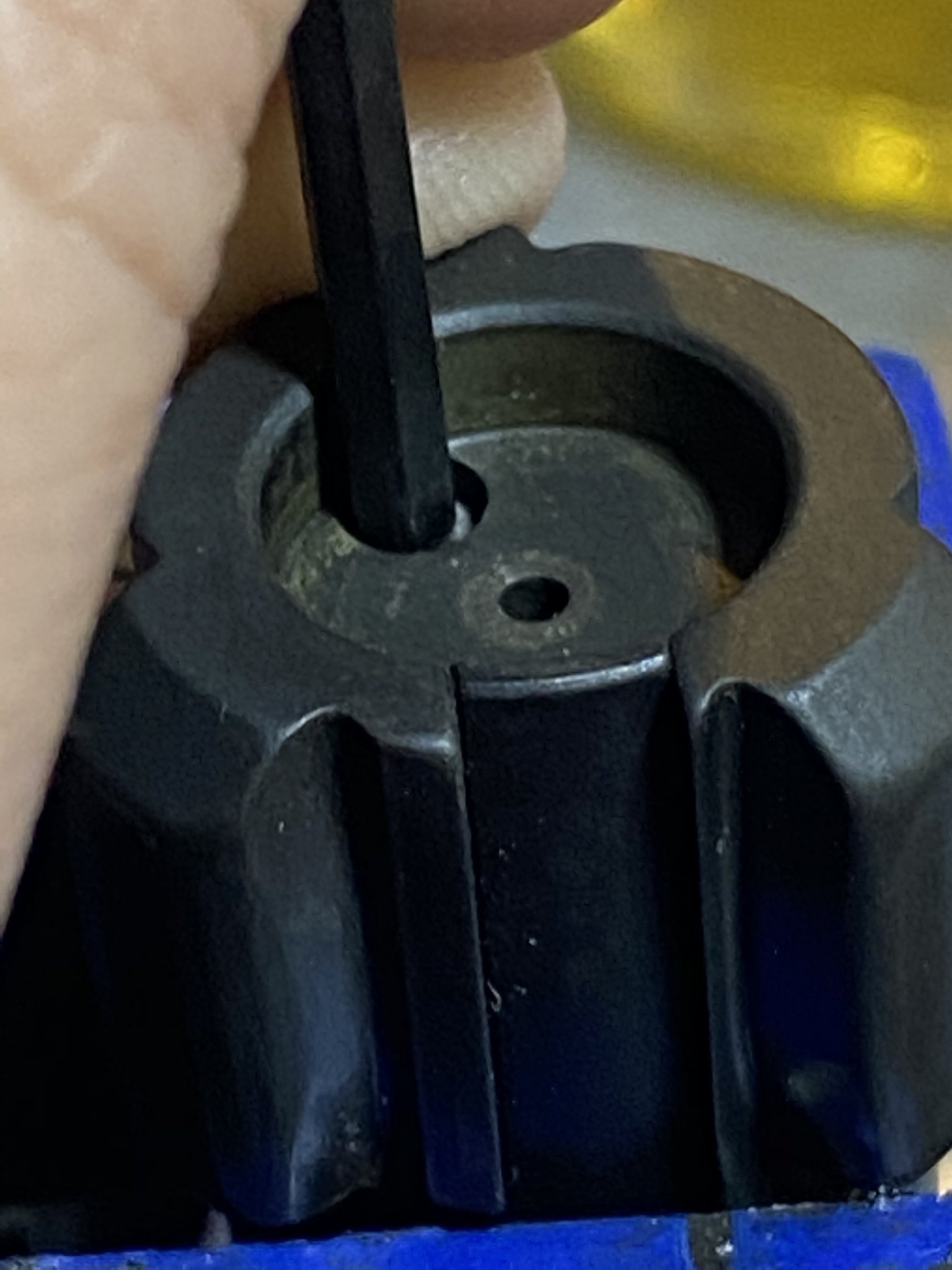

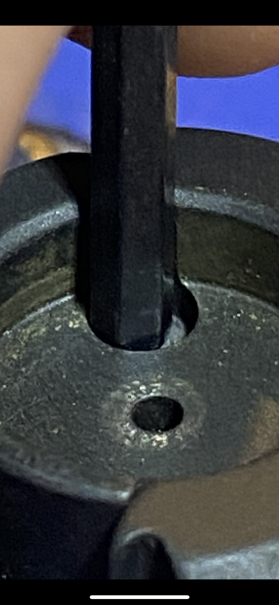

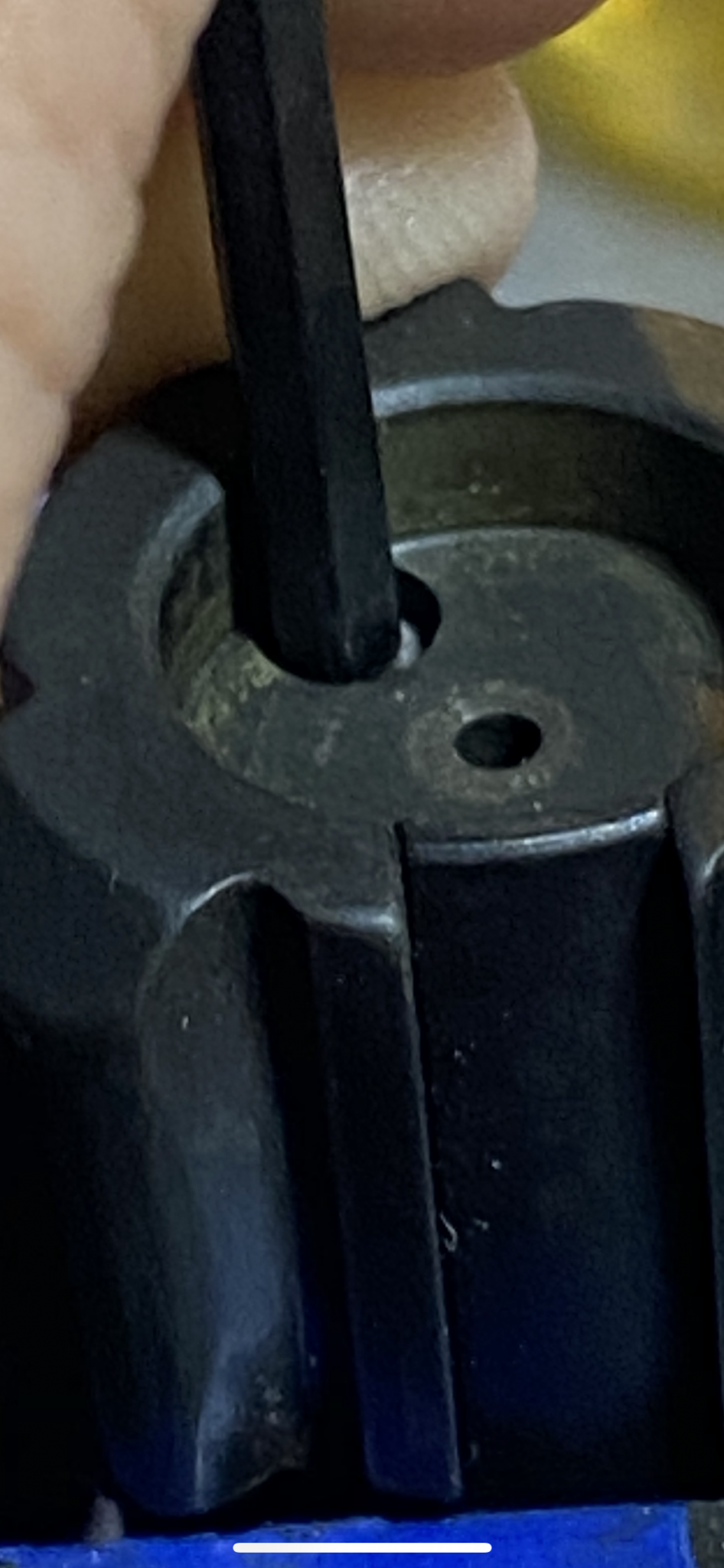

How about a picture of the ejector hole. Considering there is no smearing in the circles, I would suspect a bur or a high spot around the hole for the ejector. Who you get them from pressure. The pressure is forcing the brass back into the ejector hole. Then you get stiff bolt lift as you rub off the offending brass that is attempting to hold the bolt shut, via the ejector hole. The marks in O.P show no smearing which would lead me to look around and see if something is marking the brass.
I tried to take the best photos possible. When I run a knife across the face of the bolt and into the hole, I do not feel any raised surface or burr.
It looks like a high spot around the edge of of the hole to me, like what you would expect if a drill was pushed through from the back side. Are the marks accompanied by heavy bolt lift?
I have a Howa 1500 that did the same thing with light loads and no other pressure signs. Feeling the case head with a very sharp knife it’s definitely indented in the case like you’re talking about.
Looking at the bottom of the fp indent, I see signs of metal wanting to pop back out. You’re going to get pierced primers. Could be not enough neck clearance or too close to the lands.
