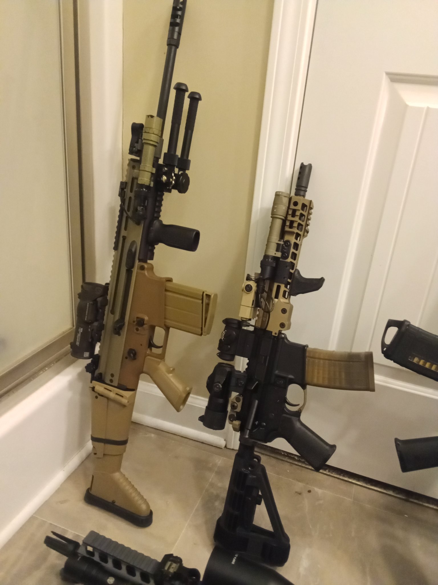

Heres a mk17 and mk18 goodbye

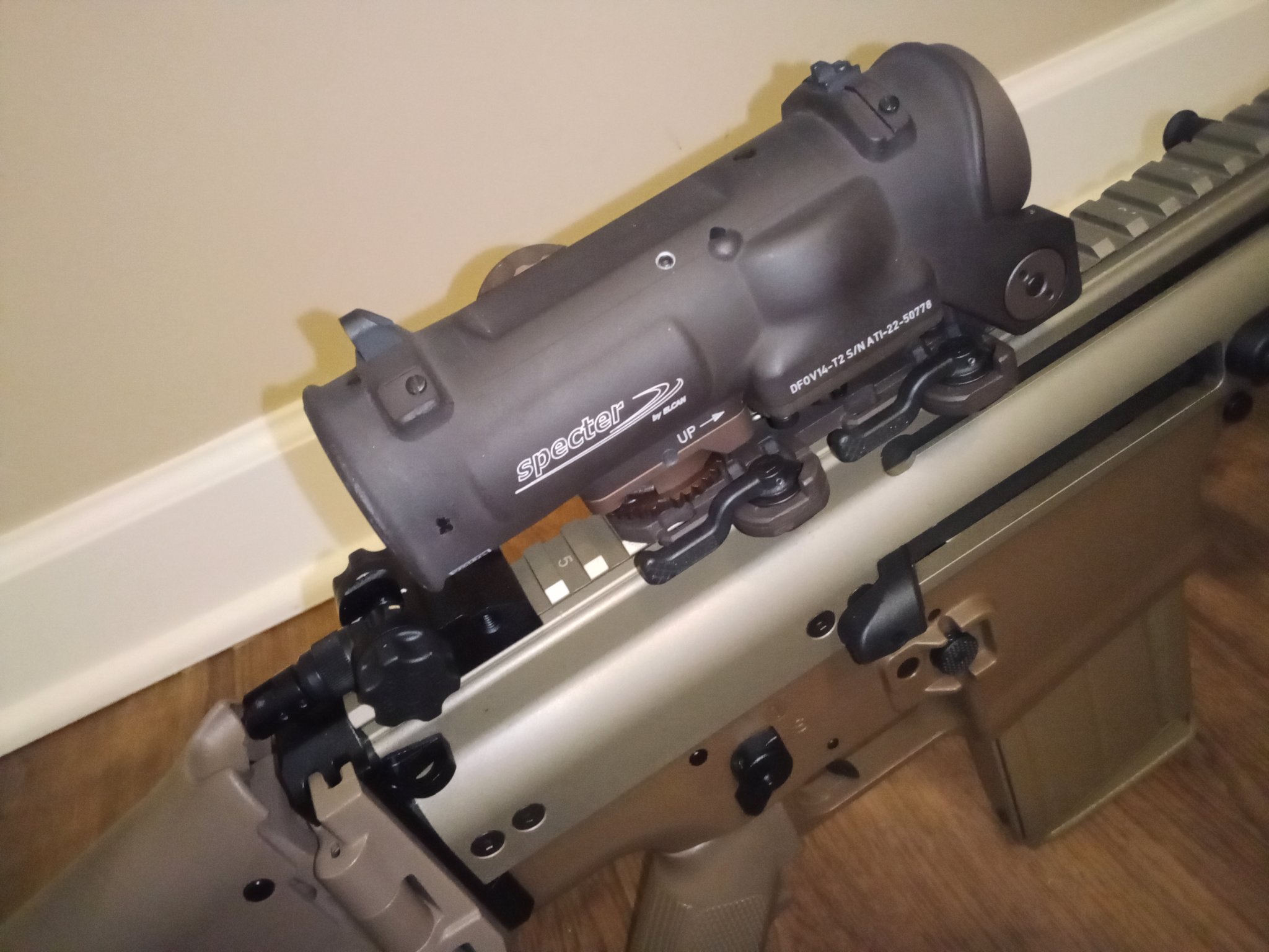

Added note: The Elcan looks too far forward for proper eye relief. In order to get a full FoV and a consistent eyebox profile, you will want to move it back until the edges are sharp. This distance is closer than the manual suggests (about 2.15" in practice). My advice is that you start by moving the optic too close to your eye, and then you move it forward just enough for the scope shadow to disappear.
Usually you will want to mount the Elcan at least right in front of the rear BUIS. If you extend your stock by any great amount, you are likely better off removing the rear BUIS to free up some additional mounting space. The rear BUIS can then be placed in front of your scope - this will still work.
I had it closer to the stock but i get perfect eye relief where it is as I have a brontosaurus neck.
