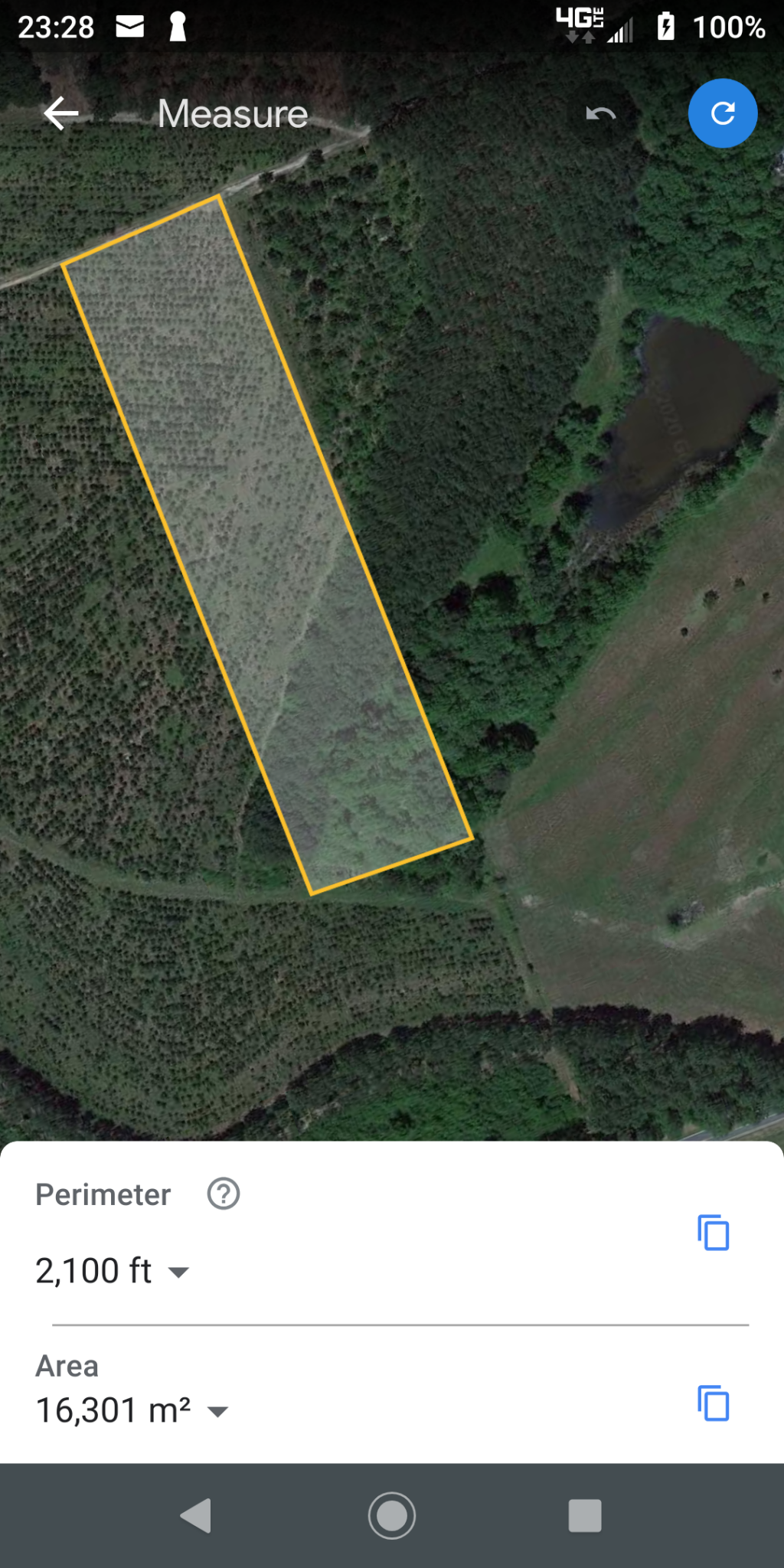

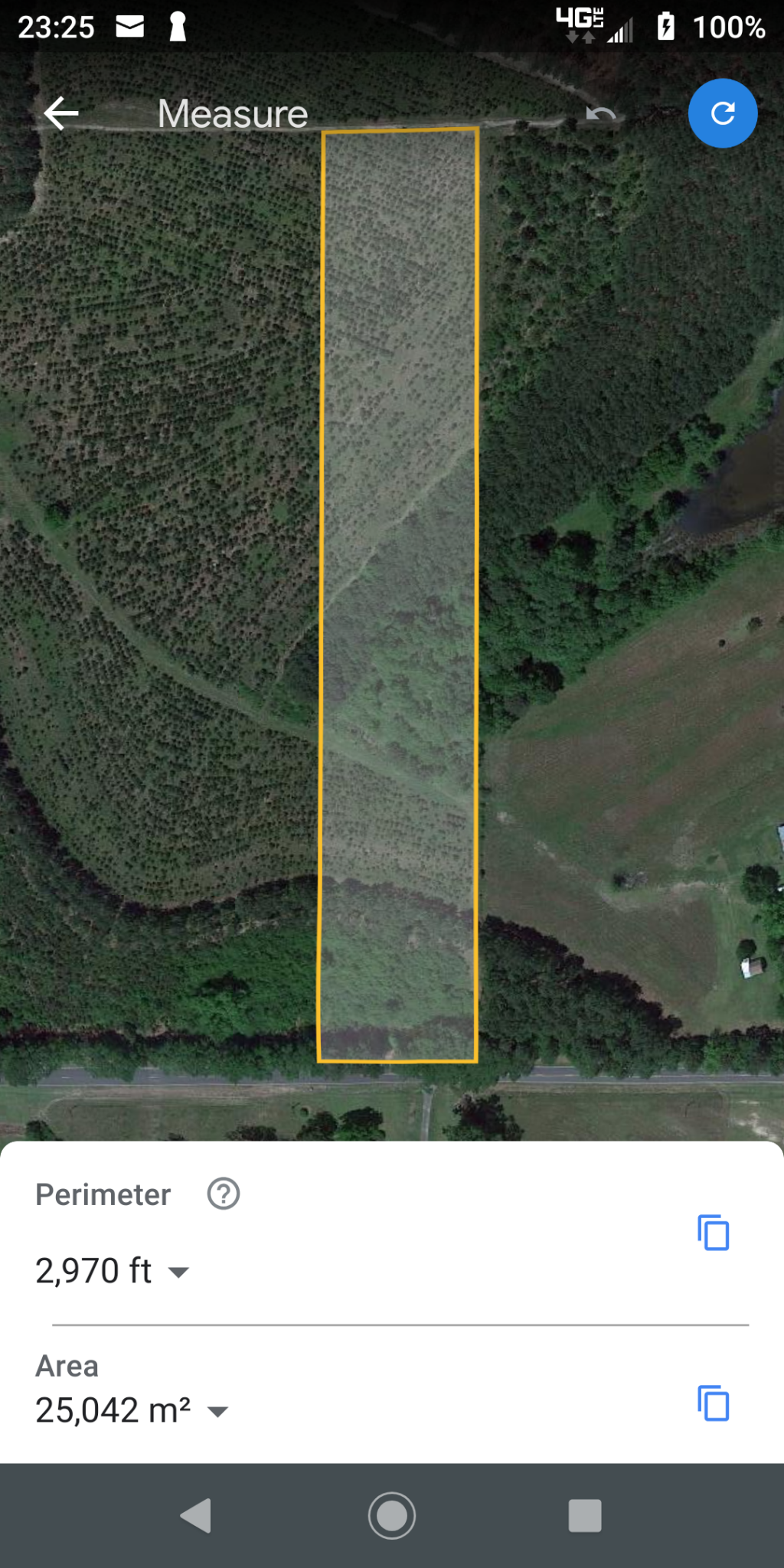

My land clearing guy did some more work last week. I gotta go tomorrow and check it out, pull my septic permit, and I reckon....put up a 'lectric fence.
I figure I'm gonna have a good 275yds to put out steel.
