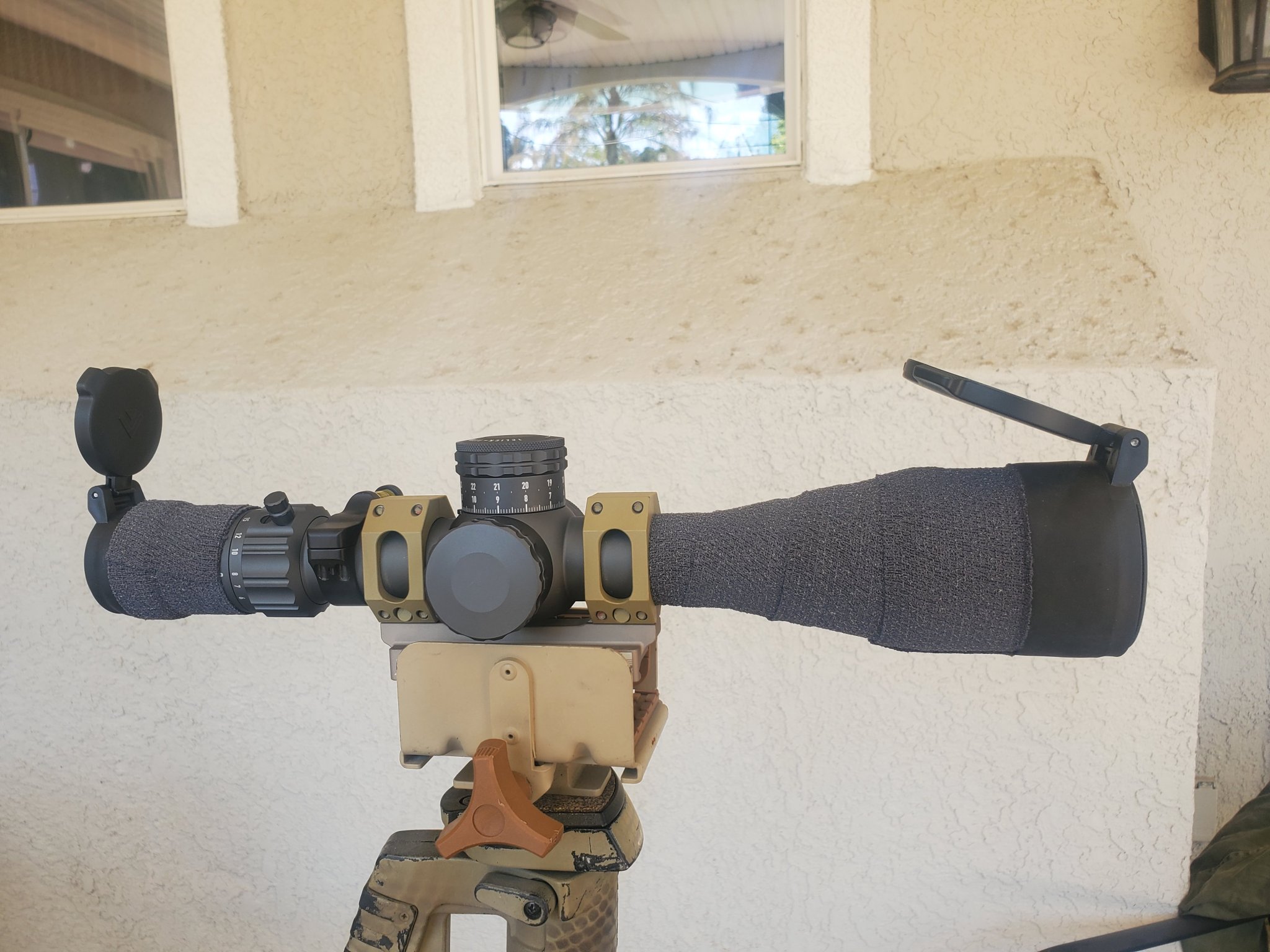

    I am going to preface this opening statement by saying that I can only find 25 mills of internal elevation in dialing, not sure if the norm is to include stadia in that elevation equation. So glean what you will from that statement. That said here is what I think, IMHO.

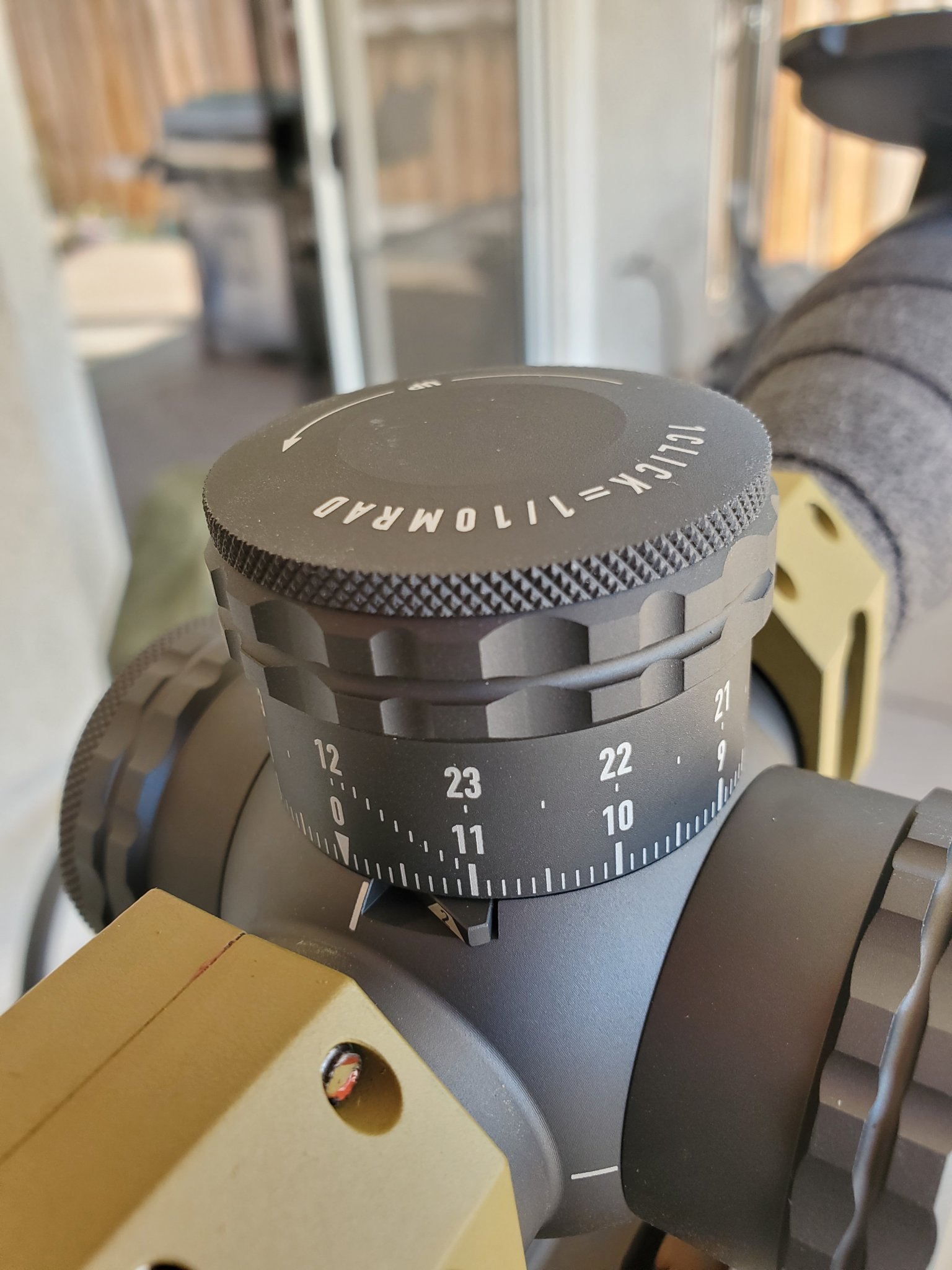

    The Element Theos has the easiest turrets I have ever used, the feedback is nice and crisp, the second rev indicator is awesome, tracking seems on point, and above all else it's a completely tooless design. Even the zero-stop is tooless and integrated into the design with - .5 mils of travel for corrections. The cap simply screws off with finger pressure and is re-set at the Zero of your choice. The windage turret is capped for set it and forget it.
    The glass from edge to edge is as clear and equal optically to my Zeiss S3 and my ATACR scopes, the Theos only trails slightly behind my Vortex HD G3 6-36. The eyebox on the Theos is forgiving even past 30x, that said I probably wouldn't use the optic past 30x. The field of view is fairly wide, not sure on the exact dimensions of the FOV but it's good enough for me. It's very equal to most of the optics that come out of the LOW factory.
    The reticle is great, at least I like it, it's fine and does not get in the way at any magnification, the stadia is de-marked at just the right positions for the shooting I do. I have not used the illumination yet, that's because I don't have any need for it, but it seems ample in twilight conditions.
    The build quality is top notch, it's seemingly very rugged and nicely designed, of course and once again this will play out over time to see if it ever craps out. Once again it's seemingly on par with anything that comes out of LOW in Japan. Personally I would probably trust Japanese made optics above European or US...sadly.
    The concept of purchasing this optic was for a switch barrel rifle (SRS or AIAX..etc..), where you could record the offsets and simply go back and forth between those settings easily and without tools. We will see if that can play out as theorized in practice over time.
    I will update this post if I get any new and meaningful data when using the optic.

    ILya has looked at this scope at least initially. He seems to like the turrets a lot but he still said that the Gen3 Razor is the one to beat and is the best bang for the buck in the sub $3K range in this scope category.
    I like Theos a lot and out of the current crop of Japanese 6-36x scopes, I think Theos has the best turret feel.
    Image quality is very good. It would be interesting to see how it compares to Zeiss S3, but I suspect they are pretty close.
    I think Razor Gen3 does have a better eyepiece, but Theos is no slouch.

    Off topic as far as the thread goes, but how those rings are mounted worries me. There is no gap in the rings at the top, which from my understanding of that particular ring design there probably should be. The two bottom screws on each ring need to be tightened first and can be a fairly high torque value as they shouldn't be squeezing the scope. And then the top screws should be torqued to the recommend torque by the scope or mount manufacturer. Just my two cents.

    You will be plesantly supprised. The Theos is a very monolithic device meaning in that all the controls glide and feel the same, no rough edges, the machining is fantastic, the tracking seems very good, and the mechanical and optical qualities punch higher then it's price point. Of course, and once again I believe the turrets to be the best of any high end optic and truly 100% tooless. Even the TT you have to set the zero stop with a tool I believe. I have owned a lot of premium optics from SnB, Kahles, NF.. etc... this is right up there.
