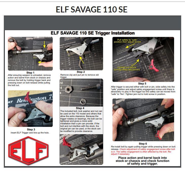

I wonder if it's compatible with those of us cursed with the bottom bolt release. Their compatibility list is lifted straight off of Timney's website...same font and everything. I wonder if this is on the up and up.
It looks like it to me. It lools like you will still use the factory sear. That is what has the lever for the bottom bolt release
a gunsmith can mod a receiver that was a bottom into a side in about 20 mins, its just a function of adding a clearance cut on the side of the receiver. The trigger would work for both but the sear remains the same.

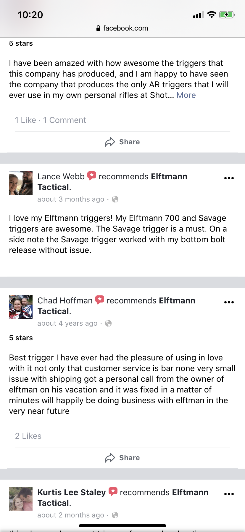

wondering the same
Saw this on their fb review page. Apparently it works with bottom bolt release.

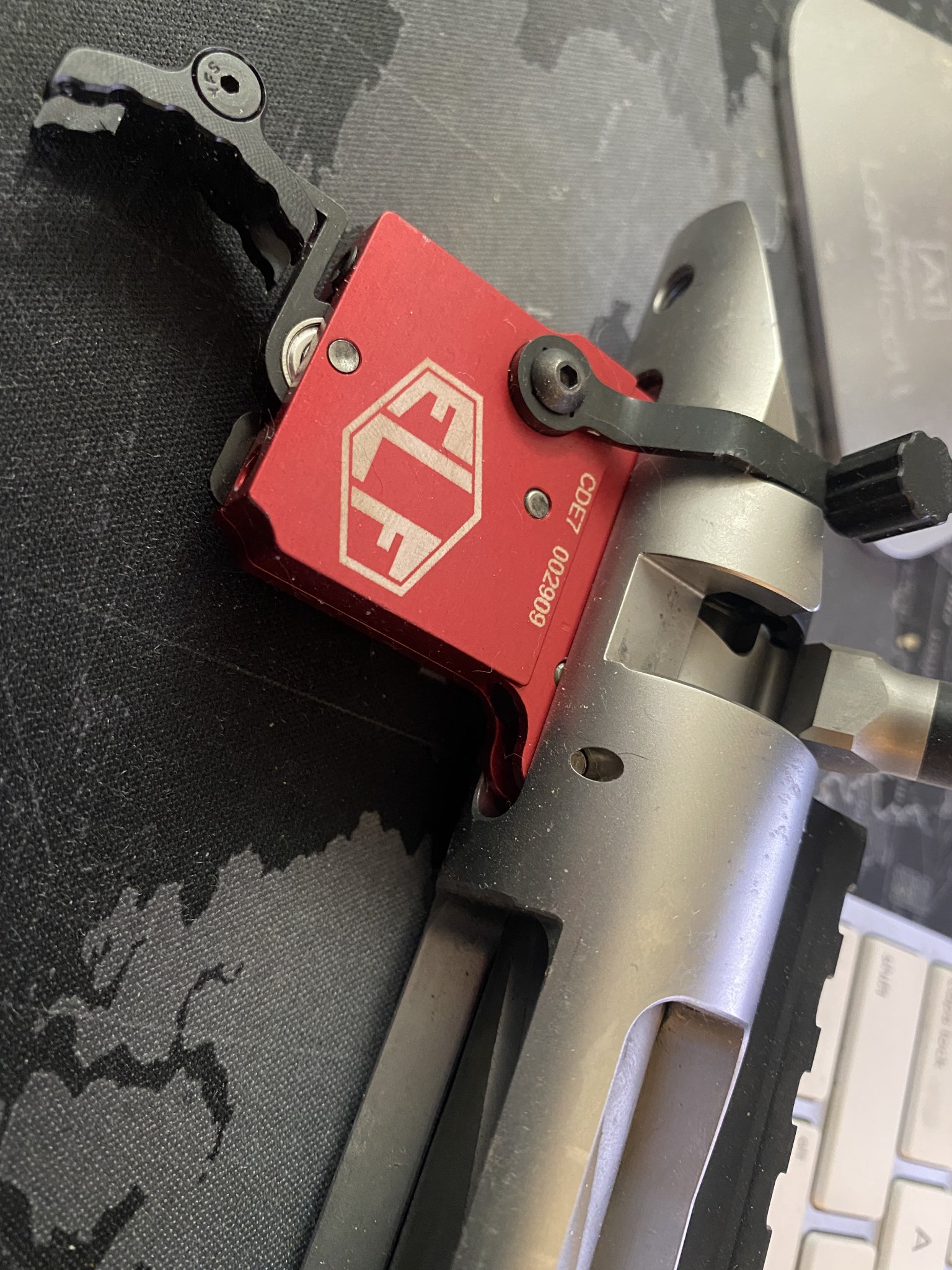

I have 2 on Savage rifles and one waiting for my Bighorn to come in. The Savage version is just a replacement trigger, not a full drop in replacement like a 700. You are just replacing the trigger, it drops into the trigger housing and you use the factory sear. They are great single stage triggers.
I got he first one a while back, probably pre-release or right after.
I also noticed some of the same issues with the Savage Elf. as mentioned in the video. On the first trigger I received, I ground down the top of the plunger to allow more threads to engage and be safer setting the trigger to a lower weight. The screw was about 3/4 the way out set to 2 pounds, which I was not comfortable with. I was afraid it would back out the rest of the way during firing. Grinding the plunger down allowed for me to set it at 1.8 pounds and still had a little more than half the set screw threaded in. I met with them at Shot Show and discussed this. I got a new trigger this week and it seems they resolved this, shortened the overall length of the plunger. I still use a little loctite on the threads to ensure it will not back out.
And in the video above, what happened to Brad was not a trigger issue. He did a bolt lift and bolt body cleaning/polishing to smooth out the action and took too much off the bolt body recess where the cocking pin rests in the cocked position and it did not fully engage 100% of the time. He is a machinist and it was fixed as soon as he got home. I was there, he is a friend of mine and we worked his 300 PRC build together.
I put one on my tac 110 in a mdt chassis and wow what a difference, I left it at the factory setting around 1.5 lbs and it is so crisp it is really a perfect trigger for my rifle. My groups shrunk by a bunch now regularly shooting .350 groups from .600. makes a huge difference at 1k:)

My final review is that this is a really nice trigger for savages at least, and better than the factory accutrigger.
