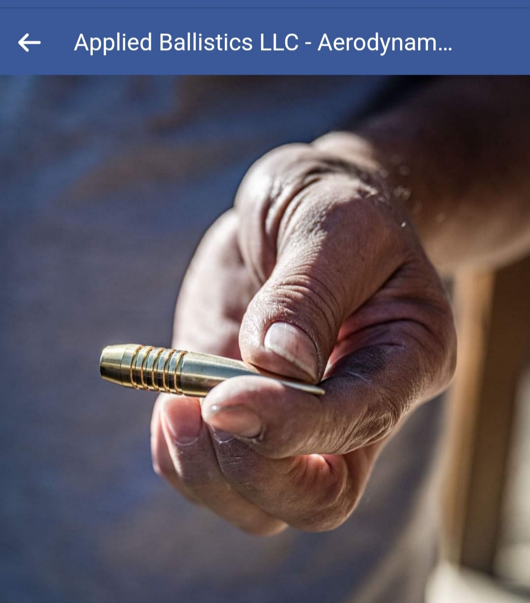

The bullet Randy shot has a drive band (it just has shallow angled shoulders) and a fairly long shank that is just over the lands in diameter. Particularly on a K&P which are a bit tight. More distinct drive bands often have lower amounts of metal displaced during swaging into the bore. They will create a more noticeable drag point in supersonic flight but often times the position of that increased drag can move the center of pressure closer to the center of gravity. Remember, drag in the right place can be stabilizing which is why engineering a bullet strictly for BC is often a failed endeavor in terms of actual performance.
Are you talking about Randy ofstad or Randy powell? Just to not confuse anyone.

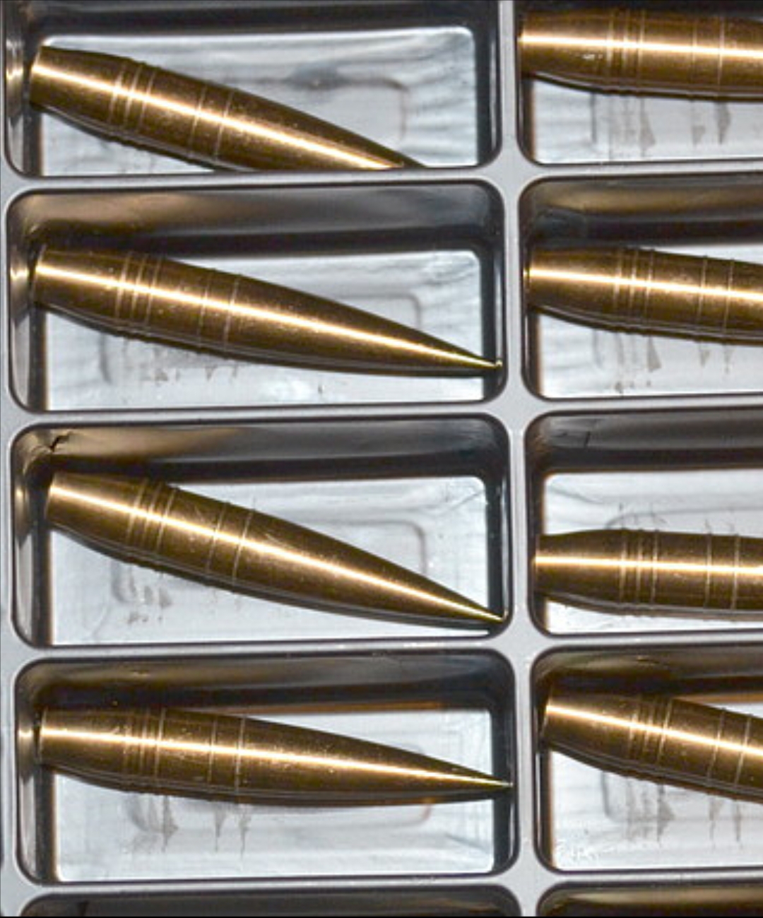

I have seen bronze/brass bullets at Windcut bullets, 520 grain .416 cal. But I do not know what alloy is used. If i remeber correctly they did even make 570 grain or 575 grain bullets. Does anyone know what alloy it is?

I couldn't tell you if they are that or C38500. It hardly comes up in conversations. I'd be surprised if I haven't shot bullets made of both. One of the more interesting post machining tweaks I've seen is annealing the bullets in a vacuum furnace after machining. Result is noticeably less fowling but I don't know any manufacturers that do it themselves.
Ofstad. I've found his bullets downrange and the engraving on them is distinct. I'll post a pic if I can find one. The 460 make some great flowers... If you just look at them you wouldn't really guess there is a drive band but if you run calipers down them it is obvious. The shoulder angle on the band is shallow so it doesn't stand out like on a laser. It is still a drive band bullet though. Larger bullets have dramatically higher surface area on the shank than on little guns so the few bullets that are not drive band bullets are kinda terrible. Amax for instance in the 50 can't be driven very quickly because there is nearly a full inch of full bore shank that needs to be swaged into the bore. 750 grain solids by comparison can be pushed about 300 fps faster pretty comfortably. Nobody makes solids that have full bore shanks for large bores.

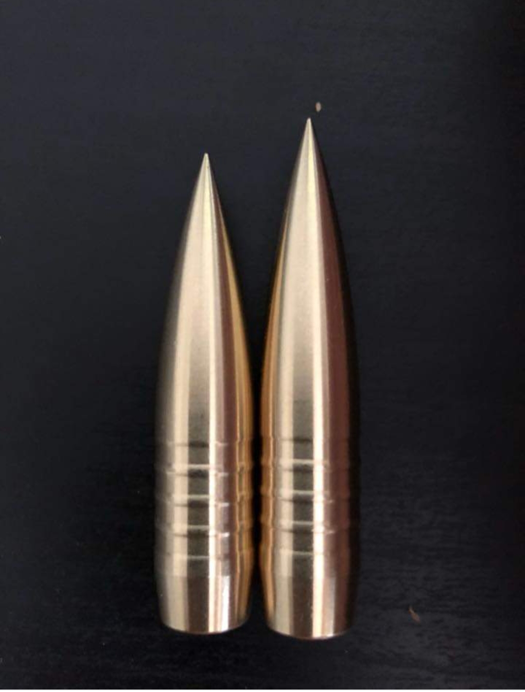

There are a lot of different approaches to them. Most have a drive band at the back and then a land diameter shank (bore-rider) or slightly over the land diameter (Usually called hybrid). Some have a drive band closer to the middle for one reason or another. The multi-band bullets have fairly high surface drag but can be pushed pretty fast without pressure signs so it is a tradeoff. Some split the difference and have a primary drive band and then a second smaller one towards the front. I think cutting edge calls it a "seal tight band" but it is essentially the same as a bourrelet which dates back to about the civil war.
badassgunworks more or less described this initially which is essentially a truncated Sears-Haack body. If you do the math, they end up with a fair amount of material that needs to be swaged during engraving so they are slower than comparable weight bullets. They have a tendency to engrave off axis compared to bore riders and they are simply not stable in flight. A bullet with a great BC that can't hit the broad side of a barn is probably not the next great thing...

The 460 that Randy O is shooting makes such great flowers because of the alloy that badlands uses. It is very distinctive compared to others

They dont use free meching copper they use 99.9 % pure copper c-110 or c-101 c-102

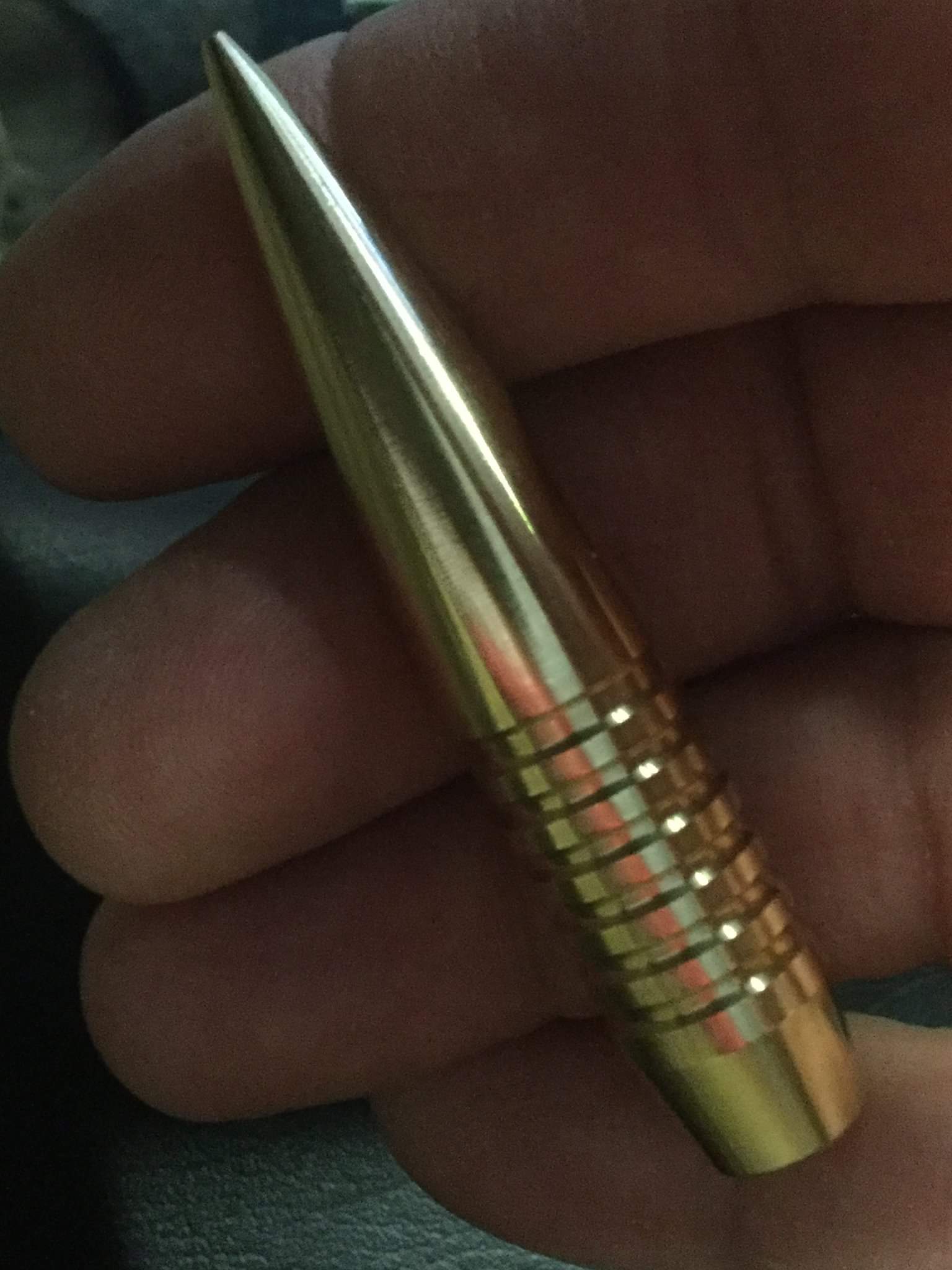

Does anyone know which bullet it is?
Looks like a thunder ammo bullet but I think Lehigh made something similar at one point too though. The rounding at the very tip makes me thing it was made by Lehigh. Hard to tell if that is a Von Karman nose profile but both use it. The banded solids can be pushed pretty quickly safely so they trade MV for increased body drag.
