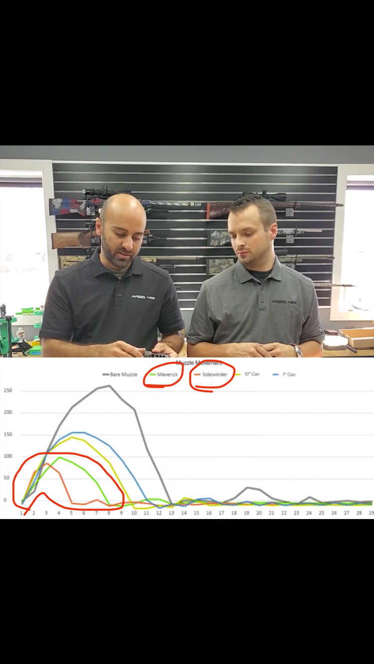

Area 419 is developing a suppressor that works not only as a suppressor but also a muzzle brake. The idea isn’t to fully suppress the muzzle blast but to remove the concussive pressure and also work as a muzzle brake.
How many of you would be interested in an ELR version? I know I would. I have a Crux 375ArchAngel in ATF jail but really the only reason I bought it was to be able to train for ELR and not turn my brain into mashed potatoes. I personally struggle to make I through an 8 stage PRS match and shooting ELR isn’t any better for me.
Anyways below is a 17min video they just released. I’m hoping something like this could be adopted for ELR for my personal reasons mentioned above.
What are your guy’s thoughts?

I ask anyone commenting to actually watch the video to understand that the suppressor portion of the can is to reduce the concussive blast while still allowing gasses to flow into the brake to reap the benefit of reduced recoil.
Regular suppressors slow the gasses to the point that the muzzle brake pull off effect doesn’t happen. This suppressor/brake will still allow that to effect to happen.
If you don’t watch the video then you’re not going to be able to have a sound response to this thread. This “suppressor” isn’t like anything done before because it’s not designed to completely reduce sound signature like most other suppressors.
Reactions: Hollywood 6mm
So the area 419 is a hybrid more or less half the recoil reduction as a full break and half the noise reduction as a full suppressor.
On another note how would a brake inside a can add any recoil reduction benefit if the gasses aren't being expelled out in the direction it was designed?
According to AREA 419’s testing, it provides about as much recoil reduction as their Sidewinder muzzle brake. Sound reduction numbers haven’t been published yet.
Correction: “muzzle movement” because staying on target is the name of the game for what it was designed for.
