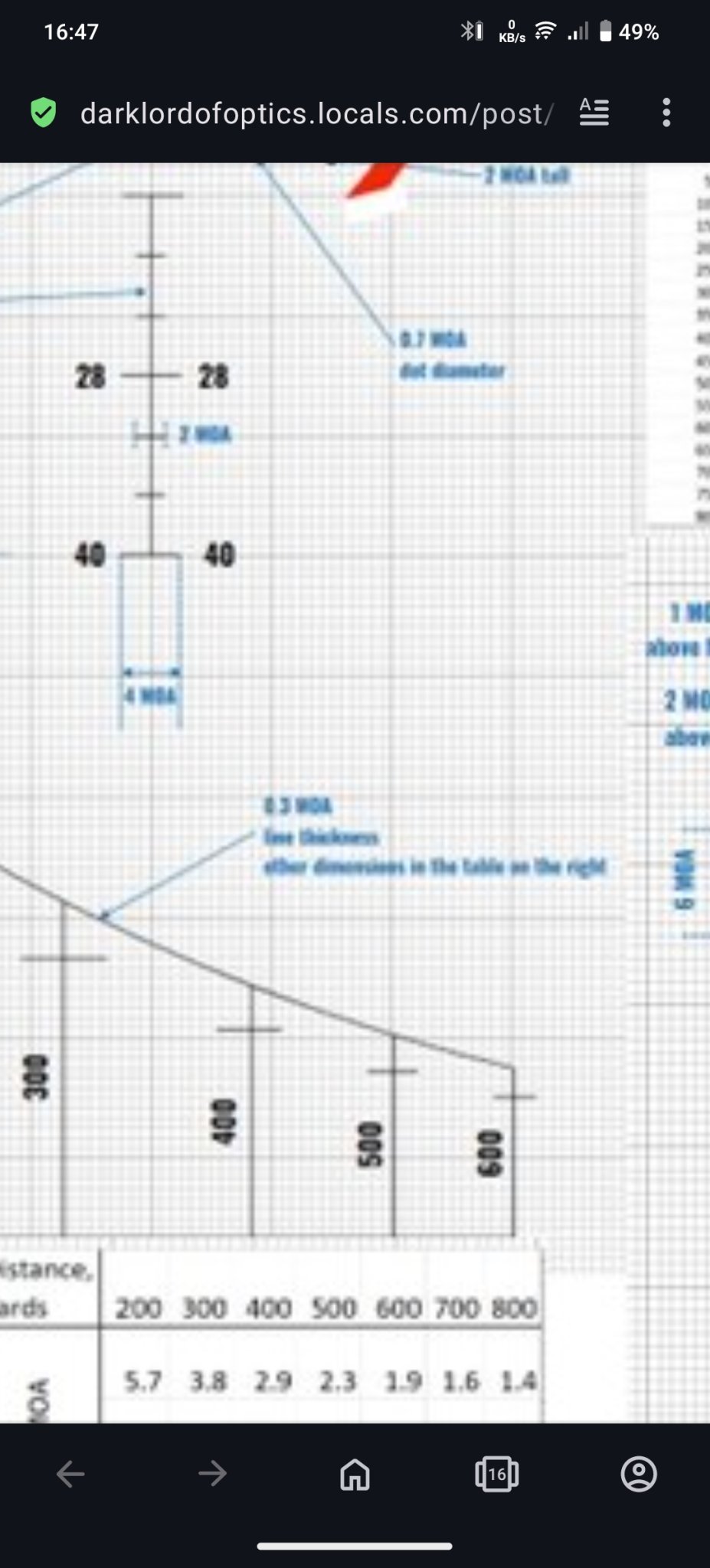

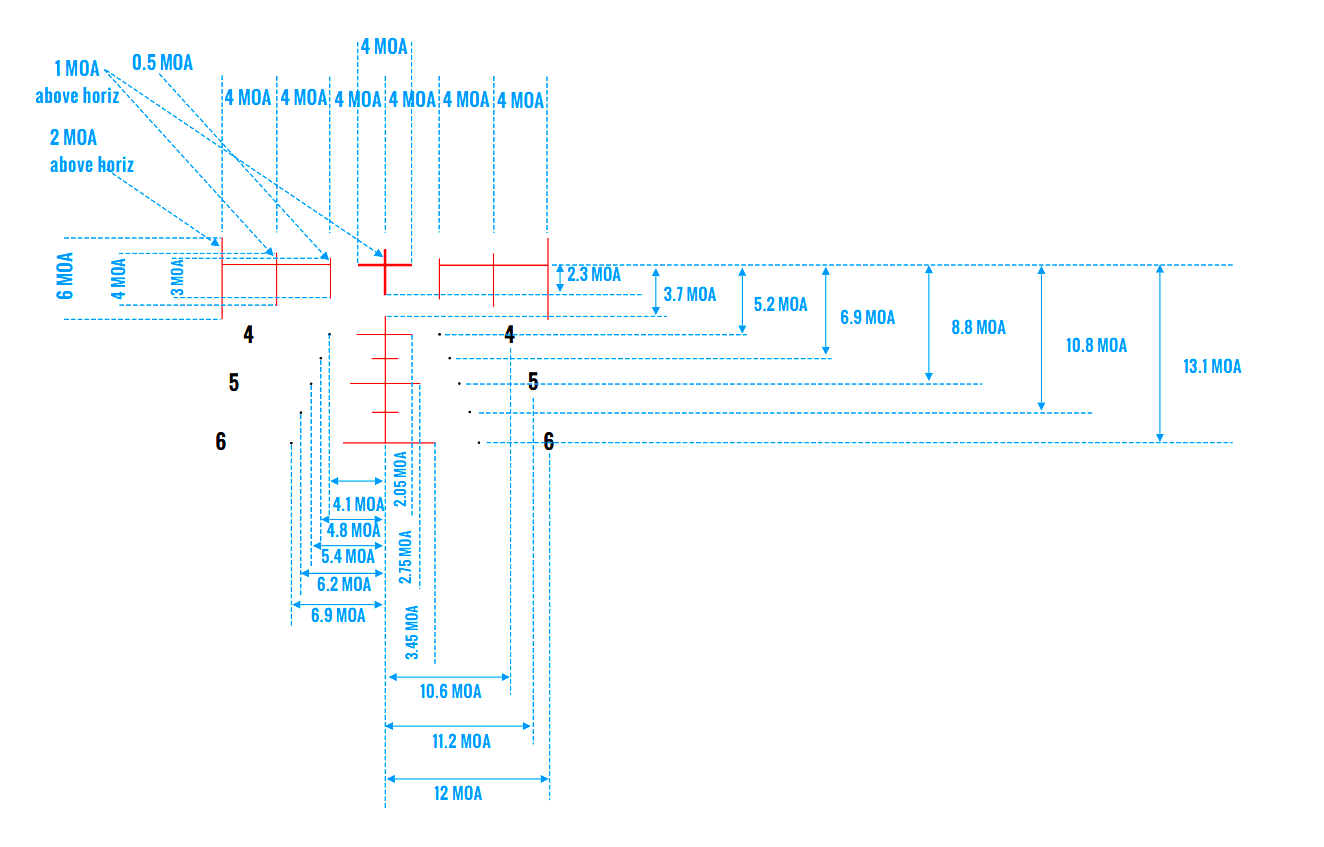

Hi Ilja
Can you post or attach a higher quality image of the BDC reticle diagram showing the subtentions, please. The text an dimensions show very blurry when I try to look at it.
Also, how does the ranging with the bottom diagram work? I cannot find any manual for it.

Are you looking at from your phone? it looks quite sharp through the browser on my computer. You may want to try on a different device.
The ranging is for a 70" tall object (long vertical lines). Horizontal line is 18" at each distance (shoulder width). Vertical line above the horizontal is 12". Vertical line below the horizontal is 58".

Thanks for the explanation.
I tried the opening the page on my laptop, but still does not show the blue text clear at all. Some letters I can make out due to the shape, but that's about it. The image on the site is only 840x630. Do you know where I can get a higher resolution image?
