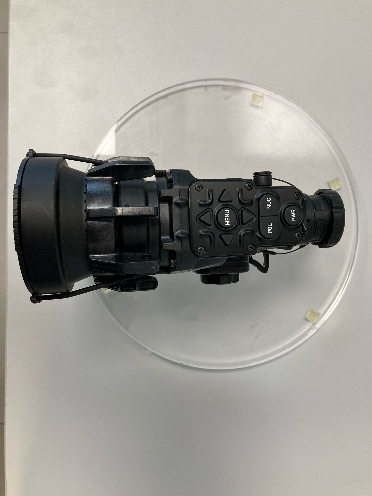

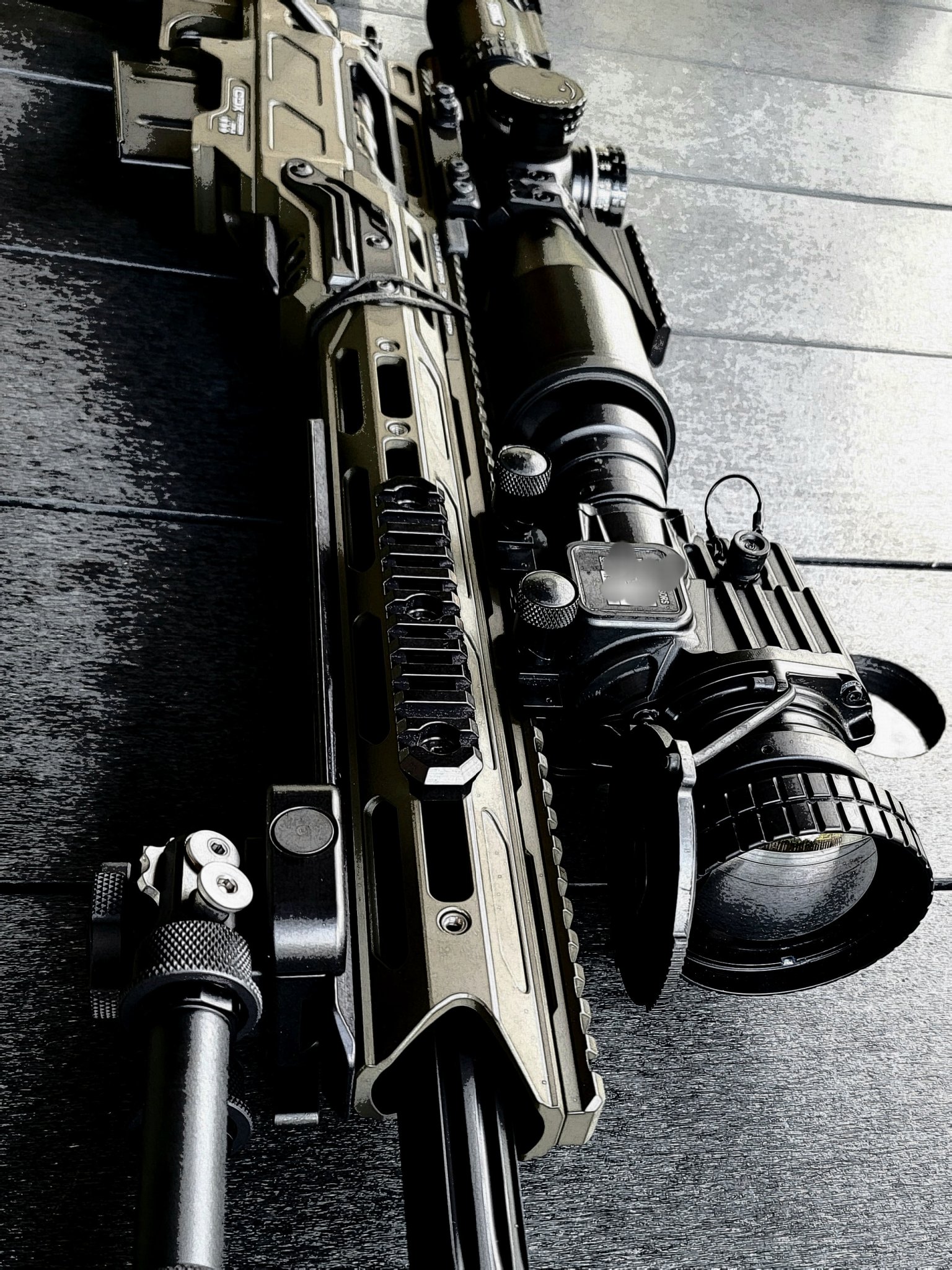

As many of you know, EOTECH has released a new line of thermal optics in the US. They are working with Theon Optics out of Europe and the clip ons are being rebranded under the EOTECH name and imported into the US market. All three of the optics share the following:
  • Ruggedized/50 cal rated
  • 10 yr warranty through EOTECH
  • Standard NV height above rail
  • Up to 10 hr run time on 4 AA lithium
  • Auto shuttered or selectable manual shutterless NUC
There will be 2 models that EOTECH will sell through their normal channels.
ClipIR
50mm f/1.1 lens
12.4 deg FOV (should be best on 1-6x optics)
17 micron
60hz with 30hz power save mode
640x480 OLED display
BH/WH polarity
MAP $12,119
ClipIR-LR
75mm f/1.1 lens
8.3 degree FOV (3-10x optics)
17 micron
BH/WH polarity
MAP $12,869
A third model will be offered by EOTECH through distribution by Down Range Thermal (limited #s)
ClipIR-xELR
83mm f/1.0 lens
5.3 degree FOV ( optimized for 5-18x optics)
12 micron
1280x960 oled display ( unity clip on mode is 640x480)
BH/WH/Edge Detect polarity
Optional wired remote avail
Winner of UK MOD SILLS procurement ( paired with AI 338 and S&B 5-25x56) and CANSOF Thermal Clip ON
MAP $15,989

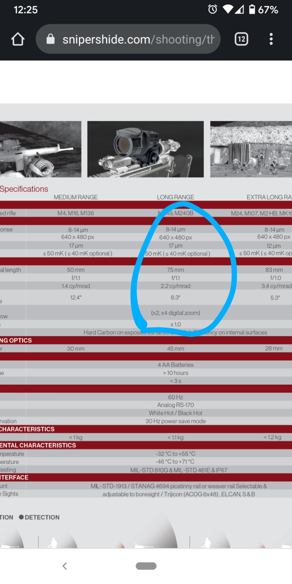

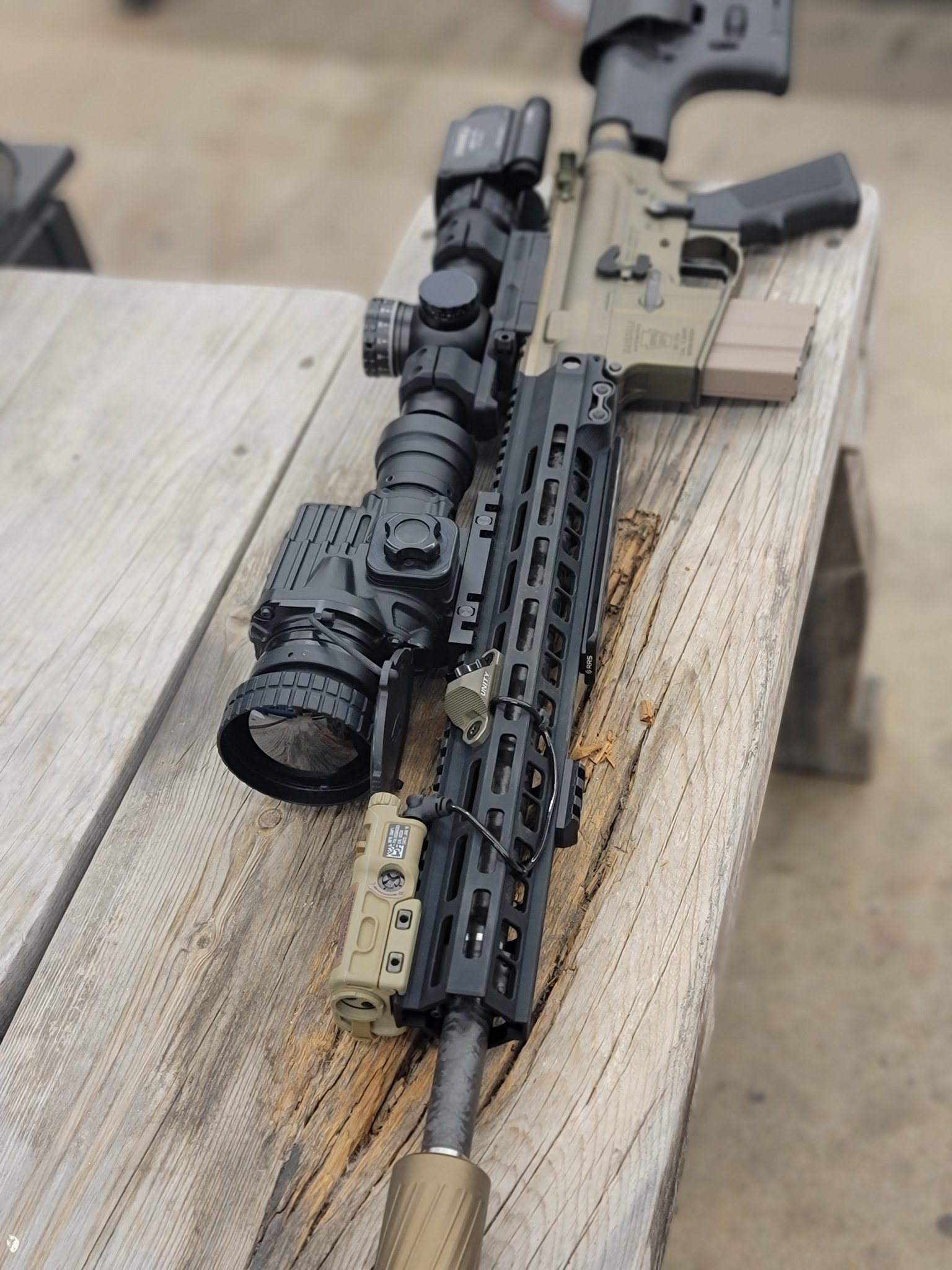

Can you elaborate on the numbers of the xELR and how available do you expect them to be, say in August or September of this year?
I'll say that as of now there are a little under 30 left avail. We may be able to reorder before end of yr but you know how this stuff goes.

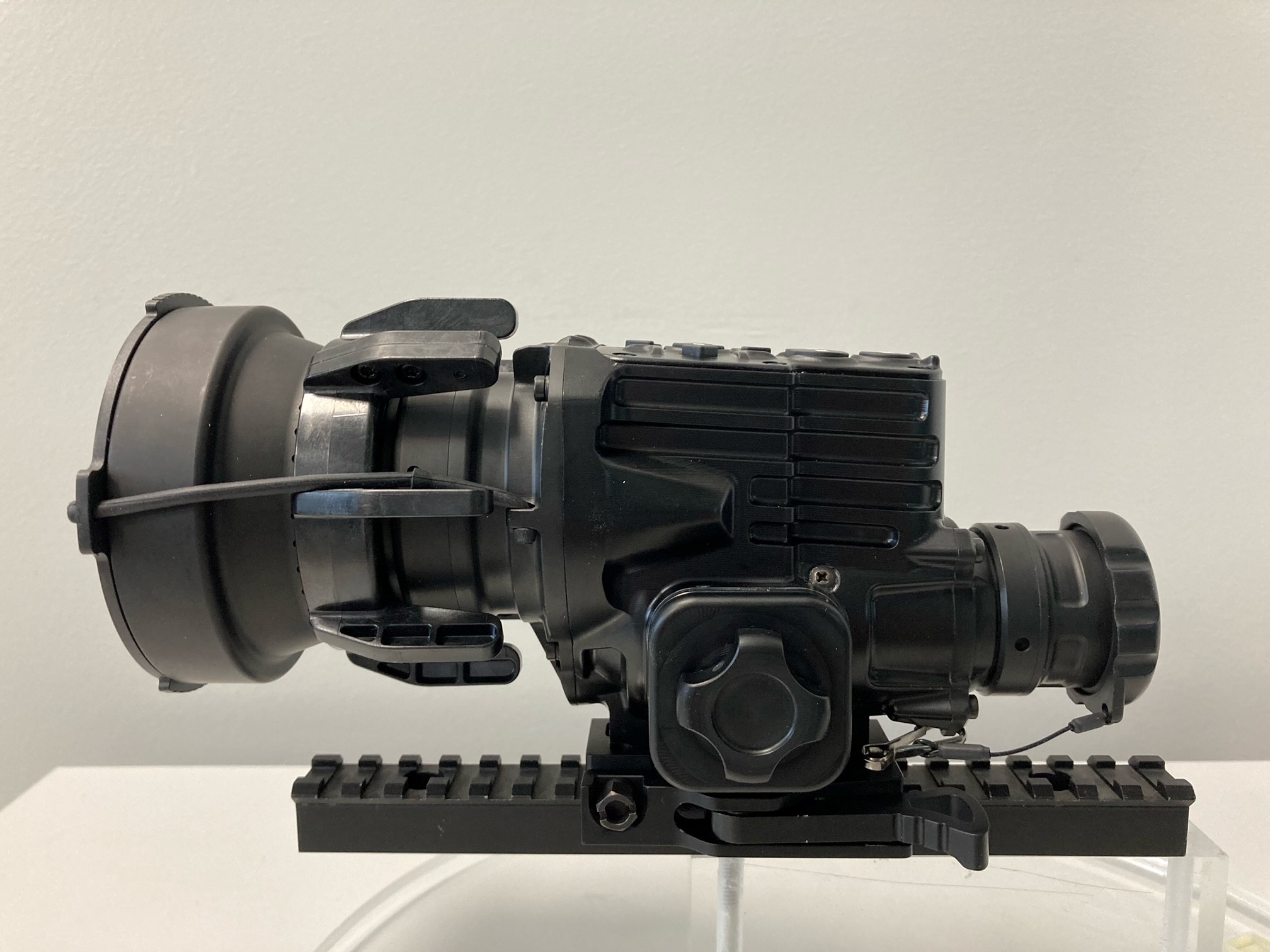

The stepped design of these is funky until you look at the LRF mounted in front. Makes total sense, I'll see what I can scrape together and let ya know!!
ETA: congrats on getting the xELR over here, I hope this is great for your business! MWIR next please :ROFLMAO:
ClipIR
50mm f/1.1 lens
17 micron
BH/WH polarity
MAP $12,119
ClipIR-LR
75mm f/1.1 lens
17 micron
BH/WH polarity
MAP $12,869
ClipIR-xELR
83mm f/1.0 lens
12 micron
MAP $15,989

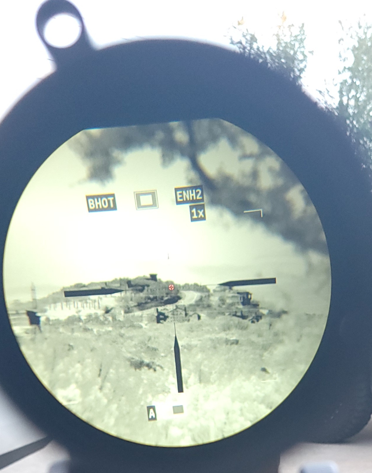

No X-elr units have been stateside yet so no. I did have the 17 micron LR for a week and was very impressed. The X-elr as referenced above beat out the utc and others in both of those UKMOD and CANSOF competitive processes. Those are extremely thorough trials. To be a product of record with two separate SF entities says something.
Reactions: Nik H and jstokes1

Are those FoVs horizontal or diagonal? If I'm reading it correctly, it sounds like the xELR has to be zoomed out to 0.5x to have correct 1x unity view for day scopes?
It has a reticle and could be used as a stand alone optic like a UTC. Not it's primary purpose but could be used that way. Edited....I have inquired how the full 1280 display is utilized and I am awaiting a reply from the manf. For now just look at it as a 1 to1 sensor display like a utc.
I don't understand what all of the specs mean, so can you break them down into poor people language? Lol.
Namely, how is the image and ability to aim at higher magnifications going to compare between the LR and xELR vs the Yoter-C I'm currently playing with?
The most important spec that I look for when comparing the thermal units side by side is Field of View (in degrees). Once you see it’s a 640x unit with frame rate of 50-60 and NETD under 40-50, it’s probably going to be a decent sensor. Then it’s all about the interplay between objective lens size and pixel pitch to give the effective magnification (or in the case of clipons with matching demagnification), or field of view.
The Theon thermals have FoV (horizontal) of 12.4, 8.3 and 5.3deg for the base, LR and xELR respectively. The LR you circled would have a slightly narrower FoV than the Super Yoter C, at 8.8deg. If you compared it to a dedicated thermal scope that doesn’t have demagnification, it’s similar to the Halo-LR at 9deg FoV and 3.5x optical mag. The VooDoo-S I’ve been playing with lately has a FoV of 15deg and I don’t like cranking more than 5x or so behind it. So I might guess the -LR Theon to do 9x or so before pixelation would get strong.

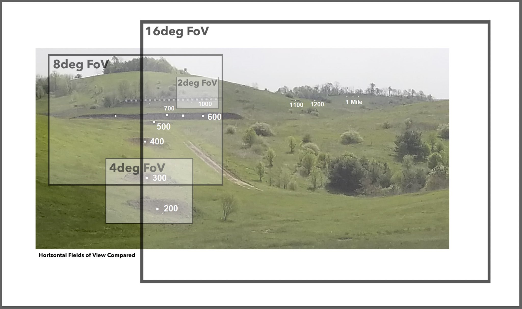

Here’s a diagram I’ve been using to visualize various FoV options at distance, on the TVP range -
Got a whole table of FoV values compared as I’ve been playing around with these, but maybe that’s for a separate post.

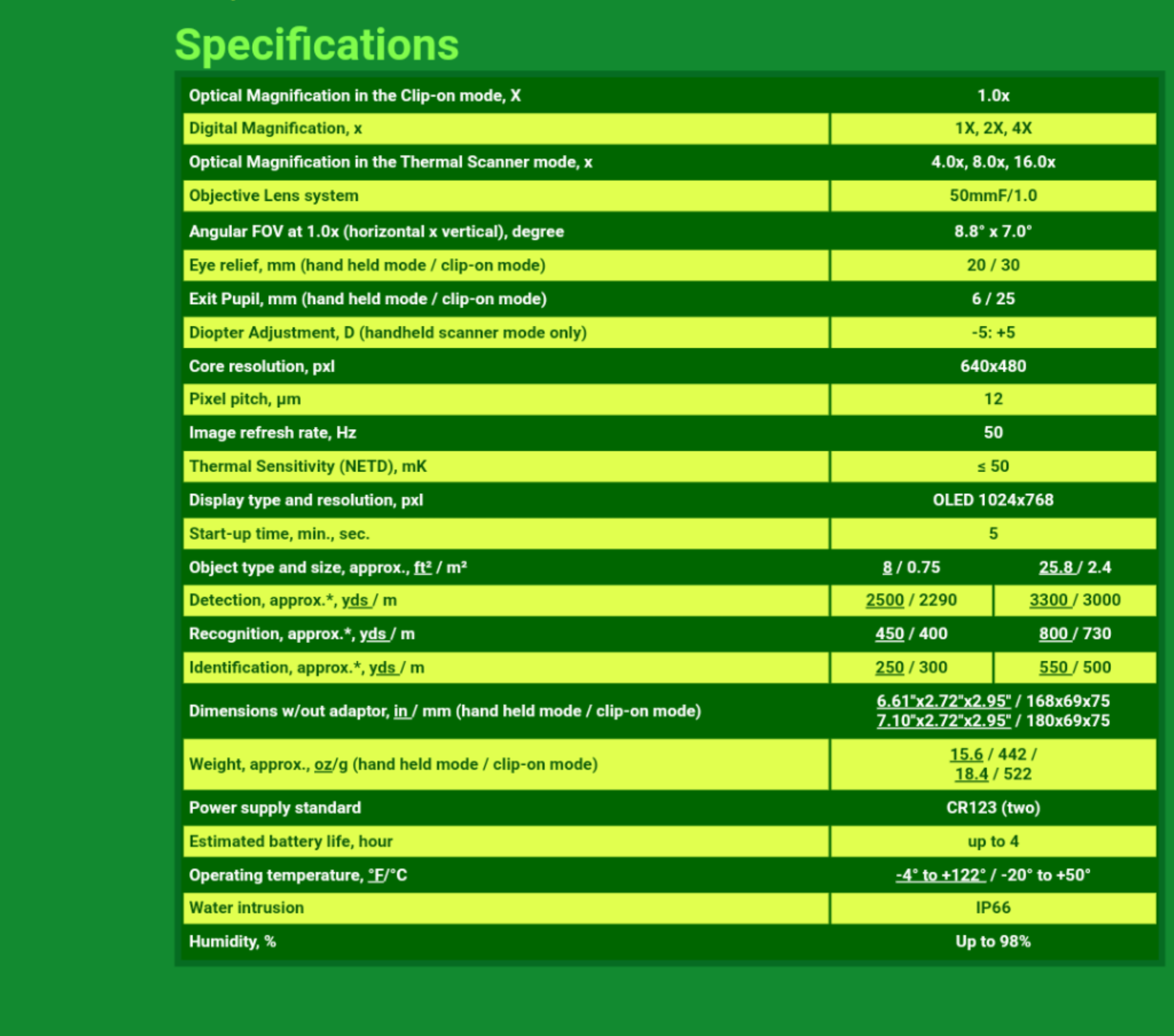

Spec wise the xELR should be neck and neck with the Xii.
A VERY in depth analysis of systems indicates that the xELR may be up to 16% better than the UTC-Xii when it comes to image quality as a high magnification thermal clip on device. I would say the rest of the situation is still in the air with regards to build quality/durability etc.
Specs don’t come close to telling the story about image quality.
Super hogster blows away most 320 core scopes with similar “specs”.
BAE core units (generally) out perform other 640 units with similar specs.
Etc, etc, etc.
There’s just far too much going on in the brains of these things to boil it down to specs. They are a good starting point, but 16% is WELL within the margin of error when all is said and done.
