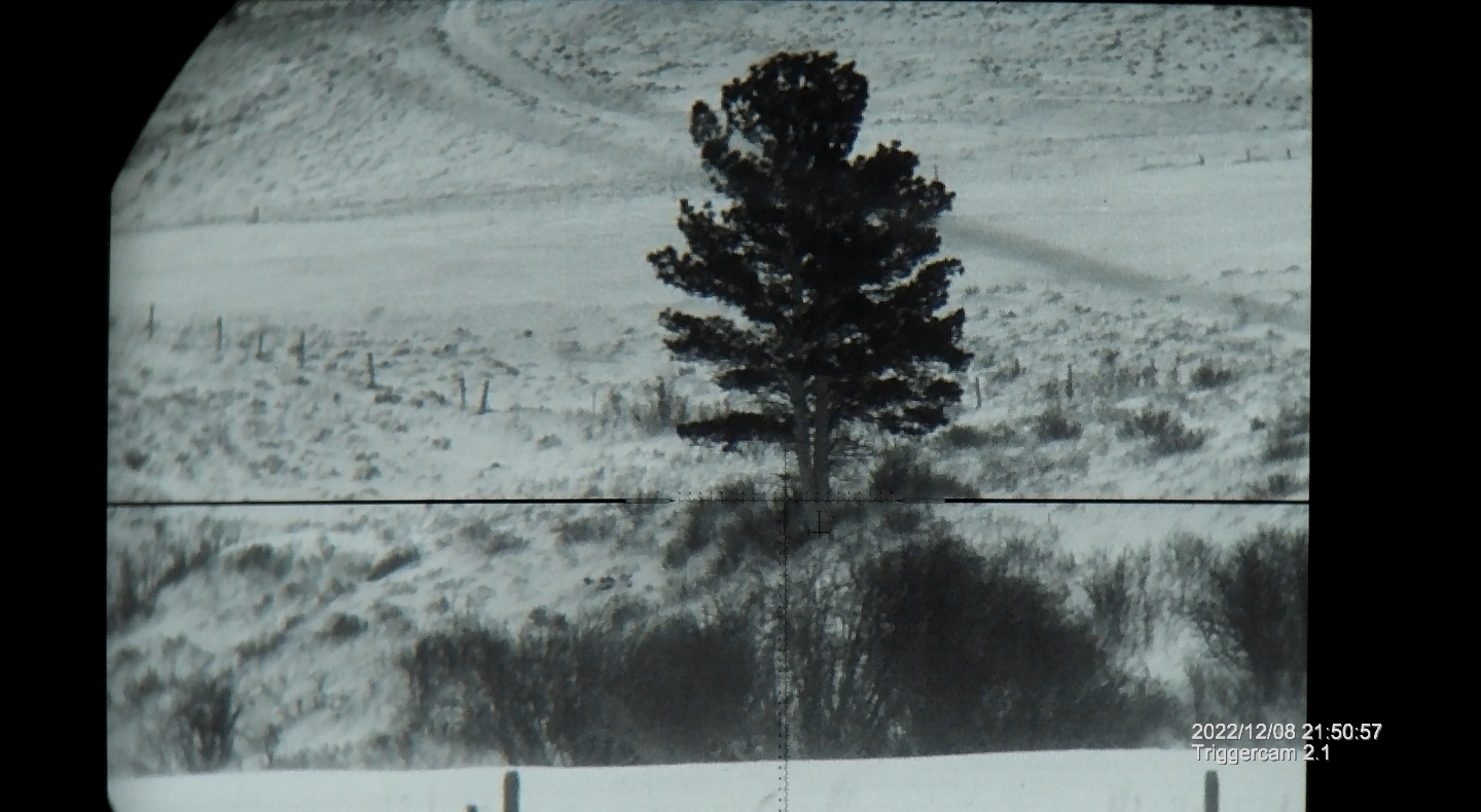

I like the scope cam videos but I feel they might be slightly out of focus. Is that hard to fix or is that not something you can see until after its recorded? (i dont own one)
Its difficult to properly capture video through the scope using thermal clip ons with a Triggercam. I did some video through the xelr Mk 1.5, and it was never a 1 to 1 ratio to what you see with your eyes. That's partially why I never posted my video through the xelr that SOK/Preston&Joe sent me since it was disparaging to the unit. I'll still posted it up though for those that are interested. Took lots of tinkering to get it looking somewhat decent.
Here's a still from that video

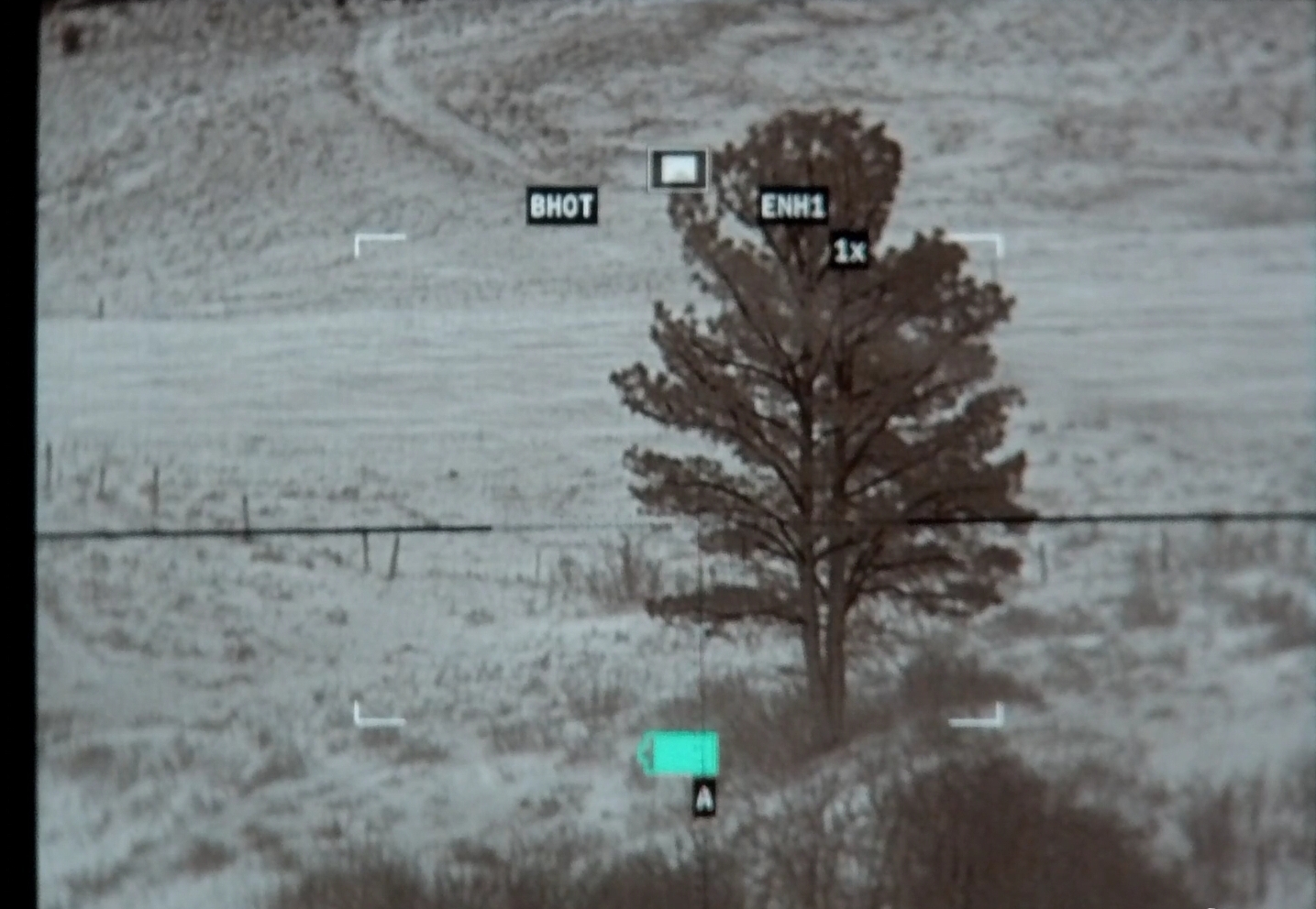

Anybody have an issue with the screen (XELR 1.5?) giving a phantom like effect (like an imprinted plasma kind of) that overlays the actual image so you can't make out any detail. It was ~20F and that is the only thing I could construe as a contributing factor (even thoughI specs say ??).
I pulled the old "turn it off, then turn it back on again" routine and it actually worked, but its like a clock started until the issue cropped up again.
Do you guys have an idea of what temps/humidity/day-night/cloud coverage produce best/worst contrast et al.? I also felt like my image wasn't popping like Im used to.
Thanks
Did you NUC it by accident? I don't have an ELR but have NUCed units with the shutter off and it basically takes an image of the current view which then stays on the screen until it's done again with the shutter down.
Again, don't have an ELR which I believe has an auto shutter/NUC, but the way you describe it sounds similar to head.mounted thermals I have accidentally done that with.
It does have some fancy NUC feature (quick reset). But that's a feature - its fallible.
I can only hope it just disappears with a 'break in period' - for now.
Pray
Sounds like the shutter isn't closing when it nucs. Have you tried to do a manual NUC when it screws up? (Short press on the button forward and right of the power button) If all else fails, nuc it with the lens cap closed.
Also, and don't quote me on this. I believe there are some auto and manual shutter options in the menu. Any chance a setting got changed?
