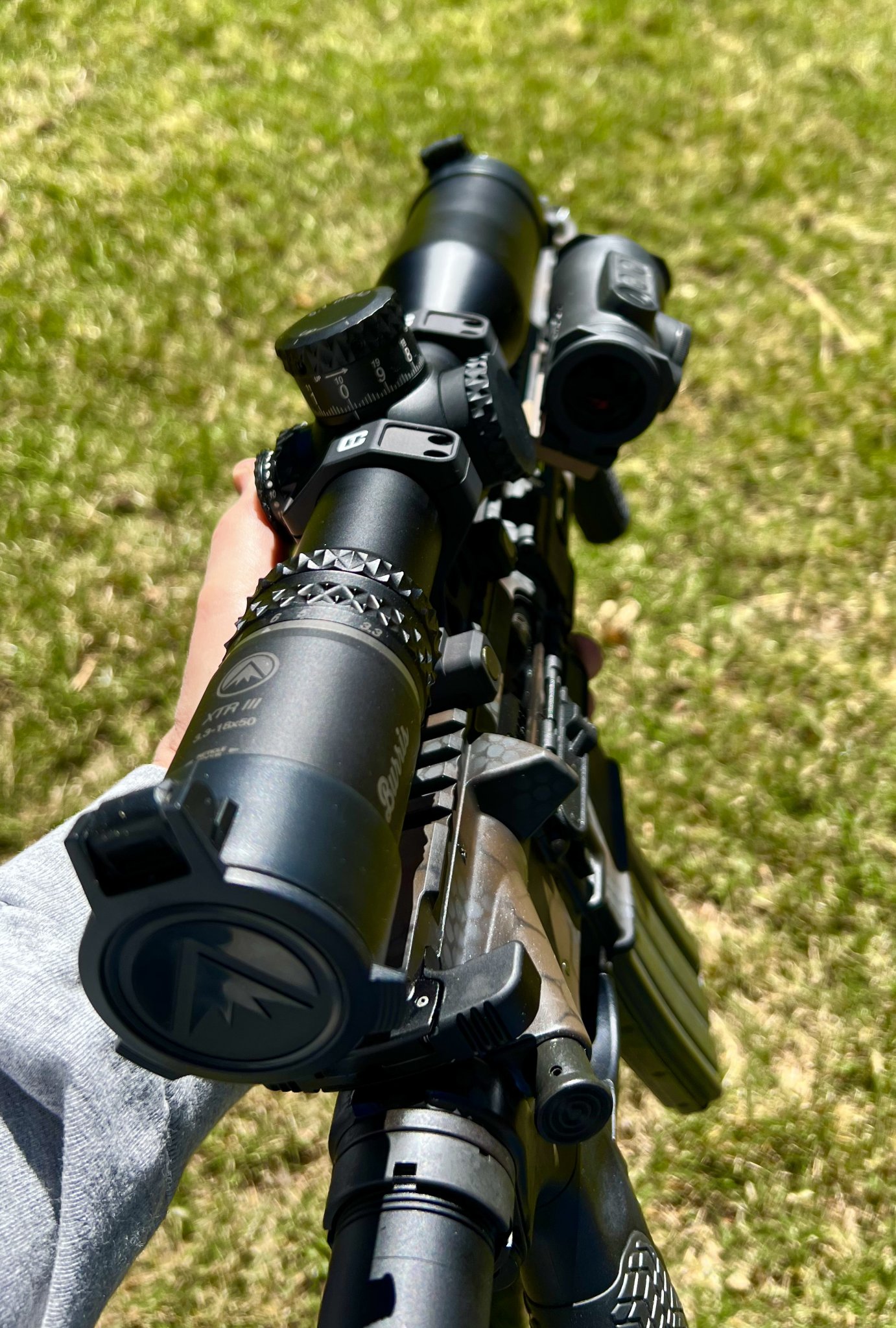

At 200 yards with a red dot I make more hits than misses on a small target from an improvised position when there is plenty of time per shot. But when I practice with position movement and faster shots I am considerably better with a scope than a red dot, even with the scope at 1x. This makes me wonder if I am not keeping the red dot close enough to the center of the window with time pressure and fatigue. With a scope there is no guessing about where the sight center is.
Running a scope on top, whether LPVO or MPVO, for longer engagement distance plus an offset reflex red dot removes the need for the red dot to be accurate. No need to mess with focus to quickly roll back and forth between CQ and distance, but it's heavy and bulky for a CQ rifle. This is a great setup but is pretty heavy and bulky.
LPVO alone is a descent alternative, but requires manipulation of magnification with the off hand, is still heavier than a red dot and sight acquisition for very close range, especially with movement, is considerably harder than with a red dot.
If you want a rig that is as light as possible with fastest CQ sight picture that's a red dot on top (holo or reflex), but It would be best to be able to reliably make hits at a reasonable distance. That's the scenario that requires a reasonable degree of accuracy from the red dot, meaning a reasonable parallax error. For a 200 yard shot on a 10" CoM target, if the parallax error is anywhere near what the EOTech website says to expect (as noted above), when you add shooter aiming error under time pressure and stress it's not a reliable setup. So the question I have now is just how close the dot must to be to the zero location to keep parallax error down to a reasonable level, say +/- 1MOA.
