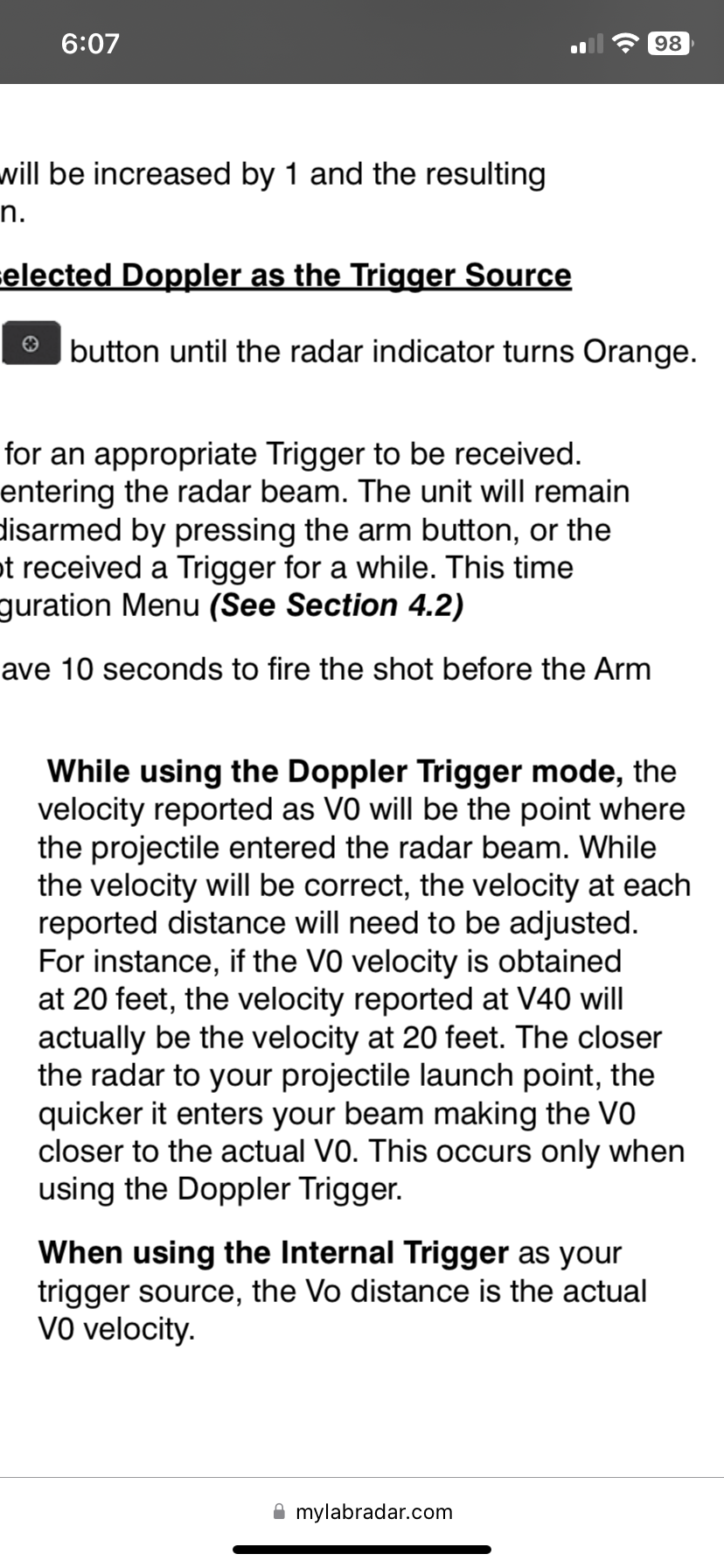

Thanks. I think no 4 isn’t correct since I was using the Doppler trigger (the internal trigger wasn’t working for some reason). Hence wondering if these readings can be trusted. If it’s catching one shot at 10 yards, then the next at 40, that would lead to a large spread of velocity readings even if the load is fine.
Labradar is radar, thus it collects bunches of radar ping returns over time and distances and calculates the curve making a best fit line and by extrapolation that line can trace it back to what it would have been at the muzzle.
It’s collecting every shot at 10 and 40 yard. And 2, 8, 15, 23, 35, 48, 56,68, 77, 83 etc
Reactions: RegionRat
When you have time, pull the data from the card in your LR and open the CSV folders. You will find the summary file will open if you have a spreadsheet program like Excel or similar. Then, open the detailed files which will show you how those individual shots were processed.
You will see that what the LR is doing is picking up shots at some distance from the antenna, but then they extrapolate back to calculate the velocity at the muzzle.
Like @spife7980 is saying, the shots are all captured at slightly different distances from the antenna, but the extrapolation is back to the antenna which is assumed to be less than half a meter from the muzzle.
Those downrange distances are from the LR antenna and the unit can only capture the reflection when the bullet breaks into the beam and no sooner. Then there is some noise filtering to get to the first data points which means even a little farther before they show data points. The estimated distance to the first reflection is then a calculated value and the extrapolation using the whole data set can be done.
Hope that makes some sense as it is difficult to put into words and I am a horrible writer. It is easier to explain in front of a white board, but without turning this into a class on RF and radar, that's what you will get for free. YMMV
