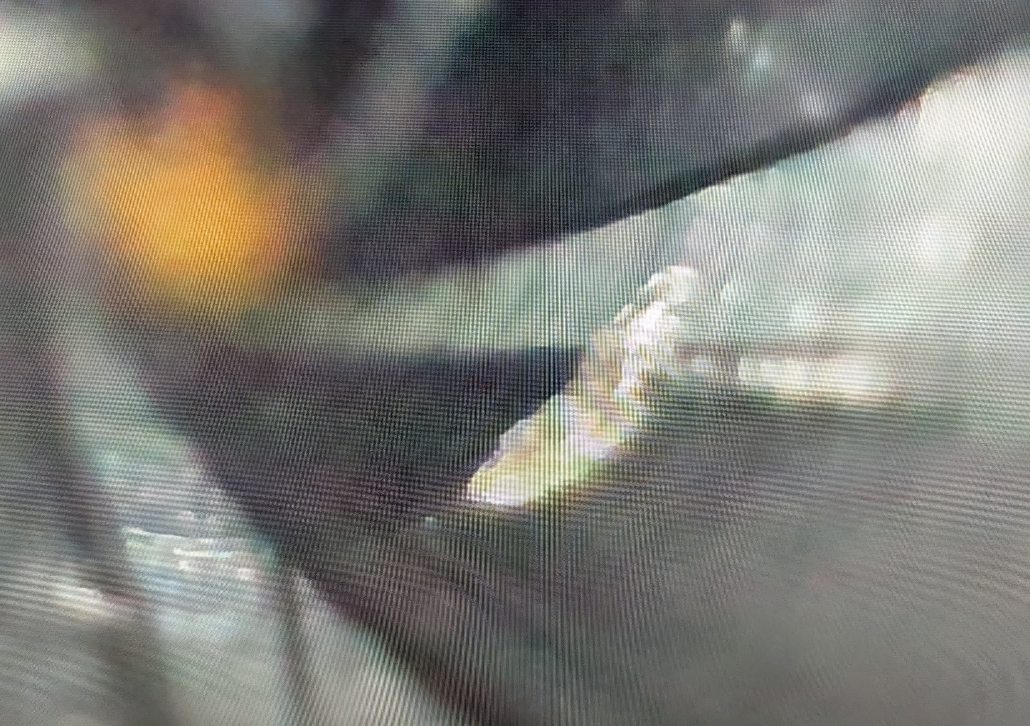

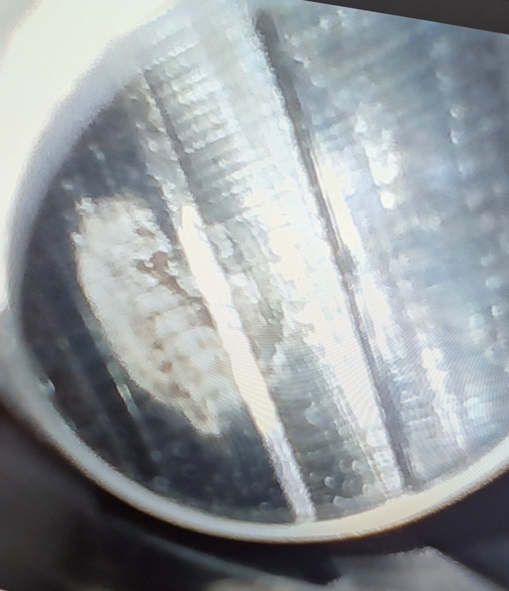

New Savage 6MM Creed. Cleaned before and after shooting 2 rounds and it's still there. What are your thoughts? The rest of the barrel is spotless. I don't
think its copper.
Yes, I’ve seen it. Typical Savage barrel. The big question is, how does it shoot?

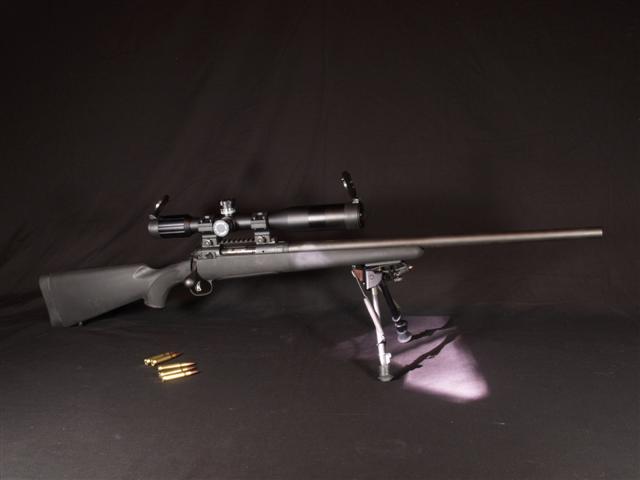

This is my Savage Hog 308 barrel; I haven’t got it to group better than 1.25”, not even with FGMM. And it’s a bitch to clean. Never again.
I looked in there to see if it had copper. Pretty much all factory barrels are shot at the factory, but not cleaned. My common practice is to clean the barrel even before shooting it to start with a completely clean barrel, then go through the break in procedure.

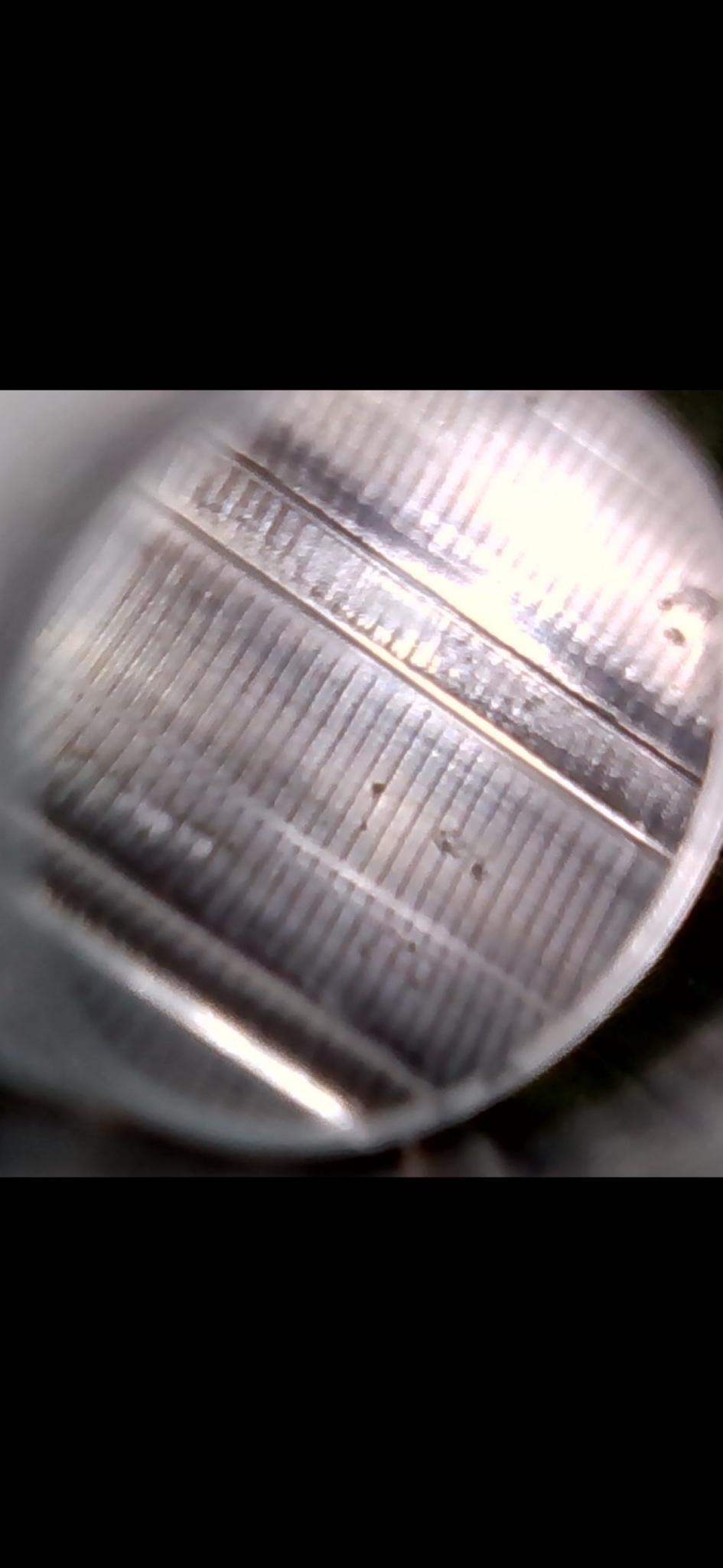

It’s a savage barrel. It’s supposed to look like that. Tool and chatter marks resembling a corrugated drain pipe
I’m a firm believer bore scopes cause more worry than they’re worth. Shoot and see what it does.
Bore scopes shouldn’t even be allowed down a savage barrel 😁
Because of the imperfections savages shoot best with a couple rounds down the barrel. Mine did best after about 20.
Clean savages shoot worse. My best results were just bore snaking mine every once in a while. Cleaning to bare metal only hurt it until it fouled back in

See. There’s your trouble. You still believe in “the break in procedure”.
Don’t look. Just shoot the motherfucker. Clean it whenever you feel like it…after a couple hundred rounds minimum.
Yeah, with a new Savage the procedure is, clean the barrel to remove the trash they left behind, followed by shooting 100-200 rounds of the cheapest ammo you can find without cleaning it. Go home and leave it dirty without touching it for a week, then run several patches soaked with Hoppe’s down the bore, followed by a few clean ones just to get some of the carbon out, oil it, and you’re good to go.
Run it like you stole it.

OP: That definitely appears to be some sort of corrosion. I'd shoot it a bit more and continue to check to see if it is collecting a lot of copper. If the accuracy that you want is there (and no excessive copper buildup), then I wouldn't even worry about it. I have a Salvage with the same horrible chatter marks from the button rifling process as well, and the barrel shoot amazingly well. If the rifle would feed worth a squat, I'd even brag about it a little.
Borescopes are amazing tools for checking your cleaning process and looking for carbon ring buildup. I'd wager though that 90% of the time they are used to diagnose issues that would otherwise not exist if the owner didn't know about them. $5 says that what you are seeing has no noticeable effect on your accuracy.
Judas priest with the “don’t look at your barrel with a borescope!!!” nonsense.
It’s a precision instrument, that until recently was unaffordable to most. Part of the learning process is learning what to look at and what to ignore.
So you post so pics and guys who know more should say “don’t worry about that. Probably nothing. See how it shoots”.
Instead of oh my God, not a borescope!!! The worst thing ever invented. How dare you stick one down your barrel, you fool! The sewing circle comments are superfluous and unintelligent.
