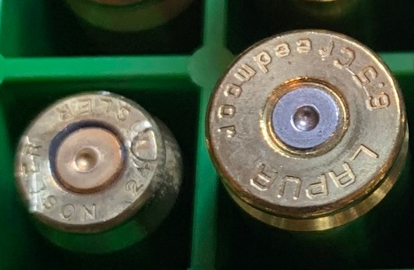

The one on the left is a touch warm for ref. & it was 150fps slower than my top loads with same bullet. That was a little Valk experiment with TS 15.5 that didn't go so well. Kidding obviously, but speed doesn't always correlate to pressure. I'm surprised the primer stayed in that one.
The 6.5 on the right was a 156 Vulcan at 2838 from a 25" barrel :unsure:
Goes to show how much powder selection matters.

To this question the answer is..........it depends. It could be a die problem or improperly set head space on the ammo. The action design also plays a big role. The picture I posted above of the 6.5 Creedmoor was shot in an ARC Nucleus. That action doesn't have a round spring loaded ejector, instead it has a mechanical thin blade ejector (never leaves a mark). If you look real close at the pic you'll see a light circular swipe between the LA & the primer. Feeling it when opening the bolt is almost imperceptible. I have to pay real close attention when opening to feel it. The brass grew enough to be just barely pinned against the bolt after firing. That tells me pressure is up there near top end. I also look at the radius on the edge of the primer & that depends on the primer used. That particular Vulcan load used a FGM205 primer & had I used a cci#41 there would be more radius.
