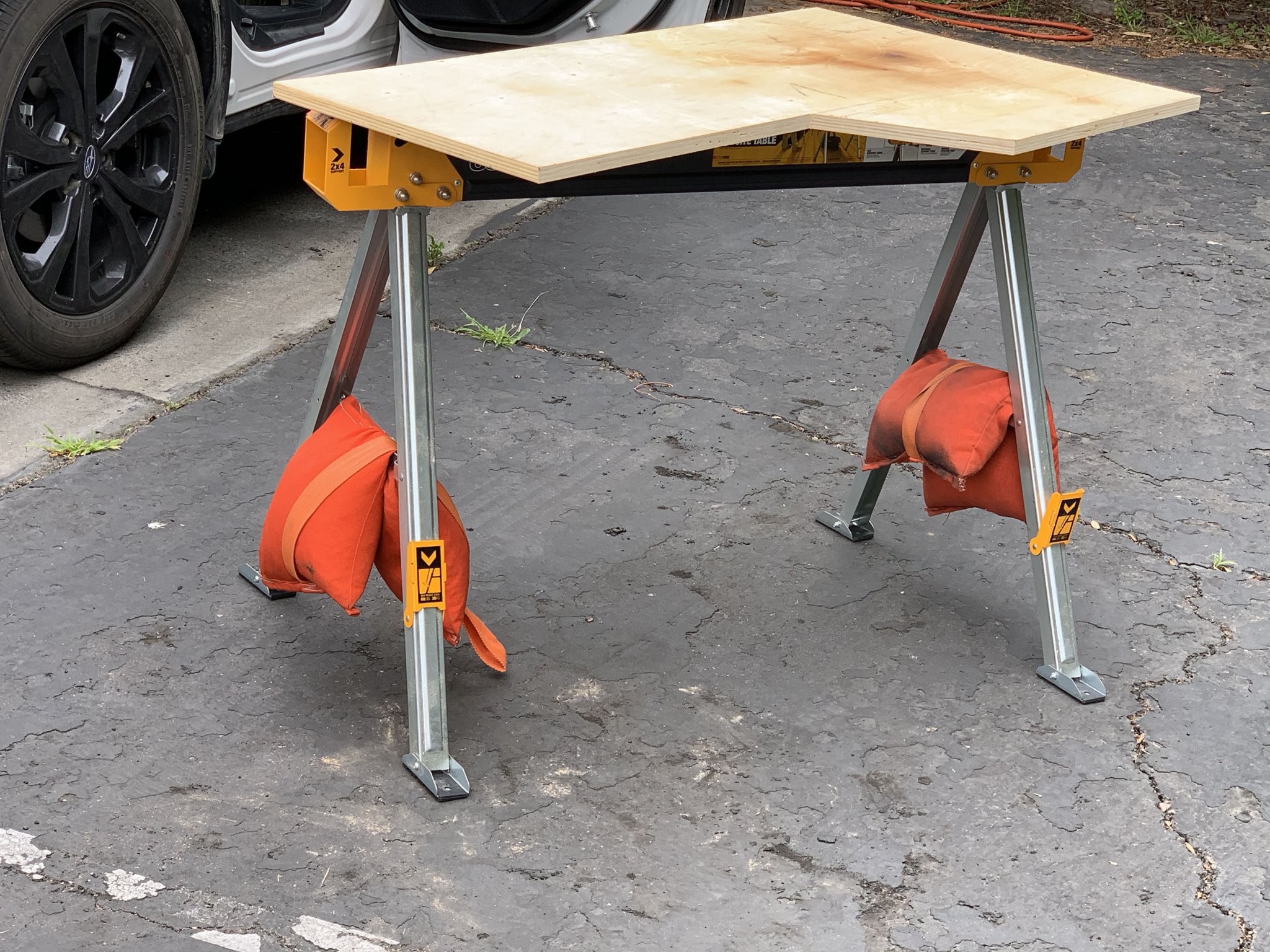

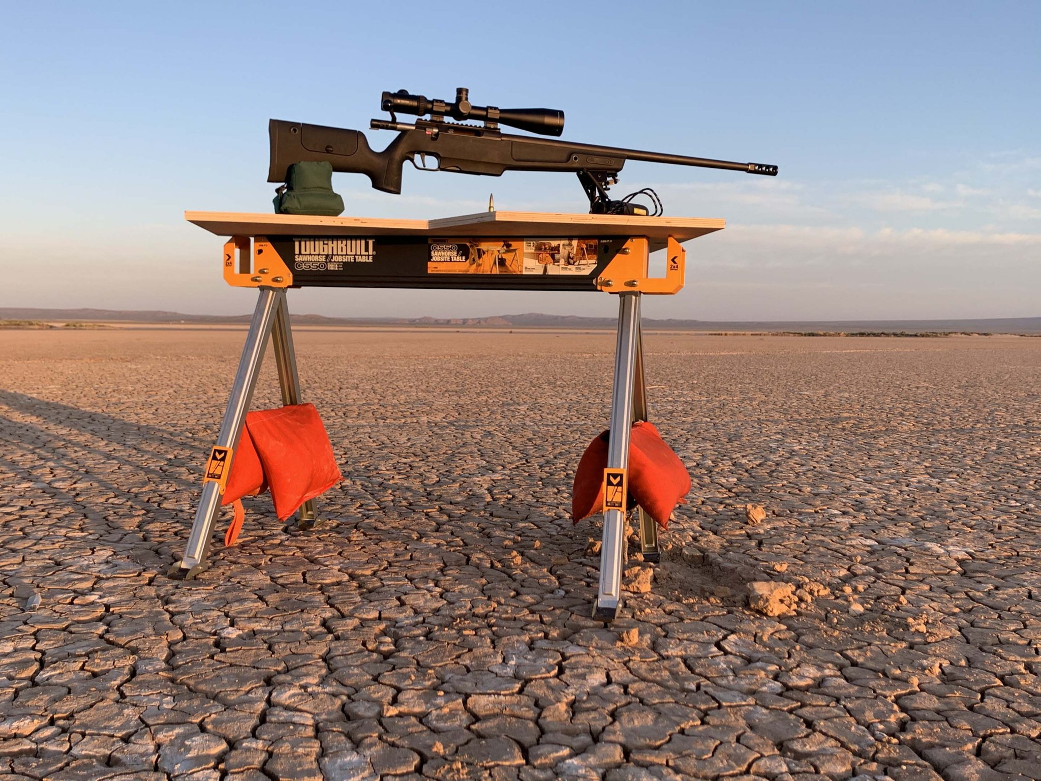

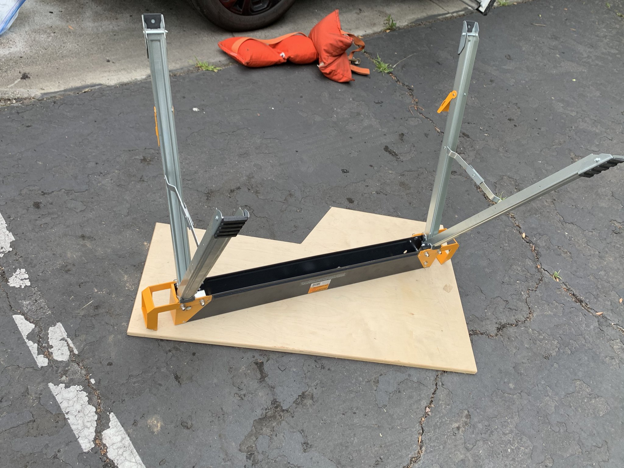

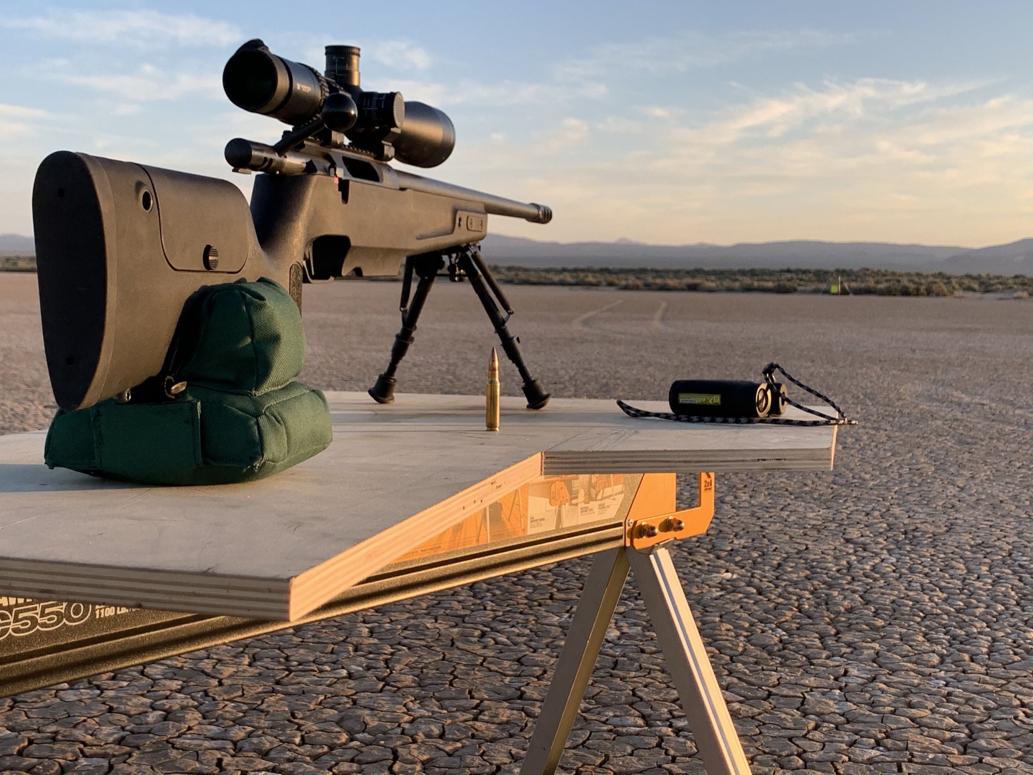

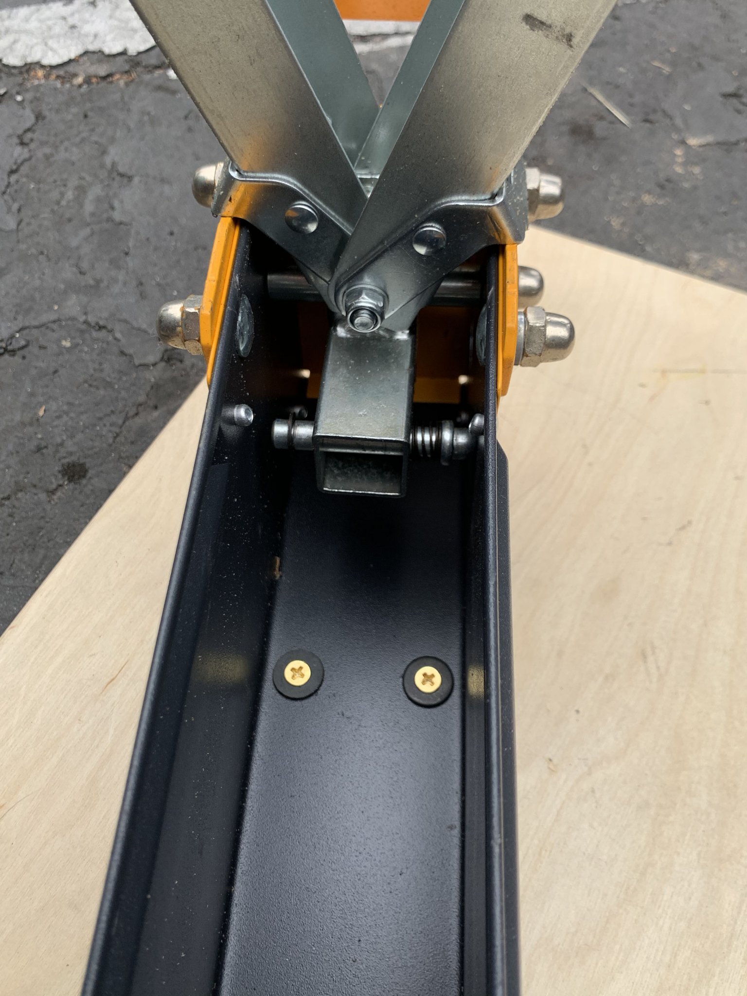

Needed something better than $34.95 Amazon picnic table to shoot off. Grabbed a few things I had laying around and came up with something easy and very stable. Far exceeded my expectations..

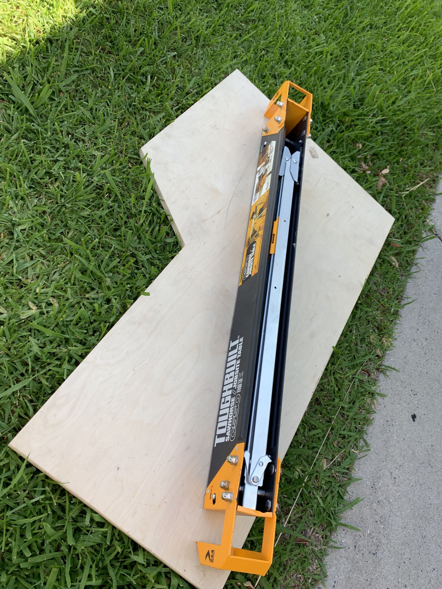

The sandbags are are Mathews 15 lb ones which are used to stabilize light stands in photo studios: pn 299550, $26 from Adorama in NYC and lots other places. Free delivery- at least when I ordered them 2 years ago. The sawhorse is available at Home Depot: pn TBC550, $30. The deck is ¾" Birch ply 40" X 24" with 8 X 17" notch - 60 degrees cut. Flip over for RH shooters. Used jigsaw with straight edge to guide. The sawhorses already have two holes at each end ideally located- #8 X ¾" wood screws with thick Teco steel 3/16" flat washers. Obviously, sawhorse is run diagonally: I balanced the deck before connecting- then marked outline underneath with pencil. Leaves floor space for the shooting stool legs.
One of the main reasons this table works so well is that these new style, inexpensive sawhorses are truly excellent- especially for the price. Can't believe how cheap they are for the quality. The typical stiff rubber sawhorses that I already had laying around were immediately VERY obsolete when I bought one of these. VERY rigid when deployed. And the sandbags really lock it down. Though, not actually sure I needed the sand bags- seemed to work real good without them as well.
Add carrying handle cutout, carpet, and edges to taste......

Ha! I knew someone else had the same idea! I've been using a Toughbuilt C700 for a similar table for awhile now! The saw horses from Toughbuilt are amazing!
The only difference is that I use a table clamp for the top (instead of screws) to allow me to break it down for transport.

They really knocked it out of the park with those TB sawhorses. Can't believe $30- about same price as those lame, wombly cheapo rubber/plastic ones. The amazing rigidity of those saw horses is what makes this work.

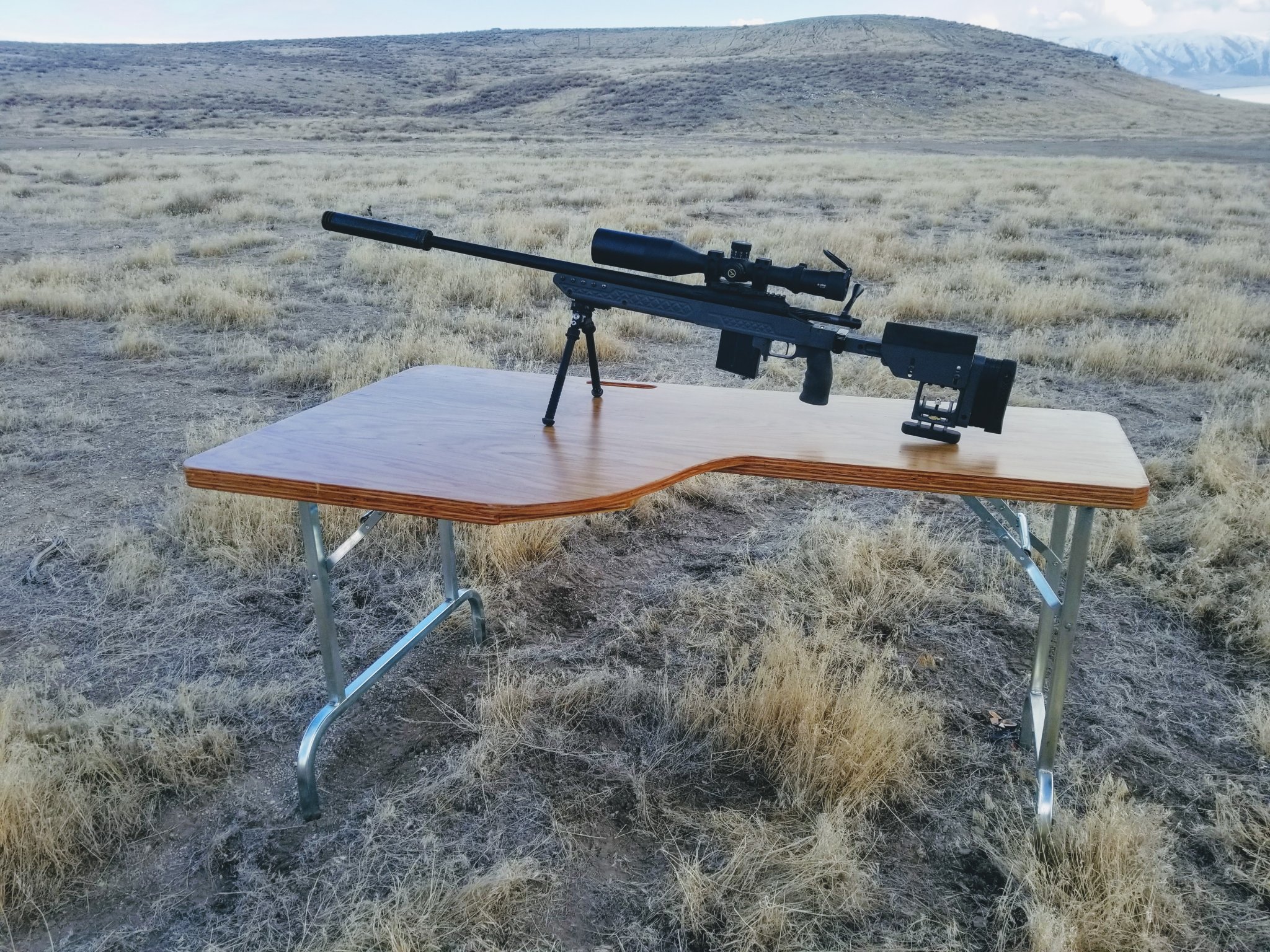

I thought it was setup for a left hand shooter but the bolt is on the right side of the rifle.
Don't know why, but I shoot rifles LH- and pistols RH. All rifles I have owned have been RH actions- and ambidextrous stocks. Actually didn't realize I was shooting rifles backwards till several years ago. So yeah- table is set up for LH shooter. Will probably get a LH stock at some point from GRS. I see no reason the get a LH action at this point.

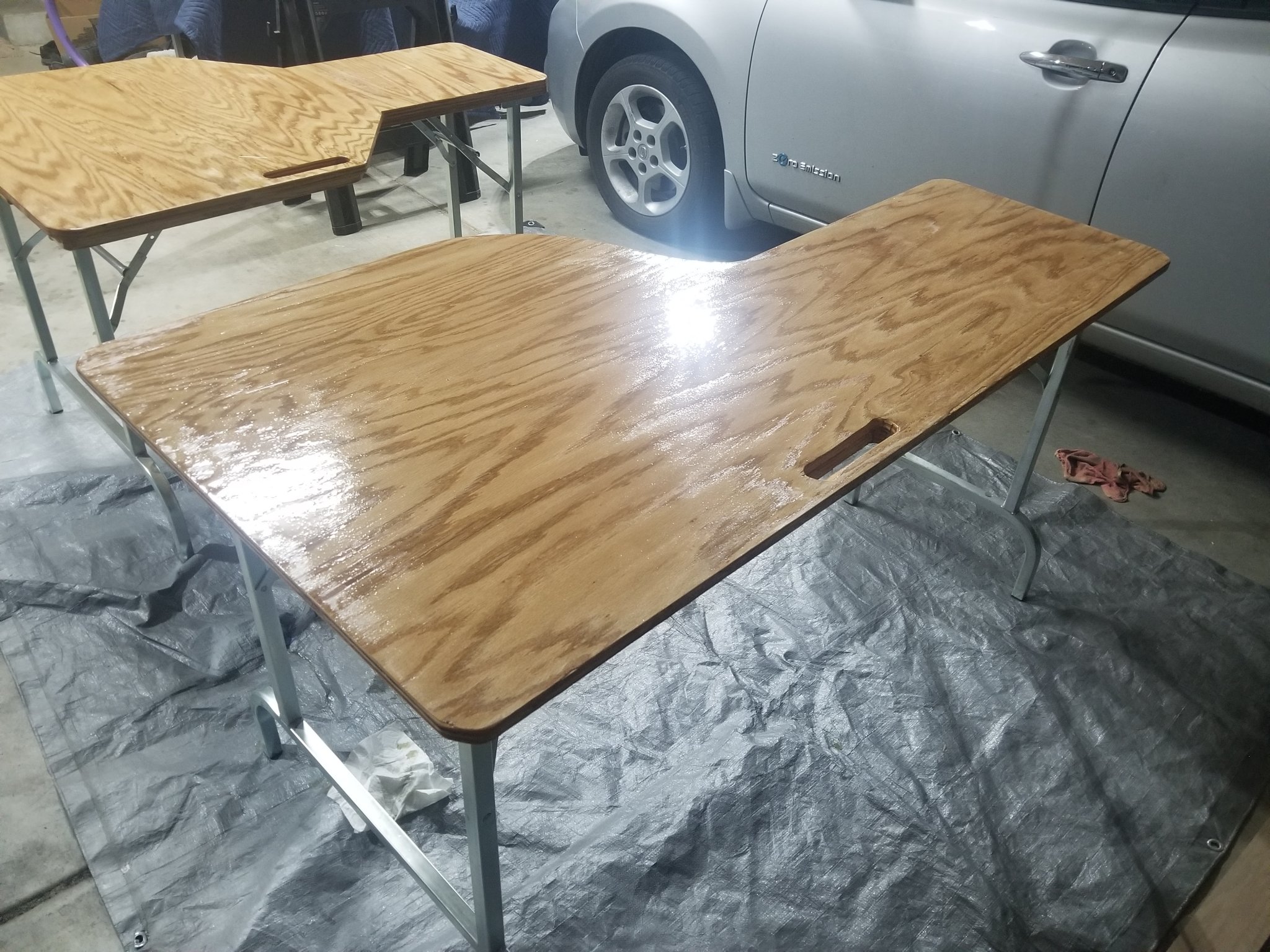

Well, what's one more quarantine project, right? I went with a 24"x48" piece of 3/4" birch from Home Depot. Spray painted it Hunter Green and put a coat of waterproofer on it (still wet). Might put some outdoor carpet on it later. Super simple and cost effective solution. Thanks @kip.duff !

That's a Sig Sauer SSG 3000 Patrol .308W, US import version with different stock than Euro versions. That picture shows a PST gen 1. Many claim McMillan made the stock- I'm not so sure. Sig stopped importing several years ago. The US version was offered for less $ than the Euro version- and the domestic no-name stock helped in that price reduction. I'm looking for a Euro style stock, like wooden STR 200 type- STR 200 and SSG 3000 interchangeable stocks and barrels.

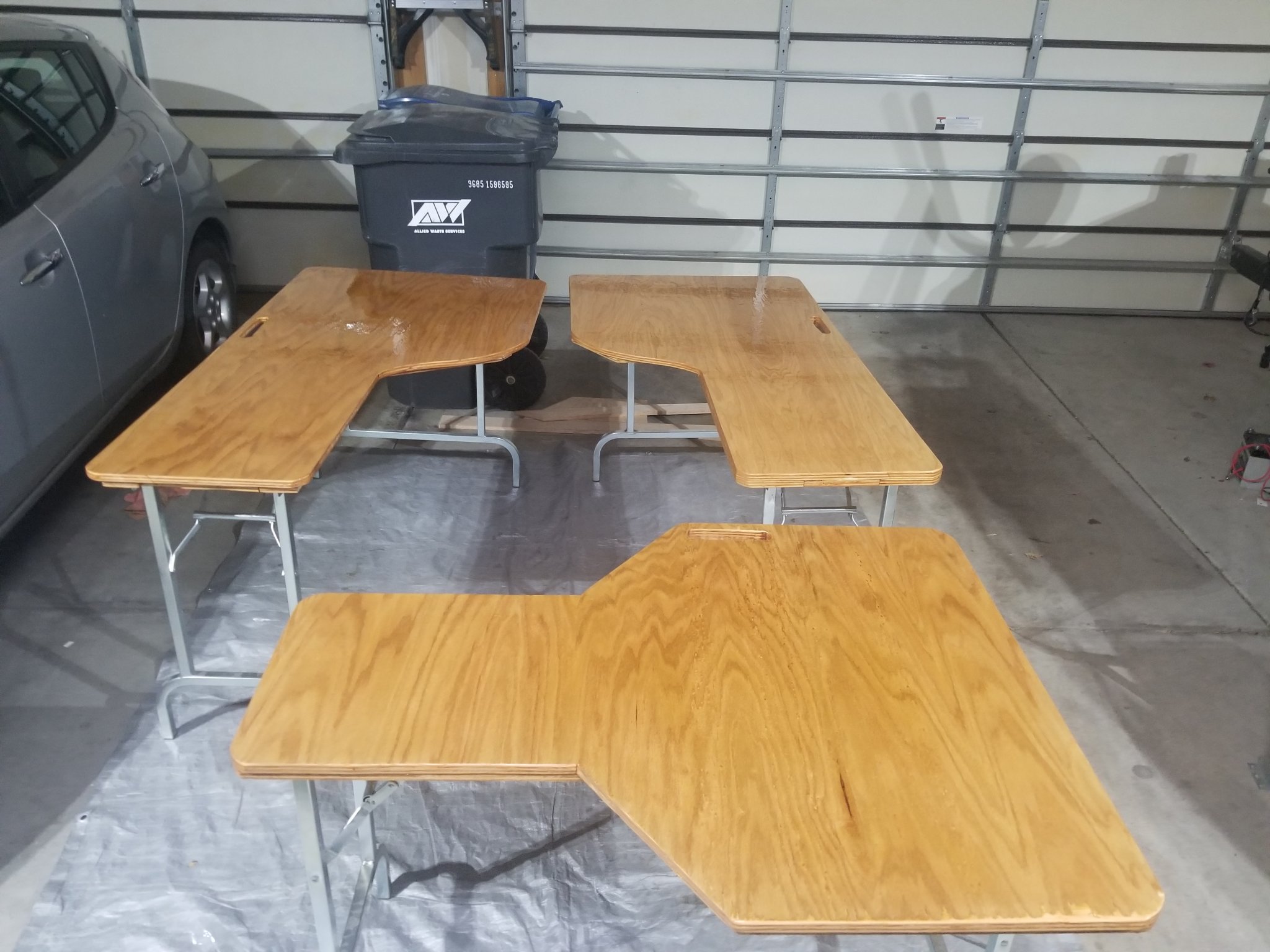

After some deck stain. It's a two person job to actually move it anywhere substantial. I wanted something big enough to not feel cramped.

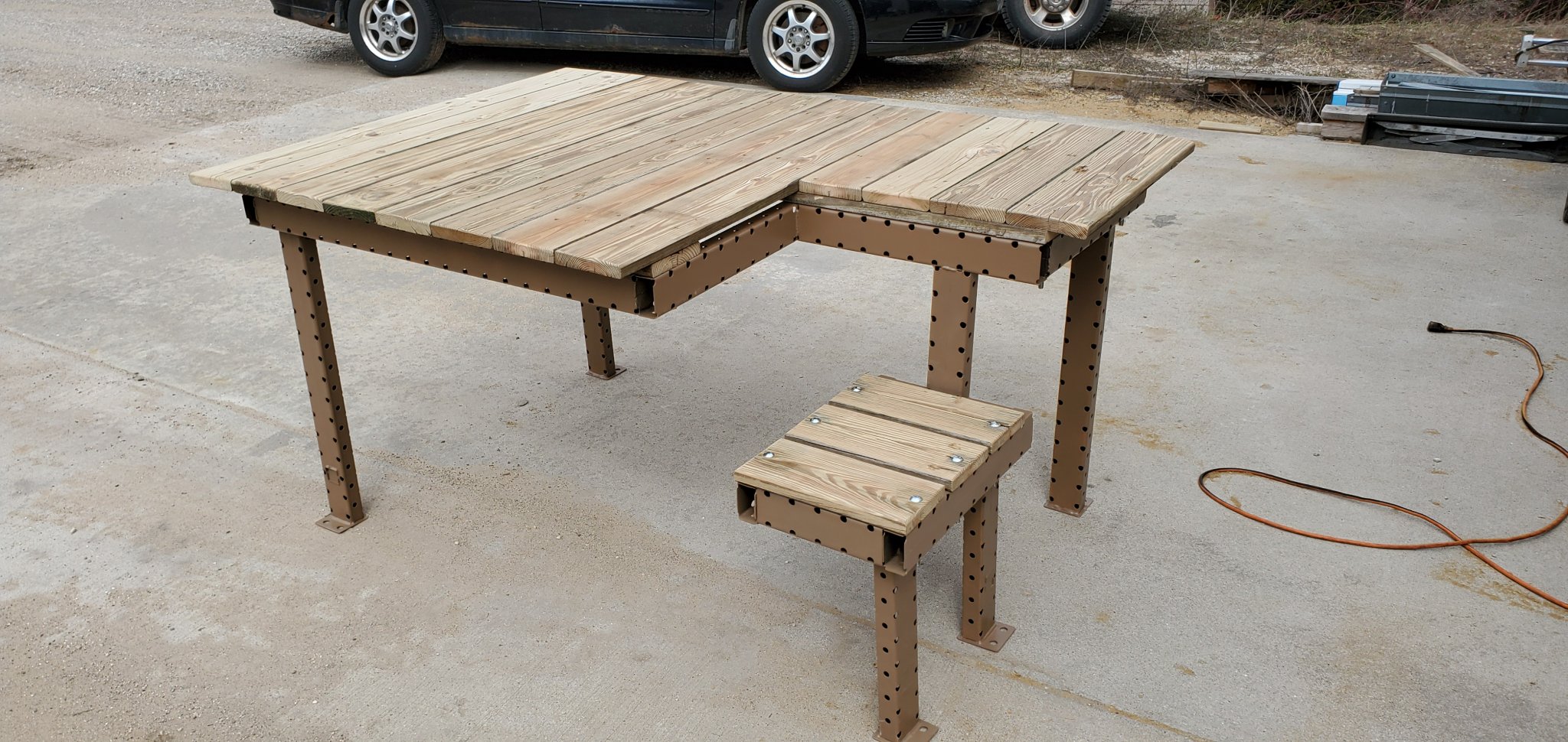

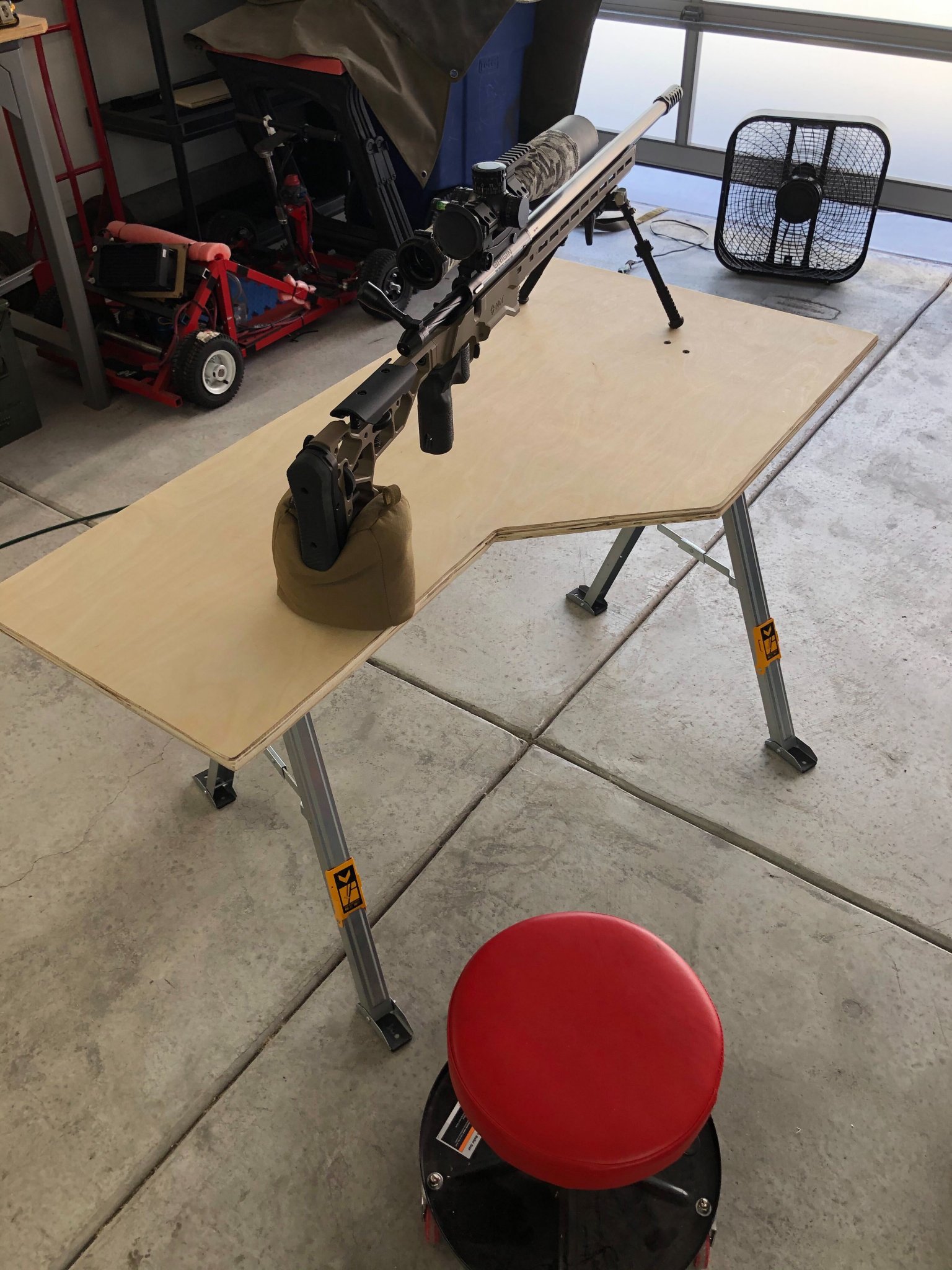

Got the legs from EBCO. I used the SQ30OL and a set of SQ18OL. I was building 2 tables so that gave me the ability to have them overlap and lay down nicely by using the overlap one from each set opposite the non overlap. I liked having the narrower legs in the back which made it so the legs were not in the way of the chair.
