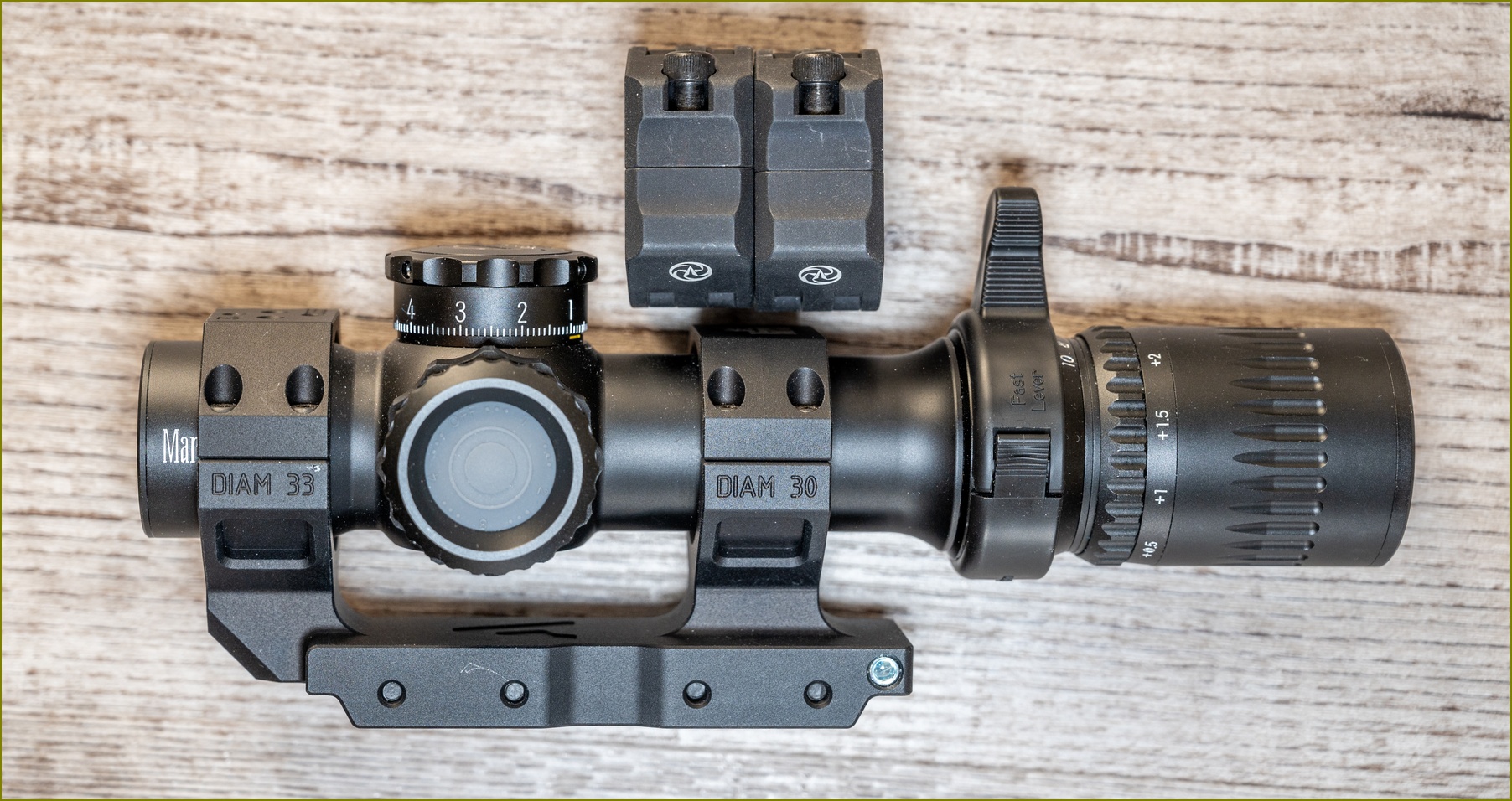

There is also the ability to use 2 rings in the middle. Like 2 NF Ultralite 4 bolt or 2 ARCM10's.
That is correct, here's a pic I took with two ARC's together, should be pretty darn strong
