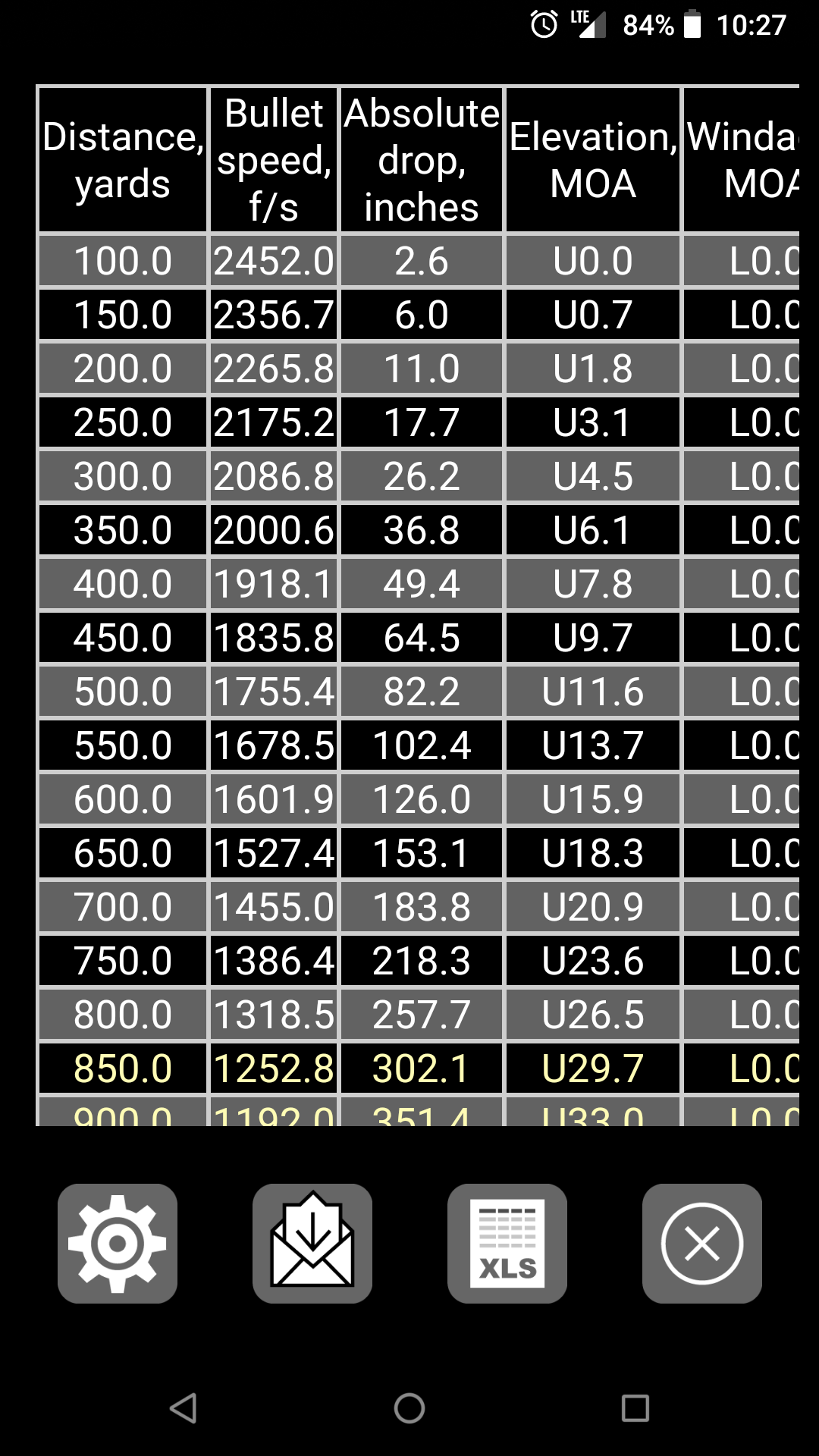

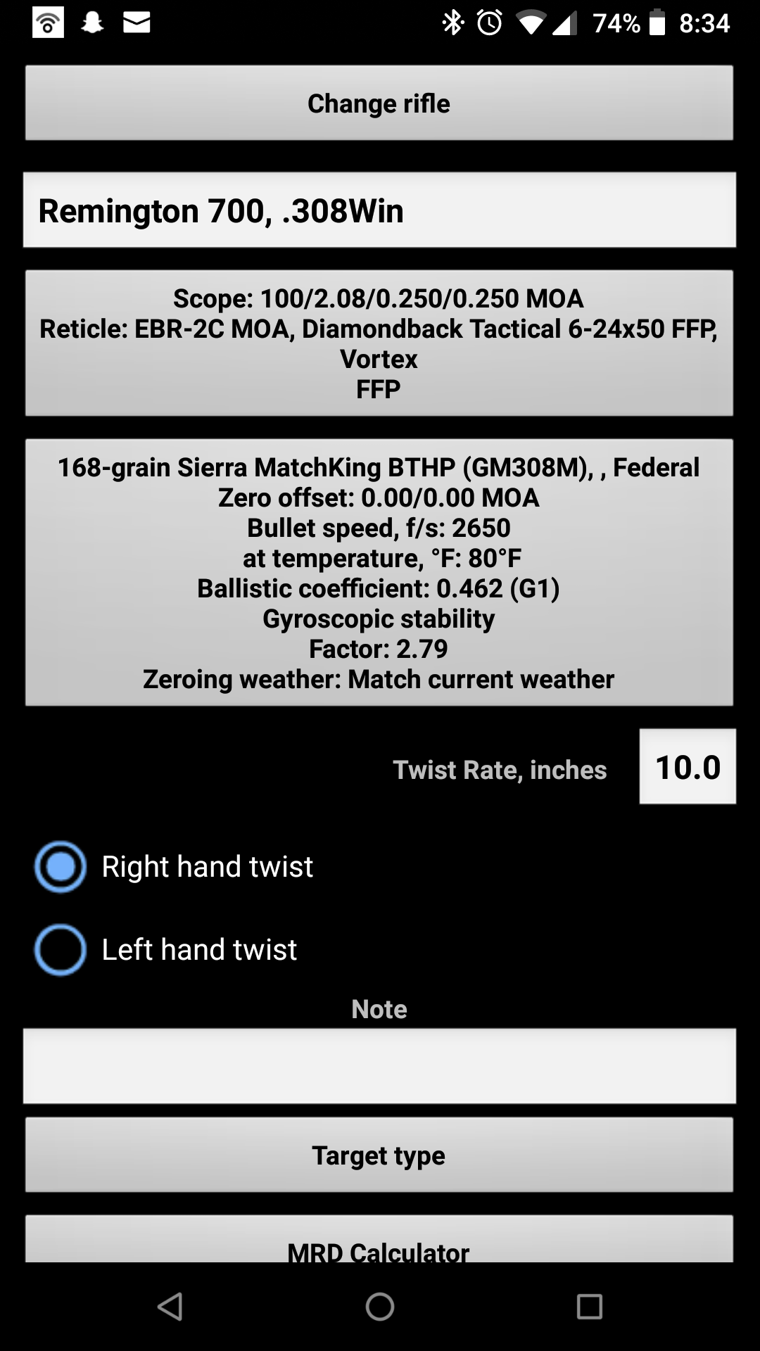

    This is off my Strelok Pro. Without a chrono I'm just inputting BC and velocity off the bof of ammo. Depending on the weather inputs I throw in I'm at 1.75-2 MOA by the calculators. I'm at 4. I understand my numbers aren't quite right, but I'm not sure why I'm soooo far off...

    I believe the "absolute drop" on the chart is referring to bullet from from the muzzle to each distance. It's shows 0 MOA of elevation at 100yrds which is where I zero'd. But the "up adjustment" shows 1.8 at 200yrds (Hornady said similar). I have to dial 4MOA or holdover 4 in my reticle to hit my 200yrd...

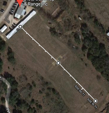

    Where is your range. Hell we can probably see on google maps that you target ranges are wrong.
    This has to be an operator error and not a gun or scope error.
    My guess is range of target is wrong.
    Validate your scope height. Your program data seems off too. 11 in of drop at 200 yards is off by 6 to seven inches. I understand one is actual and another is program. Not familiar with your scope but you sure the reticle and adjustments are both the same. Mil to mil or MOA to MOA.
    If you zero at 100 there should be no inch drop at 100.

    Well seeing as it's a public range they use for state and local club matches, and it's been there for 20+ years, I kinda doubt the range is off...

    Posting for @D1gger. Whether my data is off or not is irrelevant because the purpose of the post isn't for my software, but for what I'm actually seeing on target. I should be at 1.75 MOA of adjustment from my 100yrd zero to hit 200. I'm at 4 MOA (adjusting or holding over)

    Posting for @D1gger. Whether my data is off or not is irrelevant because the purpose of the post isn't for my software, but for what I'm actually seeing on target. I should be at 1.75 MOA of adjustment from my 100yrd zero to hit 200. I'm at 4 MOA (adjusting or holding over)View attachment 7070139
