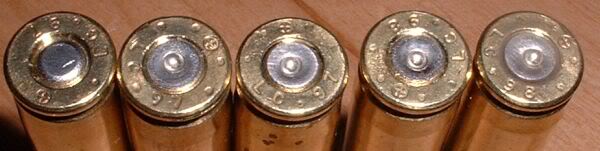

I fired this in my old Colt AR15.
There is a flat primer
There is a primer crater
The case stretched in front of the web
There is an extractor impression.
There is an ejector impression.

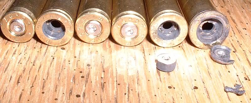

This is a work up with Blue Dot and 35 gr Vmax, an erratic powder at high pressure in the .223 that works best around 35,000 psi
This is a work up with H335 55 gr, a powder that works well at high pressure.
From left to right:
unfired, extractor groove .329"
28 gr, extractor groove .329", 11% overload 69 kpsi Quickload
29 gr, extractor groove .329", 15% overload 80kpsi Quickload
30 gr, extractor groove .3295", 19% overload 92kpsi Quickload
31 gr, extractor groove .3320", 23% overload 106kpsi Quickload
We don't really care what the pressure is, we care about the effects of pressure on the weakest link in the system, the case head. The .223 case head in this case is failing somewhere between 29 gr and 30 gr of H335.
Maybe the primer pockets are not loose, yet, but I find the extractor groove expansion to be the best indicator for the limit on which to base a safety margin.
Somewhere between 29 and 30 gr the threshold can be found.
The safety margin is subtracted from that to find the max load.

BigEd, I SIMPLY asked for some opinions as to the info I provided that I am seeing with my loads. I described details of case condition and CH expansion numbers and SIMPLY asked for some opinions. At least Clark gave me some opinions and I thank him for that. If all you want to do is quote one technical research piece after another I guess this is an open forum. Again I am simply asking for some opinions from some guys to help me decide ON MY OWN what is safe for ME.
I was raised old school and was taught that "if I don't have anything nice to say then don't say it." There is no reason to call people stupid! I am trying to learn an art so I won't be stupid.
I DON'T NEED TO BE TOLD THAT I CAN'T TRUST EVERYTHING I READ ON THE INTERNET.
I have read and reread 3 manuals that I own. I have talked with Sinclair tech people several times. That doesn't make me an expert. Since everyone is probably scared (including me) to ask anymore questions about this I seriously doubt I will get any help on this topic.
I even talked about what I read in Zediker's book to discuss his idea of pressure signs. We all have to decide on our own how we see things but would have been nice to have had a nice civil, informative discussion on my original question. But I imagine that can't happen for fear of being called stupid. Any ideas or opinions (or even if bogus info from someone who knows nothing) are just things that we all can sort through to decide what we think is right.
I really am sorry that I started this thread! Really enjoy this sight but the fun is gone when you have to fear being land blasted for questions (even unintelligent ones, ha). I once heard the only "dumb" questions are the ones we don't ask. Guess that is not always true.
Thanks to any of you brave souls that want to give me your opinions as to my questions.

And one more thing, the cases below were not loaded by Lake City Army Ammunition Plant because the brass failed its quality control inspection. These rejected cases were loaded by Federal and someone here wants you to load them to 75,000 psi after they failed inspection and he says "he knows what he is doing".

.223 brass fired in an AR doesn't always reliably show signs of excess pressure.
Sometimes the primers flatten, but other times they don't.
Often you won't be able to tell that the loads are too hot until you start blowing primers.
Increase .2 grains until you blow a primer, then back off by half a grain.

I sincerely want to thank you for a very good and civil response. That is something I understand. I have yet to blow a primer on any of my first 700 loads on this AR. But I did experience slight ejector ring on max varget load with lapua brass and backed off that load about a grain.
Not seen any pressure signs yet on this AR Comp load but feel am about max and will quit at 23.2 gr.
Thanks again for the info.

So what are you telling bbowles to blow the primer out of the primer pocket and jam the trigger group or rupture the primer and score the bolt face?
Question: what is 55,000 psi and what does "shall not exceed 55,000 psi mean?????????
Answer: Not knowing when 55,000 PSI is exceeded simply restates the problem.
Spare us the drama: The world won't end should he accidentally blow a primer.
