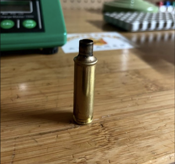

So I've been using an expander mandrel for a few years now and I'm running into an odd issue. I've been using the expander for .223, .308, and 6.5 Creedmoor and only see this issue on 6.5 Creedmoor.
Check your brass for donuts inside the case neck at the junction where the neck meets the shoulder. Possible that repeated sizing has caused a ring of brass to form inside the case which is putting up significant resistance for the mandrel and causing the case to collapse. The way to check for this would be to take a fired, unsized case and see if you can press or drop a bullet into the case without any resistance. If it drops in freely then I doubt donuts are the issue, if it hits a hard stop partway in then you've probably got donuts.
For an expander mandrel I would prefer to open the case up closer to 1 or 2 thousandths from FL sizing, but 0.004 isn't out of the question. You can adjust this with either bushing size or having a die custom honed to the desired neck diameter.
I suspect you are using an "expander" mandrel rather than a "turning" mandrel. They are 0.001 thou different in size, with the expander mandrel being the larger of the two and typically 0.001 under bullet diameter. The turning mandrel is 0.002 under bullet diameter. I use the "turning" mandrels as I prefer 0.002 of neck tension. Switching to a turning mandrel will reduce the sizing force needed.
Upgrading to a better mandrel material will also noticeable reduce the amount of friction/effort for sizing with the mandrel. Look at either the Sinclair Carbide, 21st Century TiN coated, or the 21st Century Black Nitride turning mandrels.
Ok - I think this is pointing me in the right direction. I went ahead and ordered a new mandrel from 21st Century with a smaller sized mandrel option. If this doesn't work it looks like I'll have 2 options: either get new brass or start trimming the donut. At the moment, I'm reloading Peterson Brass that has 3 firings. After giving the bullet drop test a shot, it did go in all the way but I certainly noticed resistance as it entered the neck/shoulder junction so I'm thinking the donut may be a factor. Thanks for the response!
Lunch break update. So I tumbled my brass for a few hours while I was working with polish in the media. I FL sized 25-30 pieces brass and then expanded the necks. No lube inside the necks and the ram stroke was smooth as butter.
Welp, I'm a moron... the inside of the case necks were just dirty and my reloading process got lazy. I've been tumbling brass after sizing to remove the lube, but guess I need to tumble before and after now :LOL:
