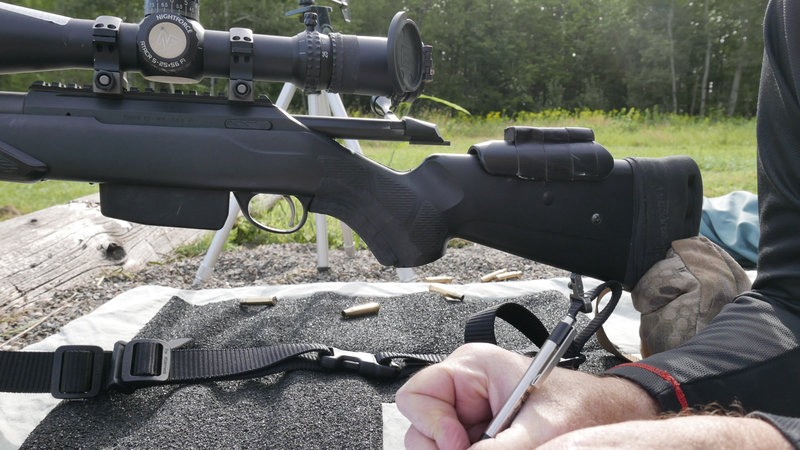

Here is a great example of a student taking a stock Tikka T3 and making it fit him SH_HD_TikkaStock-1.jpg
