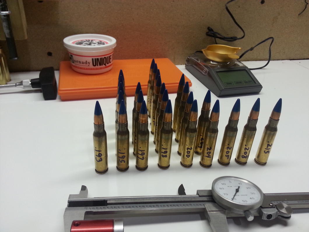

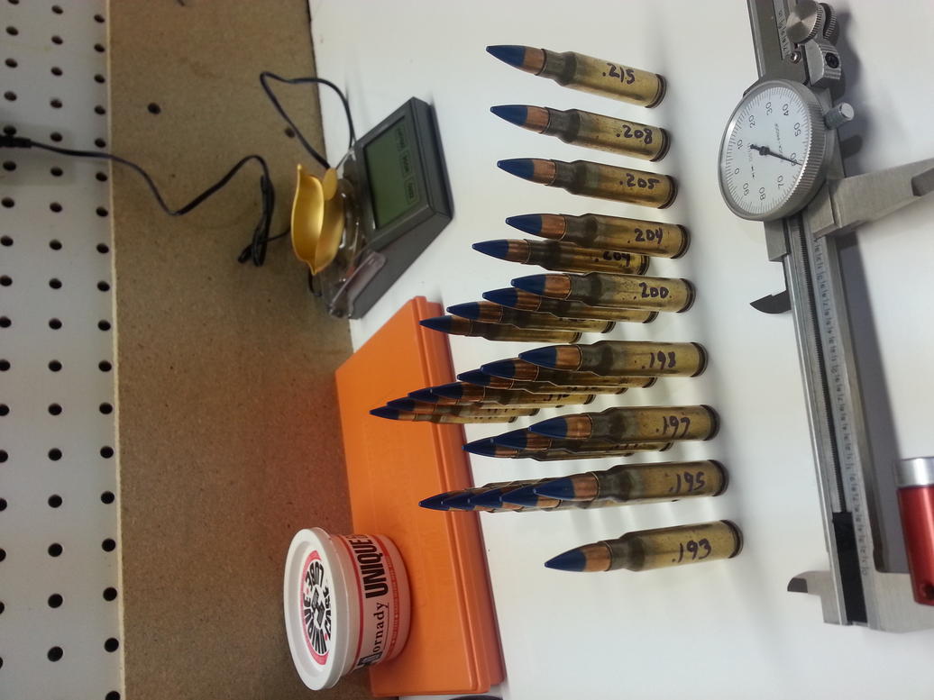

I recently bought some "play" ammo. Had to buy it loaded because they didnt sell just the projectiles. I am a real meticulous reloader and like things to be right. The pic below is what I recieved...add a 2 in front of the #'s on the case and thats the oal to ogive. These are horrible. Debate is wheather to pull projectiles and make them right; maybe even seat them longer so they'll be closer to my POI at 400 or just shoot them. Not competition bullets but they cost a fortune and im too meticulous. I want every round to count....what to do.....

The max difference in base to ogive length from the numbers in your picture seems to be 22 thousands. It also looks as though the bullets are not VLDs, but rather something with a tangent ogive. They MAY be relatively tolerant of the jump. If so, you might not notice a huge difference between rounds. The only way to know for sure is to shoot a few and see. With the lack of attention to seating depth, I'd be much more concerned that the powder charges were also measured with a similar lack of attention. If the charge weights are all over the place, pulling the projectiles and changing the seating depth may not buy you much. I'd just shoot a few and see what happens.
Yeah, powder charge was my main concern after see the rather broad seating depths. Ill give a few a try for sure. If I do pull them apart, obviously id dump the powder and start from scratch. The case lengths and necks look like crap also, so I dont expect much from these. Not expecting 1/2 minute by any means but geesh, throw me a bone, id be lucky to see 1 1/2 " at 100 with the looks. Thanks for the comments guys and ill repost when we get a day less than 17 mph winds.:confused:
