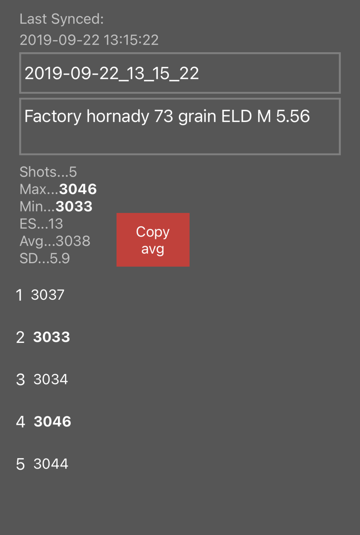

    About 5 years ago I bought a bunch of Hornady 5.56 73 grain ELD M ammo. It shot under an MOA in the Stag Varminter with the 5.56 chambered 24” 1:8 barrel.
    I didn’t see any of the usual pressure signs so I bought a shitload more.

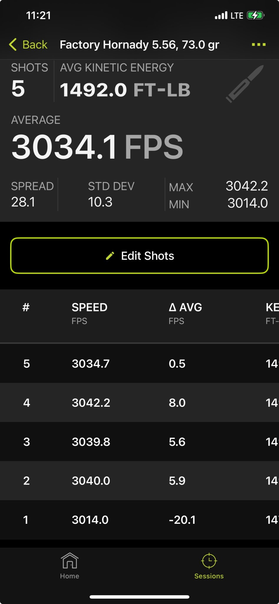

    I took it out recently and tested it again with a different rifle with Krieger 1:7 24” barrel, 5.56 chamber.
    It grouped about the same as before. No flattened or cratered primers.
    Is this ammo too hot? Am I prematurely wearing out components?

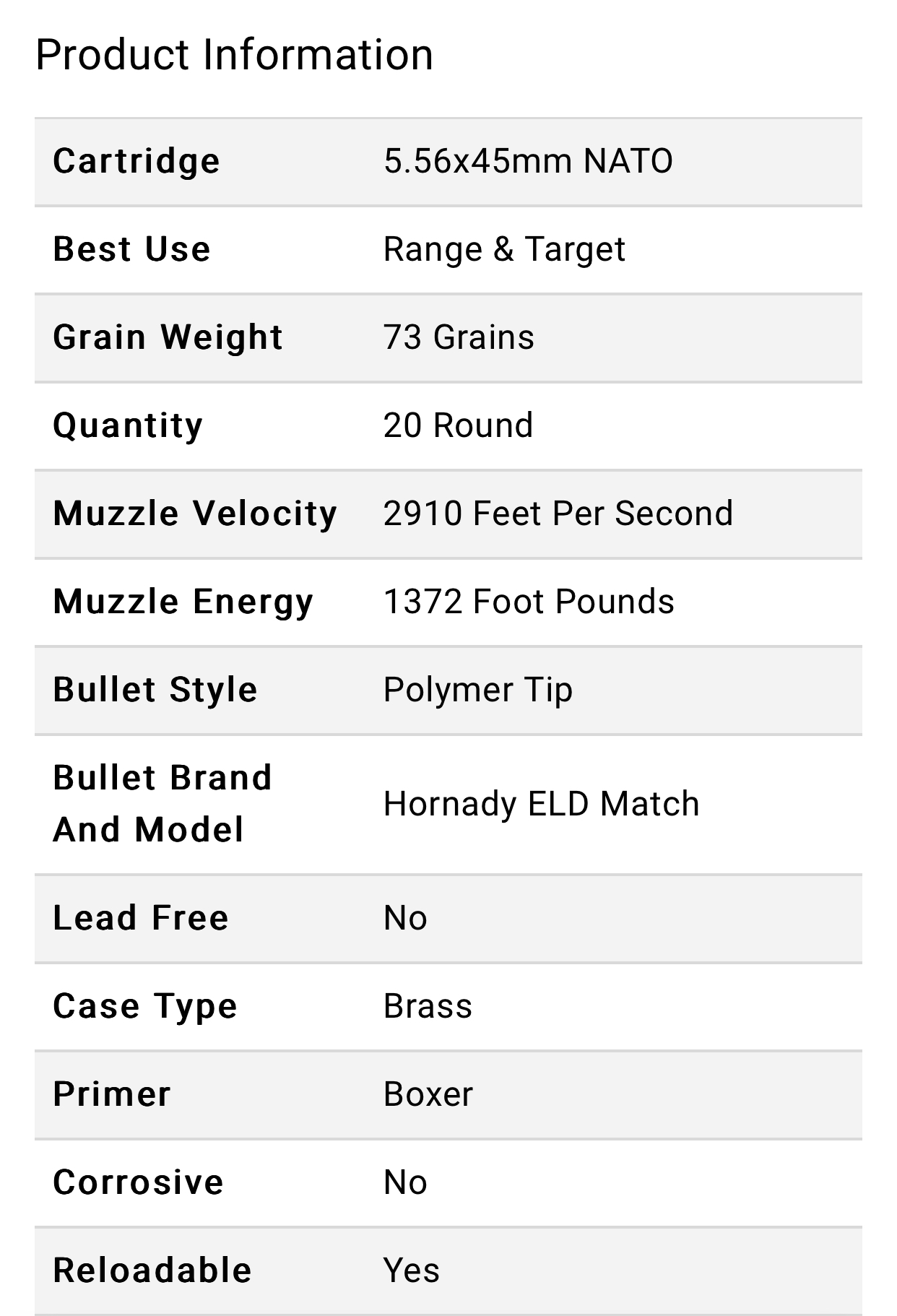

    Ahh superformance that makes a lot more sense. Yea that's still a little fast but if you're not getting ejector swipes, case head swell, flat/pierced priemrs, etc... I wouldn't be incredibly freaked out for being 100fps fast.

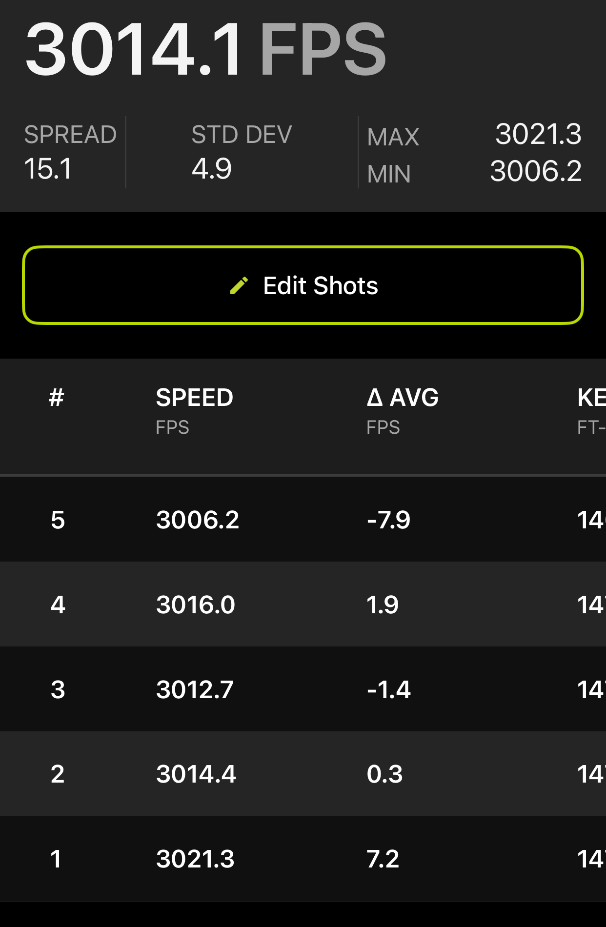

    I attempted to duplicate that load with Ramshot TAC, nickel plated black LC brass, and FED205MAR primers.
    This is what I got.

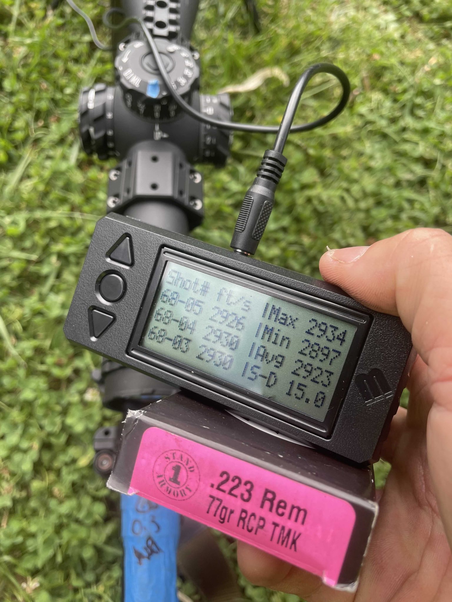

    What does the base of the fired case look like on that Stand 1?

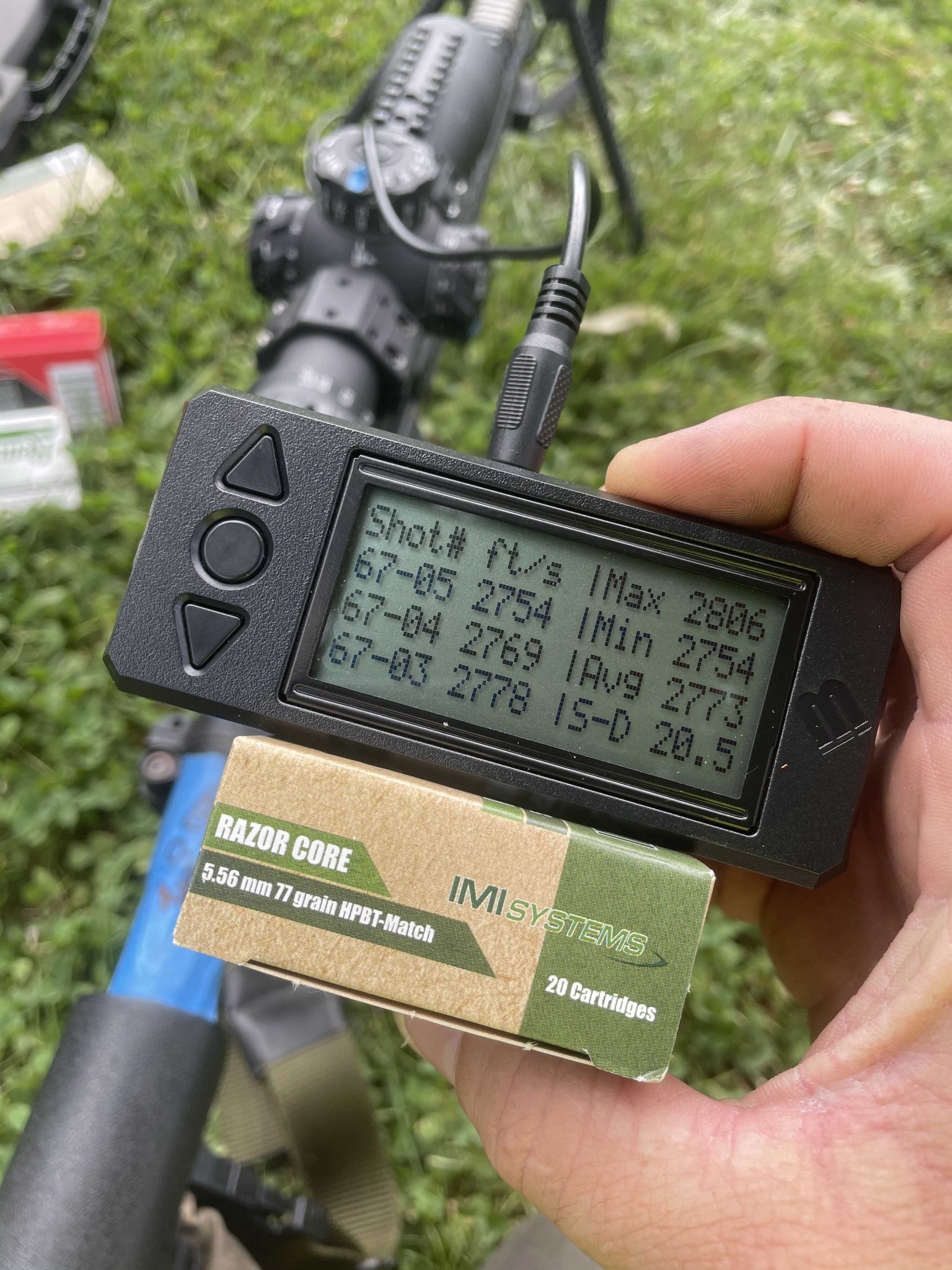

    Out of a 24” with 1:7 I get about 2960ish with the IMI Razor Core. How am I getting that much more speed with only 4” of extra barrel length do you suppose?
    Idk sounds like you have a fast barrel.
    I bought a a LOT of that Stand1 ammo for my terminus bolt gun that is very ammo picky. I mainly just shoot mk262 and razor core through this match rifle ^
    That’s .223. Mine was the 5.56
    @hlee 2910 fps
