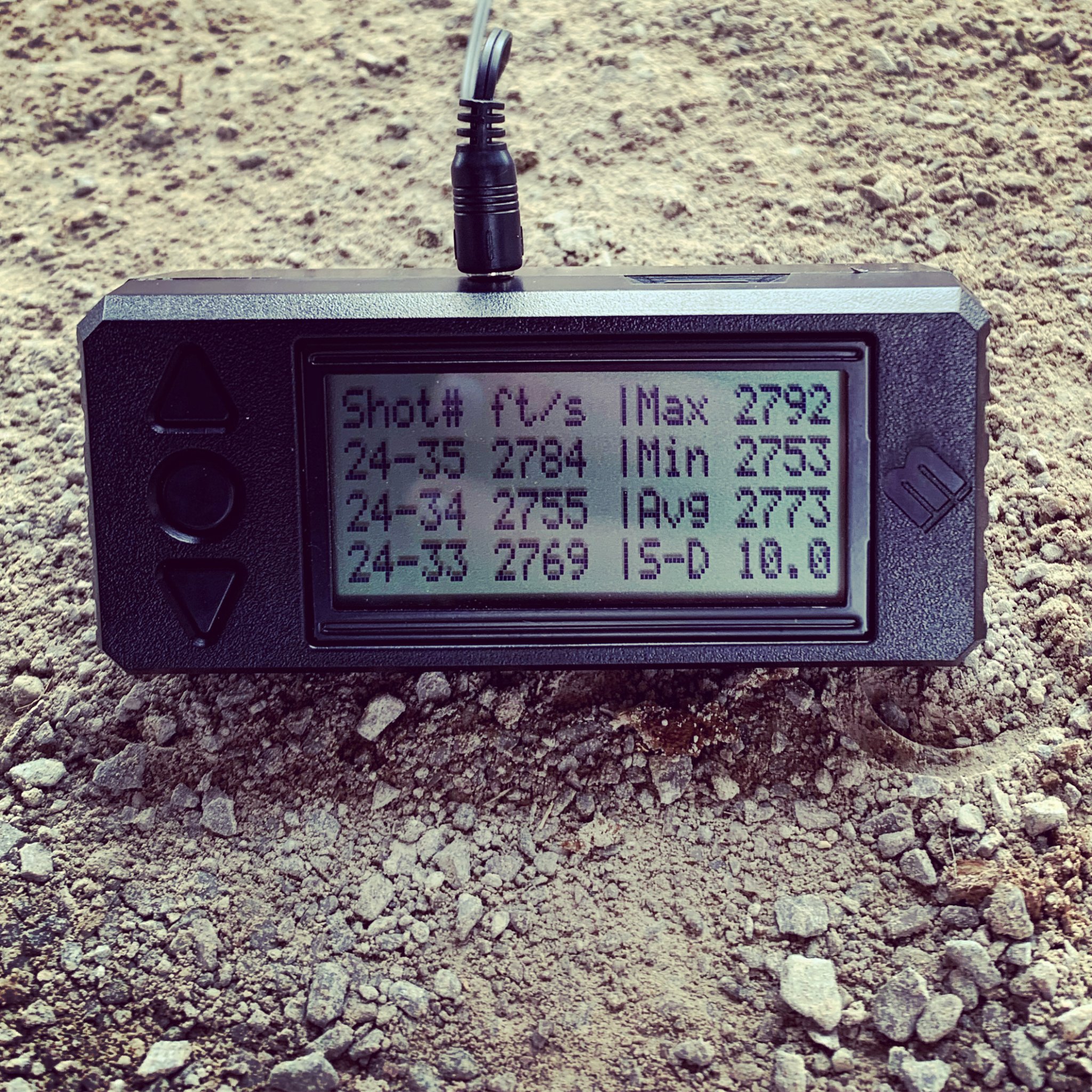

You are probably gonna get a lot of replies in this thread with guys posting chrono numbers. Pretty useless stuff. The only way to really know is to experiment yourself. The same load in different rifles can have very different results.
Reactions: 308pirate and OG10
Do you have a chrono? I so, and it runs with a decent SD/ES and it groups well, then it will do fine at further distances. If the sd/es is pretty high, you’ll run into consistency problems the further you go.
So, if one round runs our barrel say at 2650, your dope at 1k will be 9.3 (example. It’s environmentally specific) at 1,000. If the next round runs 2690, it will be 9.6.
Depending on target size, that can be a miss.
Then skill level takes over. Are you confident enough in your fundamentals that you know you made a good trigger press and it was likely the velocity that ran you high/low?
Or are you going to be wondering if it was you or the ammo that caused the error?
Run the American Gunner over the chrono and see how it does. If it's giving you an SD in the 20s and an ES in the 40s, look at the factory stuff from Hornady, Prime, and Berger. The Berger stuff shoots VERY well and it's loaded in Lapua brass, so since I'm assuming you don't reload, you can sell the brass off rather quickly to lower your costs a bit.

I am new at this long range game, but have been shooting all my life. No Chrono, no Kestrel, but I am a member at a super-nice range about ten minutes from my house. We have four of these electronic target gizmos. According to the microphones my 140 AG had an ES of 17.2 on this group. I also do not reload; have no time in my life for puttering. Wish I did. In any event I feel the American Gunner is a solid value and works for me in my everyday shooting (usually alone, usually on steel.) Best cheap 6.5 ammo that I can not get frustrated over. This idiot has spewed.

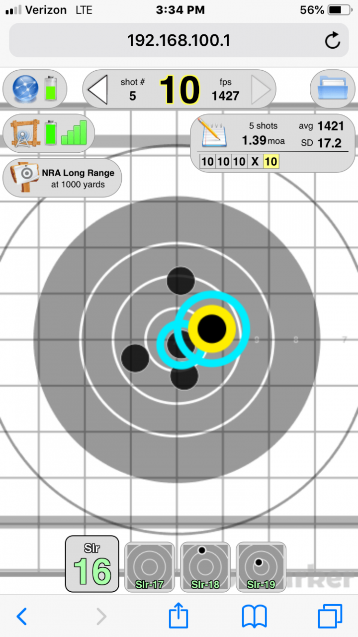

Still shooting the 130grain Berger FGMM, using federals ballistics calculator Friday at 425 I made a cold bore center mass hit it couldn’t have been any better. That’s not really a far shot but I stacked the next 2 right on top. For factory ammo I’m pretty happy.
35 rounds of Berger factory; 140g Hybrid variety.
8.5 mils to 1000 yards in 800 DA
