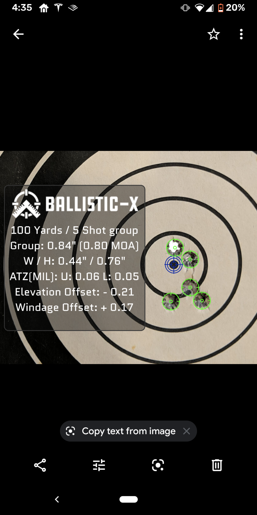

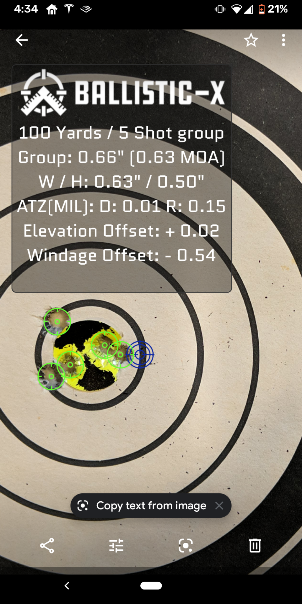

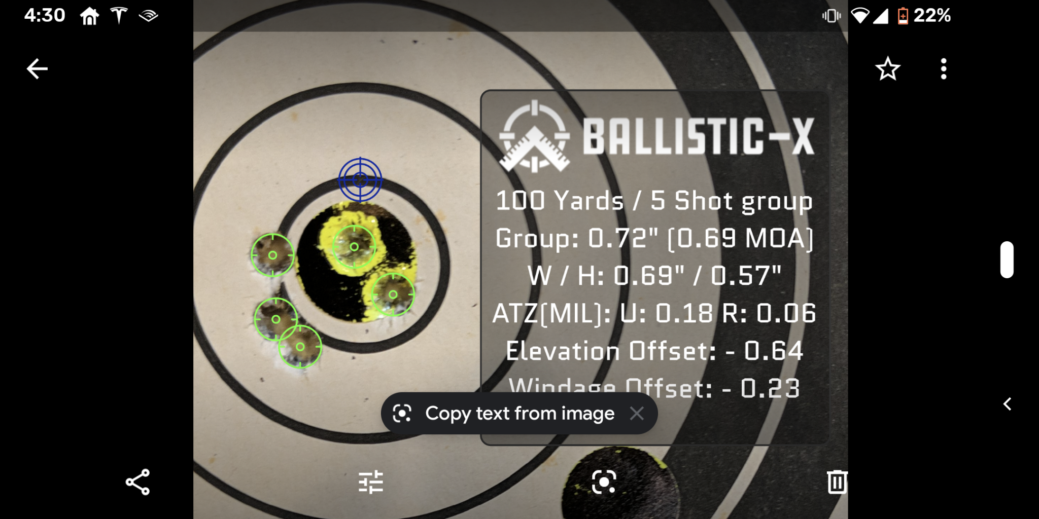

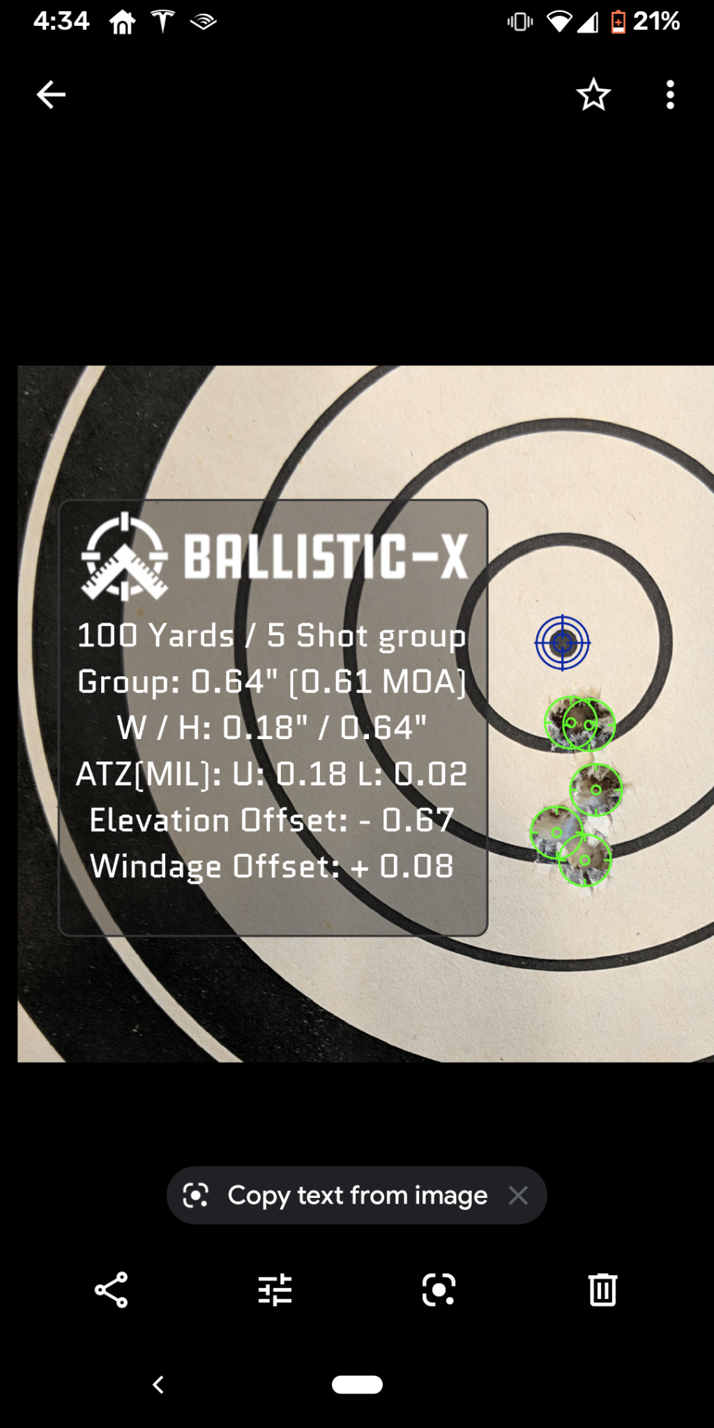

FWIW, my tikka CTR has been consistently in the .75 moa range with factory Hornady American gunner (doesn't seem to be much better with 'match' ammo). Trigger adjusted down to about 1.7 lbs with the internal set screw.
