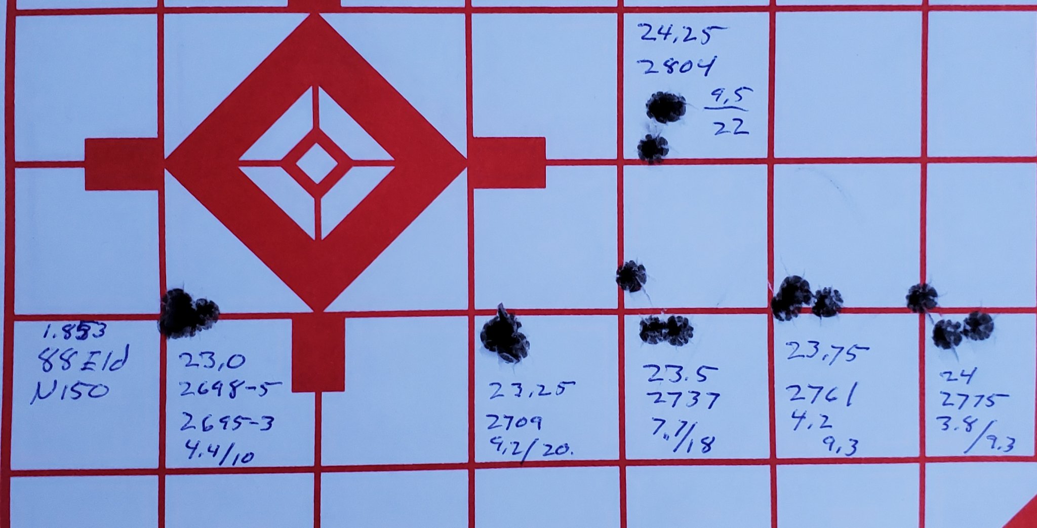

Berger 85.5's and 88 ELD's have worked well in mine with N150, sorry I have no chamber specs.
Mind sharing your load and velocity with the 88’s and n150? I’m running 88’s and n140 currently in a proof/origin.
I don’t have access to my load data but was running low 2800’s but primer pockets aren’t lasting long. Going to try and slow it down some.
Tried some 88 ELD'S and N150 today... made me look good 🤣
26" proof with whatever reamer proof uses in their prefits. COAL length to lands is around 2.518ish, these are jumping .030-.035. Charge weights above 23.25 grains were compressing enough to grow COAL.

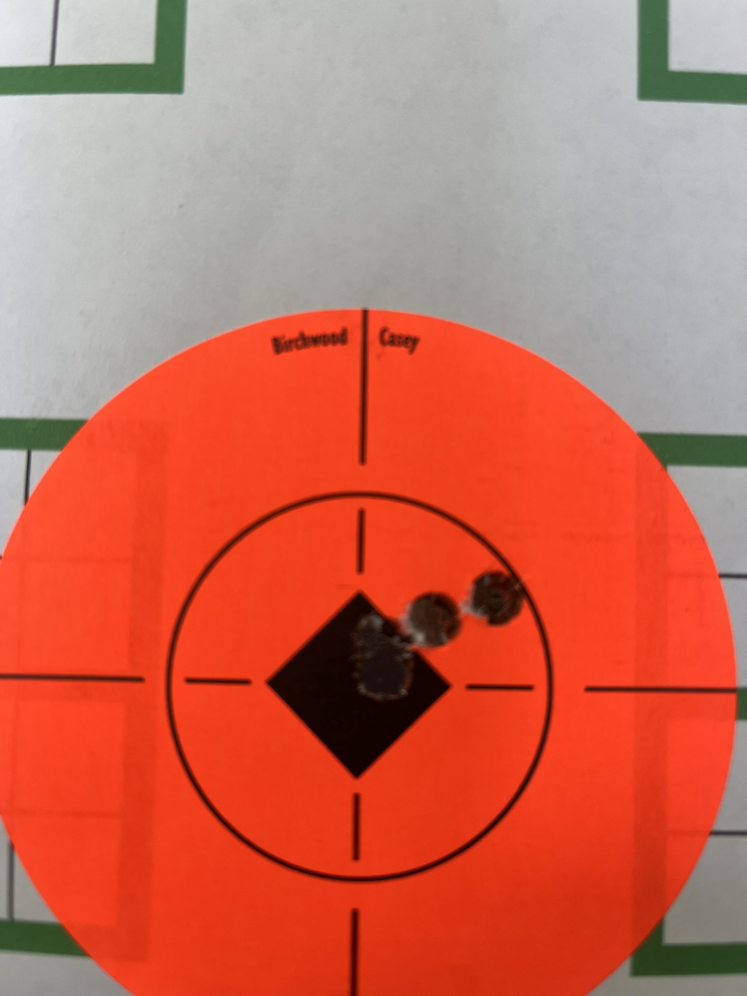

From the 5.56-223 reloading thread.
Proof prefit and 85.5 with n140. First 5 rounds out of the barrel
