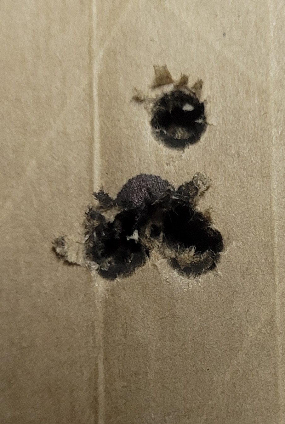

Tikka T3x varmint .223. Top round is final zeroing round. Bottom hole is 5 rounds.
